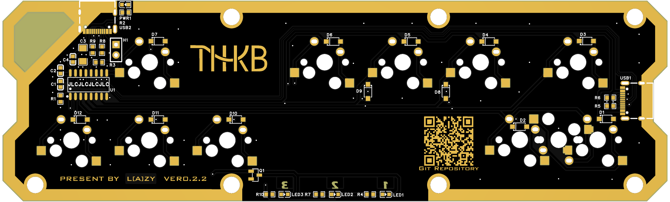

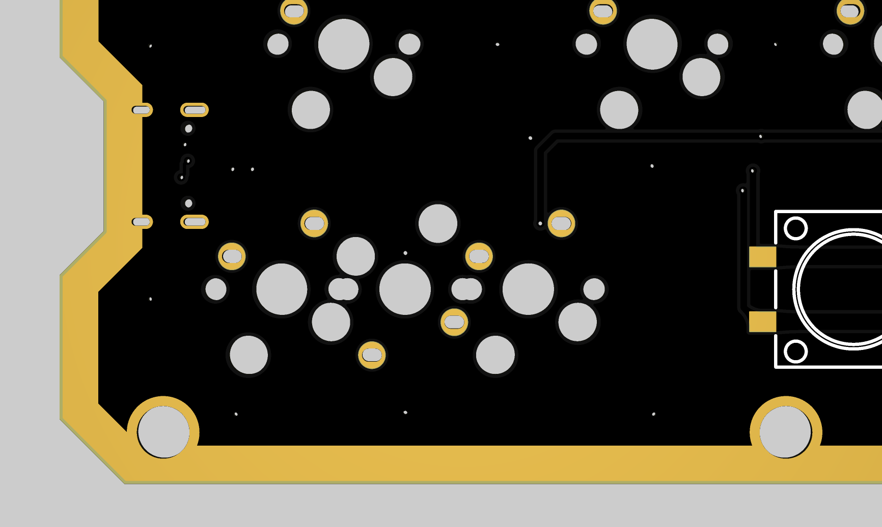

Hardware - v0.2.2
|-- pcb Contains PCB Gerber files, design files: THKB_main_v0.1.3 - JLCPCB EDA Open Source Hardware Platform (oshwhub.com)
|-- bom Bill of Materials and purchasing links

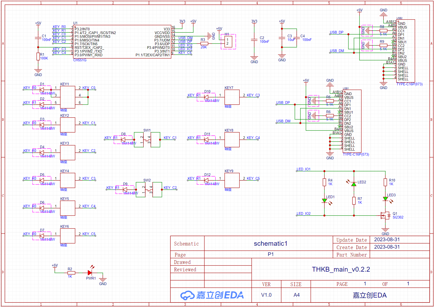

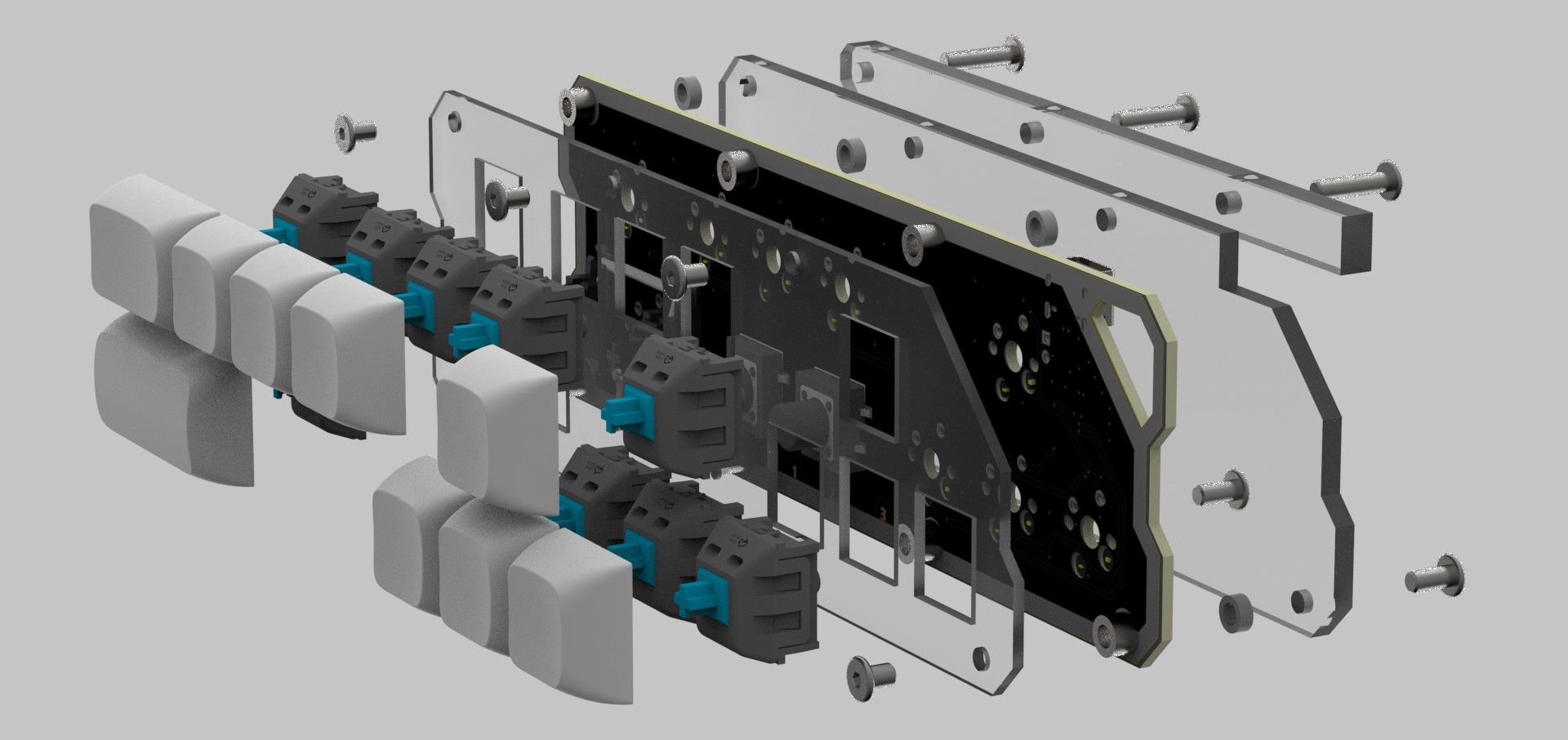

legacy version of the software firmware and is no longer maintained. III. Hardware Architecture Description 2.1 Design Concept To implement a low-cost design, all components and structures were cost-cutting while ensuring stability and usability. The keyboard has two tactile switches, supporting up to ten or even nine switches. The PCB supports both hot-swapping and soldering, allowing for adjustments based on application. The keyboard can be configured with nine 1U switches and one 1.5U switch, or seven 1U switches, one 1.5U switch, or one 2U switch. 2.2 Structural Design The keyboard tilt angle is approximately 6°. To save costs, the keyboard uses a sandwich structure, consisting of a 2mm acrylic top plate, an FR-4 fiberglass PCB, a 3mm acrylic bottom plate, and a 5mm acrylic support plate, all secured with M3 hex screws. For added stability, SMT studs are used to fix the keyboard to the PCB, making it non-removable. The top surface uses 4mm screws, while the bottom surface is secured with 8mm and 12mm screws respectively. A 2mm high through-hole post is used at the bottom to prevent the base plate from contacting components. Sandwich pads, under-switch pads, and other accessories can be added to improve the feel. The keyboard uses standard Cherry MX switches and PCB 2u stabilizers. It is recommended to use DSA, XDA, original, or OEM keycaps with lower profiles. 2.3 Chip Selection The CH551 51 microcontroller from Nanjing Qinheng was chosen. Priced at only one yuan, it supports USB FS 2.0, 128B DataFlash, and a 24MHz clock speed, making it ideal as the main control MCU for this project. The minimalist peripheral component design requires only a few resistors and capacitors, allowing for a minimal system setup. Furthermore, 51-core microcontrollers are generally robust and can withstand everyday static electricity. This enhanced robustness allows for more sophisticated PCB designs, such as exposing the tinned copper and drawing patterns. IV. Firmware Design The key scanning method is a traditional matrix scan, scanning from row to column. The keyboard consists of two rows and six columns, with a total of 12 keys. It uses the traditional 8051 mode, employing built-in pull-up resistors. Before scanning, the corresponding register is set to 1 to enable input functionality, and a 1N4148 is used to prevent crosstalk. All operations related to the host computer and USB interrupts are handled in the USB terminal service function. /*! * @brief Initialize keyboard * @param None * @return None */ void keyboard_init(void) { Port3Cfg(1,2);//R0 push-pull output Port1Cfg(1,4);//R1 push-pull output Port1Cfg(3,5);//C0 quasi -bidirectional input Port1Cfg(3,6);//C1 quasi-bidirectional input Port1Cfg(3,7);//C2 quasi-bidirectional input Port3Cfg(3,1);//C3 quasi-bidirectional input Port3Cfg(3,0);//C4 quasi-bidirectional input Port1Cfg(3,1);//C5 quasi-bidirectional input Port3Cfg(3,1);//C5 quasi-bidirectional input Port3Cfg(3,0);//C4 quasi-bidirectional input Port1Cfg(3,1);//C5 quasi-bidirectional input Port3Cfg(3,1);//C2 quasi-bidirectional input Port3Cfg(3,1);//C3 quasi-bidirectional input Port3Cfg(3,0);//C4 quasi-bidirectional input Port1Cfg(3,1);//C5 quasi-bidirectional input Port3Cfg(3,1);//C5 quasi-bidirectional input Port3Cfg(3,1);//C2 ...

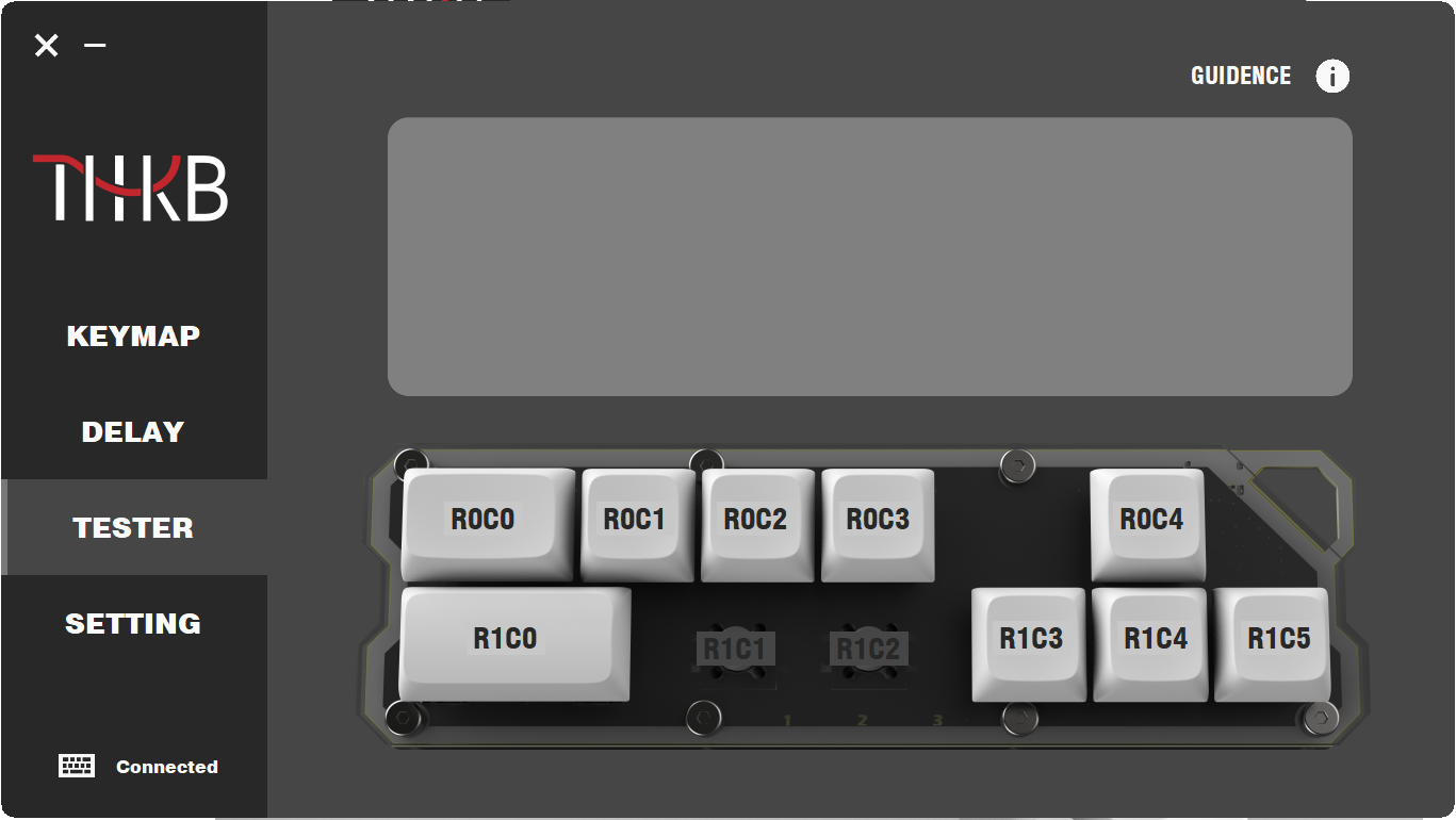

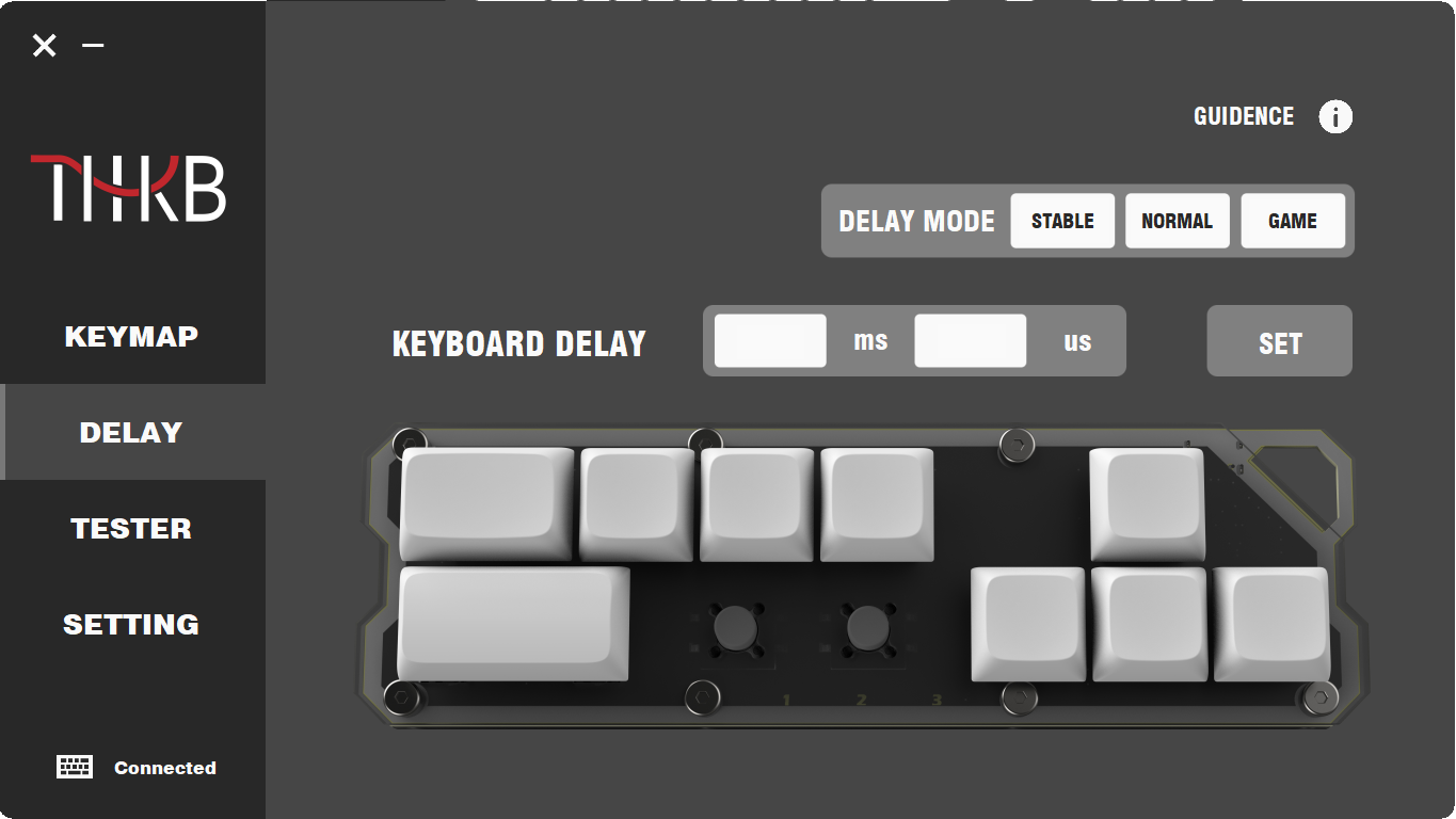

The upper computer software is written in C#, using the Winform framework and calling the Hidlibrary library. The design idea is that the main window contains four sub-windows. By clicking different buttons on the main window, the sub-windows can be switched to call different functions, such as mapping change, delay change, key test and settings. The lower left corner displays the current connection
status The button delay supports 20µs to 50ms and can be adjusted by inputting a specific value. The different modes above are coded as follows: stable mode (5ms delay), normal mode (800µs delay), and game mode (50ms delay). In game mode, a hard press can cause a double hit. A delay greater than 50ms will prevent the button from triggering, while a delay less than 20µs will easily cause a double hit.

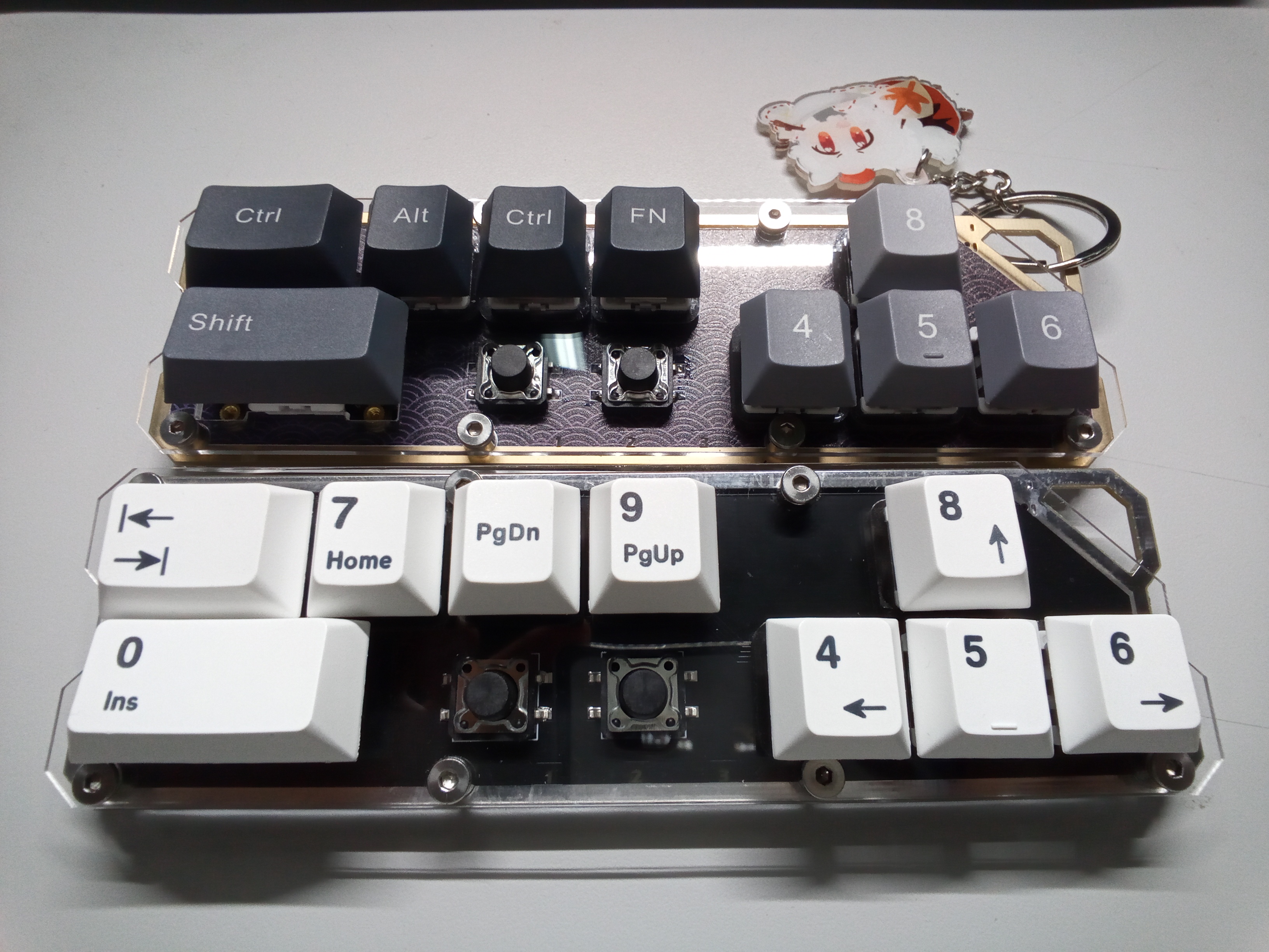

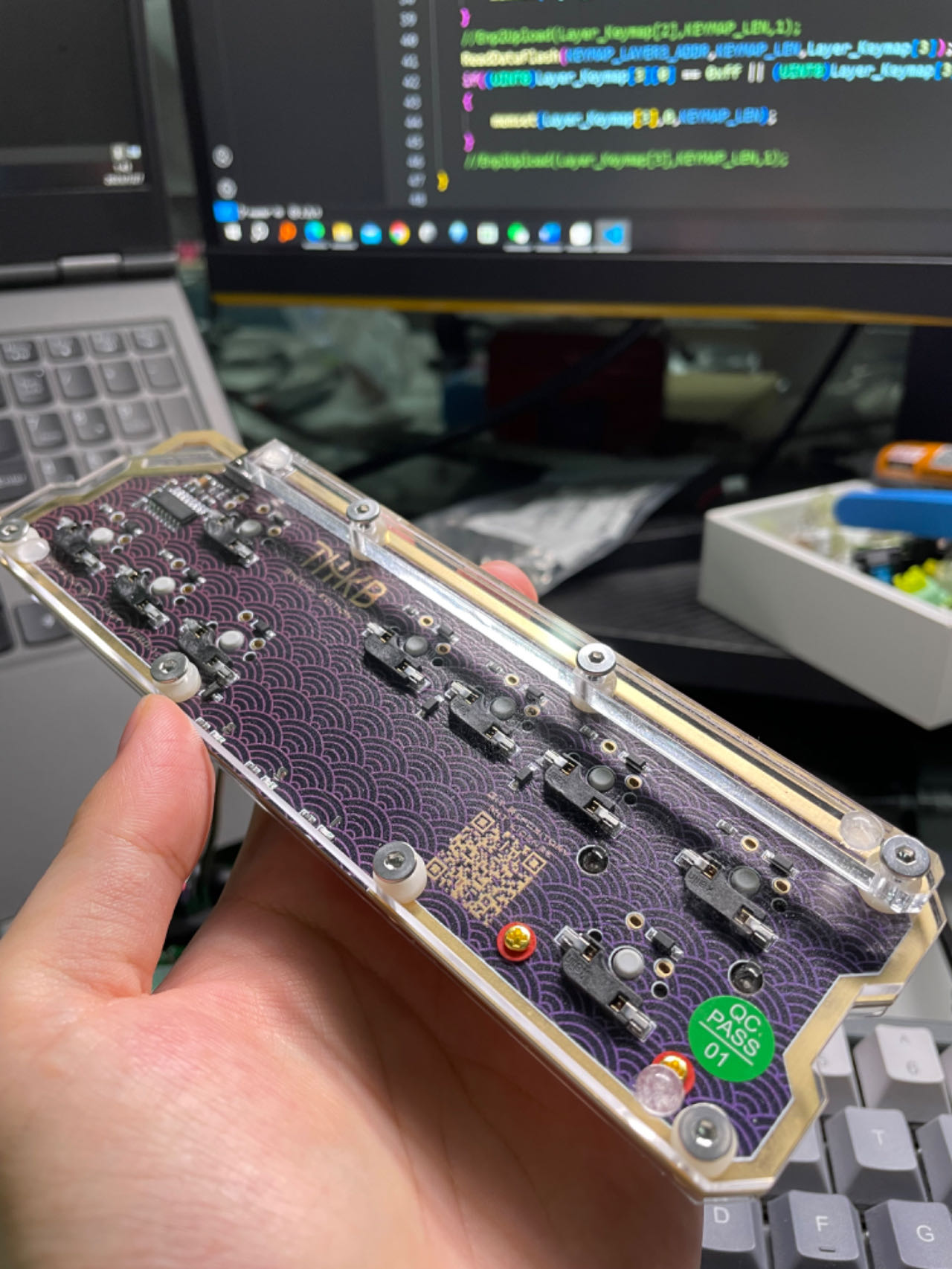

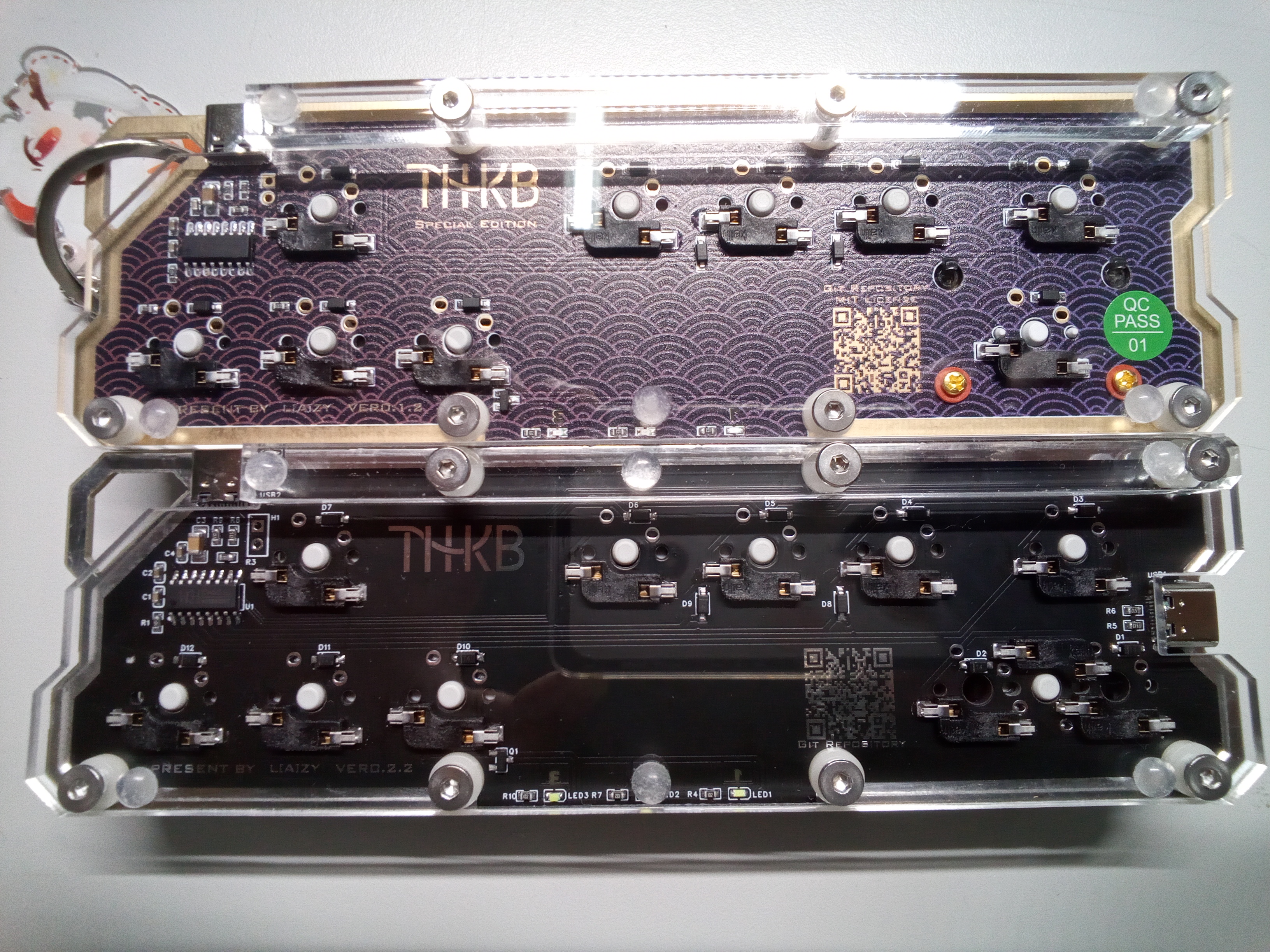

The settings interface is not yet developed, so it is currently blank.

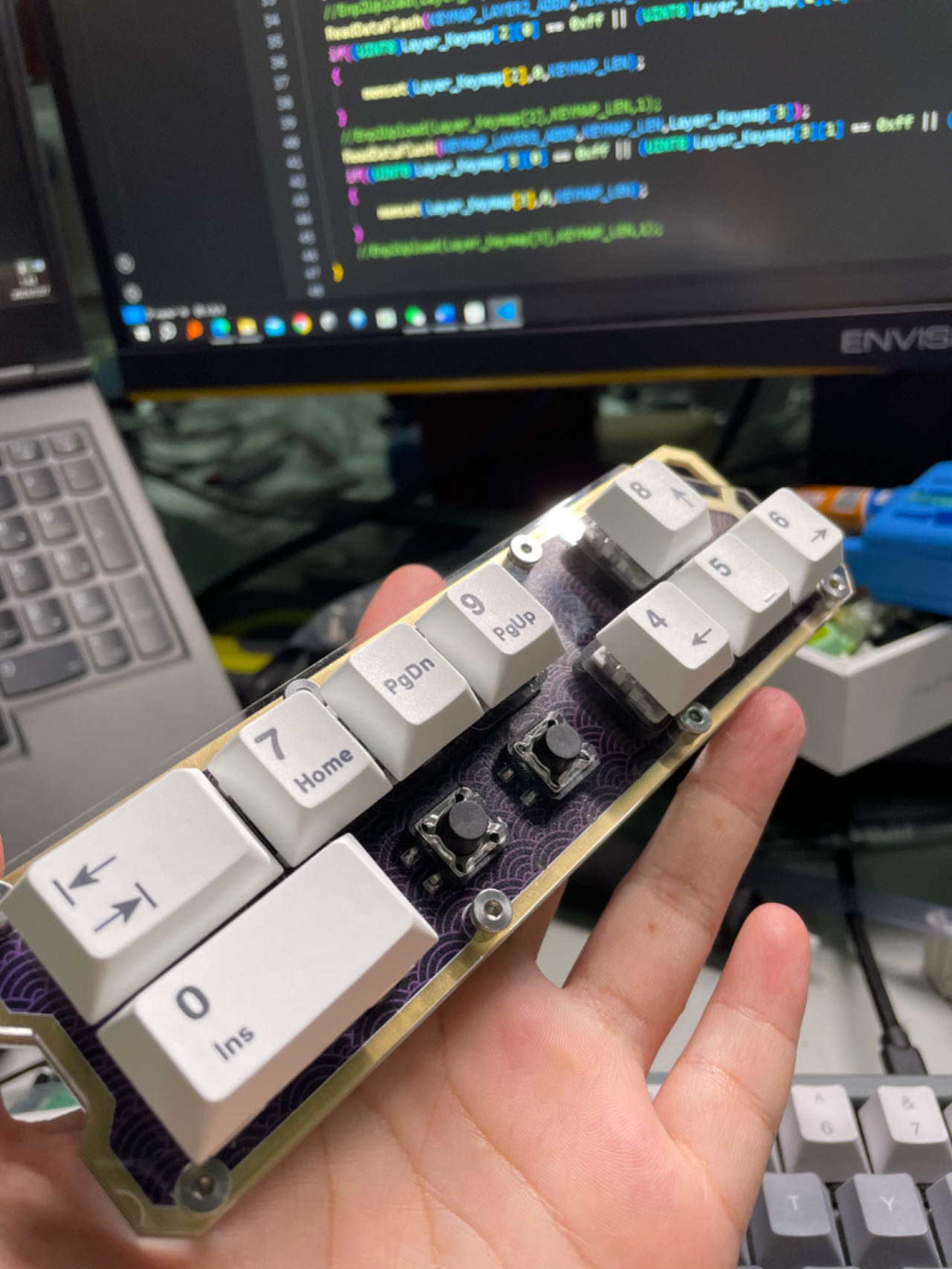

VI. Renderings and Real Shots

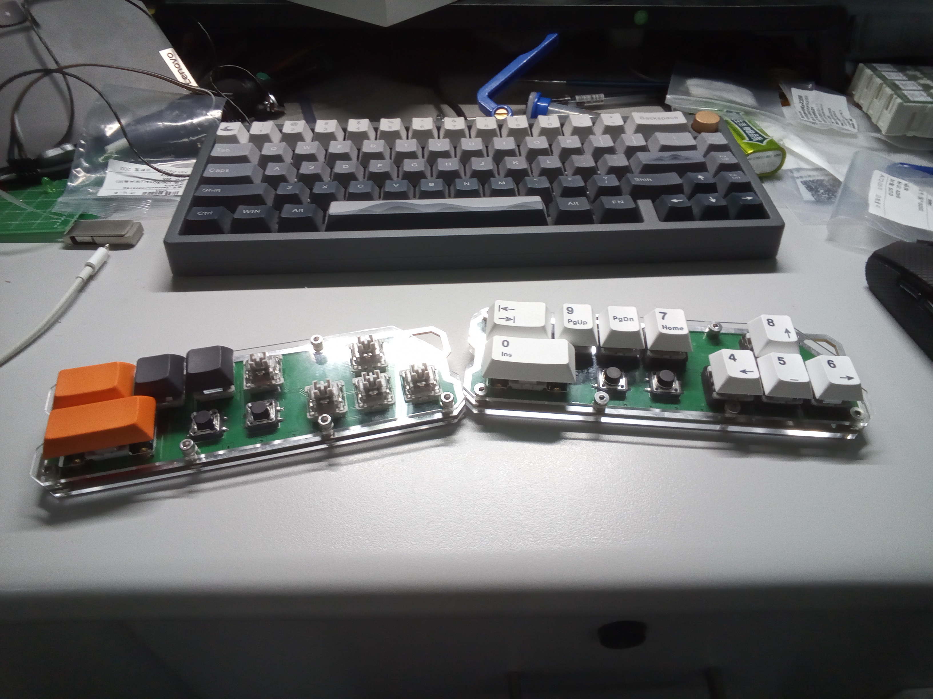

: Prototype v0.1.0
, v0.1.3 Special Edition (Purple Gold) and v0.2.2 (Black Silver)

This project originated from an inspiration I had at the end of June. If you know the "Touhou Project" IP, I believe you can guess that this keyboard is specifically designed for STG (bullet hell shooter) games. Variable latency can adapt to different typing forces, and the latency can be minimized through fine-tuning to suit different users. Of course, this keyboard will definitely have many more uses, which awaits your development.
