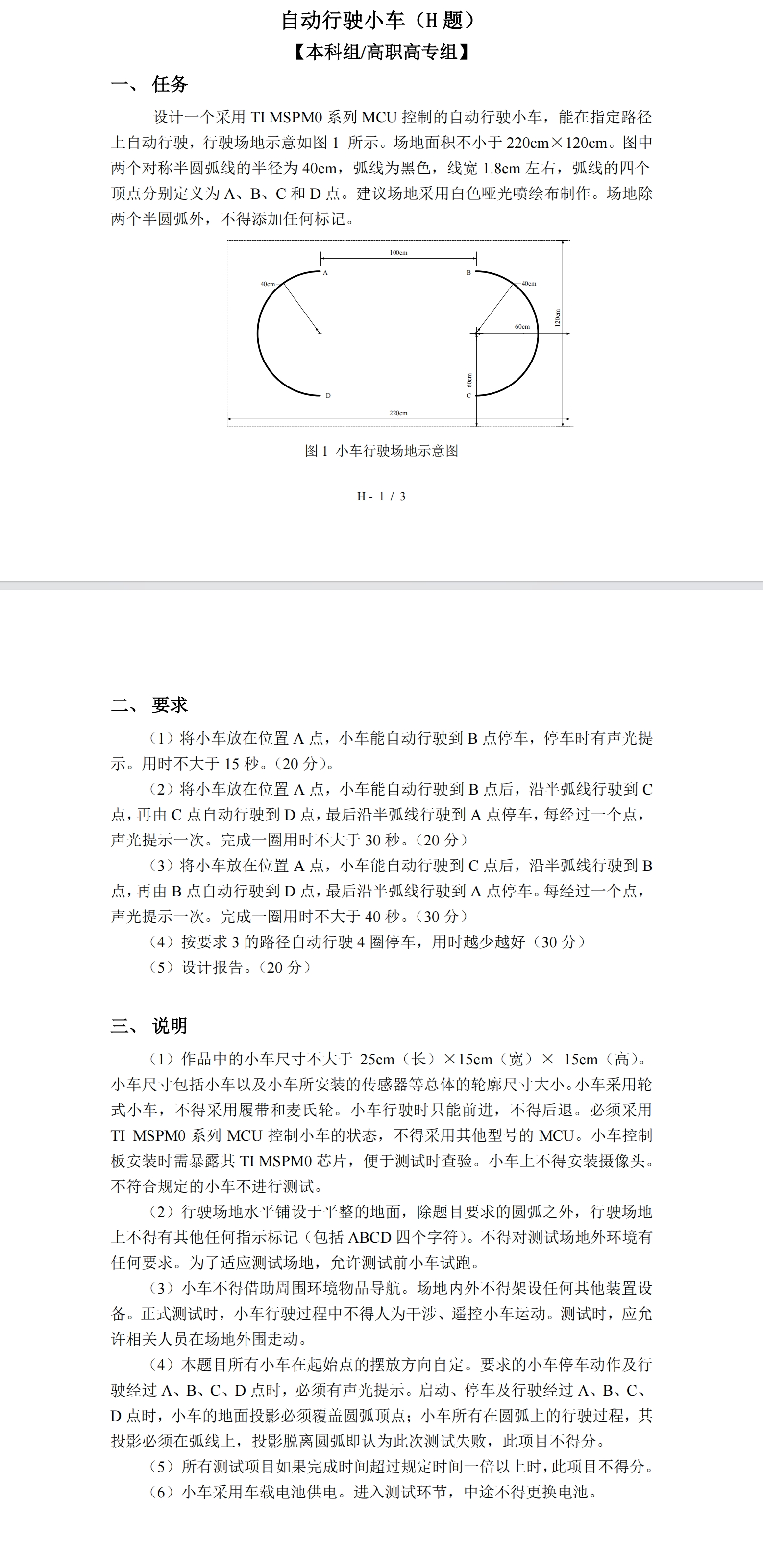

This work won the second prize in the Jiangxi Division of the 2024 National Undergraduate Electronic Design Contest.
II. Topic Requirements

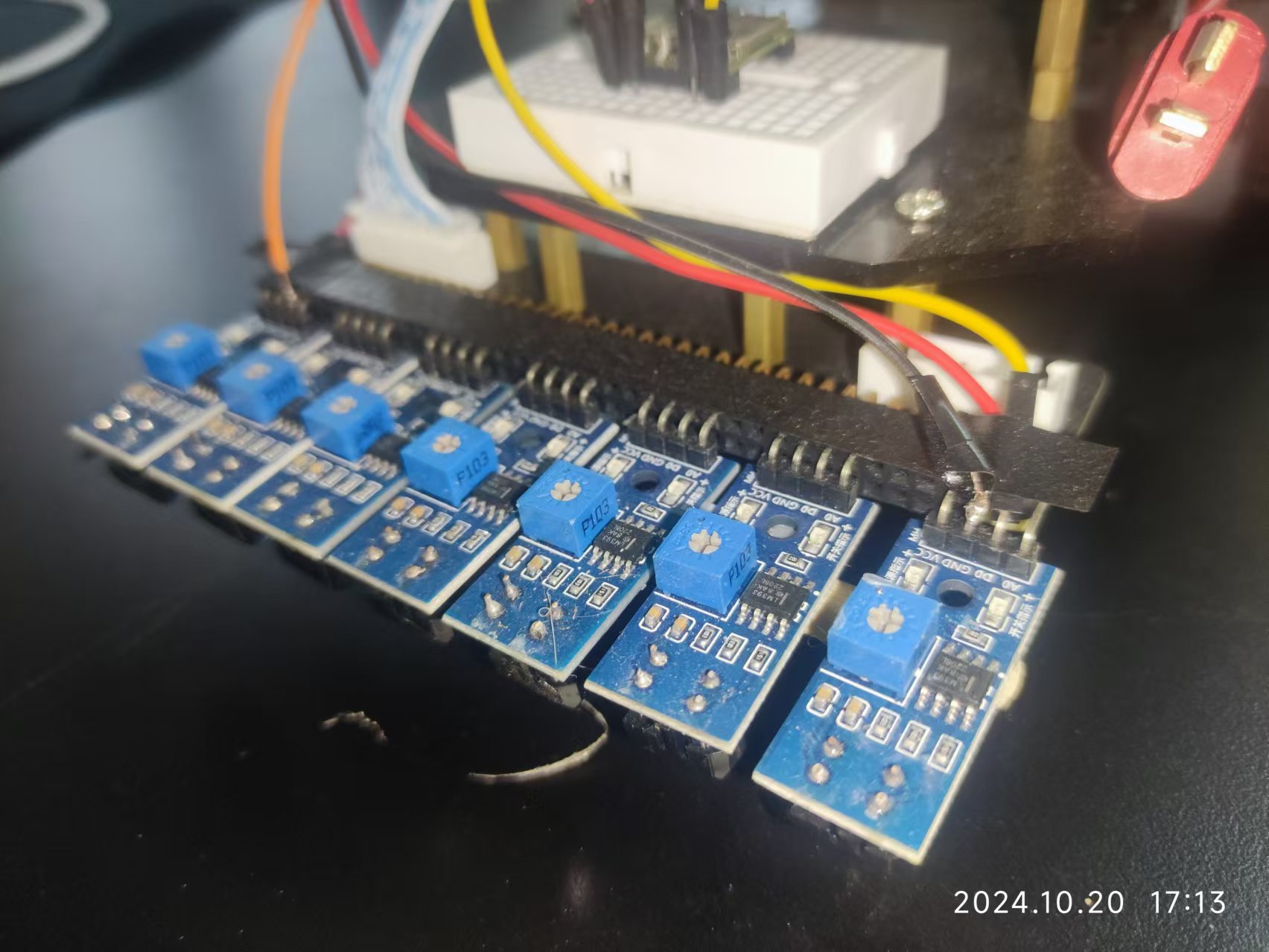

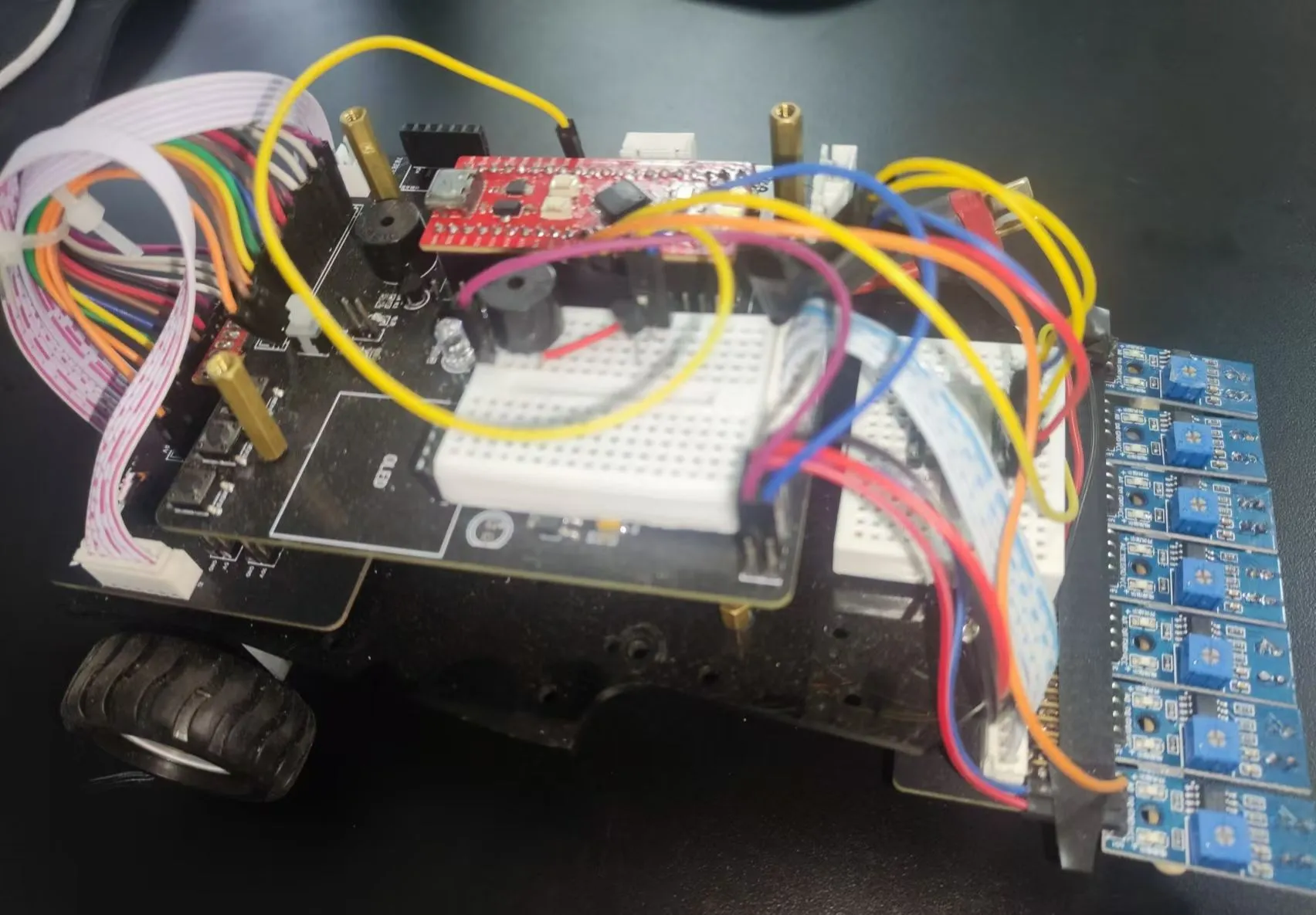

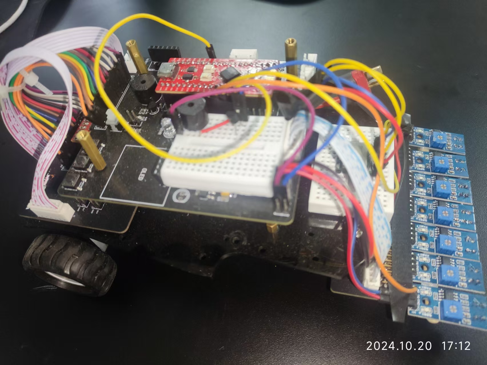

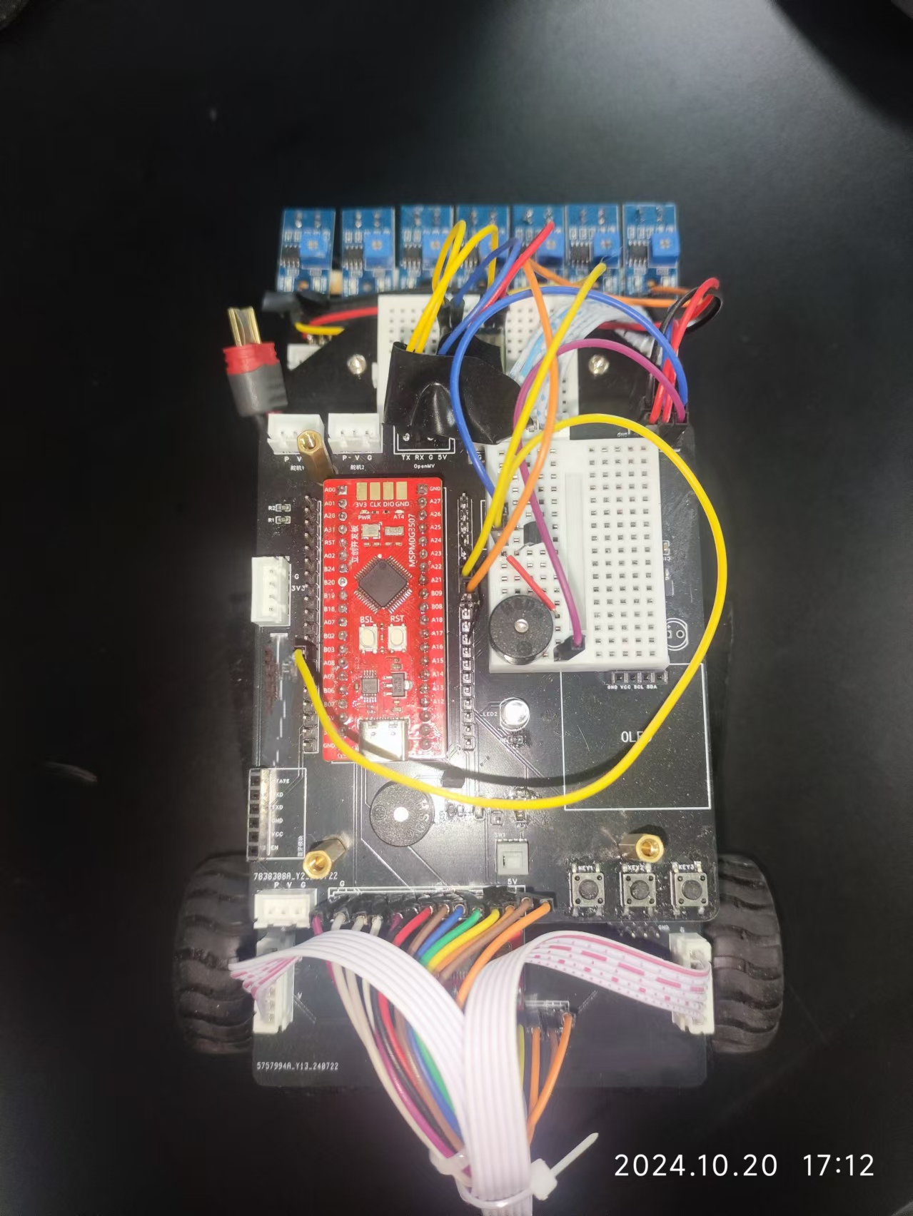

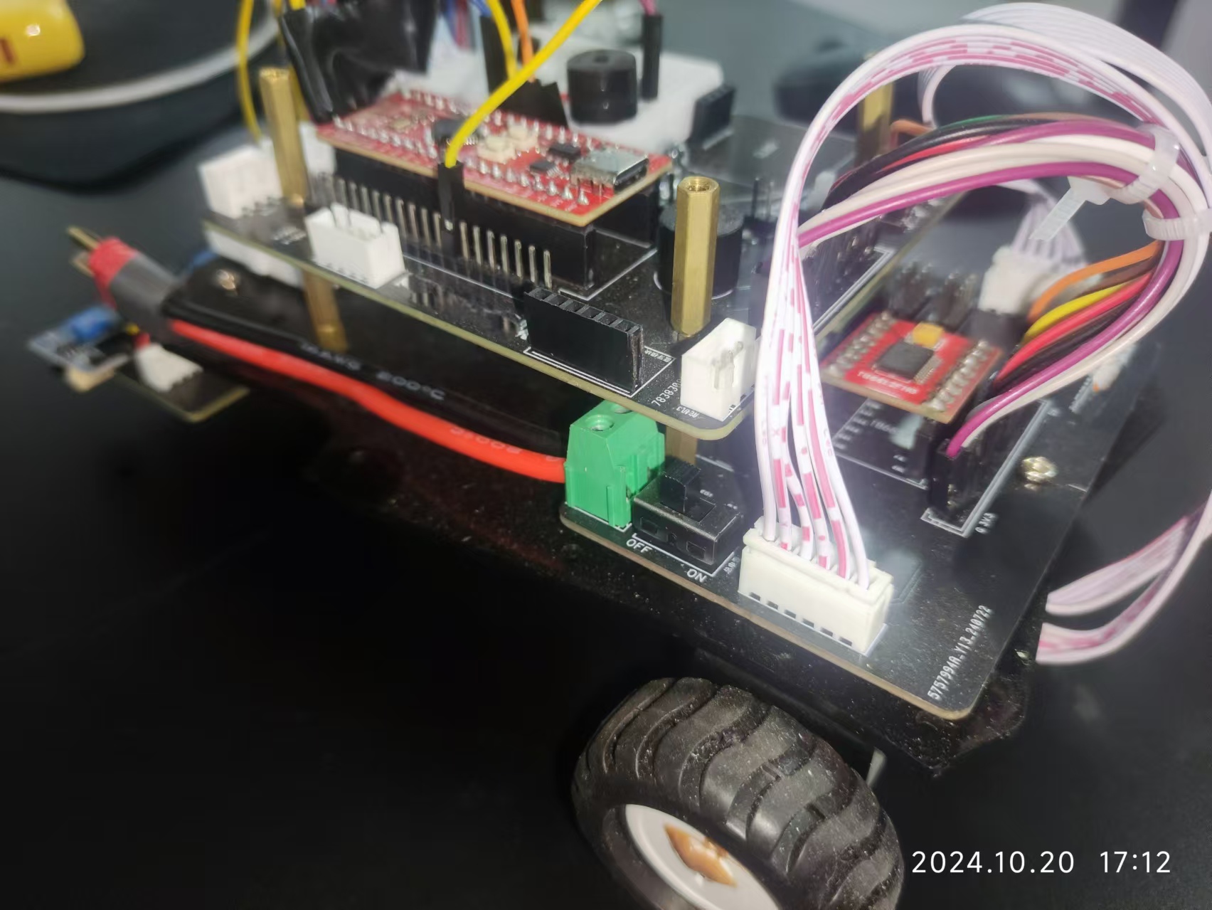

This work adopts a modular design. The control board uses the LCSC development board MSPMOG3507 as the main controller, integrating common modules such as OLED display module, buttons, and buzzer; the power board uses two adjustable switching power supplies to step down the 12V power input to 10V and 5V, and uses a TB6612 motor driver to drive two MG310 motors; the tracking board simply places two rows of corner headers, and infrared tracking or grayscale sensors can be freely added as needed.
IV. Physical Demonstration
V. Precautions
For better results, an external Witt serial port gyroscope was also connected.
