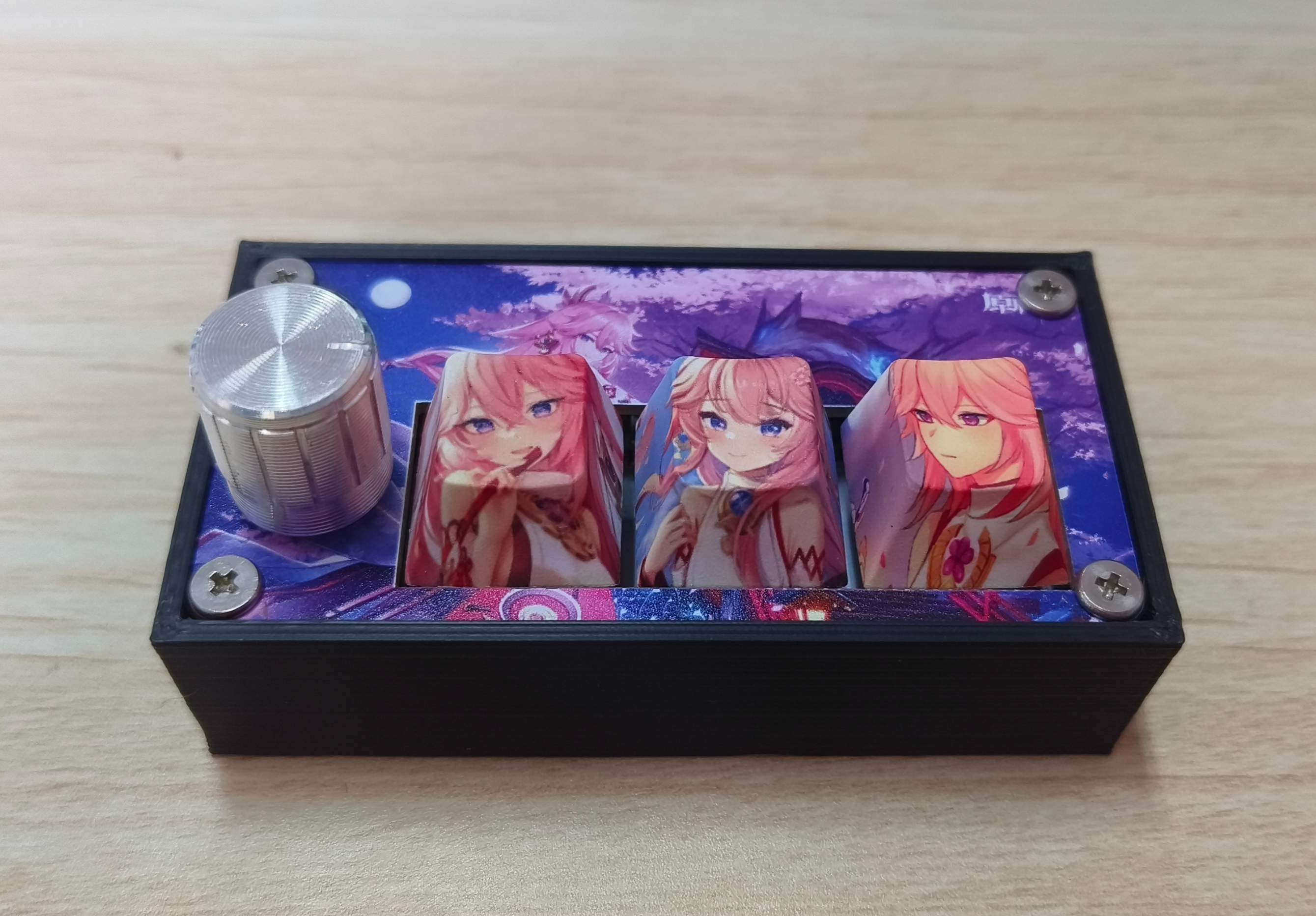

Moyu Mini Keyboard
Some computers may only recognize the keyboard keys but not respond to them.

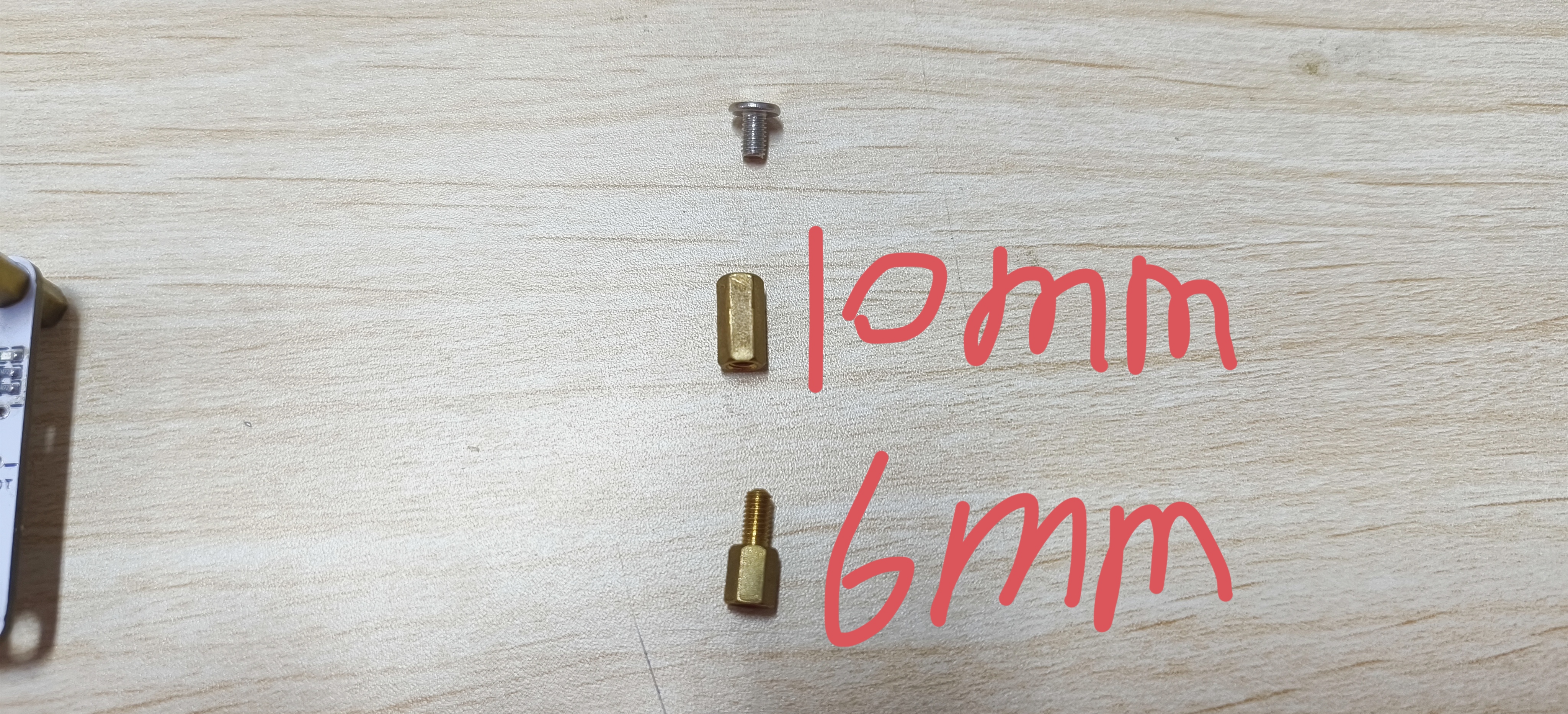

not to buy the wrong components below, otherwise they won't install.
(1) The dimensions of the copper pillar

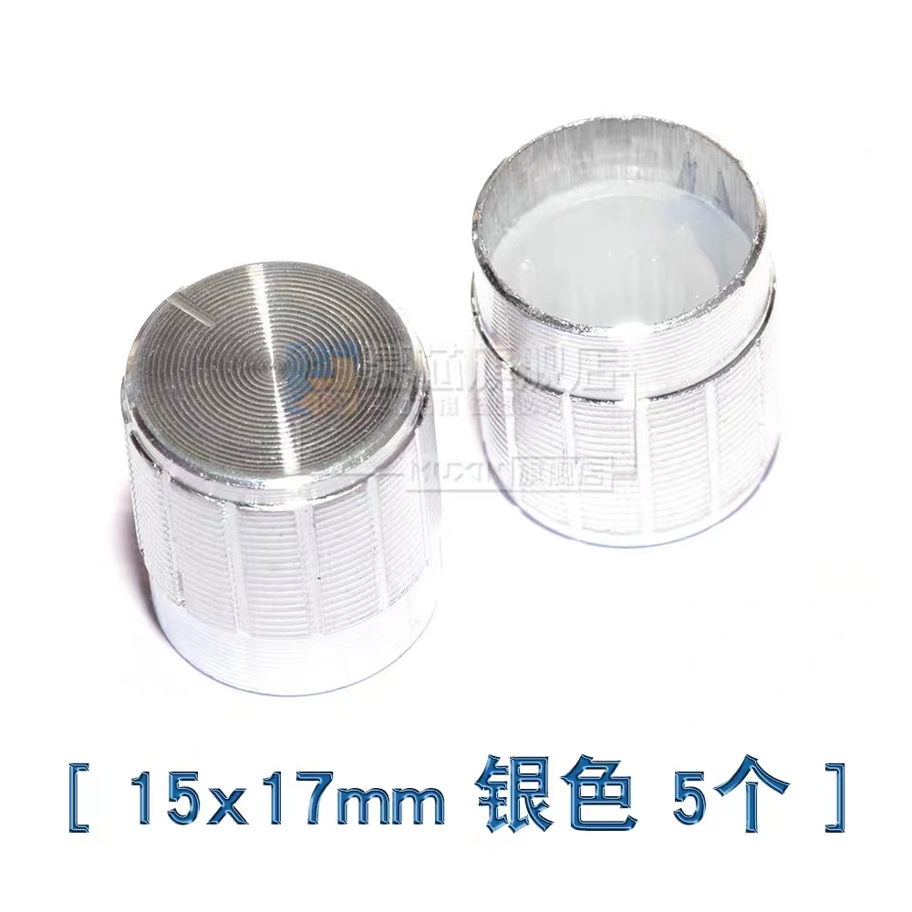

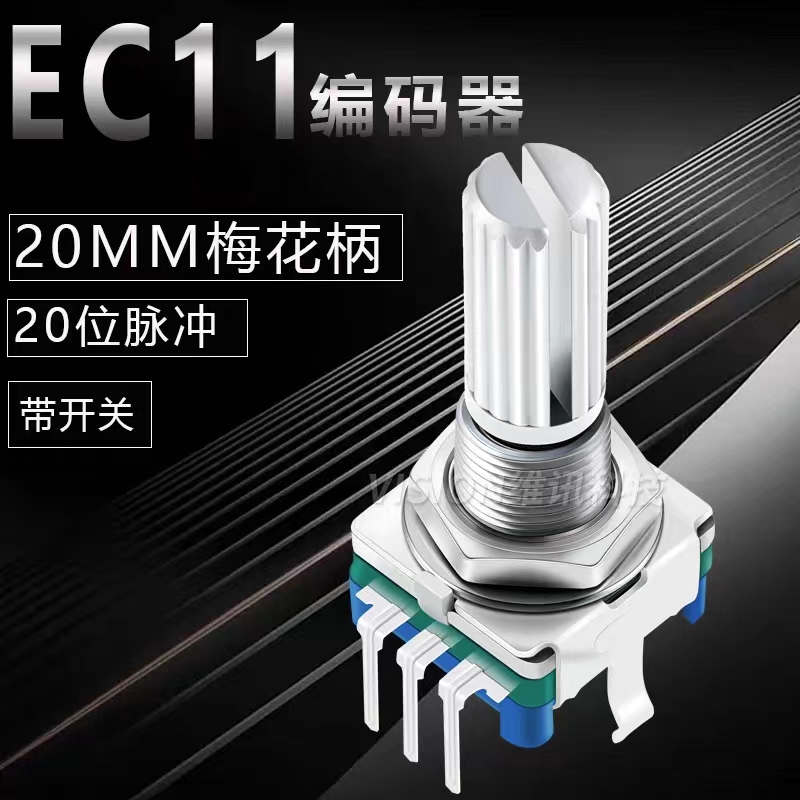

(3) Buy a 20mm swivel shank EC11 encoder with 20-bit pulses, like the one below
(4) Don't buy the wrong encoder cap either, the one below is just right
