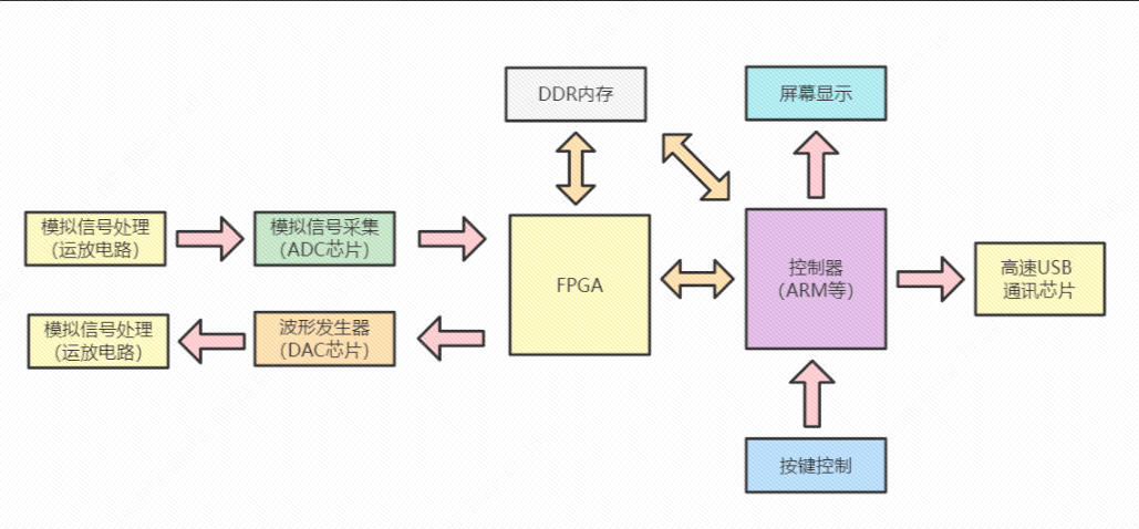

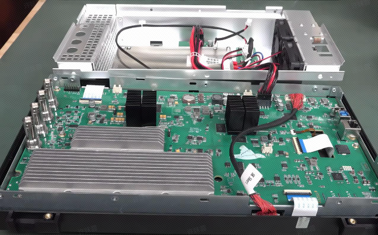

The first type is the professional oscilloscope: primarily using RAM as the main controller, FPGA + high-speed ADC chip for analog signal acquisition, high-speed DAC as the waveform generator, and high-precision operational amplifier preamplifier circuitry.

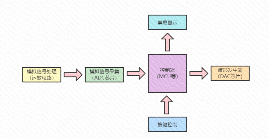

The second type is the practical oscilloscope: primarily using a microcontroller as the main controller, high-speed ADC for analog signal acquisition, high-speed DAC as the waveform generator, and operational amplifier control preamplifier circuitry.

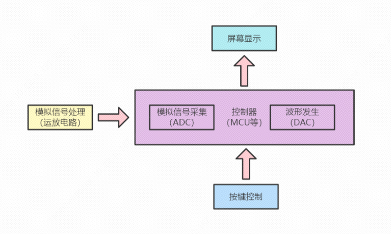

The third type is the learning oscilloscope: primarily using a microcontroller as the main controller, built-in ADC for analog signal acquisition, and simple operational amplifier preamplifier circuitry.

adopts a learning-level oscilloscope design scheme, using the built-in ADC and DAC of the Liangshanpai GD32F450 to create a DIY oscilloscope. (The analog circuit design incorporates deep learning and references Anfulai's open-source oscilloscope module circuits, and a usage license has been obtained from Anfulai.)

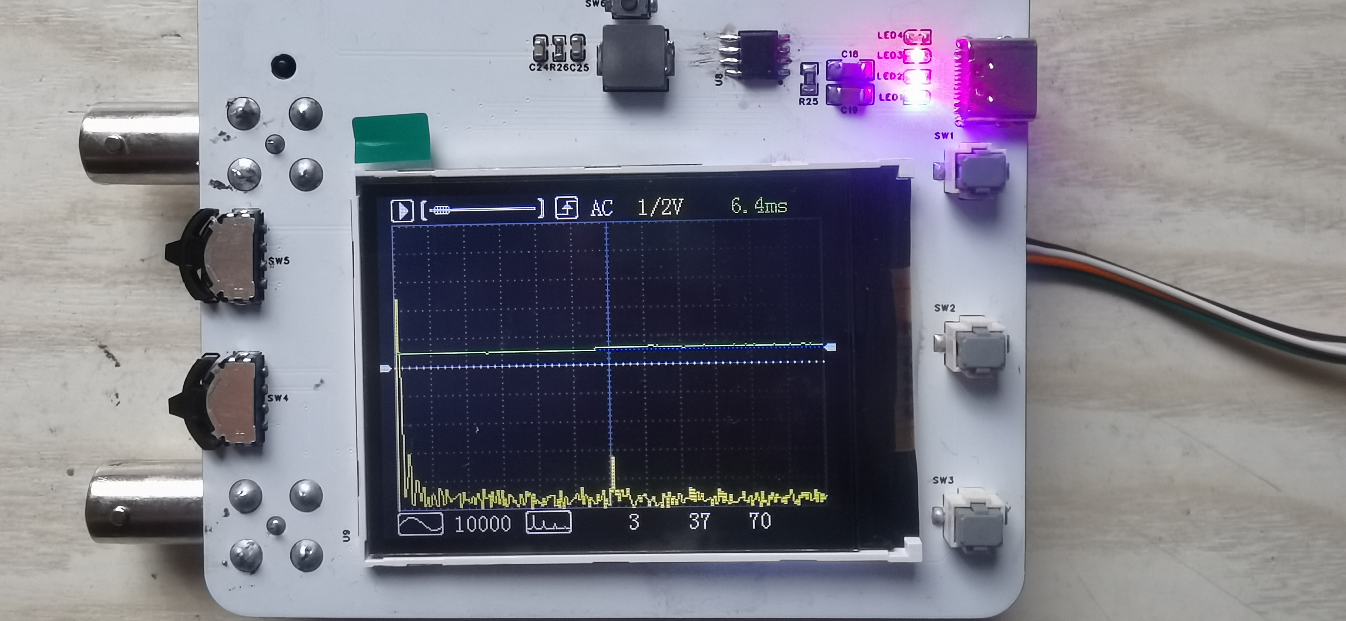

5. The Liangshanpai development board oscilloscope module features
fully open-source hardware and software functionality, allowing for free definition of more interesting functions.

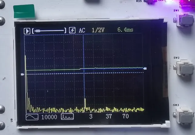

Sampling Start/Stop: Starts and stops the ADC trigger timer; when paused, detailed information such as maximum and minimum values ​​can be viewed.
Buffer Scroll Bar: Displays the acquisition status by calculating the waveform trigger position; the paused status is displayed by adjusting the offset position.    
Rising/Falling Edge: Determines and displays the position when the sampled value and trigger condition are met through software comparison.    
AC/DC: Controls the on/off state of the oscilloscope's pre-amplifier coupling relay via IO.    
Voltage Scale: Assigns voltage values ​​in 1/2V/div increments; controls the operational amplifier multiplier via IO using an analog switch.    
Time Scale: Changes the sampling time scale by controlling the ADC trigger timer period.    
Trigger Amplitude: Sets the trigger value and draws the horizontal beam position using software; indicated by a blue dashed line.    
Waveform Offset: Shifts the display position vertically using software processing; indicated by a white dashed line.    
Waveform display: Instead of the traditional two-point slope line calculation (neither X nor Y coordinates are used), it uses only vertical lines drawn between adjacent points, reducing the amount of code computation.    

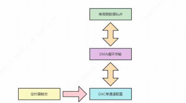

Waveform generator type: Change the single-cycle data in the DAC's buffer to automatically generate the corresponding waveform output.    
Waveform generator frequency: Change the DAC's Time trigger period to automatically generate the corresponding waveform period.    
FFT measurement switch: Software controls the display of the FFT spectrum waveform.    
FFT frequency measurement: Calculate the frequency using the maximum frequency percentage point, which may differ slightly from the actual frequency.    
FFT spectrum scaling factor: Scale the maximum value based on the value that needs to be displayed at a height of 150 pixels.    
Display coordinate offset: The sampling state displays the trigger position value, and the paused state displays the manual offset position.

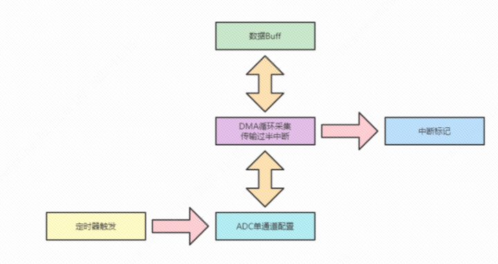

Since the software framework uses Time+DMA for both ADC and DAC, if an external ADC and DAC are used for advanced development, the Time+DMA data interaction needs to be switched to the corresponding GPIO.    
When using DMA+GPIO, it is necessary to use consecutive GPIOs and prevent accidental operation of GPIOs on the same bus (8/16 bits).
