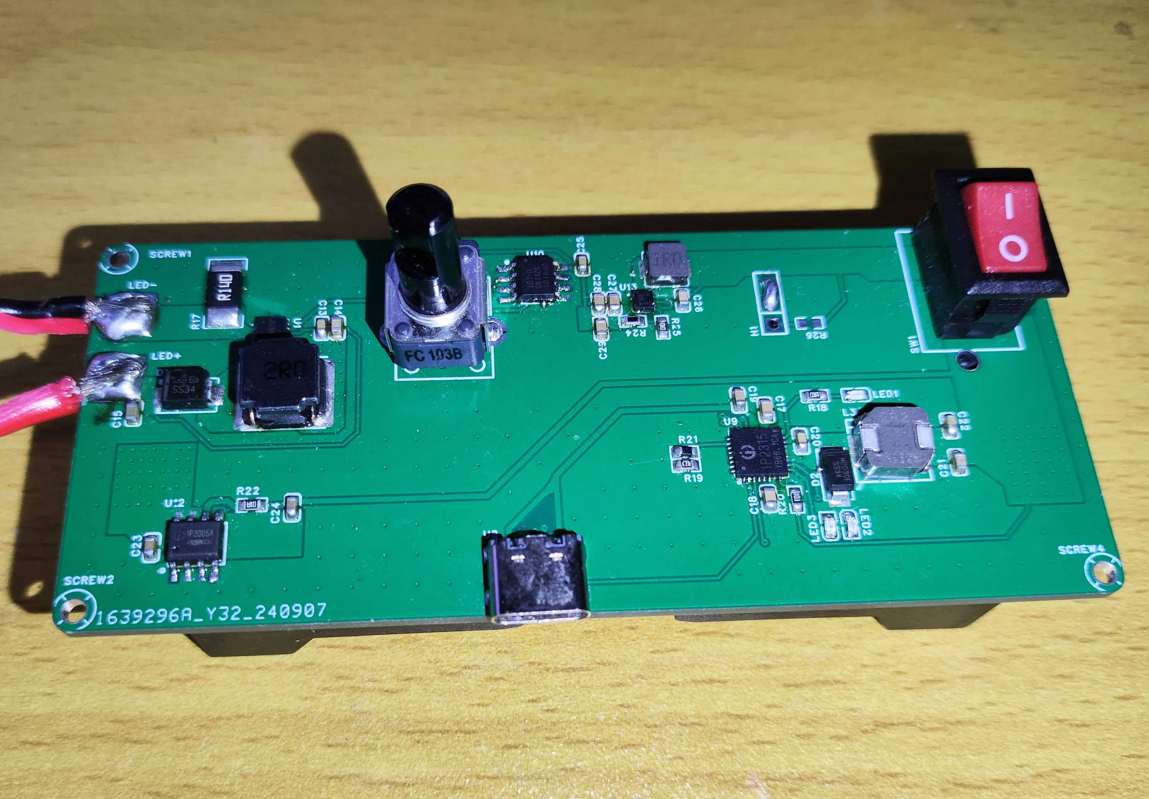

LED control board based on SY7203DBC
  This is an LED driver board using the SY7203DBC chip. For portability, a 21700 lithium battery has been added. The charging IC is an Ingenic IP2315, and the battery protection IC is an IP3005A.
  The brightness control section of the SY7203 uses a GP9101 as an external PWM signal source, powered by a TPS61022 which draws power from the battery and boosts it to 5V (a significant overkill, but this design was intended to verify the TPS61022). For a lower-cost replication, the TPS61022 can be replaced with other chips. The GP9101 has very low power consumption, so a 500mA DC-DC converter should be sufficient.
  The board uses a 2-series, 10-parallel configuration. Custom boards are available for other requirements.
