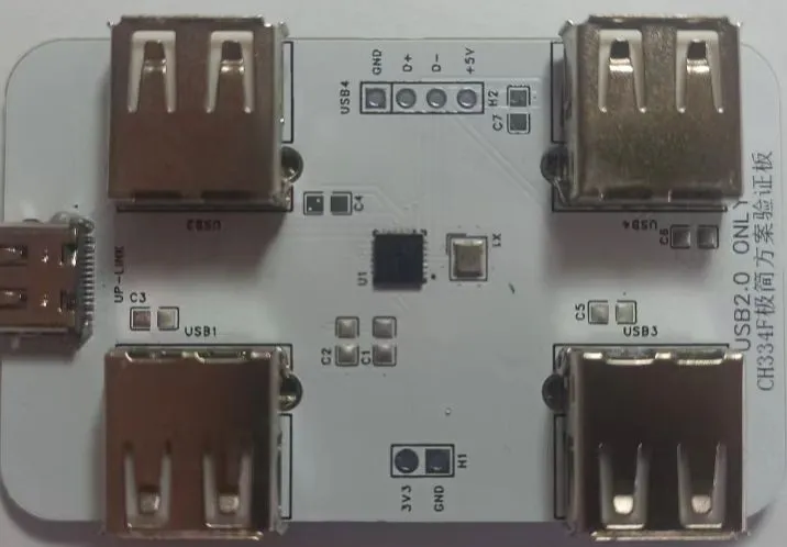

Minimalist Type-C 4-way hub (USB 2.0)
Project Introduction:
Having previously used USB hubs, I encountered extremely unstable transmission when the uplink cable aged, and various strange malfunctions. Therefore, I designed this cable-detachable hub to verify the feasibility of the hardware solution.
Actual testing showed a speed of 330Mbps, changing my previous impression of USB 2.0 as "slow and unstable."
Project Functionality
: Based on Type-C for USB 2.0 signal transmission and functioning as a 1-to-4 hub (general USB hub).
Project Parameters
: Supports longer Type-C uplink cables. In actual testing, a 1-meter Type-C cable worked normally and stably.
When connecting a computer with a 1-meter cable and a DIY SSD external hard drive, the speed reached 334.4Mbps, with an average of around 330Mbps (41.25MB/s).
Pre-installed capacitor pads were not soldered during actual testing.
Principle Analysis (Hardware Description):
This project consists of the following parts: Type-C uplink interface, main controller and crystal oscillator, and USB-A downlink interface. This project primarily involves connecting to a computer or other USB hub-enabled devices via Type-C, and using a main controller to bring out four USB-A ports, thus implementing a USB 2.0 hub design.
One USB 2.0 port and one 3.3V power supply port are provided via a 2.54mm header for easy connection and debugging.
Software code:
This project does not involve firmware or host computer software development; it utilizes USB plug-and-play functionality, ensuring compatibility with most devices supporting USB interfaces and standard USB.
Notes:
No capacitors are soldered to test the feasibility of a minimal component setup, which may slightly affect power supply. The test environment should be a relatively clean power supply environment; a poor power supply environment may cause peripheral devices to malfunction.
This project is designed according to the USB 2.0 specification; note that downstream devices have a power supply limit of 500mA.
The 3.3V port is powered by a CH334F microcontroller; please refer to the datasheet for specific usage and parameter limitations.
[Image of the actual device]

Project Overview
This project is a replica of the original Bilibili video above.
Physical Images :
Figure 1: Soldering Completed
Figure 2: Printed Shell
Figure 3: Assembly
Figure 4: Hole Alignment Perfect
Figure 5: Read/Write Speed ​​is also Acceptable
Overall, it's a successful replica.
Notes :
1. I used that large inductor for the 1.2V section because I happened to have it, so I used that package. Replicas don't necessarily need to use the same one.
I didn't use Type-C because I'm too inexperienced to solder a 24-pin connector (sad).
