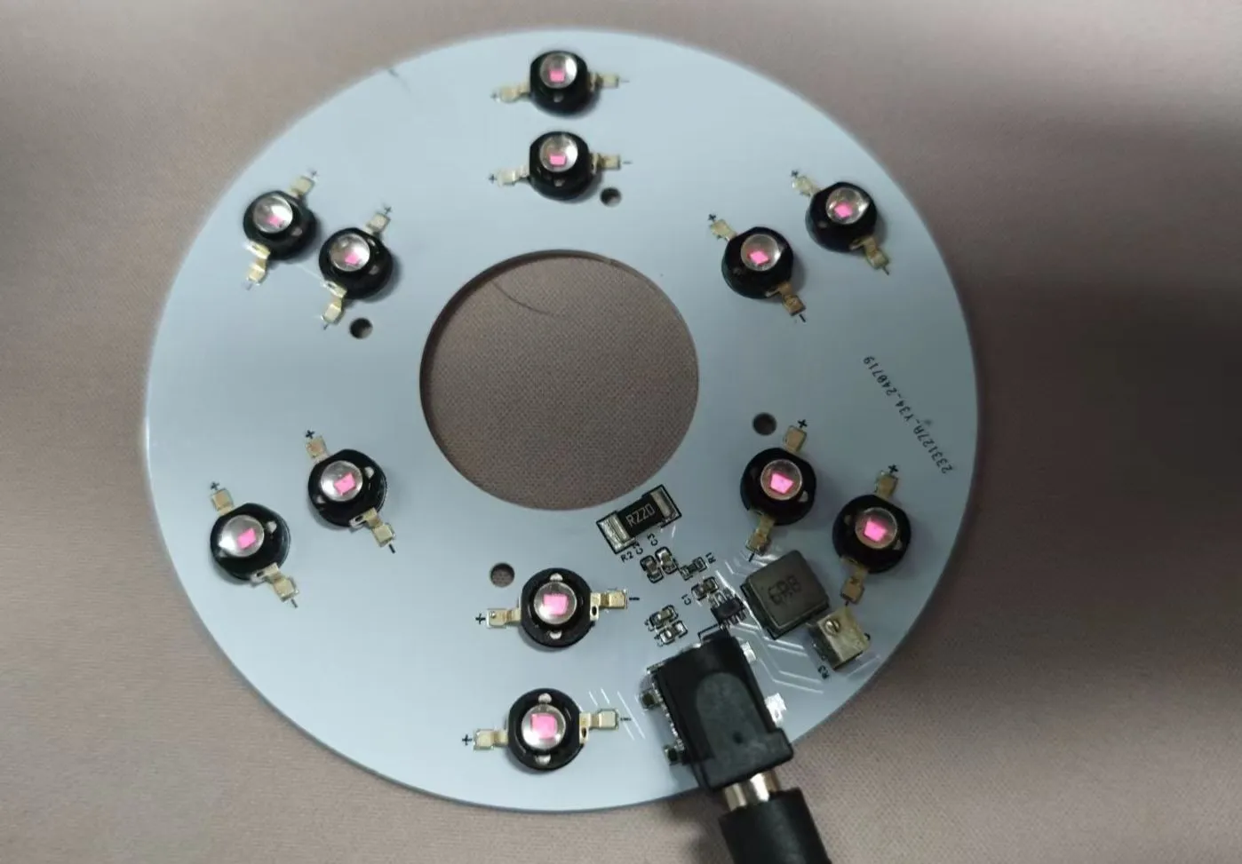

Constant current LED driver board based on TPS92200
Project Overview:
This project presents a constant current LED driving solution based on TI's TPS92200 LED driver chip. It can achieve a 4-30V input and a maximum current output of 1.5A. LED brightness can be adjusted by changing the potentiometer value. The solution uses 12 infrared LEDs, but other LEDs can also be used. The inductor value and feedback resistor can be adjusted according to the LED's on-state voltage, current, and ripple. It is suitable for experiments or lighting needs in night vision applications. The TPS92200 supports overvoltage protection, short-circuit protection, and overheat protection.
Project Parameters:
This design uses the TPS92200 LED driver chip, supporting brightness adjustment via voltage sampling or PWM output. This solution uses analog voltage sampling, with an analog dimming range of 5%-100%.
The driver board uses a DC 5.5 interface with a 12V input voltage. The LED voltage drop is 1.7V, with three series and four parallel configurations, each channel providing 100mA of current. The single-sided aluminum substrate offers better heat dissipation compared to the FR4.
The selection parameter calculation example
can be adjusted according to your needs. Parameter
values
Input voltage range: $V_{VIN}$
12V $pm$ 10%
LED forward conduction voltage drop: $V_{LED}$
1.7V
Output voltage: $V_{OUT}$
5.2V (1.7V*3+0.099V)
Maximum current per LED:
300mA
Sum of maximum LED currents: $I_{LED}$
1200mA
Inductor current ripple: $K_{IND}$
30% Maximum LED current
LED current ripple: $I_{LED(ripple)}$
20mA or less
Input voltage ripple: $V_{VIN(ripple)}$
200mV or less
Dimming type:
This project uses analog dimming, selecting TPS92200D1.
$K{IND}$ is usually between 0.2-0.4. The smaller K{IND} is, the smaller the output current ripple. Here, 0.3
FB is selected. The reference voltage at the pin is fixed, with the voltage between FB and GND being 99mV. The voltage of FB is adjusted between 5mV and 99mV by adjusting the value at the DIM pin.
The feedback resistor determines the maximum current. The feedback resistor calculation formula is:
R{SENSE} = frac{V{FB_REF}}{I{LED}} = frac{99mV}{1.2A} = 0.0825Ω
The inductor calculation formula is
L=frac{V{OUT}(V{VIN(max)}-V{OUT})}{V_{VIN(max)}K{IND}*I{LED}f_{sw}}=frac{5.2V(13.2V-5.2V)}{13.2V0.31.2A*1MHz} = 8.75uH
TI recommends that the inductor current ripple be greater than 300mA. The inductor current ripple calculation formula is:
I{L(ripple)} = frac{V{OUT}(V{VIN(max)}-V{OUT})}{V_{VIN(max)}Lf_{sw}} = frac{5.2V(13.2V-5.2V)}{13.2V8.75uH1MHz} = 360 mA
If the LED ripple requirement is not high, the maximum brightness can be changed directly by modifying the size of the feedback resistor without affecting the implementation of basic functions. This solution uses a 0.22Ω feedback resistor, and the actual current per channel is approximately 110mA.
Note:

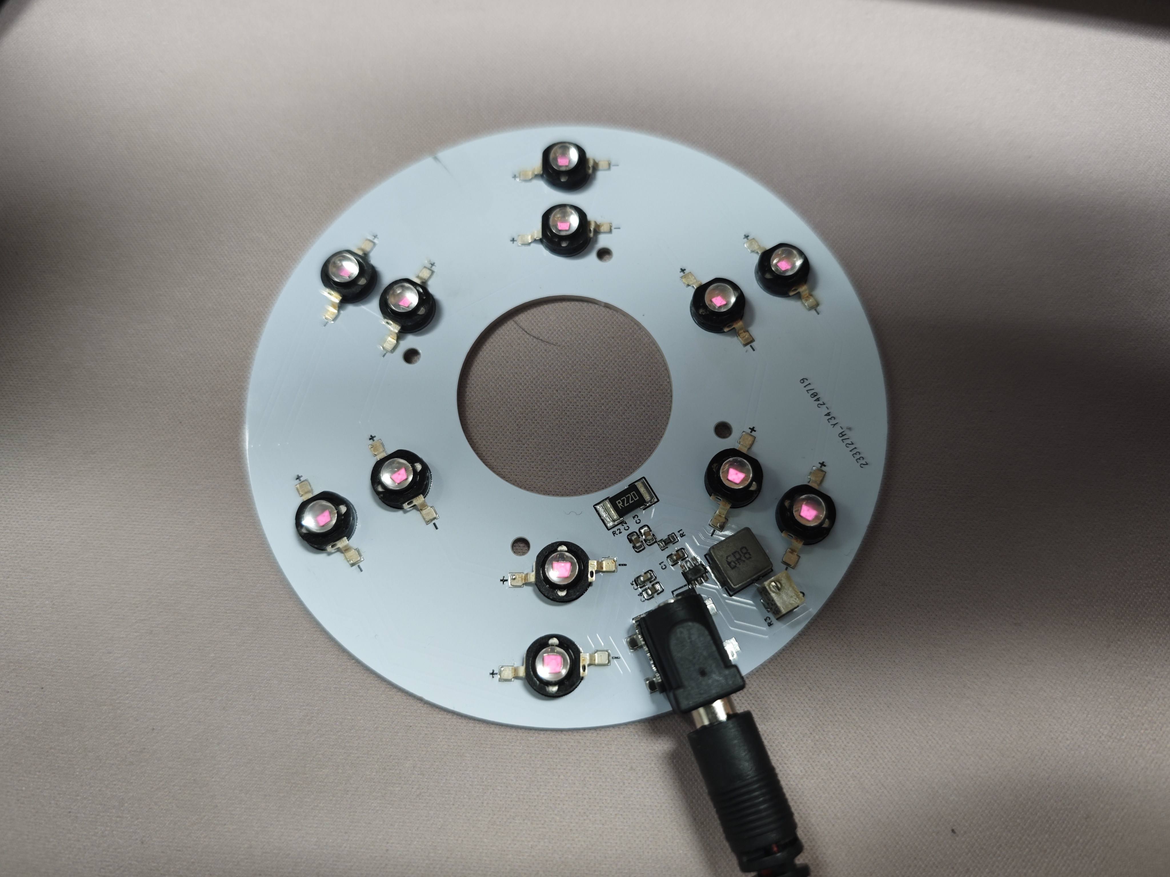

This solution uses a single-layer aluminum substrate for prototyping. The bottom surface of the aluminum substrate is conductive. Care must be taken not to select the wrong package for the adjustable resistor and DC power interface. This solution uses single-sided surface mount packages throughout.
The actual product image
shows a light board using 850nm infrared LEDs.

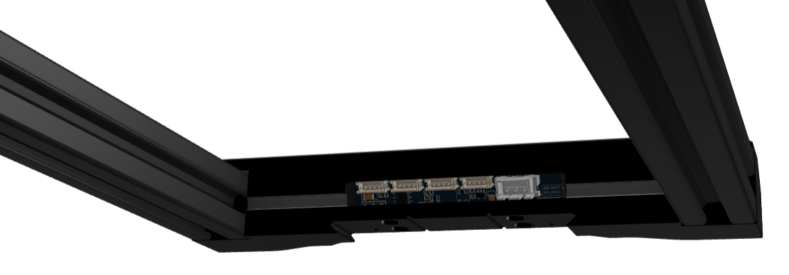

A simple and low-cost 3D printed pressure-sensitive heated bed leveling solution, compatible with HX71708 or CS1237, with a high sampling rate of 320 or 1280Hz.
This program obtains
a 3D printer pressure heated bed. The main controller uses PY32F002AF15P (Puran) and Air001 (Hezhou), which are essentially the same. The Arduino development environment is provided by Hezhou, and it can use either HX71708 or CS1237 (recommended) AD conversion chips.
The circuit is simple and easy to modify, and can be easily embedded into various other motherboards or project circuits.

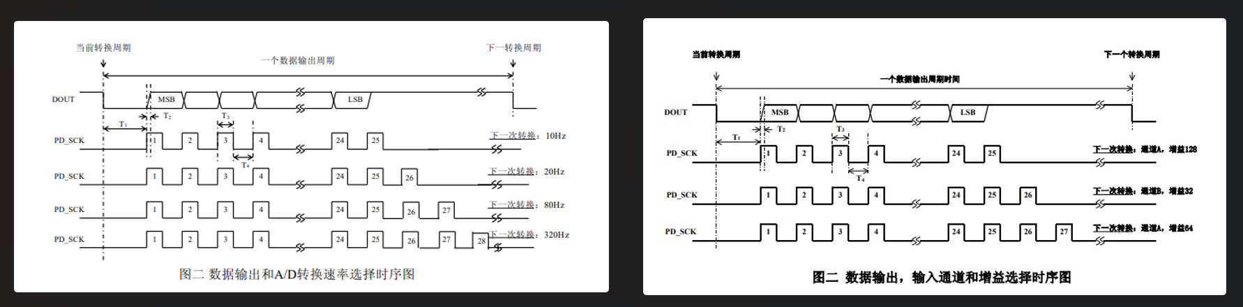

Chip selectable data rates:
HX71708 10, 20, 80, 320
; CS1237 10, 40, 640, 1280.

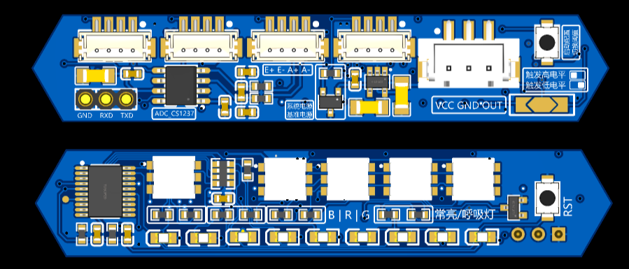

The basic version
adds an RGB version with
a 5-level LED progress bar display function, triggering progress to convert to percentage, controlling LED lighting from 30-100%.
One logo light, four text background lights, resistor jumper settings for color and constant or breathing light selection.
An external reference source chip can be used, or a 20R resistor can be used with an LDO as the reference source. An external reference source provides greater accuracy and stability.

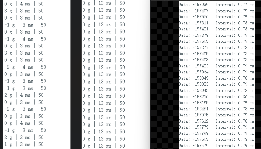

Test conditions: CS1237 1280Hz, 5mm/s speed, belt Z 80:20 reduction ratio, trigger weight 150g.
Accuracy test results after 10 consecutive repetitions:
Range
Deviation
0.0025.
0.001146
0.0025
0.001146
0.0050
0.001581
0.0050
0.001581
0.0025
0.001000
0.0075
0.001871
0.0050
0.002000
0.0050
0.001658
0.0050
0.001581
0.0050
0.001346
Klipper officially recommends that the repeatability range of the leveling probe be within 0.025. If using the HX711 with a maximum data rate of 80Hz, the speed must be reduced to barely meet this requirement. The high sampling rates of the HX71708 and CS1237 can significantly improve repeatability to obtain better probe data.
If the test results show a range value greater than 25 micrometers (0.025 millimeters), then the probe does not meet the accuracy requirements of a typical bed leveling procedure. Adjusting the probe speed and/or the probe start-up height can be tried to improve probe repeatability.
Comparing the data intervals of HX71708 (80Hz and 320Hz) and CS1237, the

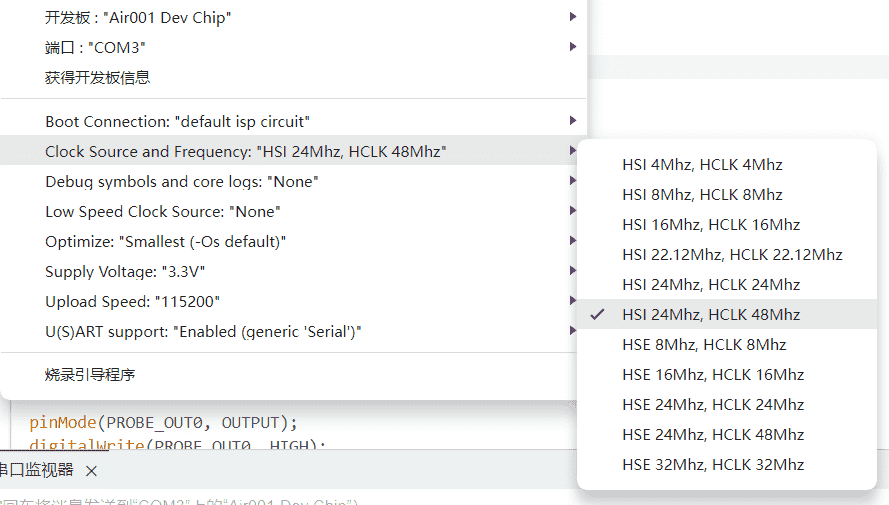

require a separate serial port programmer. Connect the pre-installed serial port pin header for downloading.
Configure the development environment according to the official tutorial of Hezhou. Air001 Arduino-based user manual
[Important]: Set the main frequency to 48MHz during download.

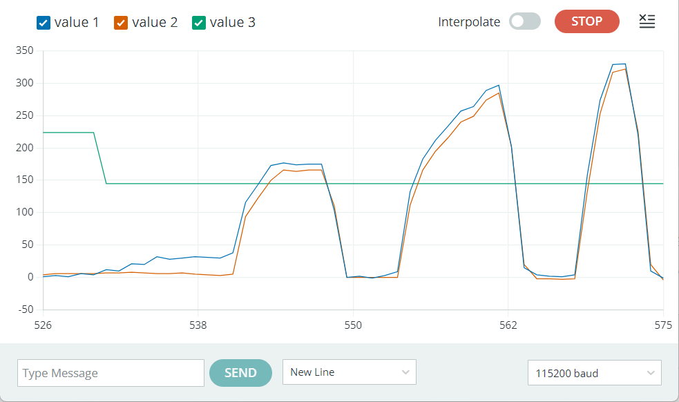

. Debugging instructions:
The SERIAL command enables real-time weight reading output, outputting three data points every 100ms: weight, filtered weight, and trigger threshold.
After enabling SERIAL output, you can use the Arduino IDE's serial port plotter to visualize the data using charts.
The RECORD command starts recording the highest and lowest weight readings, which can be used to observe reading fluctuations under no-load conditions or trigger force.
EMA is used to enable or disable the exponential moving average filter. This option is not saved after setting and is enabled by default.

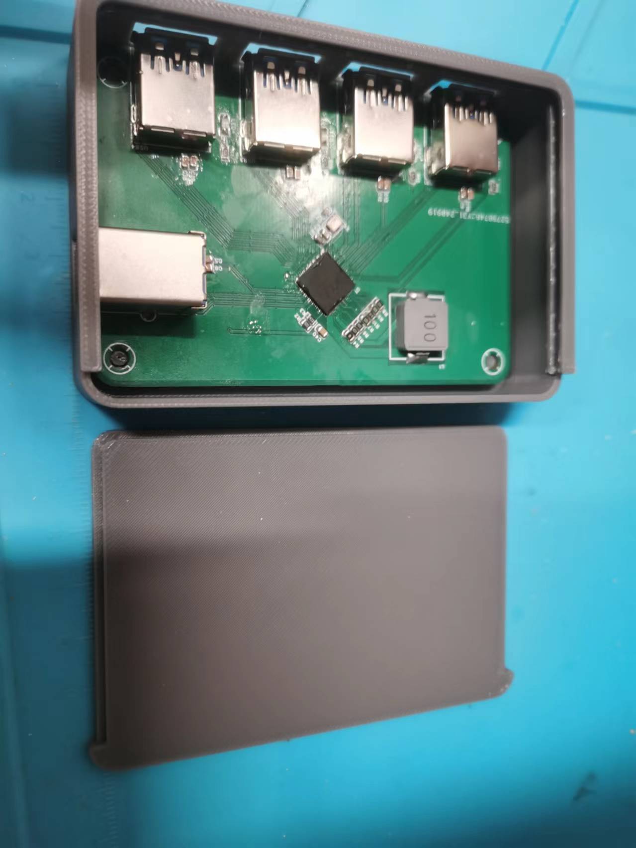

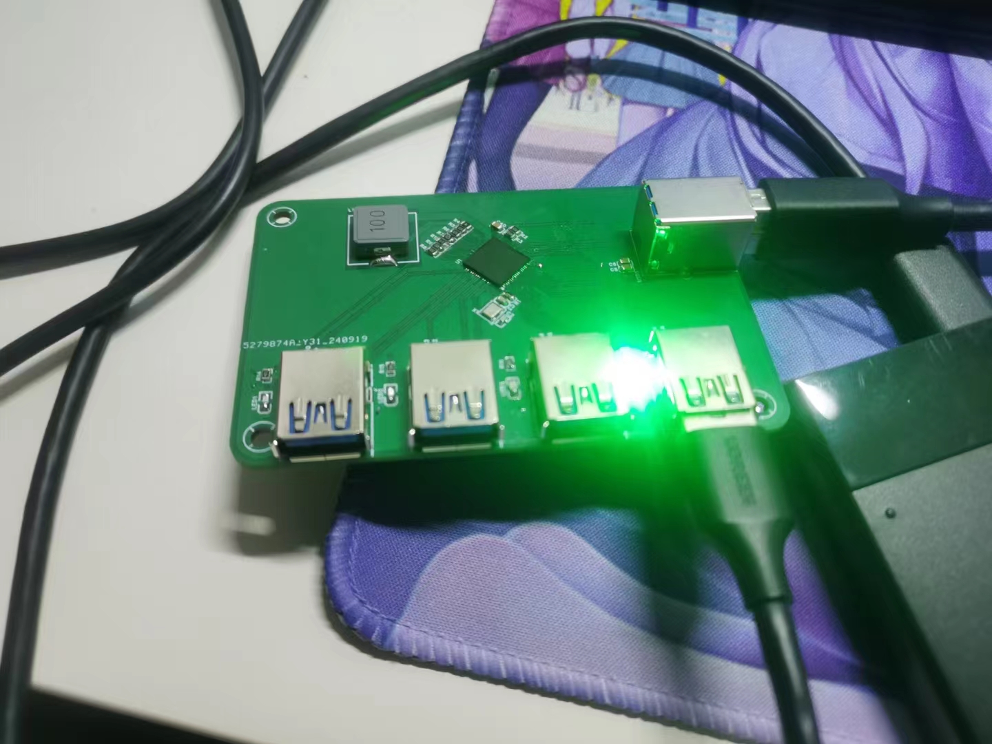

This project is a replica of the original Bilibili video above.
Physical Images :

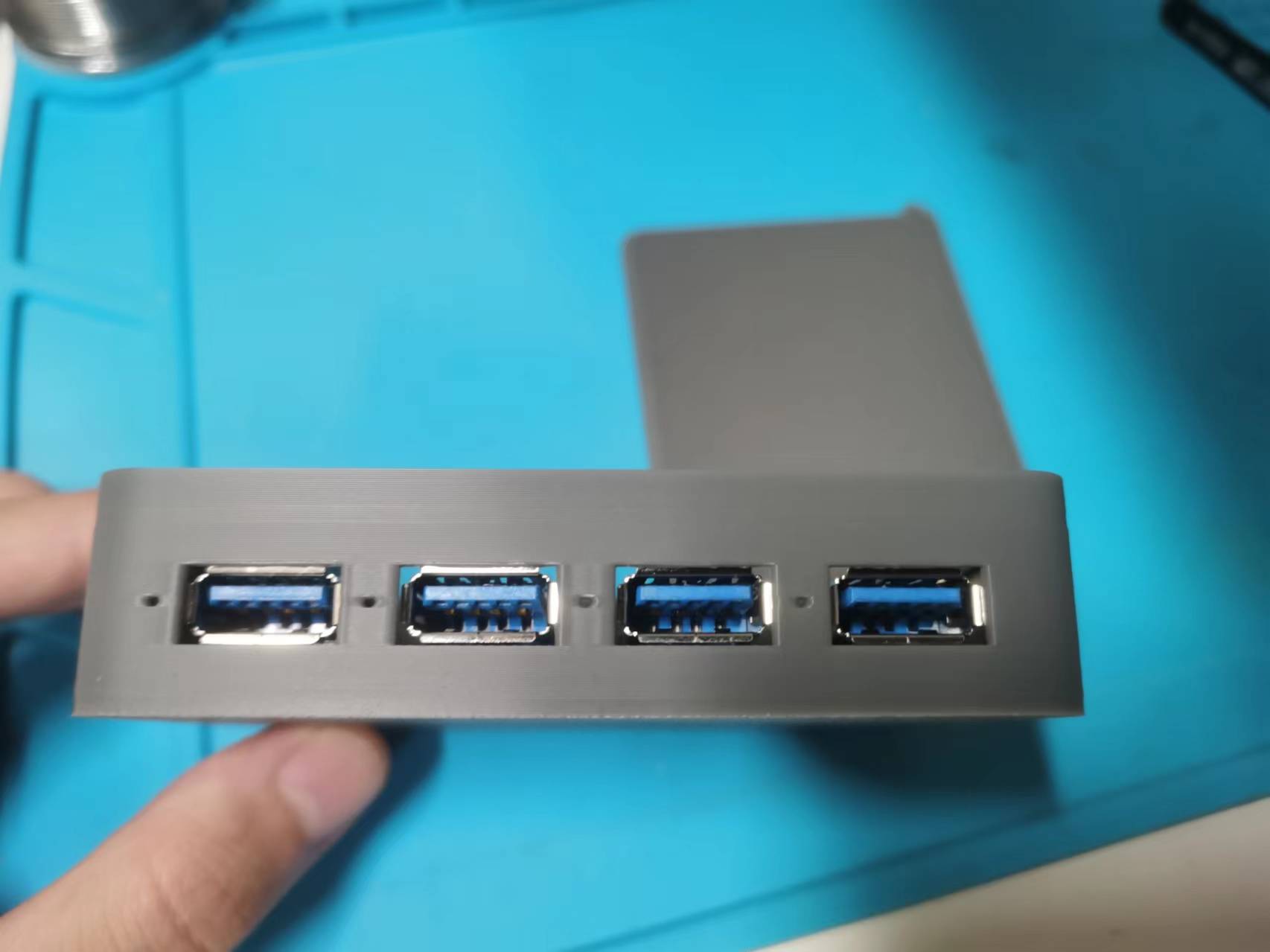

Figure 1: Soldering Completed
Figure 2: Printed Shell
Figure 3: Assembly
Figure 4: Hole Alignment Perfect

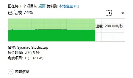

Figure 5: Read/Write Speed ​​is also Acceptable
Overall, it's a successful replica.
Notes :
1. I used that large inductor for the 1.2V section because I happened to have it, so I used that package. Replicas don't necessarily need to use the same one.
I didn't use Type-C because I'm too inexperienced to solder a 24-pin connector (sad).

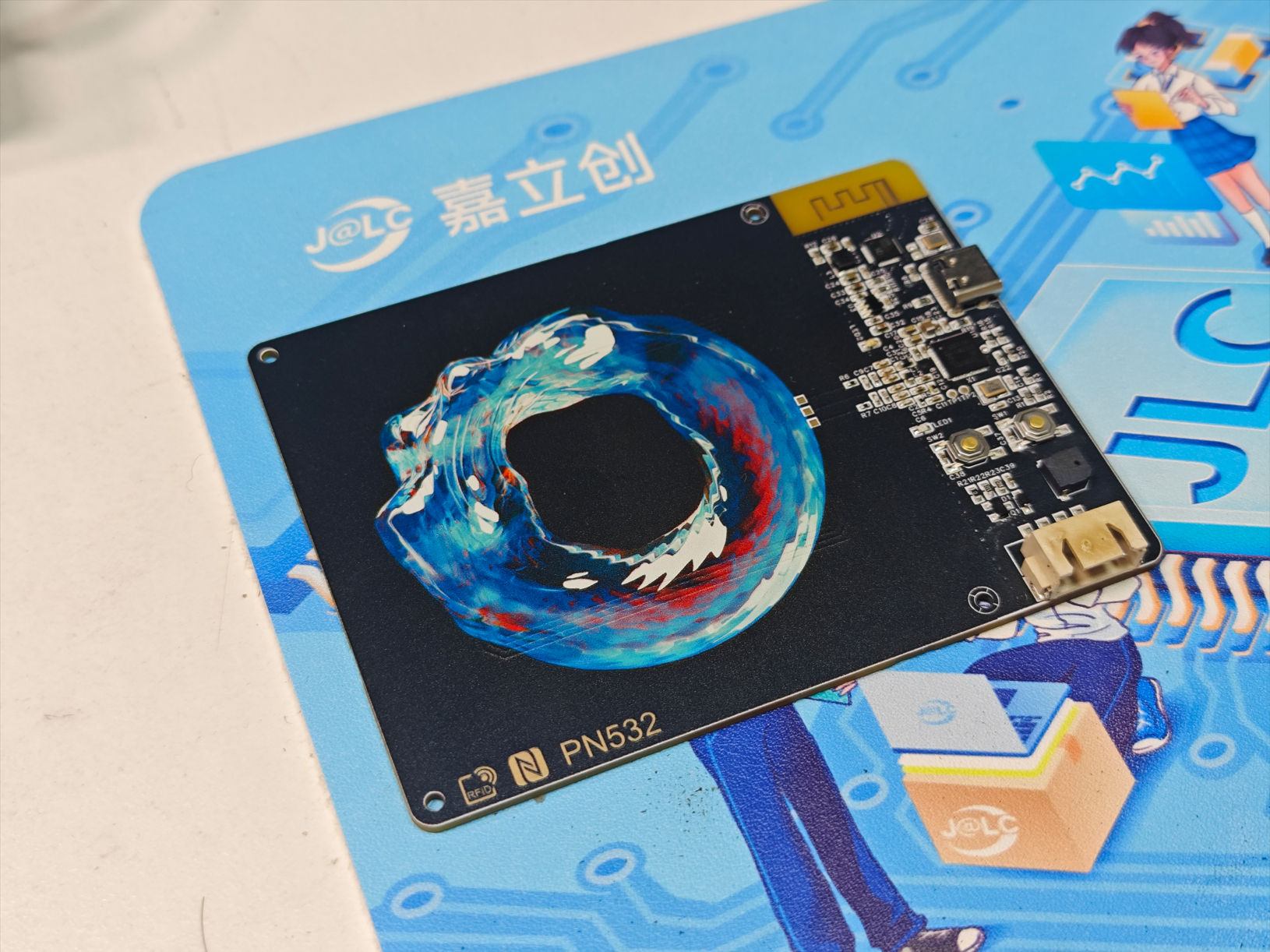

Color silkscreen PN532 CH582 NFC card reader

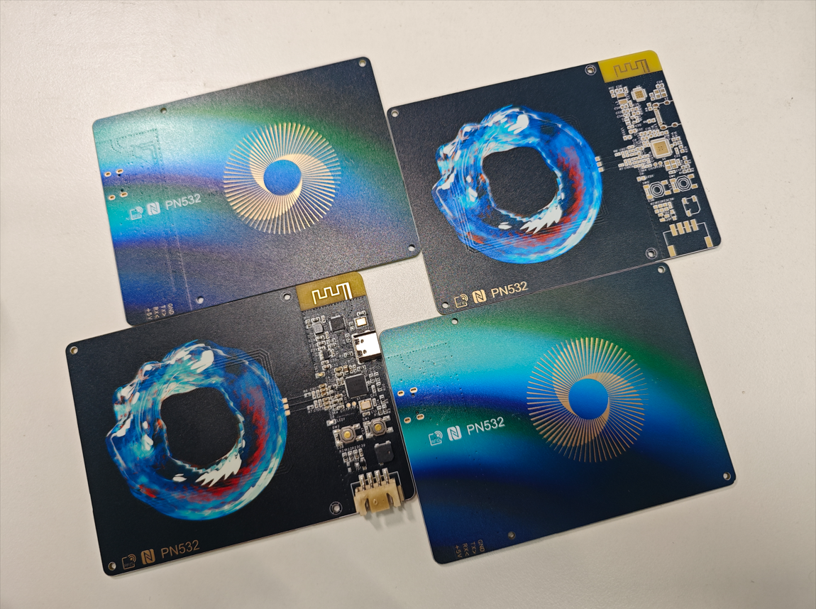

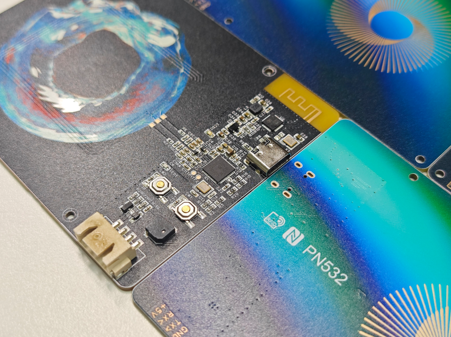

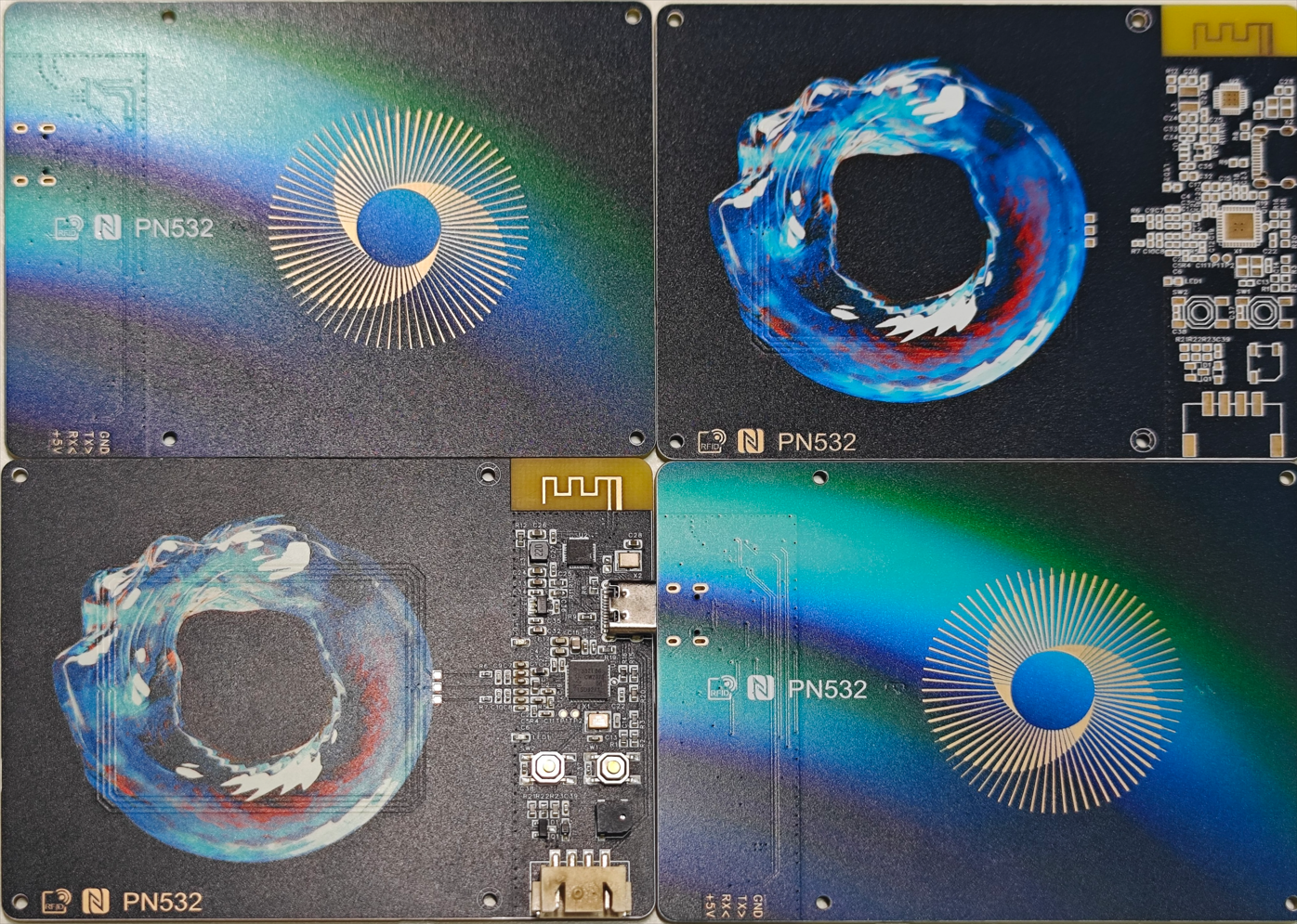

The PN532 NFC card reader with CH582 uses JLCPCB's color silkscreen printing process and can connect to a host computer via USB serial port, simulated keyboard, or BLE, or be used to develop serial screen applications based on CH582.
In August, I received a free color screen printing voucher from JLCPCB. Seeing that most color screen printing projects on the JLCPCB open-source platform were microcontroller core boards or simple NFC cards, I designed this PN532 + CH582 card reader to make the most of this voucher (it needed both circuitry and a large area for color screen printing). Other PN532 projects on the JLCPCB open-source platform either directly expose the PN532's serial port or add a CH340, requiring dedicated host computer software. This project adds a CH582 to the PN532, allowing connection to a host computer via USB CDC serial port or BLE, or direct interaction between the CH582 microcontroller and the PN532. It also exposes a four-wire XH2.54 interface for serial displays, enabling the development of more applications.
The circuit design
uses the NXP PN532 chip, supporting multiple protocols such as ISO14443A/B, FeliCa, and NFCIP-1. It supports card reading, writing, and card emulation functions
, connecting to the main controller via UART, SPI, and I2C interfaces. This project uses a UART interface to connect to the CH582.

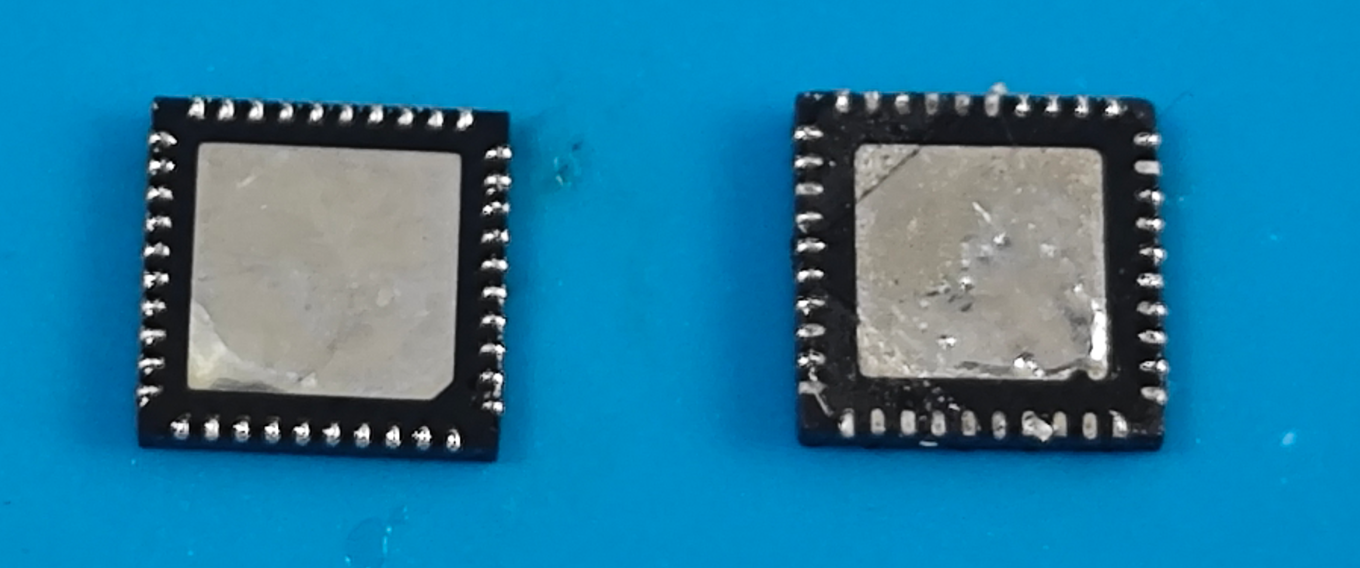

The PN532 chip on Taobao costs around 9 RMB, but there's a risk of counterfeit products (even from highly-rated shops) being unusable. It's recommended to buy a pre-built module for around 10 RMB and disassemble the chip.
The left side shows a usable PN532 chip removed from a PN532 module; the right side shows a 9 RMB chip from a certain shop, with obvious signs of polishing and solder oxidation, unusable on the board. Note the different shape of the bottom heatsink pad in the lower right corner. For debugging, test the 26-pin RSTOUT_N test point. After the chip completes reset, it should be 3.3V; if it remains at 0V, the chip or crystal oscillator is faulty.
The antenna matching circuit layout references NXP's AN10688, and the capacitor and resistor values ​​are based on yizhidianzi's engineering specifications. The measured sensing distance is approximately 4-5cm.
The PN532 crystal oscillator frequency is 27.12MHz, a less common model. Note that
the WCH CH582F low-power Bluetooth MCU chip has 32KB RAM and 512KB Flash, and two USB FS OTG controllers.
Only one USB port is actually used; it can be replaced with CH573F or CH571F, but the price is similar, around 2-3 yuan.

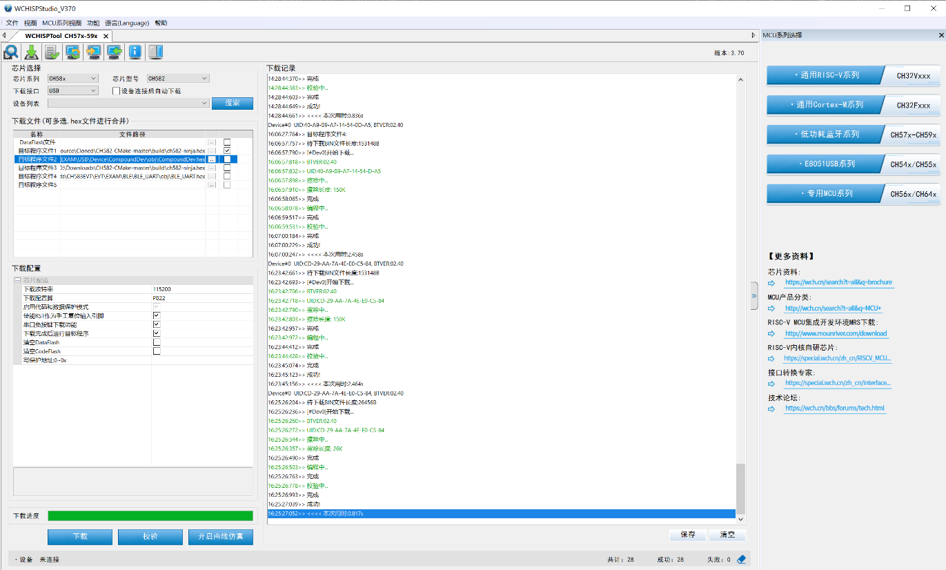

Firmware can be downloaded directly via USB without a programmer: Install WCHISPStudio, press and hold the SW1 button while inserting the USB into the computer, then select the firmware file in WCHISPStudio and click download.
The two-wire simulation interface is brought out to the SBU pin of the Type-C interface according to the project's scheme. Although there is currently no suitable debugger, the debug interface can be manually brought out using a Type-C test board. The
BLE antenna design is related to the board thickness. This project uses a 1.6mm board thickness.
The board is equipped with an MLT-5020 buzzer, which can be controlled by the TMR0 PWM output of CH582.
The color silkscreen image is from Unsplash and can be used for free commercial purposes. Front image, back image.
The color silkscreen is not heat resistant. I used a 260-degree reflow oven for soldering, and it turned a little yellow. It is recommended to use a lower temperature.
All components are surface mount. There are no protruding insertion holes on the bottom. The board can be placed flat on the table.

. The firmware provided in this project is based on the WCH official example with simple modifications. It is relatively rudimentary. You can modify it as needed. The firmware functions are as follows:
When directly plugged into a computer's USB port, the red light illuminates, indicating that the CH582 will recognize it as a USB HID keyboard. When an ISO14443A card is detected, the blue light illuminates, a buzzer sounds, and it automatically reads the card's UID and simulates keyboard input of the UID, followed by pressing Enter, similar to the function of a barcode scanner.
Holding down the SW2 button while plugging into the computer's USB port will cause the CH582 to emulate the CH340 chip, recognizing it as a USB CDC serial port. It can be used with various PN532 serial port host computer software. Other PN532 projects on LCSC Open Source provide host computer software. The red and blue lights will flash alternately during data transmission and reception.
Press and hold the SW1 button while inserting the USB cable into the computer to enter ISP mode. You can download the firmware (the firmware is ch582-hid-cdc.hex, and the ch582-hid-cdc.zip file is the source code) via WCHISPStudio.
I tried using WCH's BLE serial port pass-through example, and it was possible to achieve BLE serial port pass-through through the WCH BLE Tool Android APP, but it didn't appear in the MTools BLE device list. This might be due to a different Feature ID; a compatible board is needed.
