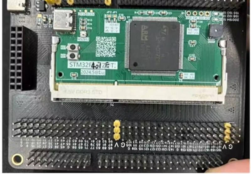

Project_DDR3 Core Board
Onboard modules include TYPEC, EEPROM, SPI FLASH, SRAM, MPU6050, WS2812, buzzer, and buttons; board
thickness 1.0mm, immersion gold finish; compatible with STM32F103Z and STM32F407Z chips via jumpers;
suitable for use with DDR core board I/O expansion board.
