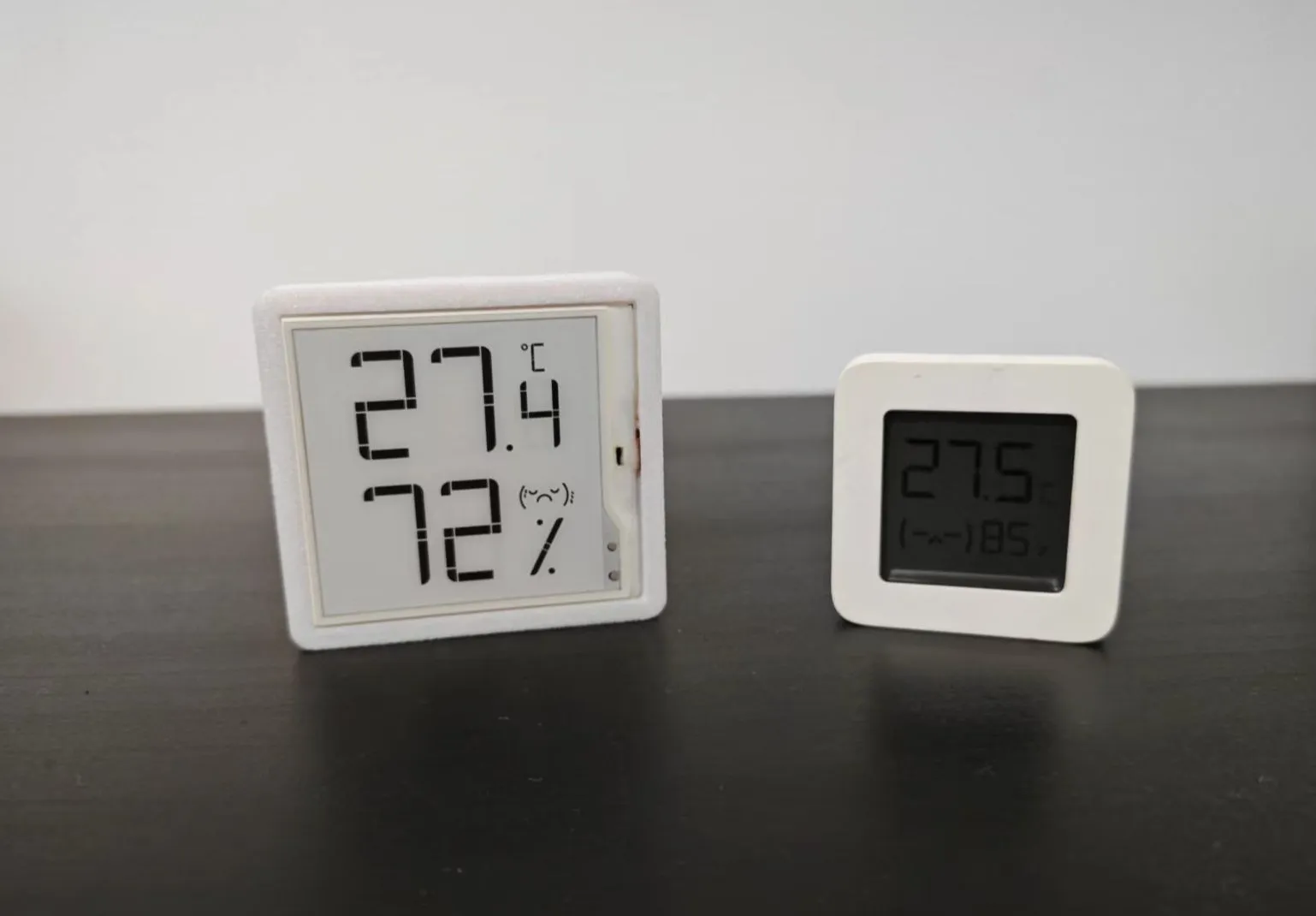

While browsing on Xianyu (a Chinese online marketplace), I found a segmented e-ink screen and bought it because it was cheap. I discovered it was the screen for a Miaomiao thermometer and hygrometer, so I intercepted its communication protocol and got it working. After that, I wanted to make something with it, and that's how this e-ink thermometer and hygrometer came about. E-
ink screens far surpass LCD screens in terms of visibility, maintaining good readability even at wide viewing angles and in low-light environments. This project uses a domestically produced CH571+GXHT30 e-ink Bluetooth thermometer and hygrometer (to cut costs, haha).

Segment E-ink Screen:
This screen displays temperature and humidity, emojis, and a Bluetooth icon. The position of each segment is marked on the diagram.
Full-screen refresh time is approximately 2 seconds, with an average current of only about 500uA. The screen requires periodic full-screen refreshes to remove residual artifacts from partial refreshes.
The partial refresh time is approximately 700ms, with an average current of only about 180uA.

The outer shell is 3D printed, and a suspended design is used to accommodate the screen in the front panel. Different materials are recommended for the support during printing to ensure a flat screen recess. I used a PLA body with a PETG support surface.
The middle PCB clamp uses an interference fit to hold the main body in place, and the back cover uses four-sided clips. However, because it's 3D printed, the lifespan of these clips might be short.
The front panel is covered with a transparent acrylic protective e-ink screen. The acrylic dimensions are 59.8mm*55.8mm, with a 7mm rounded corner diameter and a 2mm thickness, and it can be attached with UV glue. Anyway, the 3D shell isn't expensive and can be easily disassembled. Compared to Xiaomi's LCD screen, the actual product is a complete knockout.
