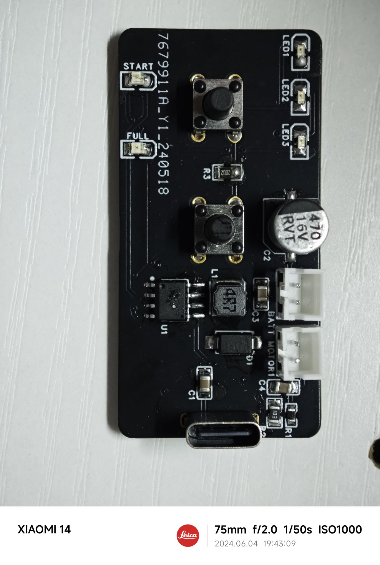

This portable, rechargeable fan features three speed settings and is powered by one or two 18650 batteries. It uses the LP78070F motor driver chip. It has five LEDs, three speed indicator lights, two charging indicator lights, and two touch buttons: one for speed switching and the other for reset. The power supply and motor interface use a 2mm pitch PH2.0 female connector for easy connection and maintenance.

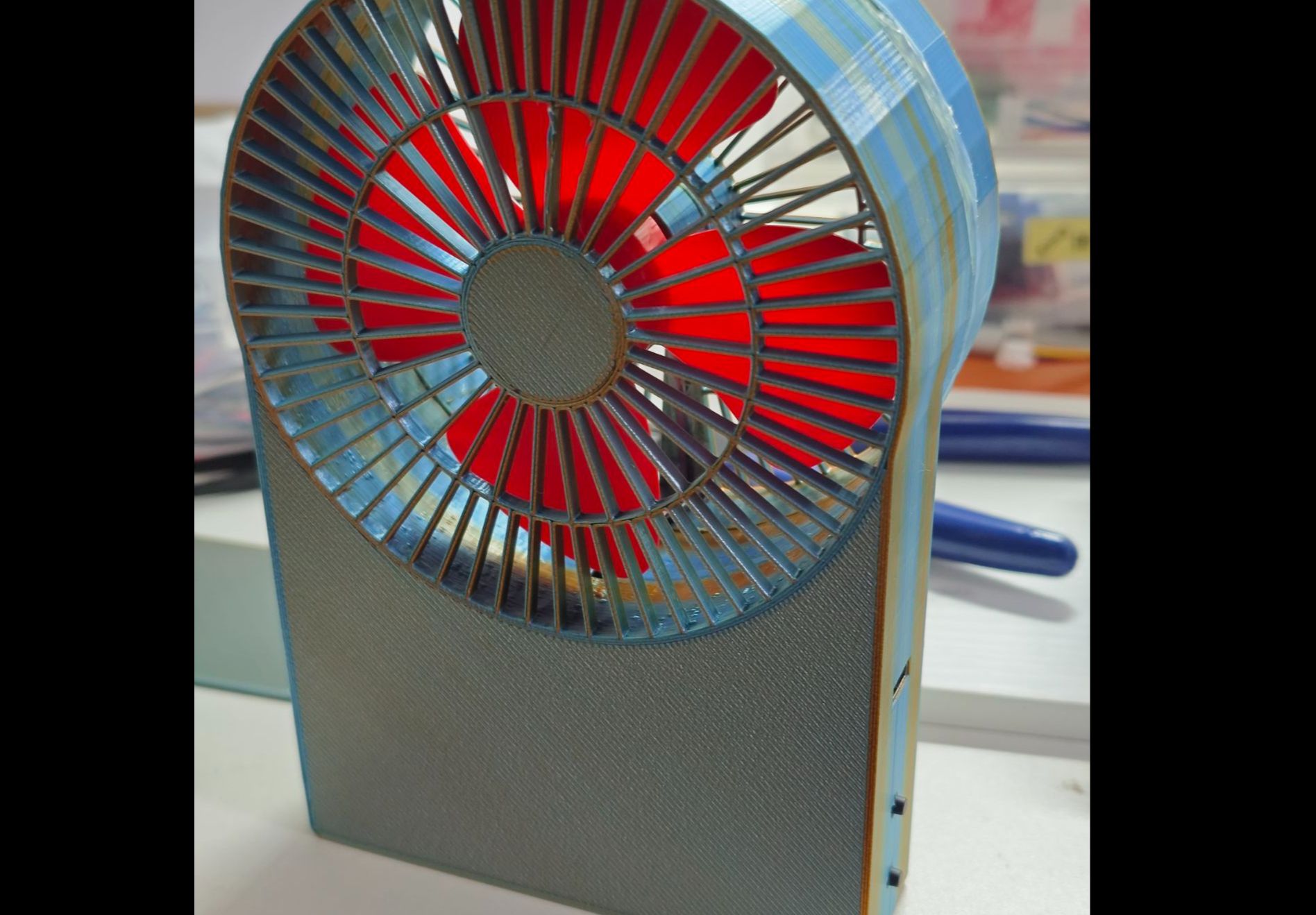

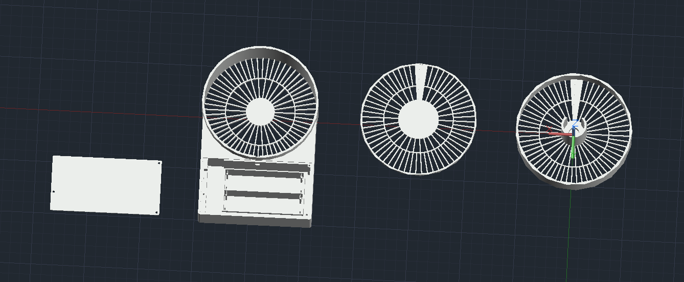

The overall structure was modeled in AutoCAD and manufactured using a 3D printer with PLA filaments. Two motor base models are available: a flat-bottomed brushless motor base and a standard 130 motor base.
The 3D-printed fan blades were too rough, so they were purchased from Taobao; the default blades are 100mm in diameter with a 2mm aperture.
The 18650 battery holder is built-in using a model and connects to the battery using 18.5*16.5mm spring contacts. The two batteries are connected in parallel, allowing for the use of one or two batteries.
