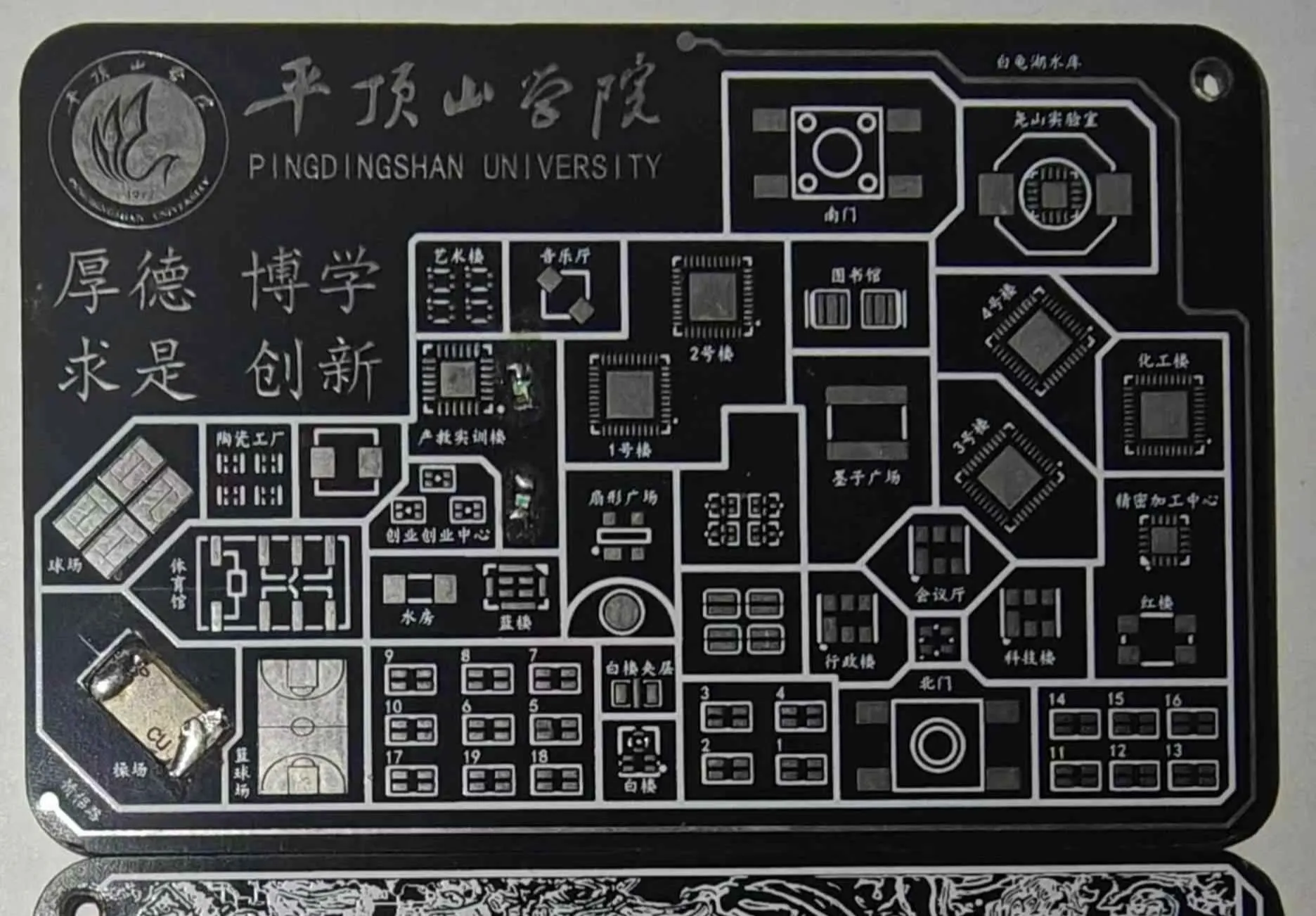

Campus Map + Black Monkey NFC
The LEDs use surface-mount 0805
chips with a CUID chip
principle: a coil scans the phone, generating alternating current. The two LEDs are connected in parallel (note: the positive and negative terminals of the two LEDs are placed in the same position in the circuit). The two LEDs alternately emit light, which appears to the naked eye as if both are lit. The first board
is 1.2mm or 1.6mm thick
, featuring a school theme and a rose design. The
second board is without NFC, featuring a school theme and a Black Myth: Wukong design. The
third APK is NFC Tools Pro software.
The process is: Task - Add Task - Application - Application - 111 - OK
. [Images: ![26d29ec61938d3a43f6a4296bbcdd63.jpg]
