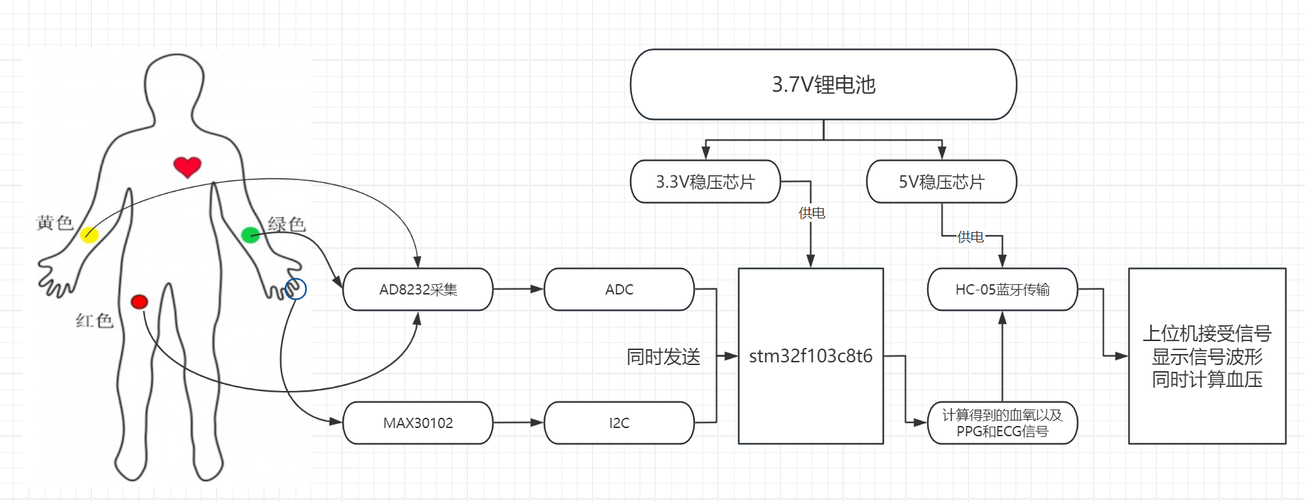

Requirements analysis
necessitates portability, requiring battery power and wireless transmission; therefore, a 3.7V lithium battery was chosen. The operating current is below 20mA, while the main control chip requires 3.3V power and Bluetooth requires 5V power; therefore, LDO-type voltage regulators were selected, providing 3.7V to 3.3V and 3.7V to 5V conversions respectively. The AD8232 chip was chosen for ECG signal acquisition due to its stable output and low power consumption. The MAX30102 digital pulse wave sensor was selected for PPG signal measurement, acquiring pulse waves through frequency division dual-wavelength acquisition. An ADC is used to receive analog signals from the AD8232, and I2C communication is used to receive digital signals from the MAX30102. Wireless transmission is required, hence the choice of Bluetooth HC-05. The host computer needs to display ECG and PPG waveforms while performing digital filtering, peak recognition, and other computational processing; therefore, MATLAB AppDesigner was selected.
Overall Design Scheme Block
Diagram Schematic Design Description

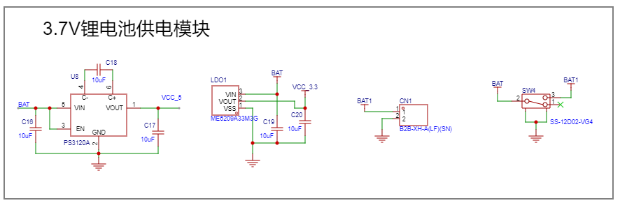

Power Supply Module
: Powered by a 3.7V lithium battery, with a direct-plug connection for easy battery replacement or charging. A sliding switch controls the main power supply. A 3.7V to 3.3V chip provides a 3.3V output to power the main control chip; a 3.7V to 5V chip provides a 5V output to power the Bluetooth module. Note the common ground handling in the circuit.

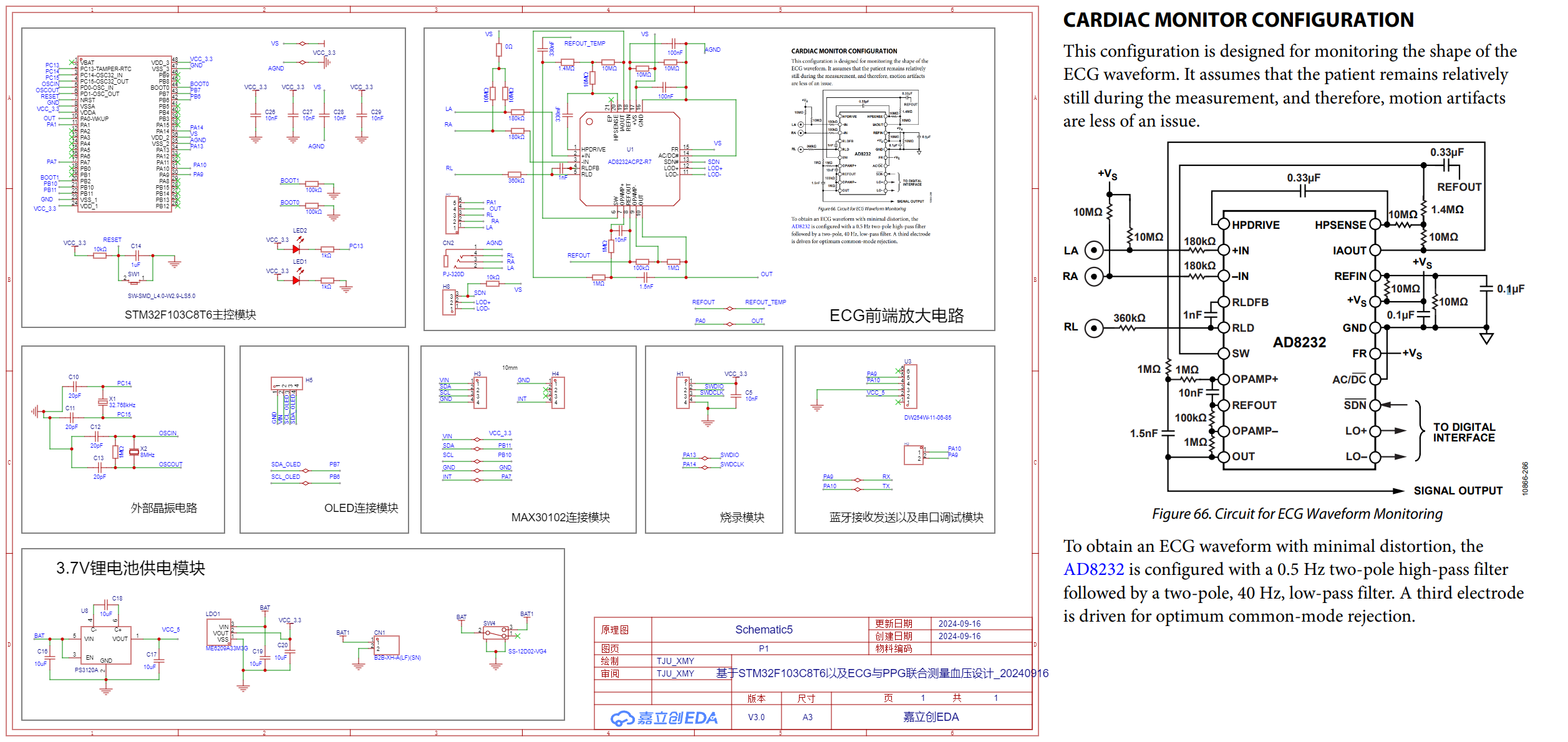

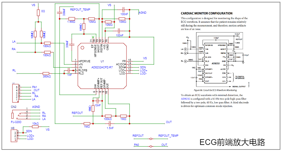

2. ECG Acquisition Module:
The AD8232 is used as the ECG front-end acquisition module. Design this part of the circuit according to the AD8232 datasheet (as shown in the right figure). Note that a pull-up resistor needs to be set to a high level on the SDN+ pin to start the chip. The headphone jack is used to connect to the ECG leads. Spare connection pins and circuit test pins are reserved. For detailed data such as the specific frequency response of the AD8232, please refer to the complete AD8232 datasheet.

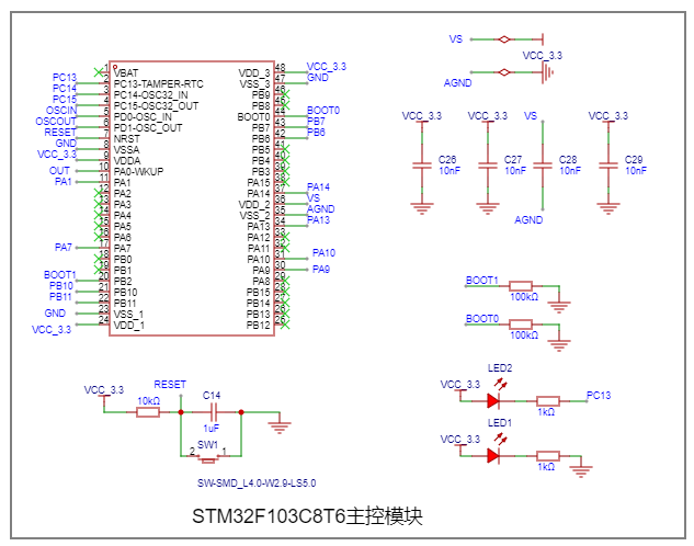

5. Main Control Chip:
The main control chip is an STM32F103C8T6. When powering on, ensure the decoupling capacitors are connected to the power supply and output ports of the four chips respectively; ensure a reset button is provided; this program only uses the dual-BOOT low-level programming method, therefore no jumper cap is provided. If additional programming and debugging methods are required, please reserve pins and jumper caps for the dual-BOOT; reserve programming pins and serial port pins for wired connection to facilitate program programming and debugging; ensure the required chip pins and corresponding connections are set correctly, and disable unnecessary pins.

The complete schematic diagram is shown below.

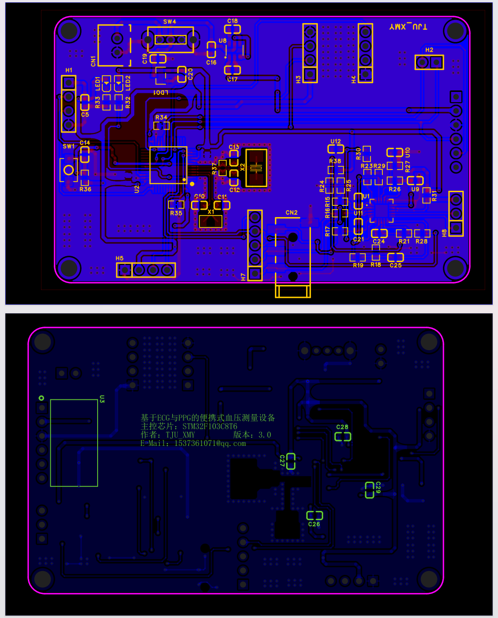

PCB Design
Notes: This section includes some PCB design notes, such as PCB layout, routing, trace width, spacing, etc.
Power Supply Module
: Although this design is for low power consumption, the power supply module, as a main circuit, should ideally have thicker traces. Most power lines are 24 miles wide. Due to the limited spacing of chip pins, the power lines connected to the chips gradually transition from 10 miles to 24 miles.
Signal Lines
: All lines except power lines are signal lines, and all signal lines use a 10-mile trace width.
Vias
: All electrical connection vias have an outer diameter of 24 miles and an inner diameter of 12 miles. The positioning vias at the four corners of the PCB have an outer diameter of 4 mm and an inner diameter of 3 mm.

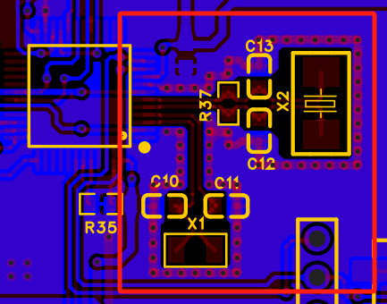

Crystal Oscillator Circuit :
Since the crystal oscillator section contains high-speed signals, its routing should be differential signal lines. Vias should be used around it, with the diameter of the surrounding isolation vias being 24 miles outer and 12 miles inner. The vias are connected to the ground plane, and the internal crystal oscillator area surrounding the vias is designated as a copper-free zone (this zone should not be limited to the top layer but should be multi-layered, i.e., all layers). No copper pouring is applied to this area to isolate high-speed signals from low-speed signals.

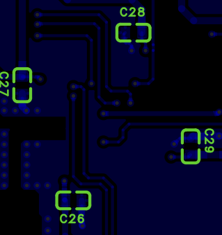

5. Decoupling Capacitors
: Decoupling capacitors should be connected according to the spatial structure of the schematic. For example, the decoupling capacitors for the four power pin pairs of the STM32F103C8T6 need to be installed near each power pin pair, as shown in the figure.
6. Copper Pouring
: GND vias should be used effectively to achieve full copper pouring, especially in areas with complex signal lines. Copper pouring near signal lines can reduce external interference and improve signal stability.
7. Cross Connections and Teardrop
Routing: Orthogonal routing should be used whenever possible. Sharp angles should be avoided. Teardrop routing should be used for cross connections. Teardrop routing should be applied to all components requiring electrical connections, including chip pins and vias.

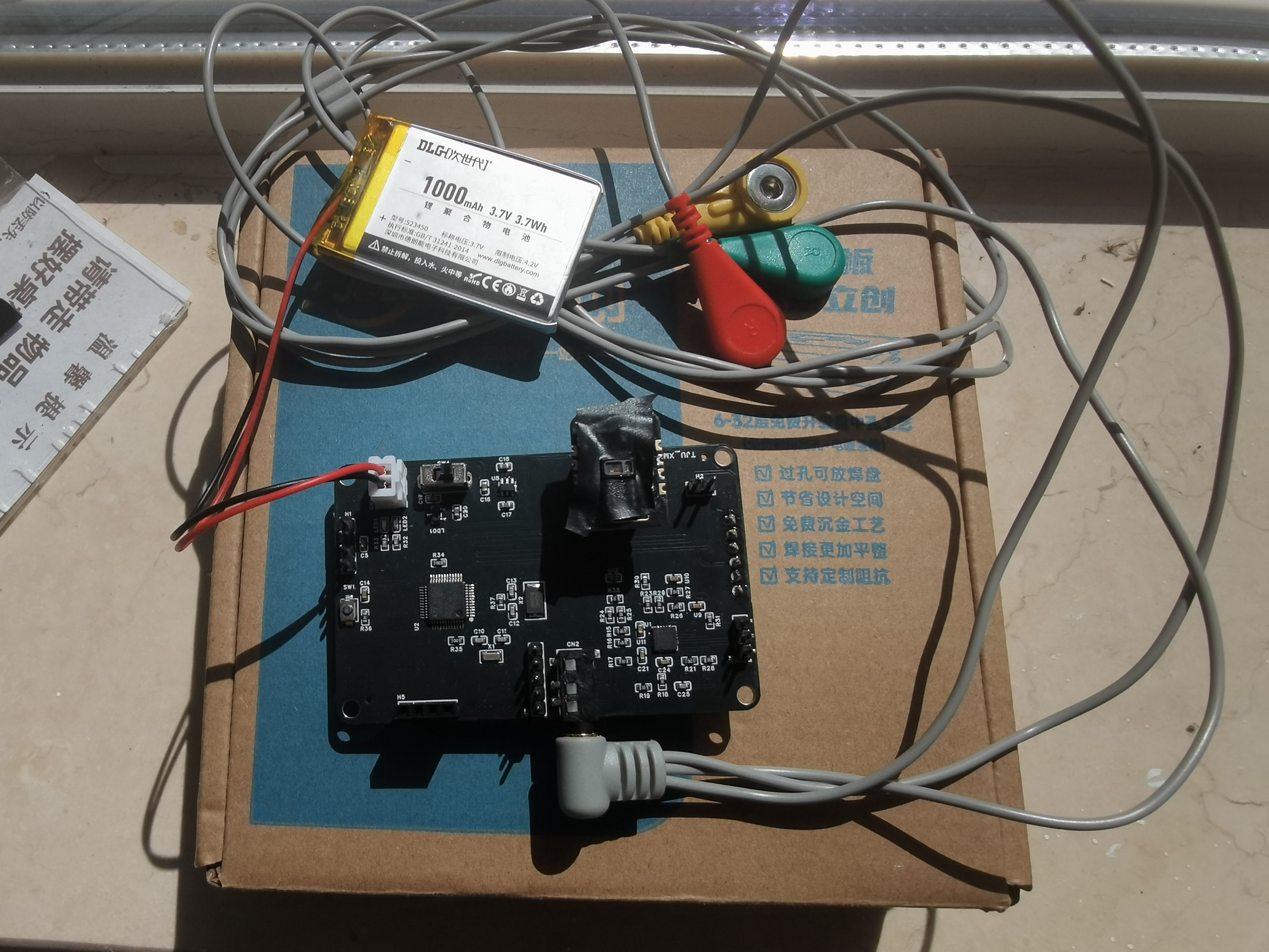

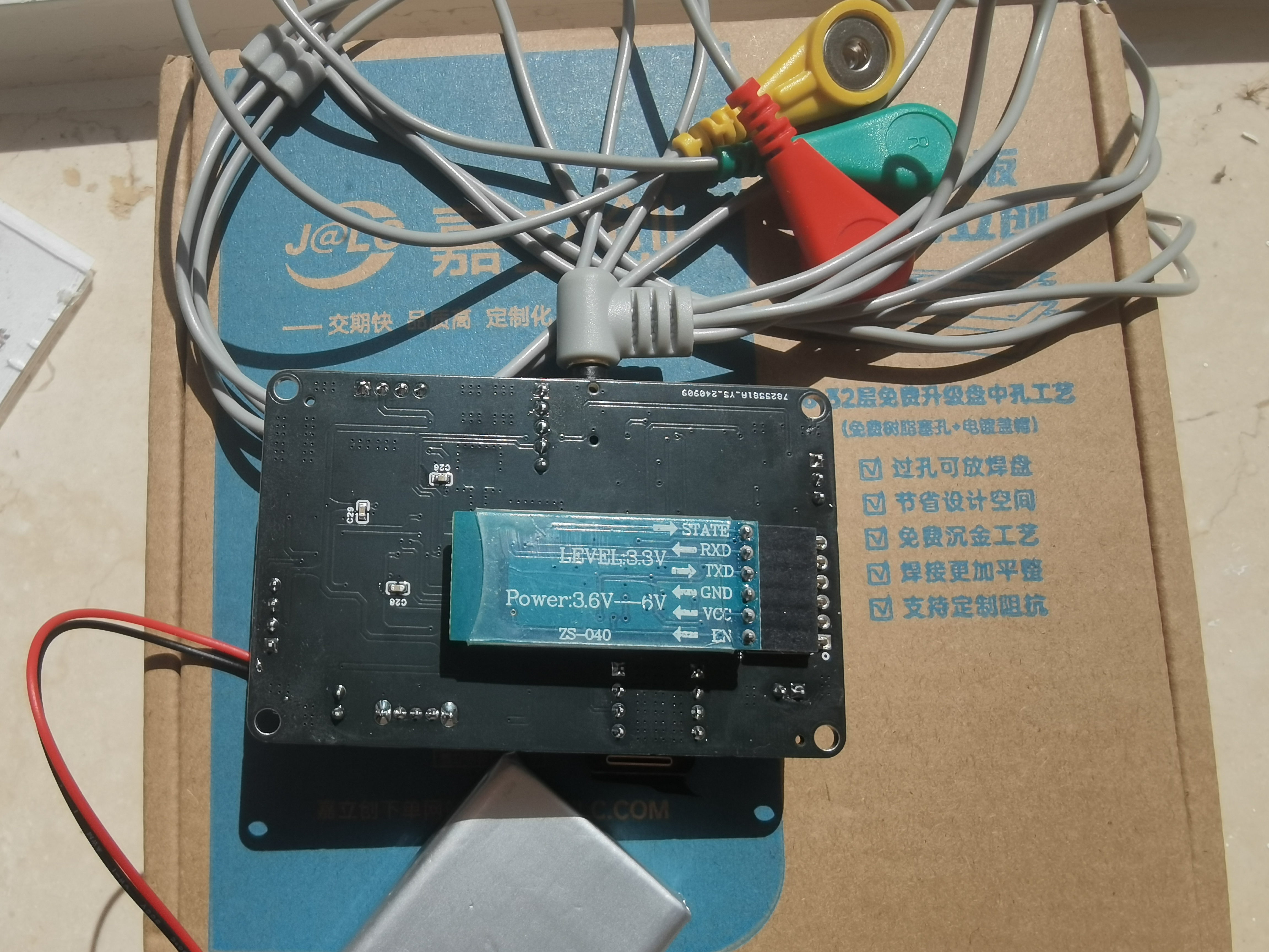

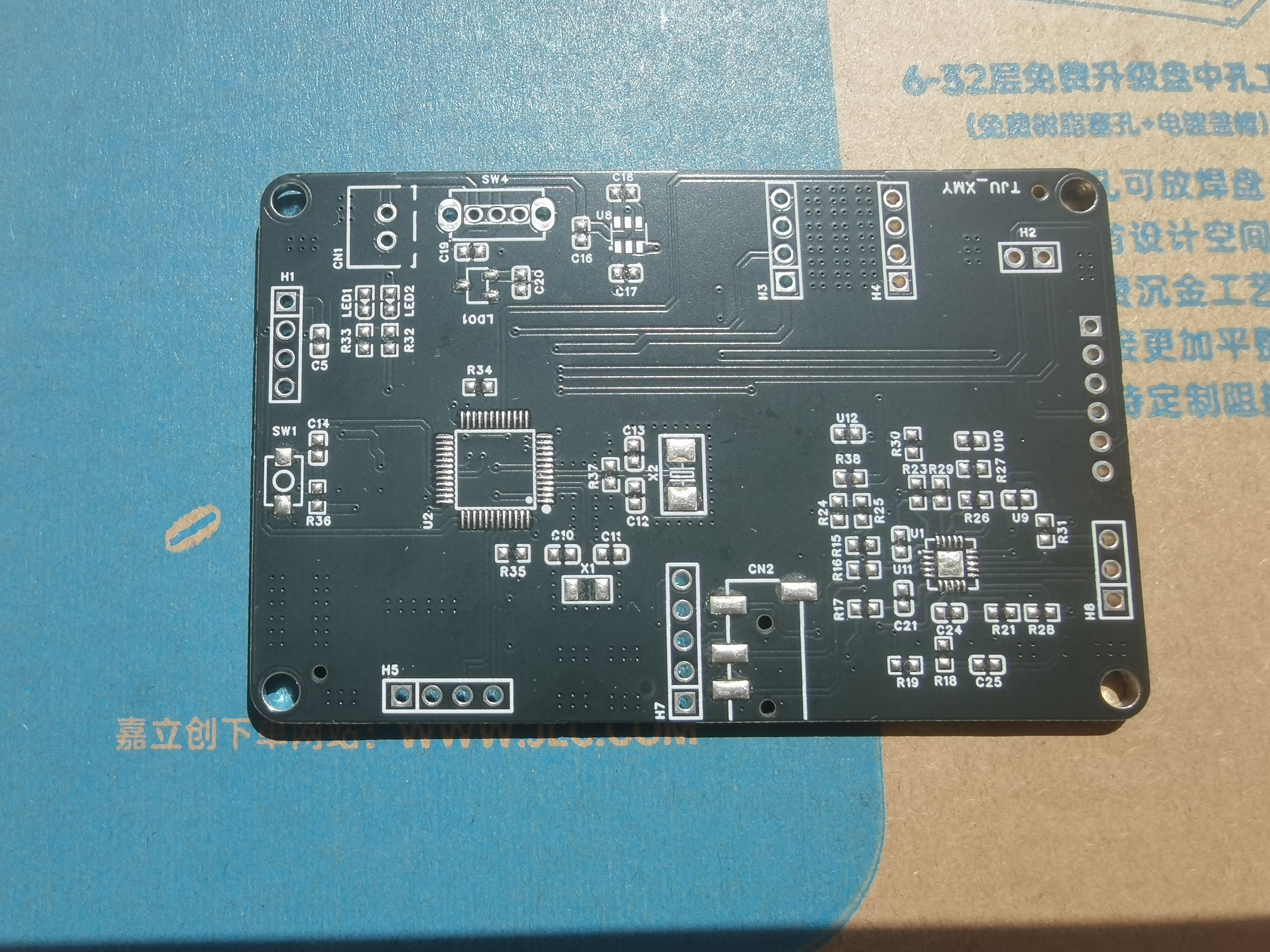

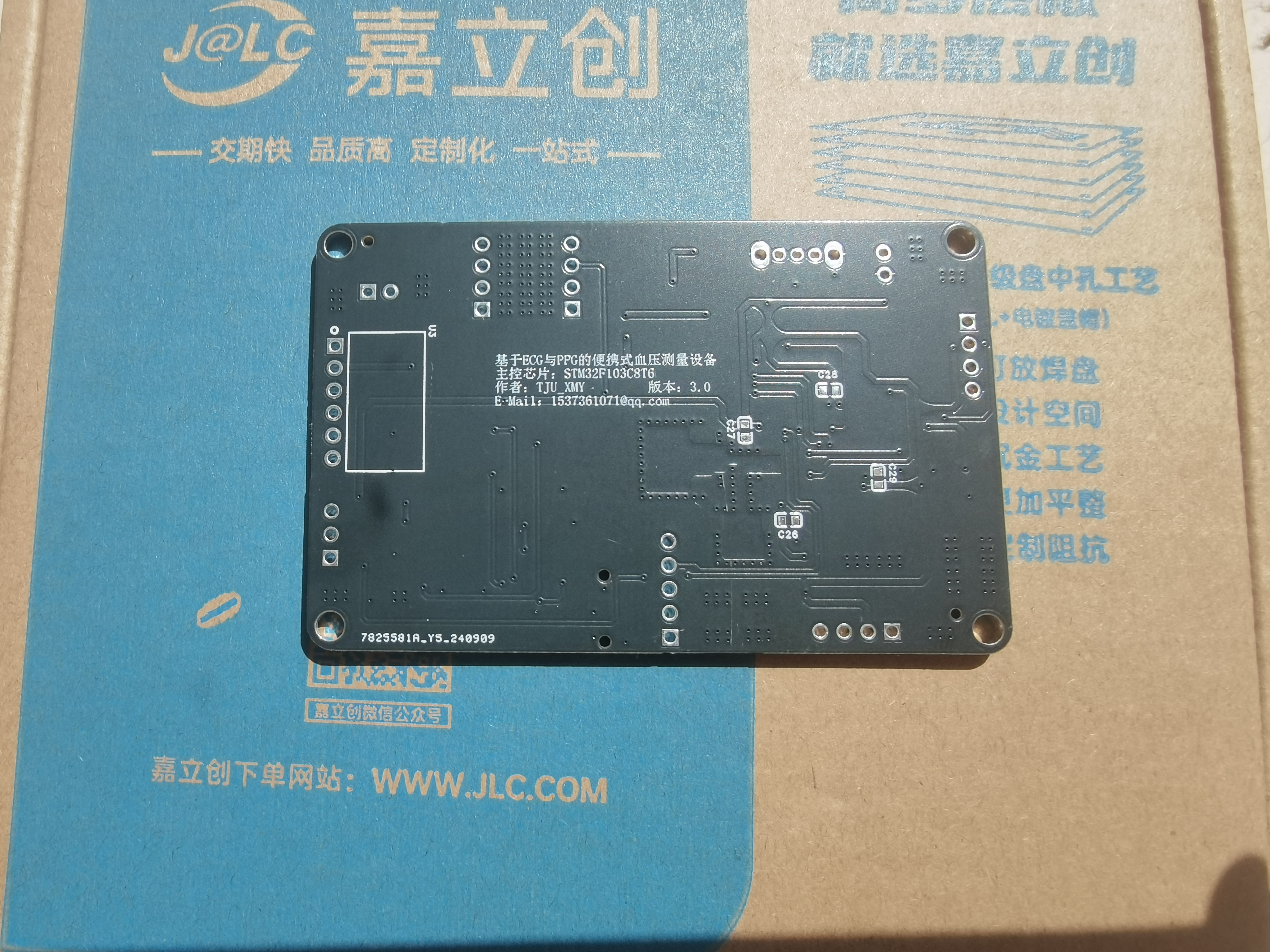

The front and back of a complete Version 3.0 PCB are shown in the following figure:

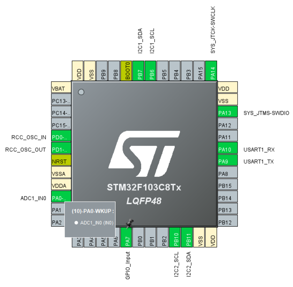

STM32F103C8T6 Programming Instructions

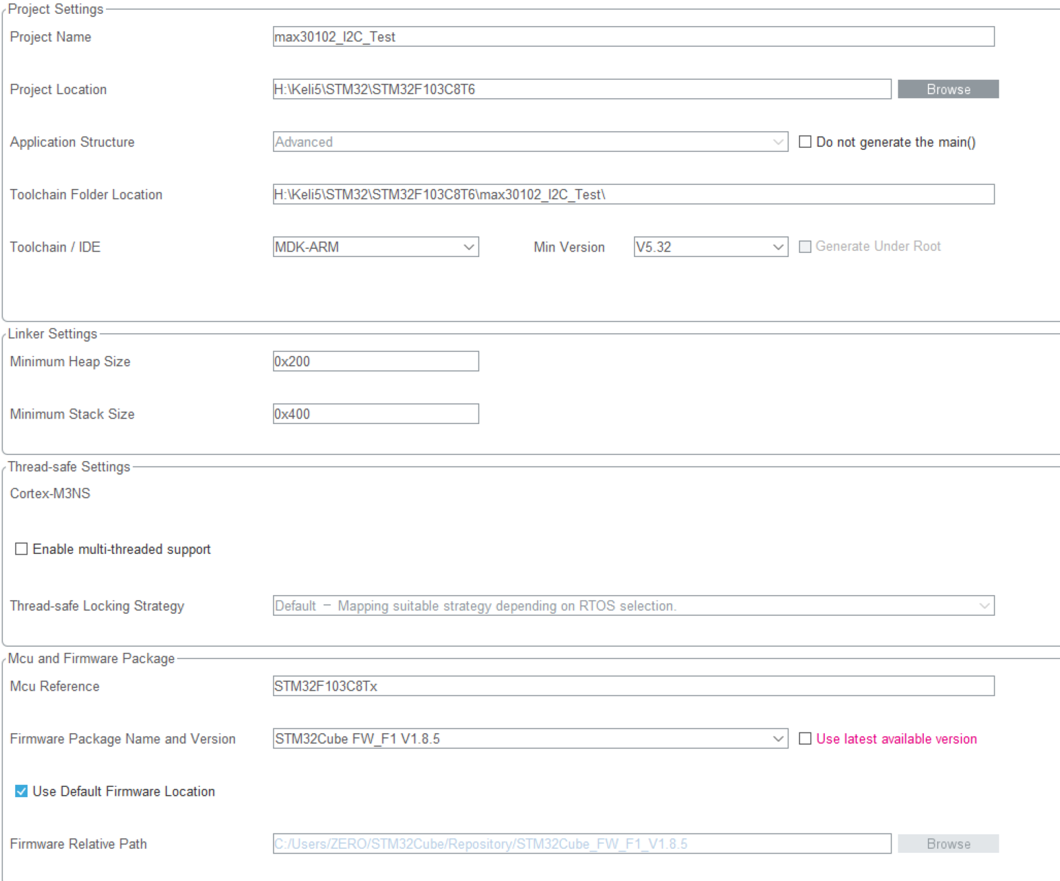

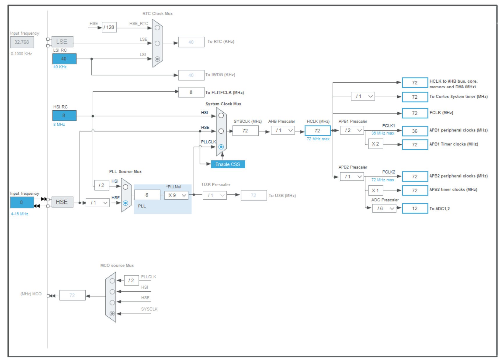

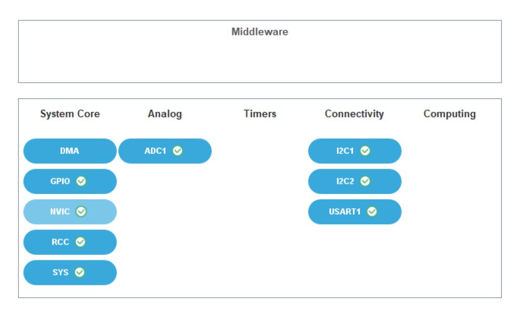

This project utilizes STM32CUBEMX for programming, facilitating basic microcontroller configuration. The CUBEMX configuration interface is shown below,
along with the clock tree.
The configuration environment is as follows:
the compilation IDE is Keil5_MDK-ARM-V5.32, the program files are primarily in C and C++, and the STM32F103's HAL library is used, which needs to be downloaded and installed beforehand.
Detailed code is omitted here; specifically, it receives data from the MAX30102 via I2C, then starts the ADC for sampling. After completing one round of calculation, it sends the data received by the ADC and I2C, along with the decoding result, via serial port before proceeding to the next round of signal reception and processing. For detailed code, please refer to the attached "PTT.zip"

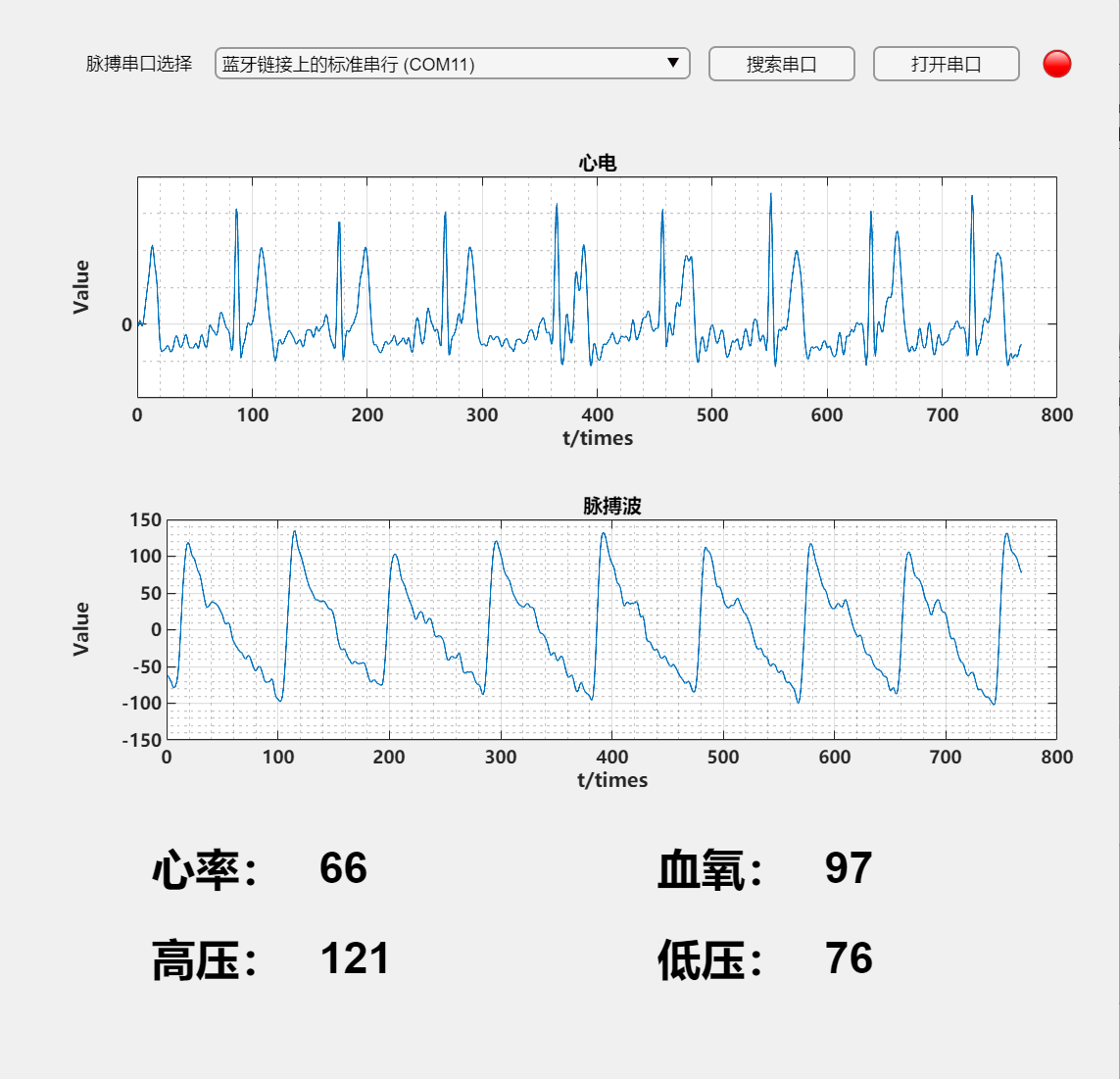

host computer program
. The host computer is written in MATLAB. Specifically, it opens the serial port to receive data sent by the microcontroller, segments it, and displays ECG and PPG separately in the coordinate area, while simultaneously displaying heart rate and blood oxygen saturation in real time. Subsequently, the two physiological signals are filtered to eliminate unwanted interference and correct baseline drift. Finally, the systolic and diastolic blood pressure are calculated using a linear fitting formula and displayed along with heart rate and blood oxygen saturation. The program code for this part will not be explained in detail here; please refer to the attached "Host Computer.zip" for details. The host computer interface is shown in the following figure:

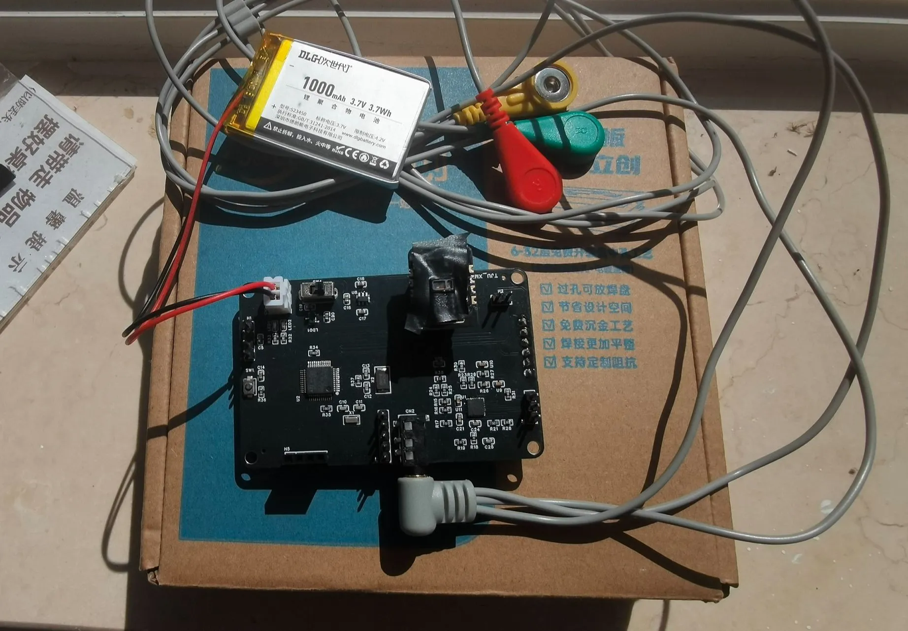

Physical Demonstration
PCB (Unsoldered)
: The front and back of the unsoldered PCB for Version 3.0 are shown in the following figures:
The front and back of the soldered and connected PCB for Version 3.0 are shown in the following figures:
Precautions
: 1. When soldering chips, to protect the chips, it is not advisable to use soldering temperatures above 300 degrees Celsius. The author used a 290-degree soldering iron and hot air gun for soldering, for reference only.
2. The MATLAB version used by the host computer is R2021a (64-bit).
3. Regarding the connection of the ECG lead wire, the connection of the right leg drive electrode does not necessarily have to be attached to the right leg; it can also be attached to the left or right arm.
4. When the MAX30102 is running, the index finger may touch the circuit components carrying electrical signals when in contact with it, which may affect the acquisition of ECG signals. Therefore, it is recommended to use insulating tape to seal the front of the MAX30102, leaving only the central LED exposed, to ensure that the index finger will not touch the circuit when placed on the LED.

After burning the program, disconnect the programmer, connect the 3.7V lithium battery and other modules, and turn on the switch. The red LED power indicator on the PCB will light up, indicating successful startup.
Turn on your computer's Bluetooth and connect it to the HC-05 Bluetooth device. Connect the ECG lead wire and attach the electrode patches. Place your finger on the LED light of the MAX30102 and remain still. After opening the host computer, select the corresponding Bluetooth serial port, click "Open Serial Port," and wait for the system response. The host computer will automatically detect whether the acquisition is complete and stop. No additional operation is required from the user. After the signal is collected, it will automatically calculate and display the filtered waveform and the blood pressure calculation result.
