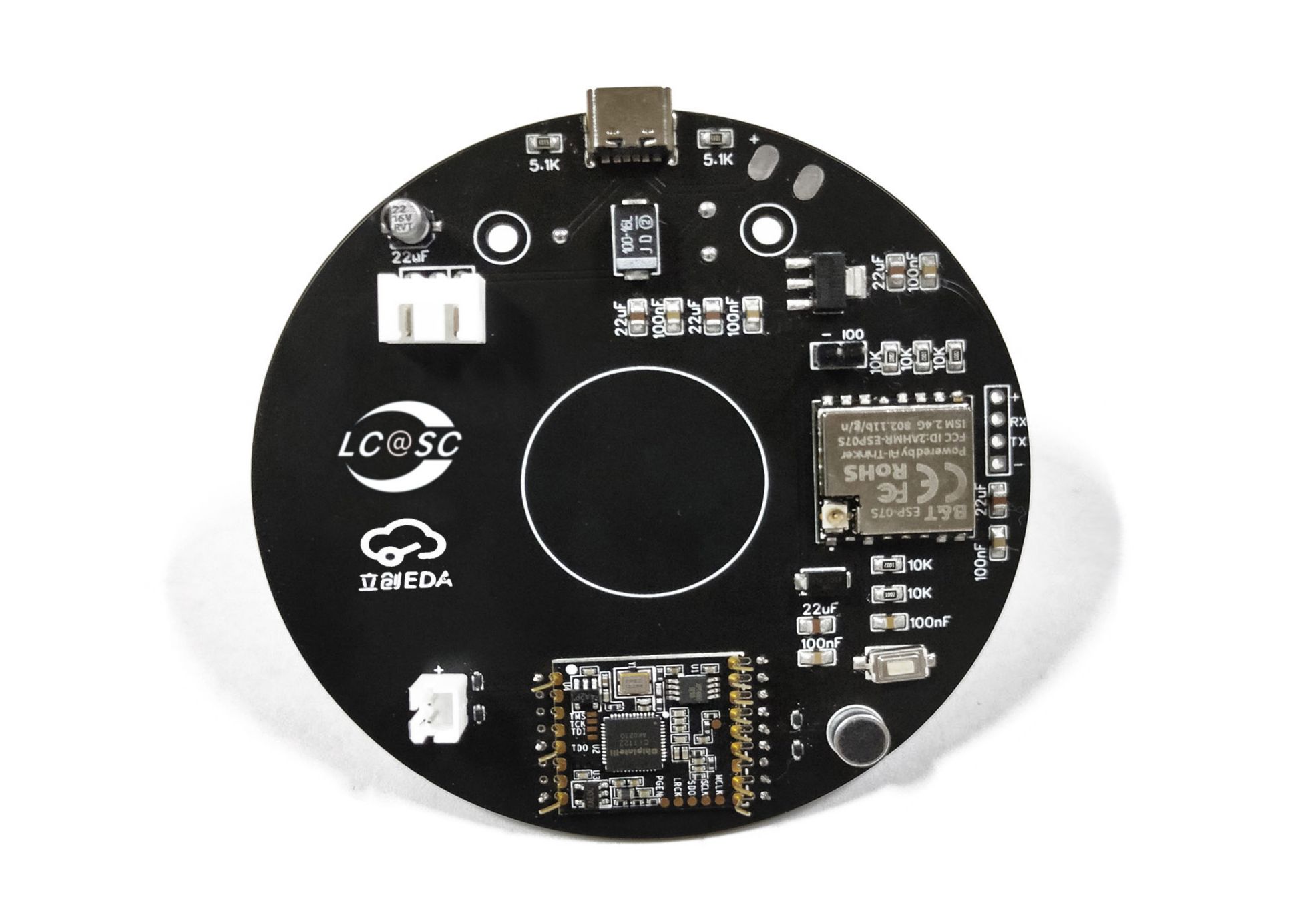

The offline voice module uses Qiyingtailun's CI-C22GS02S , and the chip is CI1122 . Test pins are used to make clips for fixation, which is convenient for disassembly. The main reason is that the module is highly playable and convenient for other subsequent tests.
The main control is ESP-07S , which is small and compact. Using Arduino for programming is very friendly to a novice like me.

Frontal photo ( the logo of the 6th Lichuang Electronic Competition and the logo of EDA )

Color control is that the offline module TX1 sends a semantic ID to ESP, using a custom semantic ID. The semantic ID of turning on the light is 0x6132. Except for the protocol part, ESP receives 0x3261, so remember to receive it in arduino when you do not change the offline voice SDK. Swap when judging data.
The volume part entries are identified through command word ID . From the command word semantic ID recognition example in the code, we moved to command word ID recognition. As for why semantic ID is not used , simply speaking, it does not ...
For the firmware production and burning of offline voice programs, please see the Chipintelli Documentation Center: https://platform.chipintelli.com/web#action=232&menu_id=193
