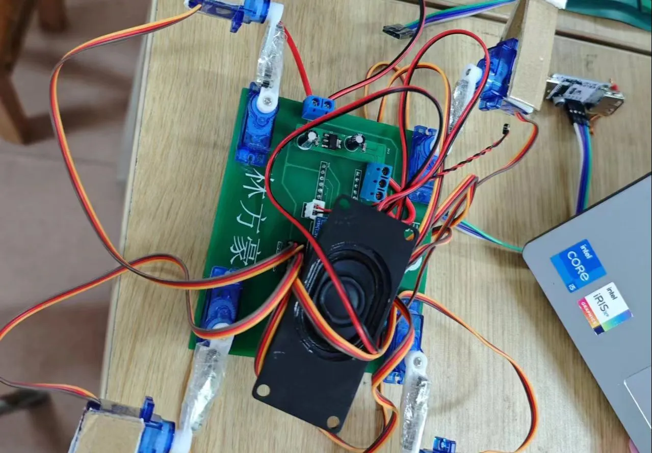

Voice-controlled mechanical four-jaw jack based on the DiKuoXing (STM32F103C8T6)
Project Overview:
This project is an extension project based on the LCSC Dikuoxing core board, using 8 SG90 servos and an ASR PRO voice recognition control module. The expansion board
for
the four robot groups has servo interfaces, a 0.96-inch OLED display interface, a voice control chip interface, a microphone, and a speaker interface; enabling voice control of the robot's movements.
Project Parameters
: 1. This design uses the LCSC Dikuoxing core board (STM32F103C8T6).
2. ASR PRO voice control module, which uses Tianwen Block programming; if you have your own components, you can integrate the module onto the expansion board.
3. Eight SG90 servos. 4.
0.96-inch display screen; the expansion board has interfaces, but this project does not currently use it.
5. AMS1117 linear regulator 5V to 3.3V circuit
principle analysis (hardware description):
I. AMS1117 linear regulator circuit:
This circuit takes a 5V power supply as input and outputs a stable 3.3V to power the microcontroller.
II. 12V power supply step-down 5V module:
This module can be purchased arbitrarily and mainly powers the servos. Note that when connecting to the expansion board, thicker wires are needed. DuPont wires cannot withstand the current after converting 12V to 5V and will burn out the DuPont wires (already tested...).
III. ASR... The PRO module
interface is on the bottom. If you want to solder it on top, swap the two pin headers on the PCB. Pay attention to the corresponding pins. See the attached
software code for notes: I. My servo motor pin connection instructions ; II. Servo motor wiring and assembly process. The legs of this quadruped robot are made of tape and glue combined with cardboard (you can 3D print them yourself if you don't want to, but I don't know how to 3D draw yet). [ Image of the actual product ]
