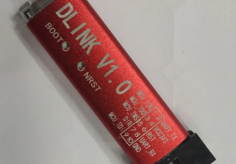

Project Parameters
This Design This design includes a GD32FV103 microcontroller, a Type-C interface, and a 10-pin JTAG connector.
This design connects to the debugger via the NUCLEI STUDIO IDE, and the debugger connects to the kernel via the JTAG interface. Debugging the kernel via an IDE.
Hardware Description:
This project consists of the following parts: power supply, main control unit, LED indicators, button control, JTAG interface, TYPE-C interface, etc.
Physical diagram
and connection diagram.

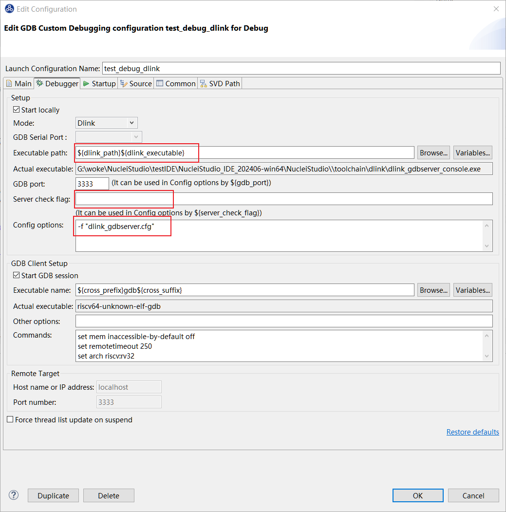

Then, configure the following in the Debugger tab. Since Custom Debugging supports multiple modes, and we now need to use Dlink, select Dlink. The Server check flag is used in NucleiStudio to confirm whether the service has started normally. In Custom GDB Server, if the service starts normally, it will output a string. NucleiStudio checks this string to confirm that Custom GDB Server has started normally. When using Dlink, this can be empty. In Config options, you need to configure the corresponding link file dlink_gdbserver.cfg. The configuration file can be found in the /toolchain/dlink directory.
DLINK Connection Instructions:
On Windows, after Dlink connects to the PC and development board, a green light and a blue light will illuminate, indicating that Dlink is working normally. Otherwise, it is not working properly; you can try resetting it by pressing the NRST key.

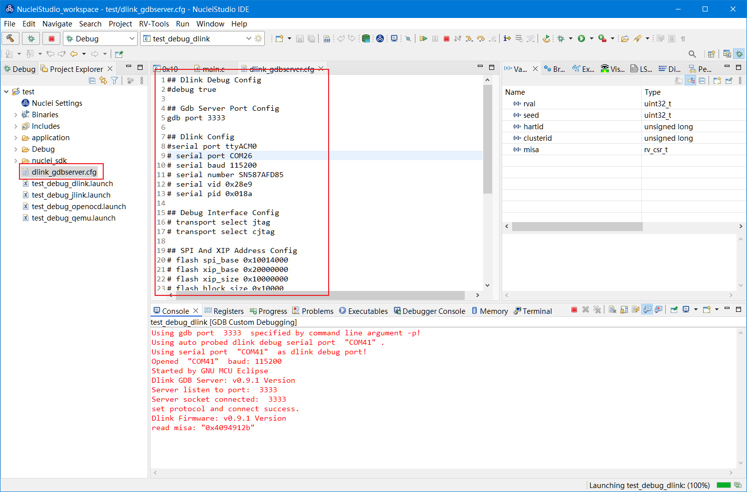

gdbserver.cfg File Configuration
After connecting to D-Link, you'll see two COM ports in the serial port tool. One COM port is used for serial output; generally, the COM port with the lower number is for debugging. The other is used for serial data exchange. Users need to specify the COM port used for data exchange in `dlink_gdbserver.cfg` and configure the serial port and serial baud. For example, on Windows, `serial port COM1, serial baud 115200`; on Linux, `serial port ttyACM0, serial baud 115200`. If the user doesn't configure this, D-Link will use the COM port with the smaller number as the default serial port and its corresponding device number as the default serial baud. For Windows, you can refer to the following configuration:

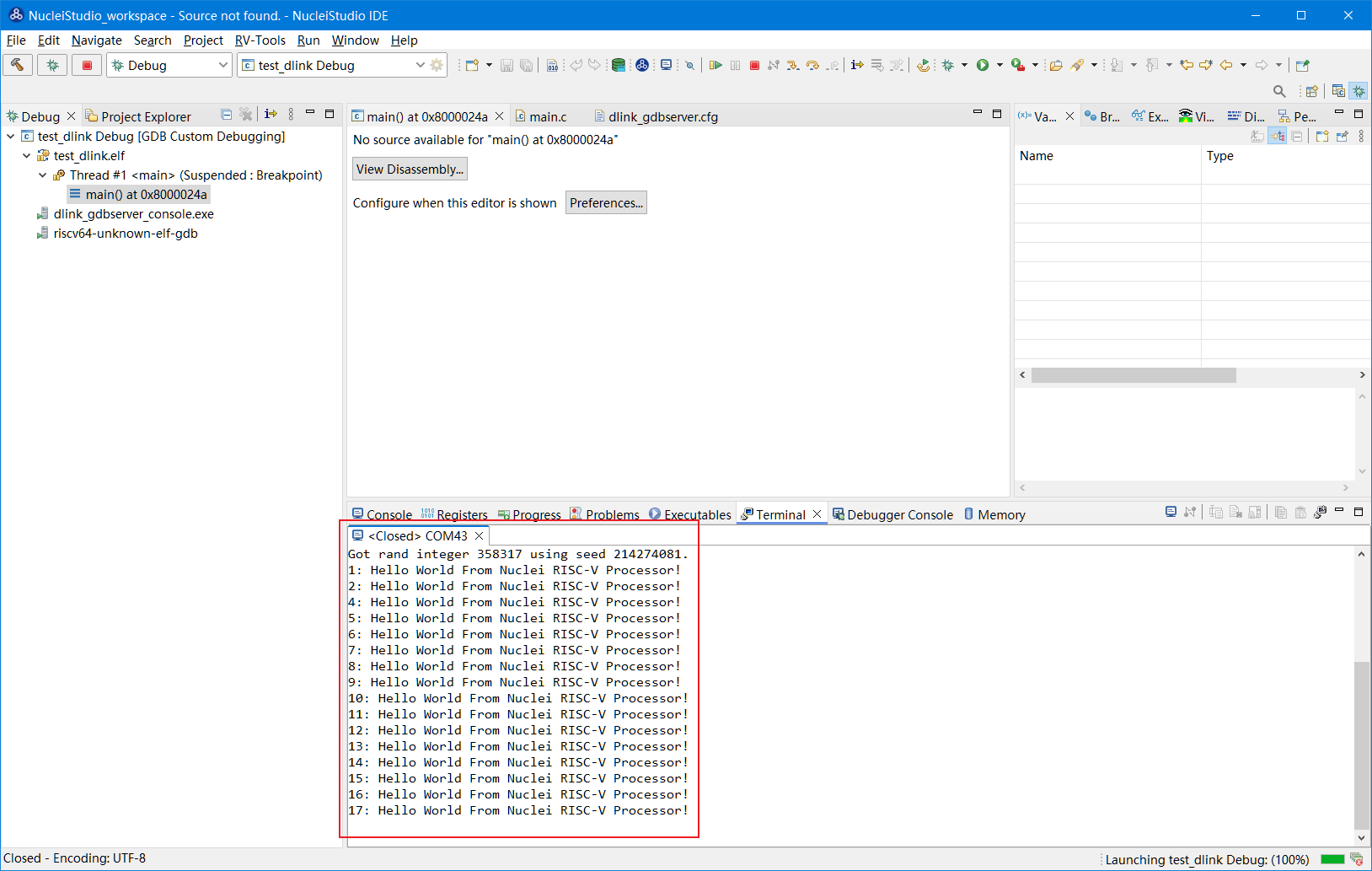

Start debugging. If the configuration is correct, the Console will output as shown below, and the D-Link indicator will light up green.
Connect to the other serial port using the serial port tool. If you can see correct output in the serial port, consistent with expectations, then D-Link can debug normally. Other operating steps are largely the same as OpenOCD.

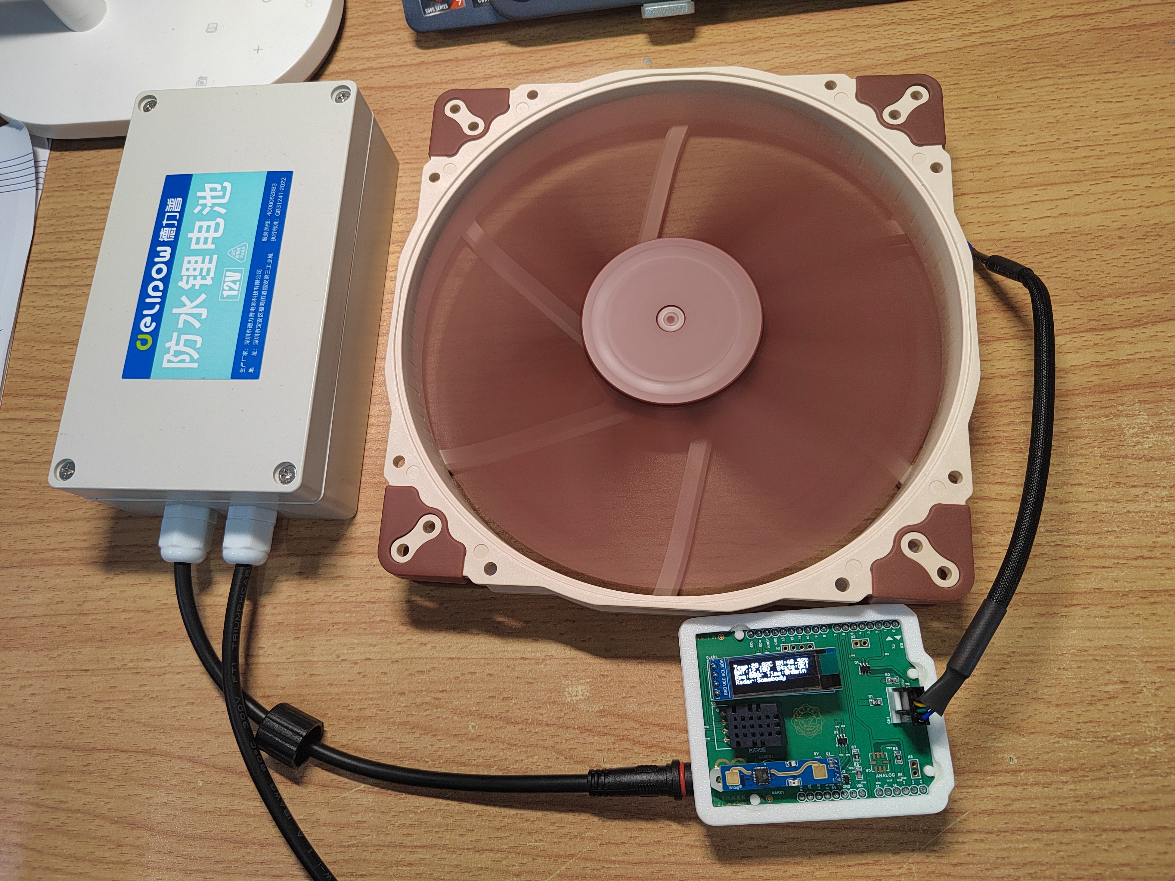

I built my own exhaust fan for the dormitory toilet. The system includes: a lithium battery, a control board and expansion board, and a PWM fan. It has the following functions: PWM fan speed measurement, PWM fan speed control, lithium battery voltage detection, temperature and humidity detection, ammonia concentration detection, and OLED information display.
I built my own exhaust fan for a dormitory toilet. Its main function is to detect the toilet environment and whether anyone is in the room, thereby controlling the fan speed to achieve fully automatic intelligent ventilation. The
system consists of
an Arduino UNO R4 control board,
a self-made expansion board
, a lithium battery,
a PWM fan, and is shown in the physical demonstration.
