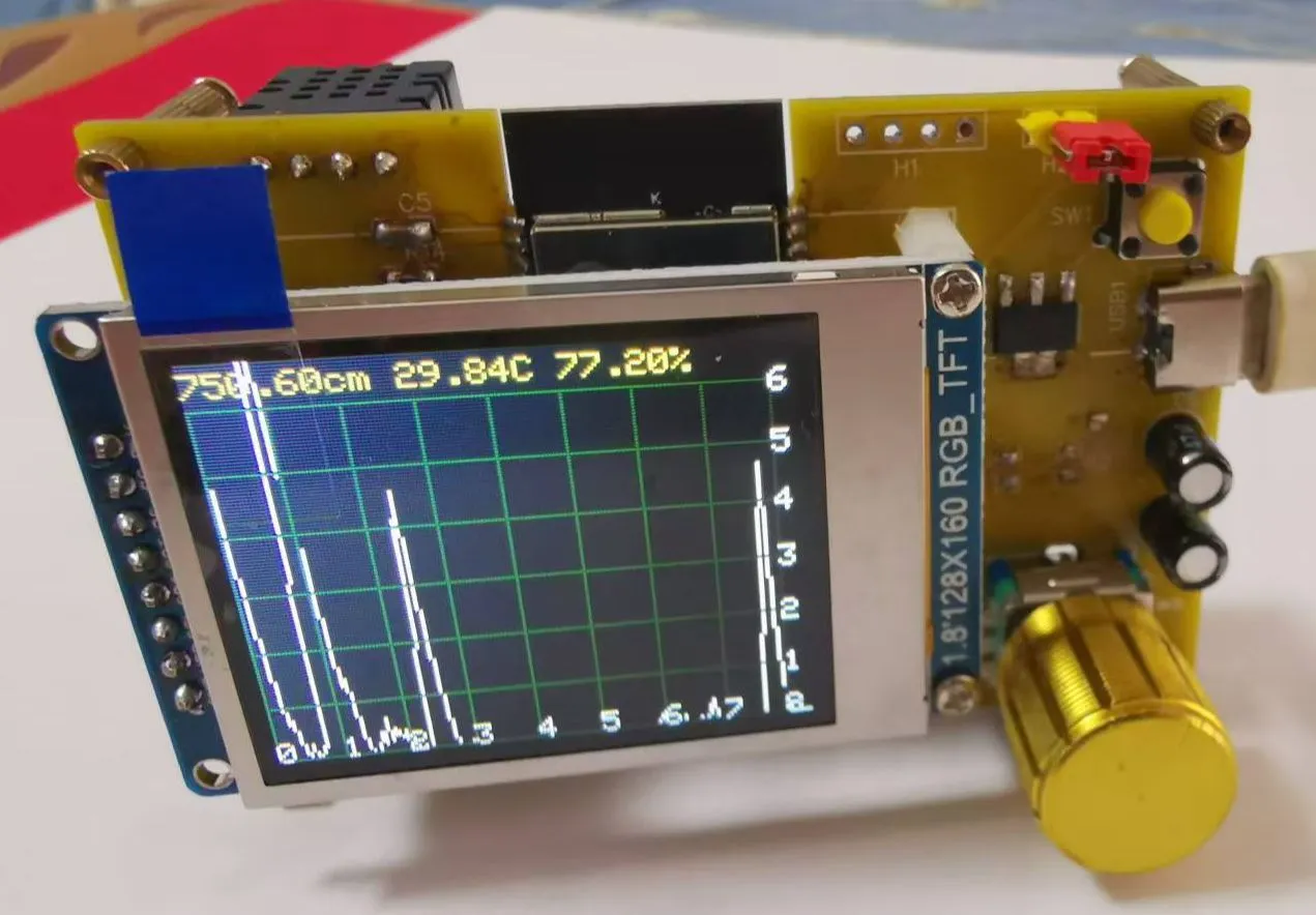

Project Overview:
This project is an experimental prototype of an ultrasonic radar rainfall monitoring system based on ESP32, capable of monitoring rainfall over short distances (within 10m).
In the field of microcontroller-based environmental monitoring devices (such as temperature, humidity, brightness, wind speed, air pressure, and lightning distance), no examples of non-contact rainfall monitoring have been observed.
Based on ultrasonic ranging, this project conducted experiments on the reflection of ultrasonic waves from raindrops and the basic noise of ultrasonic wave reception, analyzed the echo changes in various environments, and determined a scheme to add a bandpass amplifier to the received reflected wave. For experimental convenience, a 40kHz ultrasonic frequency is used in this scheme. According to the principle of sound wave reflection, for tiny raindrops, a higher frequency should yield a larger reflected wave, thus improving sensitivity. In principle, the rainfall can be calculated based on the characteristics of the reflected wave, but this has not yet been achieved.
This project utilizes the Wi-Fi function of the ESP32 and adopts the MQTT protocol to send rainfall, temperature, and humidity information to a server, which can be pushed to mobile devices. The server is built on a Raspberry Pi using NodeRed, with PeanutShell used for intranet penetration.
The hardware of this project uses an ESP32WROOM module, a 1.8" TFT color screen, a rotary encoder, a DHT temperature and humidity sensor, and an RCWL-9610 ultrasonic ranging chip and an operational amplifier. The power supply is TYPE-C5V.
Software development
is conducted using the ARDUINO IDE platform.
After power-on, the display, temperature and humidity sensor, encoder, and ultrasonic wave generator and receiver are initialized. A second interrupt is then enabled, and a start pulse is issued in its service routine, generating eight 40kHz ultrasonic pulses. These pulses are emitted by the ultrasonic head, and the reflected waves are received, amplified by multiple bandpass amplifiers, and detected. Then, an analog-to-digital converter is initiated to read the envelope value and display the echo signal on the screen. The sampling width is 12 bits, the rate is 3.4 ksps, the horizontal axis of the curve is 8M, and the vertical axis is the echo intensity (not calibrated).
The rainfall detection logic is as follows:
1. If the echo increases and persists for a period of time, such as 30 seconds, it is determined to be rainfall.
2. Rainfall intensity is used to determine whether it is heavy, moderate, or light.
The calibration of rainfall amount requires the relationship between ultrasonic echo and rainfall, which has not yet been implemented.
Regarding sensitivity, this solution is not sensitive enough for "drizzle." The following measures can be taken to improve it: a) Increase the frequency, such as 1MHz~10MHz, based on the characteristics of ultrasonic waves. b) Increase the transmission power. c) Add a conical "horn" to the ultrasonic head.
