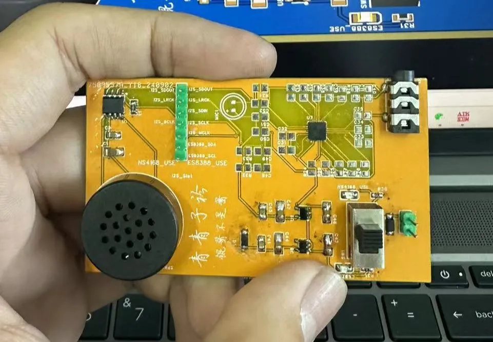

(Verifying) I2S Audio Evaluation Version
Current status: To be verified.
I've always enjoyed making small media players. Based on online research, the most commonly used audio chips are the WM8978 and VS1053.
The VS1053 has really good sound quality, and its automatic decoding feature is very user-friendly for microcontrollers. We only need to send audio signals to the chip via SPI, and it will automatically decode, and it even has built-in sound effect adjustments. However, the only drawback is that it's a little expensive.
I've also looked at the WM8978; one costs 71 RMB on LCSC (it seems to be out of stock or in very limited stock).
After some research, I found the ES8388 and NS4168 I2S audio chips. These two chips are not expensive and are good choices for I2S audio chips.
Let's start with the NS4168. This is a relatively simple Class D I2S digital amplifier audio chip. It's quite simple, with only eight pins and a simple peripheral circuit, as shown below.
R1 is connected to CTRL. The CTRL pin is responsible for configuring the left and right channel audio output.
Additionally, a filter capacitor needs to be added between GND and VDD
. After connecting the I2S audio cable, it will automatically output I2S audio.
With a 5V power supply, the output power can reach 2.5W, making it a good choice for building small speakers. I placed an NS4168 chip on this evaluation board for testing purposes. Audio is output through the onboard speaker.
The chip wiring is as follows:
SPKCLK ——— General purpose I/O, controlling left and right channel selection
I2S_LRCK Left and right channel clock signals
I2S_SCLK I2S clock signal
I2S_SDOUT
The other chip for I2S data signals, the ES8388, is even more powerful
. This chip not only supports audio output but also audio input, offering dual-channel input and output
, making it suitable for use in media players. However, after listening to it, I found the sound quality to be somewhat crisp.
In the circuit design, I specifically designed a power management switch to switch the power supply between the ES8388 and NS4168 chips.
I also designed dedicated AVDD and VDD power supplies, as well as AGND and GND power supplies for the ES8388
. = - = - Dedicated Divider
Line- = ...​ Otherwise, the chip will be burned out. According to the circuit design, we toggle the switch to switch between the NS4168 and ES8388 chips. After switching to the ES8388, the 5V is stepped down to 3.3V. There are two 3.3V outputs: VCC3.3 and VCCA3.3. After switching, we test the outputs of these two 3.3V outputs. On the multimeter, both VCC3.3 voltages are within the 3.3V range, indicating that the circuit is working correctly! 3. NS4168 Digital Amplifier Test: First, complete the soldering… (ps.) This speaker doesn't necessarily need to be purchased; you can use a regular speaker with the NS4168 directly connected to 5V. Here, we switch to NS4168 power supply. At this point, the chip isn't hot, so it's OK. Here's a brief explanation of the NS4168 chip: This chip is a super simple I2S digital amplifier. The chip itself is very simple. Compared to other I2S audio chips, this chip doesn't require any initialization configuration. After powering on, it uses I2S alignment to send audio data (16-bit, Philips format), and then it can play sound. It's important to note that this chip only supports mono output. The chip has a channel selection pin. By setting the voltage of this pin, you select the left or right channel output. The official level settings are as follows: Here, I encountered a problem: my initial test board pulled this pin low, resulting in no sound. I had to add a jumper wire. But don't worry! This control pin is brought out on the open-source board, allowing you to set the left and right channels using paper audio. When we transmit audio signals via I2S, the chip will output according to the selected channel. For detailed information about this chip, please refer to the chip's official datasheet . I've modified a simple piece of code from Atom to test if the chip outputs correctly. (This source code is from the "Atom ESP32 Development Board" audio player experiment, for reference only. To briefly explain the code's principle, Atom's code implements WAV decoding and ES8388 output. The ES8388 part includes chip control (setting volume, etc.) and I2S output. We removed the chip control part, kept the I2S output part, and connected our NS4168 output to the ESP32's output terminal.) Power-on test , successful!!! Please watch the test video. Here's my impression: the sound quality is acceptable, and most importantly, the chip's output power is quite high. I connected a computer speaker here, and it easily powered it. Let's also port a video player (happy!). The porting method is the same. Since our NS4168 doesn't require initialization or pre-boot configuration, we just need to remove the original ES8388 configuration code. See the video for the effect; it's quite impressive after connecting a loudspeaker.
