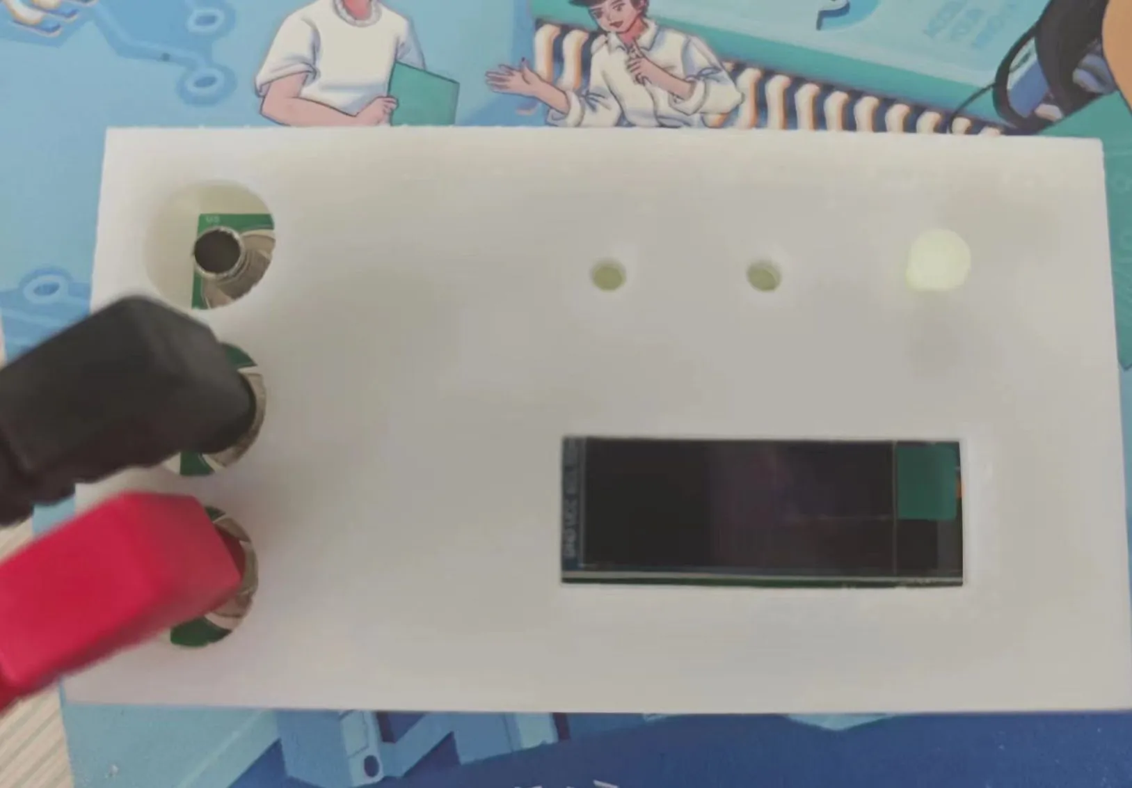

This project is a replica of a training camp voltmeter and ammeter. The core board uses the domestically produced Wuhan Xinyuan Semiconductor CW32 as the main controller, with a reduced PCB size and an additional casing. The display effect is shown in the figure:
Measuring a 3V button battery:
