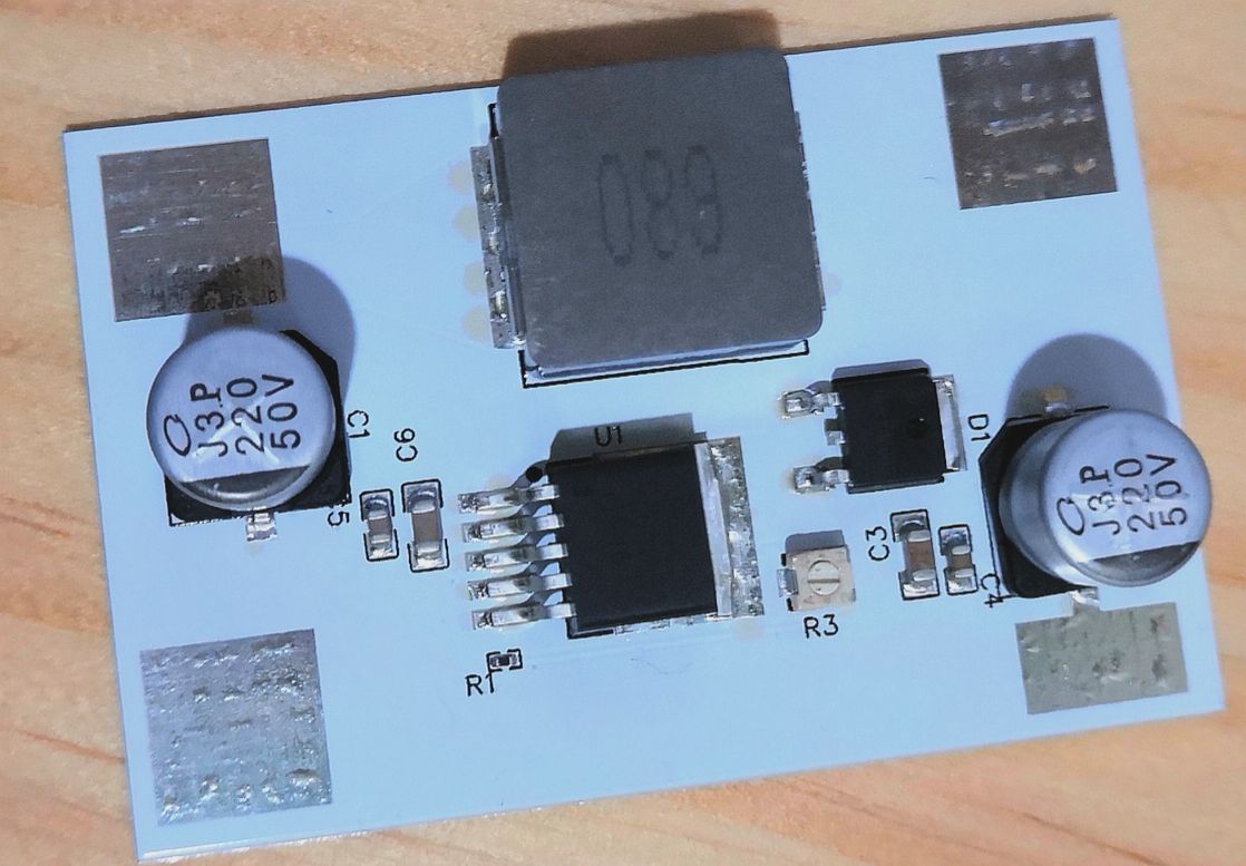

Project Introduction
This module is a simple switching power supply module. Through the XL6019 switch chip (switching frequency is about 220kHz) BOOST boost circuit to boost the 20V output by the PD charger, and output
28V2A to power high-power LEDs. (In fact, the constant current drive circuit should be used for current regulation, but this project is mainly to test the performance of the domestic XL6019, so the voltage regulation output is used)
The design is derived from the project "XL6019 Verification Board"

Schematic diagram
The whole circuit consists of a power boost circuit and an output voltage feedback circuit. Under normal conditions, it works in a constant voltage output mode.
By changing the resistance of the voltage divider resistor (sliding resistor R3) connected to V_out in the feedback circuit, the V_out voltage can be adjusted

2. To select the inductor, you
can use this website https://product.tdk.com/en/search/lc_select_tool
to match the inductance value according to your needs, but the website has very limited support for Chinese, and using this tool requires a little English. The following is a screenshot of
Figure 2, BUCK (classic buck switching power supply topology) circuit design, where Vf is the diode in the buck circuit.
Click the drop-down menu on the right side of this page and replace step-down with BOOST. For XL6019, the chip itself is equivalent to Vsw, The diode is equivalent to Vf.
The circuit requires you to select the type of original parts. Generally, there is no need to select Automotive components. Commercial components are of sufficient quality
(except for those who are not good at it. Are there really inductor enthusiasts?).
After filling in the relevant parameters, click Search to get the inductors that can be selected
. For my application, the model recommended by TDK is SPM10054T-330M-HZR (unfortunately, only automotive-grade inductors are available here).
Next, search the mall, and you can generally see the corresponding model. Then use the inductor. This method can solve most inductor selection problems.
In the actual picture, in order to "give full play" to the output capacity of XL6019, I chose an inductor with a larger rated current (7A rated current), which is actually not necessary. In the application of driving LEDs, this is a waste of resources.
One disadvantage of TDK's inductors is that they are expensive. If you plan to choose an inductor to solve the problem yourself, please consider carefully: the selection of the inductor is related to the overall efficiency, performance and stability of the circuit. Many designers in this community and many designers who sell and make "standardized" modules ignore this point.

    2. Determine the internal resistance and current parameters of the inductor.
    For the needs of this project, the average current of the inductor is about 3.5A (considering the overall efficiency is about 90%). Considering that the board has good heat dissipation, the internal resistance is more suitable within 80mOhm.
    For the design of this power supply (220kHz), Iron-silicon-chromium alloy is selected as the core material. After consultation,
    the PDMTAT series produced by PROD is made of iron-silicon-aluminum and cannot be used in power circuits above 100kHz (it cannot be used, but it is a pity at this price~).
    The SMMS1360-330M produced by SXN can be used as a substitute. The price is similar, the internal resistance is smaller and it is integrally formed.
2. Select the rectifier
   diode. Some solutions at this power level use synchronous rectification. The characteristic advantage of synchronous rectification is that semiconductor switching elements are used instead of diodes as the Vf switch in Figure 2. Since the diode conduction current must overcome the built-in electric field of its PN junction (Schottky diode is a metal-semiconductor dielectric junction) to do work, and switching elements such as MOSFET do not have the above problems. Therefore, the efficiency of synchronous rectification is higher when the current is larger (>=4A).
  The rectifier diode usually uses a suitable Schottky diode. When selecting a suitable Schottky diode, the parameters to pay attention to are:
   1. Reverse withstand voltage, the rated current
   reverse withstand voltage is more than 1.5 times the designed output voltage, and the rated current is greater than the maximum switching current of the switch chip.
   This design selects a diode with a reverse withstand voltage of 100V and a rated current of 10A, which can meet the requirements
   2. The conduction voltage drop and the maximum dissipation allowed under the diode package (very important for circuit stability, many circuit makers will ignore it)
    Since the diode heating caused by the charging and discharging of the junction capacitance can be ignored at this operating frequency, only the heat
    generation caused by the voltage drop is discussed:
     1. Calculate the duty cycle D of the IC switch at full load (duty cycle: circuit on time/(circuit off time + circuit on time))
     D = (Vout - Vin)/Vout ~= 0.50
     2. Estimate the maximum heat generation power, where Ilim is the maximum current of the switching IC, and ΔV is the conduction voltage drop of the diode (substitute the model I chose below to verify)
     P >= (1-D) * Ilim * ΔV = (1-0.5) * 5 * 1 = 2.5W
     The heat dissipation of this package can meet the requirements.
