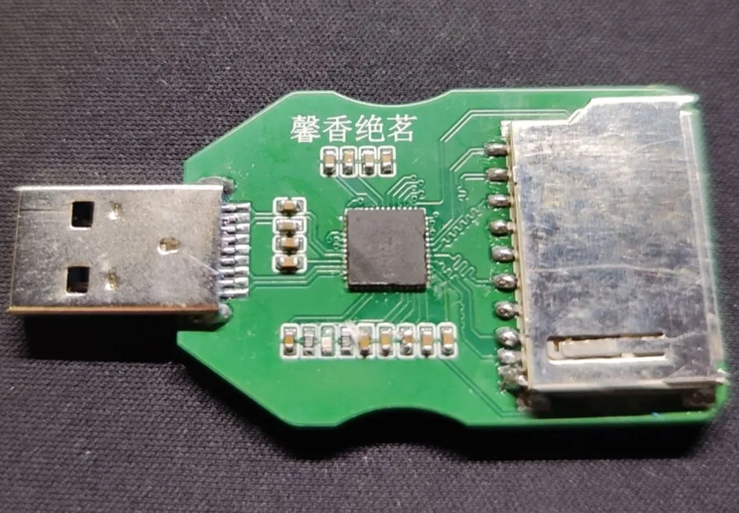

GL3224 Card Reader - Dual Card Dual Reading
There are three versions: one with an A-port, one with an A-female connector, and the last one with a C-port male connector.
PCB design instructions:
Use the 3313 structure; the lamination order is in my files (I don't know why it's not showing up here at LCSC).
Impedance control is 20% (free; you can pay for 10%), otherwise you can't create a USB 3.0 speed board. PCB
thickness is 1.2mm.
Schematic diagram:
Appearance inspiration: USB 3.0 card reader, based on the GL3224 solution, with SD and TF card slots - LCSC open-source hardware platform (oshwhub.com).
Dual card insertion is as follows:
When ejecting, you can select only one card for speed
testing:
TF card, Kioxia G2 128G version
GL3224 chip, the official 1532 firmware supports USB 3.0, no firmware upgrade required!!! (Only specific versions of Windows 10 require an upgrade).
The reason an upgrade is needed to "support" USB 3.0 is mentioned in the official UGREEN announcement.
The chip was bought for 4 RMB from Baoxiang Electronics on Taobao, and everything works perfectly. Remember to buy two extra to avoid overheating and damaging them during soldering.
My soldering process: When
soldering chips with a hot air gun, first apply solder to the chip's pins using a bent-tip soldering iron. Do not apply
solder to the large grounding pad in the middle of the chip. Heat the chip to 350 degrees Celsius for ten seconds, then apply solder paste along the pad's lead using a syringe. Apply a little solder to the large grounding pad in the middle as well.
Place the chip on top and heat it again. After the solder paste melts, press the chip down with tweezers to prevent poor soldering of any pins.
Then remove the hot air gun and wait for the solder to cool and solidify. Then use the soldering iron to run it along all four edges of the chip (you can place it on the soldering machine first for easier touch-ups) to ensure there is no solder joint. Do
the same for other components: preheat the hot air gun, apply solder paste, then place the capacitors and resistors and heat them again (do not place LEDs at this time; place them last to avoid damaging them).
Usage:
It takes five or six seconds for the computer to recognize the chip. If you are using a camera memory card for long-term copying of materials, please purchase a heatsink on Taobao.
