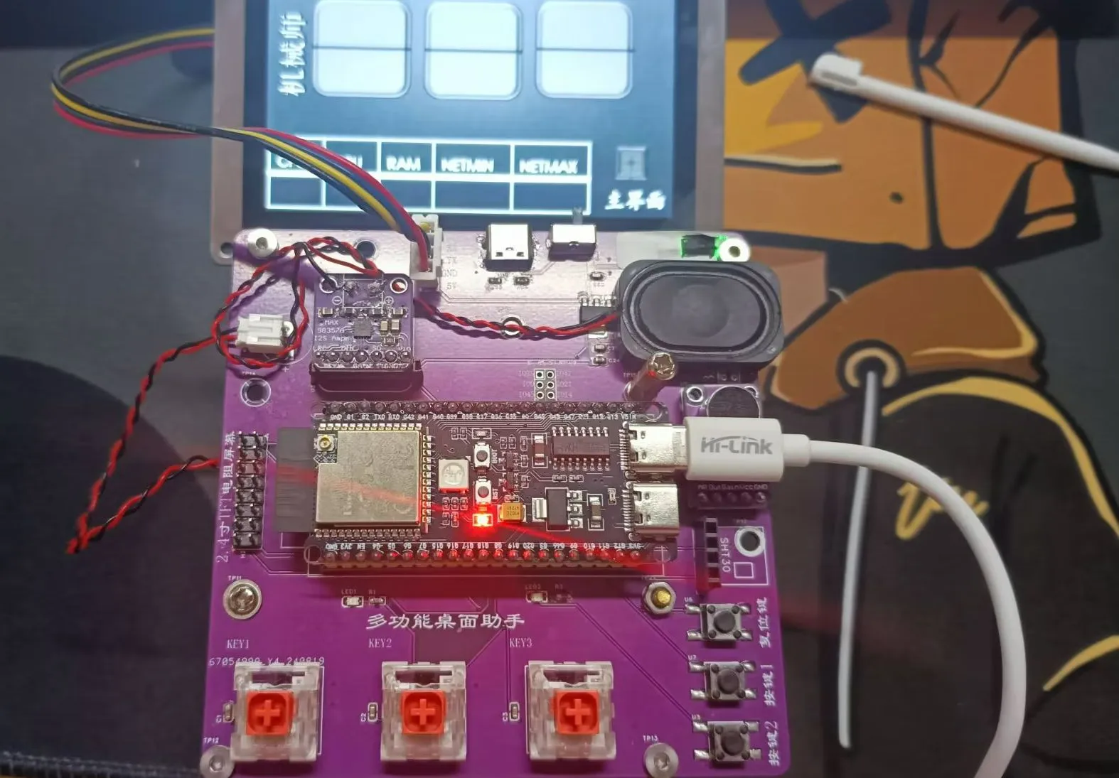

Project Overview
This project aims to develop a multi-functional desktop assistant integrating ChatGPT voice assistant, Bluetooth keyboard function, application quick launch, computer performance monitoring, weather and time information display, and music playback. It utilizes the ESP32 microcontroller as the core control unit, combined with various sensors and peripheral devices, to provide users with a convenient and intelligent desktop interaction experience.
Project Functions
1. ChatGPT Voice Assistant
Design a voice recognition algorithm to convert user speech into text commands. Through the ESP32's Wi-Fi function, text commands are sent to the ChatGPT server to obtain the response result. The response result is converted into voice output or displayed to the user on the screen.
2. Bluetooth Keyboard Function
Write a Bluetooth pairing and connection program to enable the desktop assistant to establish a Bluetooth connection with the computer. Design keyboard mapping logic to convert the desktop assistant's key operations into keyboard input that the computer can recognize. Support custom shortcut keys to achieve functions such as application quick launch.
3. Application Quick Launch
Write an application management program to identify and manage commonly used applications on the computer. Design a user interface to allow users to quickly launch or switch applications through the desktop assistant.
4. Computer Performance Monitoring:
Communicates with the computer via USB interface to obtain system performance data such as CPU, memory, and disk. Displays the performance data in real time on the screen, providing an intuitive performance monitoring interface.
5. Weather and Time Information Display:
Integrates a weather forecast API to periodically obtain and display current and future weather information. Designs a clock display interface to update and display the current time in real time.

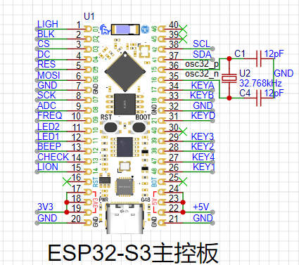

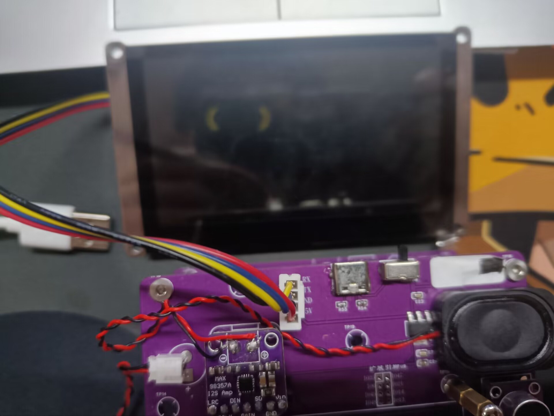

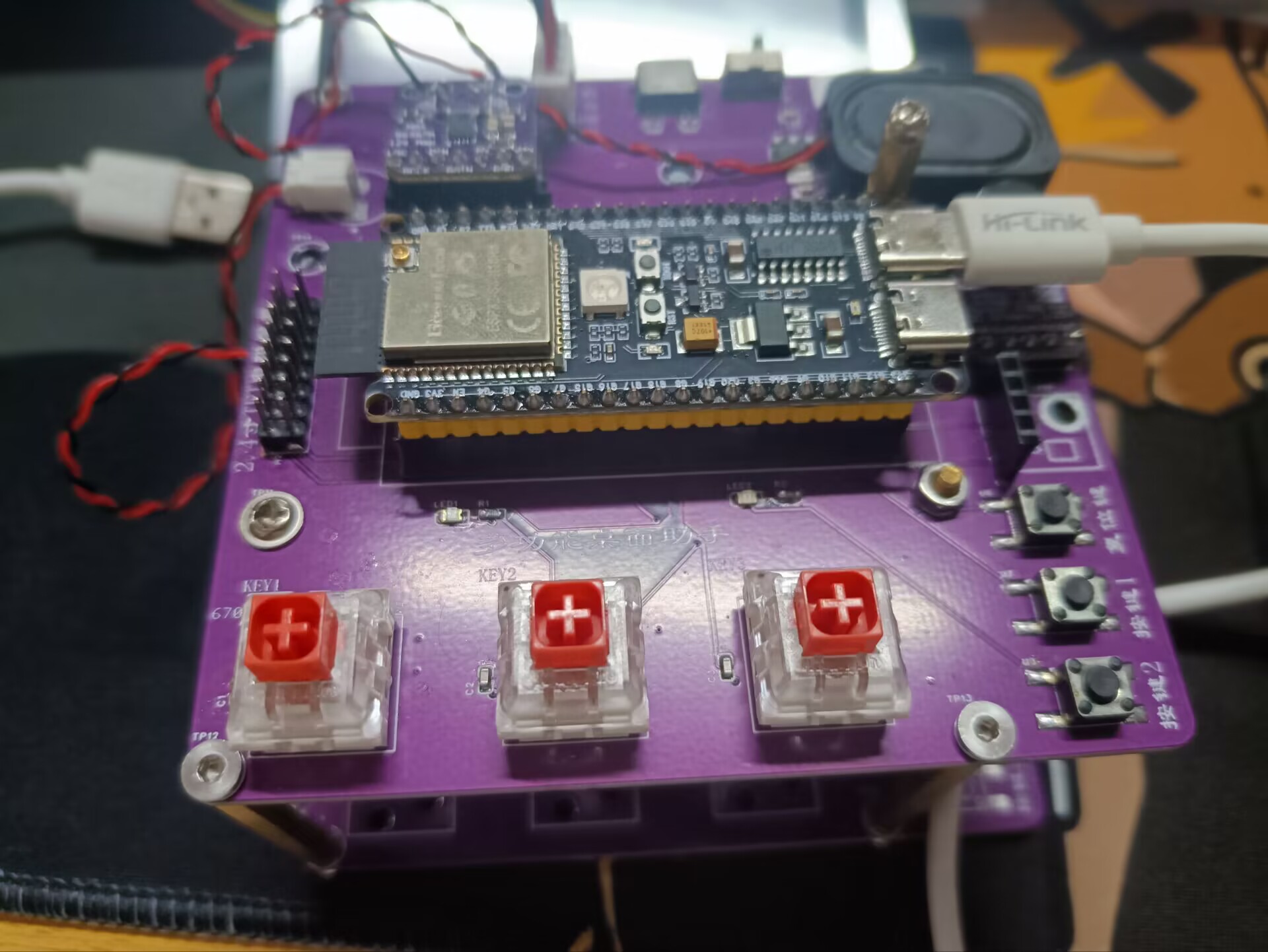

: Uses ESP32S3 as the main controller.
MAX9814 for voice input,
MAX98357 I2S for voice output, and

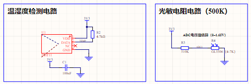

GY-SHT30-D for temperature and humidity detection.
Principle Analysis (Hardware Description)

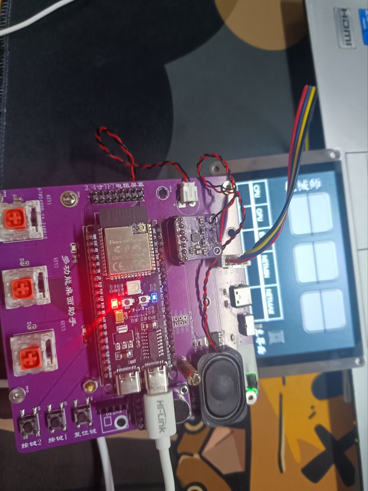

: First Version: Uses a Taojingchi serial capacitive touchscreen. It felt very sensitive. Later, it was found that too much UI was added, and the screen's built-in memory could no longer store it. This prevented many desired features from being implemented, forcing abandonment.
Second Version: Uses a 2.8-inch resistive touchscreen. After completing the UI, the resistive touchscreen felt very laggy... still not achieving the desired effect.
Third Version: Uses a 2.8-inch capacitive touchscreen.

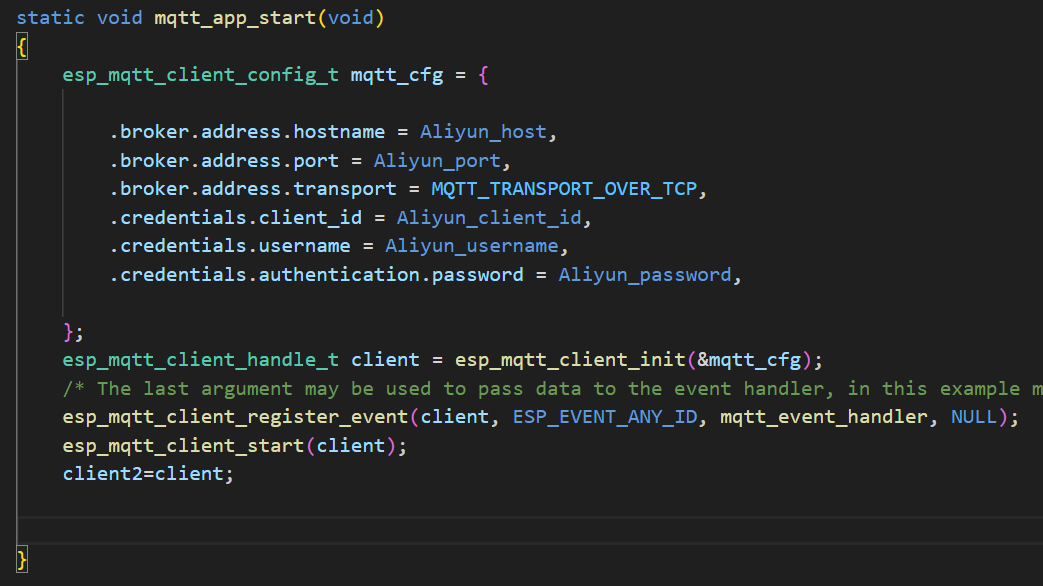

The software code
was developed using VS Code, Platform.io, LVGL, Squareline Studio, and UART HIM.
1. GPT question answering is implemented using Doubao (a type of API) from the Volcano model.
#include
String apiUrl = "https://ark.cn-beijing.volces.com/api/v3/chat/completions";
const char *doubao_apiKey = "c0c9a9df-c65b-4e8f-a5dd-65e4c501ea49";
String getGPTAnswer(String inputText)
HTTPClient http;
http.setTimeout(20000);
http.begin(apiUrl);
http.addHeader("Content-Type", "application/json");
String token_key = "Bearer " + String(doubao_apiKey);
http.addHeader("Authorization", token_key);
String payload = "{"model":"ep-20240901212403-z677d","messages":[{"role":"system","content":"You are my AI assistant vor, you must answer in Chinese and the number of characters cannot exceed 85"},{"role":"user","content":"" + inputText + ""}],"temperature": 0.3}";
int httpResponseCode = http.POST(payload);
if (httpResponseCode != 200)
Serial0.println("HTTP Request Failed");
http.end();
return "";
String reason = http.getString();
http.end();
DynamicJsonDocument jsonDoc1(1024);
deserializeJson(jsonDoc1, reason);
return jsonDoc1["choices"][0]["message"]["content"];

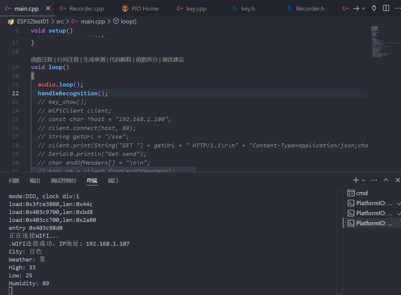

4、通过调用和风天气的API实现未来三天的天气监测。
const char *privateKey = "SWx9ptkZnxlmmy3V5";
const char *city = "百色";
const char *language = "zh-Hans";
HTTPClient client1;
void fetchWeatherData()
String getUrl = "/v3/weather/daily.json?key=" + String(privateKey) + "&location=" + String(city) + "&language=" + String(language);
client1.begin("http://api.seniverse.com" + getUrl);
int httpResponseCode = client1.GET();
if (httpResponseCode > 0)
String payload = client1.getString();
DynamicJsonDocument doc(1400);
deserializeJson(doc, payload);
WeatherData weatherdata;
strcpy(weatherdata.city, doc["results"][0]["location"]["name"].as());
strcpy(weatherdata.weather, doc["results"][0]["daily"][0]["text_day"].as());
strcpy(weatherdata.high, doc["results"][0]["daily"][0]["high"].as());
strcpy(weatherdata.low, doc["results"][0]["daily"][0]["low"].as());
strcpy(weatherdata.humi, doc["results"][0]["daily"][0]["humidity"].as());
Serial0.println("City: " + String(weatherdata.city));
Serial0.println("Weather: " + String(weatherdata.weather));
Serial0.println("High: " + String(weatherdata.high));
Serial0.println("Low: " + String(weatherdata.low));
Serial0.println("Humidity: " + String(weatherdata.humi));
else
Serial0.println("Error fetching weather data");
client1.end();

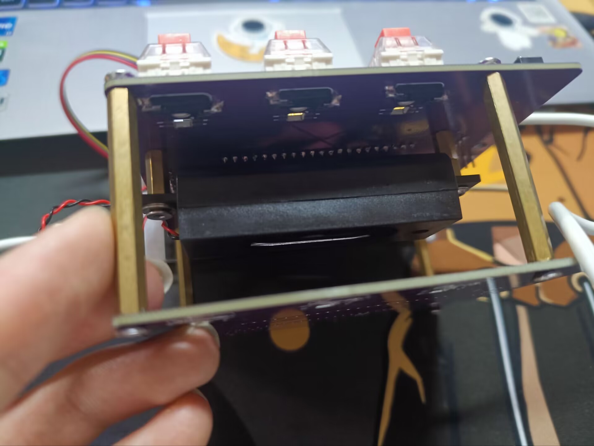

Assembly process photos
will be added later.

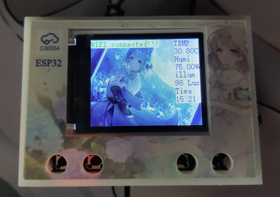

The ESP32 Desktop Assistant

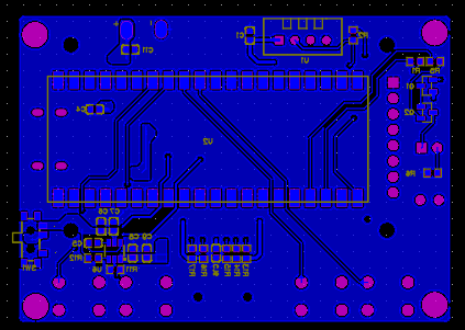

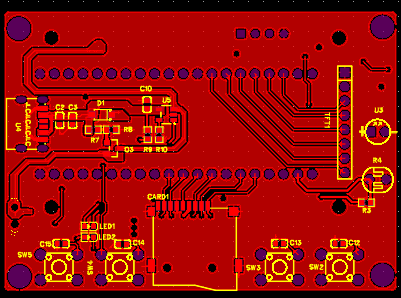

uses the ESP32-S2 module as the main controller.
The programming mode is a serial port automatic switching programming circuit.

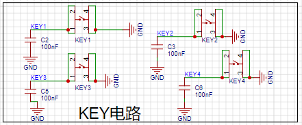

There are three buttons:
Button 1, manually turn the LED on/off
; Button 2, manually restart the MCU;
Button 3, pending.

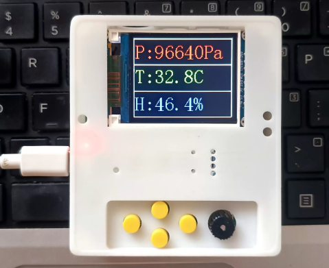

After powering on, it connects via the ESP32-S2's Wi-Fi peripheral.
Once connected, it uses a WiFi Client to connect to the weather website host and sends a request to acquire weather data.
The weather data is parsed and displayed on a 2.4-inch TFT color screen.
The time is refreshed every 30 seconds, and the weather data is refreshed every 10 minutes.
Data exchange with the ESP32-S2 main controller can be achieved via a network on a mobile phone or computer, enabling control.

1- Supports monitoring indoor light, temperature, humidity, and pressure data acquisition (completed).
2- Supports wireless data transmission for convenient remote access; AP + Bluetooth functionality has been verified and is awaiting integration.
3- Supports image playback; image display has been verified and is awaiting integration.
4- Supports buzzer alerts (completed)
. 5- Supports desktop placement (completed).
6- Supports battery charging and discharging (completed)
. 7- Supports low battery alarm (completed).

uses an ESP32-S3, a development board purchased directly from LCSC. This project was also to learn ESP32; its 240MHz clock speed and dual-core support were the main reasons I was interested.
The pinout circuit of this board is as follows:

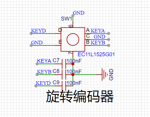

Button design:
To accommodate future functionalities, as many buttons as possible have been reserved.
A rotary encoder interface has also been reserved.
All the above circuits have added debounce capacitors; don't skimp on this!

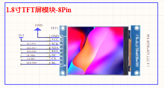

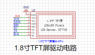

screen design:
I happened to have a 1.8-inch TFT display screen on hand, which I could utilize. I was learning how to drive a color SPI interface screen using an ESP32. This really stumped me. It was too difficult to adjust.

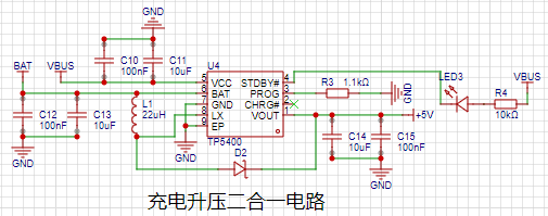

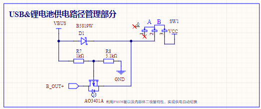

Charging and discharging circuit:
I purchased a TP5400 from LCSC; it's cheap and easy to use. I used this in almost all LCSC activities.
The circuit is simple, reliable, and practical. Just copy it directly.

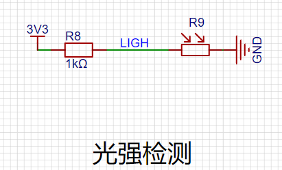

Light intensity detection
: A photoresistor is used; the stronger the light, the lower the resistance. Based on this principle, a pull-up voltage divider is used. The ESP32's AD converter then acquires the data. As shown below:

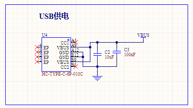

USB detection
can detect when the USB is plugged in for charging. Because the input is 5V, voltage division is performed to protect the interface.

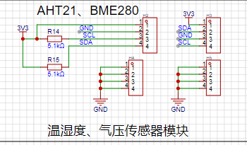

As shown below: The temperature and humidity
sensor module
uses AHT21B to collect data, and the atmospheric pressure sensor uses BMP280.
Both use IIC interfaces, so the interfaces can share the IIC bus. As shown in the figure below:
The tutorial does not include porting these two modules, as writing them yourself would be too painful. However, the lessons learned are also very rich.

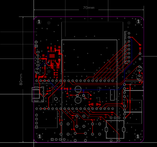

The PCB design
uses a 2-layer board, FR-4 board material, 1.2mm thick, and 70x80mm dimensions.

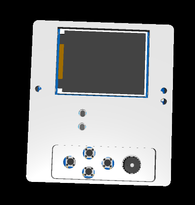

The casing design
uses LCSC EDA, and LCSC's 3D models are becoming increasingly realistic. The progress is really fast! Domestic EDA has a bright future.

The BMP280 driver
header file is as follows:

演示效果
具体见附件和B站链接哦:
https://www.bilibili.The video (com/video/BV1GFt8eYEos/?vd_source=24f1befd6441a33d7b240715cb07c7b5) Although this trip was rushed, forcing myself to persevere yielded truly many rewards.a journey of a thousand miles beginning with a single step. No matter how difficult, you must take action first.

2. Schematic Diagram Explanation
2.1 Power Supply Circuit
The power supply adopts a USB + lithium battery power supply scheme. When the USB socket is plugged in, the system is powered by the USB and charges the lithium battery; when the USB socket is unplugged, the power circuit is powered by the lithium battery.
                               USB power supply interface Lithium battery charging circuit
2.2 Automatic Switching of Power Supply Circuit
The key to achieving automatic switching of the power supply circuit is the use of a PNP type MOSFET. The
voltage Vgs of the MOSFET determines the on/off state of the circuit. When powered by USB, the potential at point G of the PNP transistor is pulled high by the voltage divider resistor, Vgs > 0, the MOSFET is cut off, and the lithium battery does not supply power. When only the lithium battery is powered, point G is grounded, the voltage is 0V, the Vgs
transistor is turned on, and a Schottky diode is connected at the USB output to prevent the two circuits from interfering with each other.
                                                     The power supply switching circuit
2.3

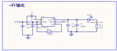

includes a 5V boost circuit. The ESP32S3 development board has a 3.3V LDO. Considering the instability of the lithium battery, a 5V boost regulator circuit is designed in the circuit to stabilize the voltage and maintain stable device operation. The boost chip selected is the Chipstar X4310, which outputs a fixed 5V when the input is 2.7~5V,
providing a stable voltage for chip operation. 2.4 Lithium Battery
                                                 Charging
Management Circuit
: Regarding the lithium battery charging and discharging circuit, the commonly used TP4054 charging and discharging management chip was used. The maximum charging current is 500mA, and this current can be adjusted by changing the resistor. During charging, pin 1 of the chip is grounded, and the LED lights up. When the battery is fully charged,
pin 1 switches to a high state, and the LED turns off. The battery charging status can be determined by the LED's on/off state. 2.5 Display
                                                   Circuit: The display circuit uses a 1.8-inch OLED screen. This screen uses an SPI interface for communication, resulting in a stable refresh rate and good display quality. 2.6 Infrared                                                                 Transmitting Circuit: According to the Espressif official manual, the ESP32S3 has infrared functionality and can transmit infrared signals through configuration functions. However, after verification, the transmitted infrared signal is only 32 bits (refer to the Espressif official API for details). However, actual measurements showed that the air conditioner remote control sends signals of over 100 bits at a time. Therefore, after multiple attempts, this solution was abandoned. Therefore, the infrared emitting circuit in this project uses a timer to output a 38kHz PWM waveform to simulate the infrared NEC protocol. The circuit is controlled by two I/O ports: one for enabling the signal and the other for transmitting the signal. All I/O ports are controlled by PNP transistors to turn on and off, and the NEC protocol is simulated through encoding.                                                                 2.7 Temperature, Humidity, and Light Detection                                 Circuit : The temperature and humidity sensor uses the cost-effective DHT11, costing less than two yuan per sensor. Light detection uses a photoresistor voltage divider, and then the voltage is read and converted by an ADC. 3. Physical Image                           of the Temperature, Humidity, and Light Detection Circuit :                                                   [Image of the physical product and its                                             display on the cloud smart APP] 4. PCB Design Notes: In the PCB design, the power supply traces should be thickened, and copper pours should be used for connections when necessary. 5. Key Program Descriptions                                       5.1                                        The Alibaba Cloud platform access project uses the MQTT protocol to connect to Alibaba Cloud. Before writing the program, you need to register an account on the Alibaba Cloud IoT platform, create products and devices, and define product functions:                        Alibaba Cloud Platform Product Creation                       Alibaba Cloud Platform Function Definition                        Alibaba Cloud Platform Device Creation After the device is created, we can obtain the MQTT connection parameters and the Topic list used for attribute subscription and publication:                                     MQTT Connection Parameters                                       Topic List Write the above information into the code as follows: After                               writing the information into the code , connect to WIFI and use the mqtt_app_start() function to initialize and connect the device to Alibaba Cloud. 5.2 Alibaba Cloud Message Subscription and Publication After writing the Topic list into the program as described in 5.1, we can create messages using cJSON and then call the esp_mqtt_client_publish function to publish the message:

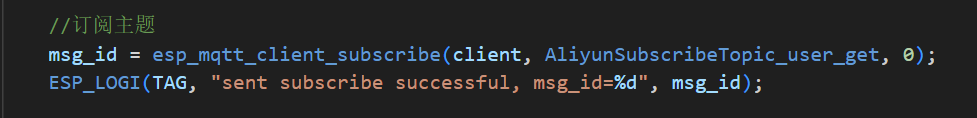

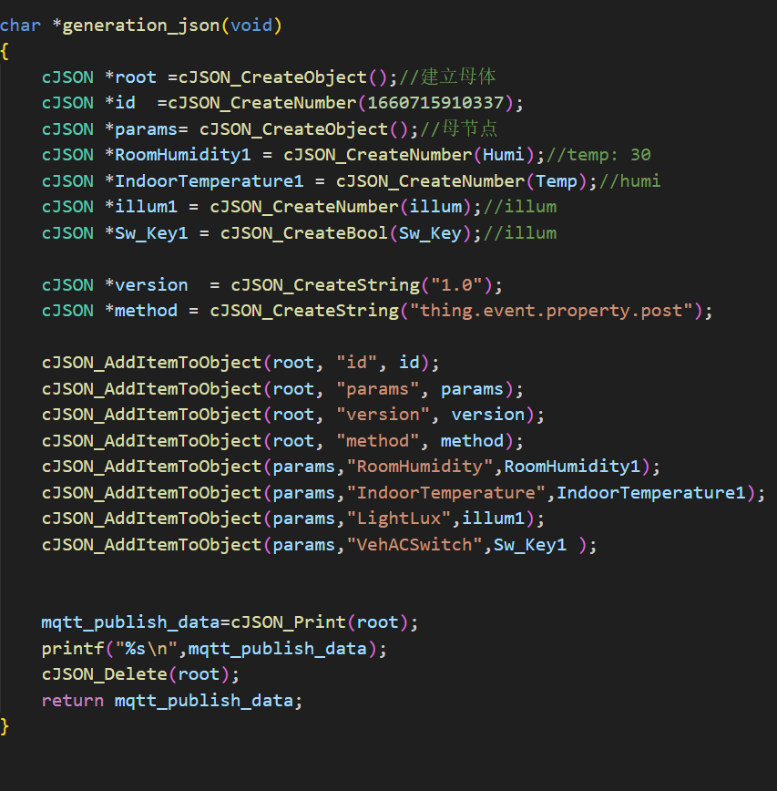

Note that when publishing messages, the variable names on our local machine must be consistent with those set on Alibaba Cloud to ensure that Alibaba Cloud can recognize the information we publish. As for subscribing to topics,
simply add the relevant Topic list during initialization. After receiving a subscription, the relevant message will be printed to the console. Alternatively, we can use cJSON to parse the message and
obtain the content we need.

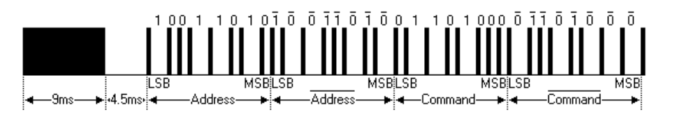

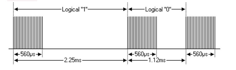

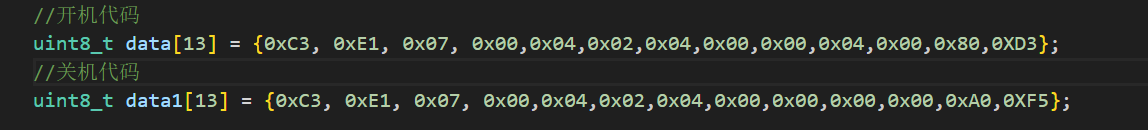

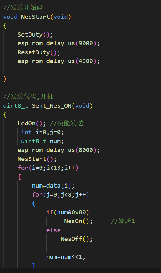

5.3 Infrared Signal Transmission
The infrared signal uses a PWM waveform generated by a timer to simulate NEC timing for information transmission. The relevant timing definitions are as follows:
Logic 1 and Logic 0:
Logic "0": 560µs effective pulse + 560µs idle interval, total duration 1.12ms. Logic "1": 560µs effective pulse + 1.68ms idle interval, total duration 2.24ms (twice that of Logic 0).
Start Code:
The start flag sequence for each frame is: a 9ms AGC pulse (16 times the 560µs pulse used for logic data bits) + 4.5ms idle.
Therefore, based on the above information, the NEC waveform can be simulated as follows:
Once the relevant code is determined, a signal can be sent through the ESP32's IO port to control the air conditioner's on/off state. The question then arises: how to determine the air conditioner control code?
If the air conditioner brand is commonly used, you can search online; you might find it. If it's less commonly used, or an older model, such as the air conditioner this project
requires control, then use an oscilloscope to measure it!

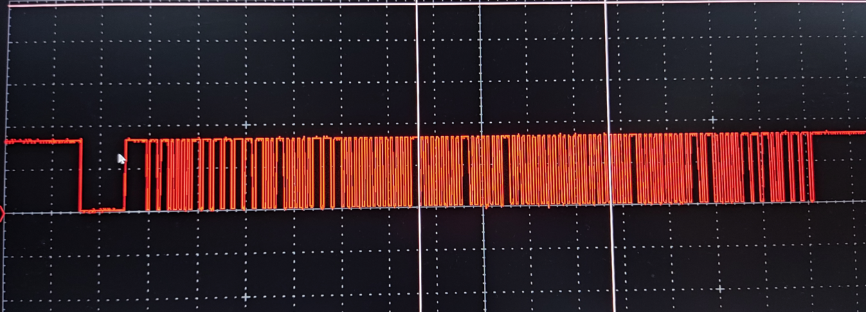

The image above shows the infrared receiver output waveform tested with an oscilloscope when the air conditioner is turned on. The power-on code information can be obtained through protocol analysis.
(Actually, it's not that complicated. You only need an infrared decoder, connected to a microcontroller, and an infrared receiver code ported from the internet. The oscilloscope is mainly used for convenient waveform observation during debugging.)
6. Assembly Instructions:
All resistors and capacitors in this project use 0603 packages. Only the chip soldering is relatively difficult; with a few attempts, you can complete the soldering. After the code is burned, install the product into the casing. Note that there are four 1.8mm diameter posts for positioning at the screen; do not break them.
