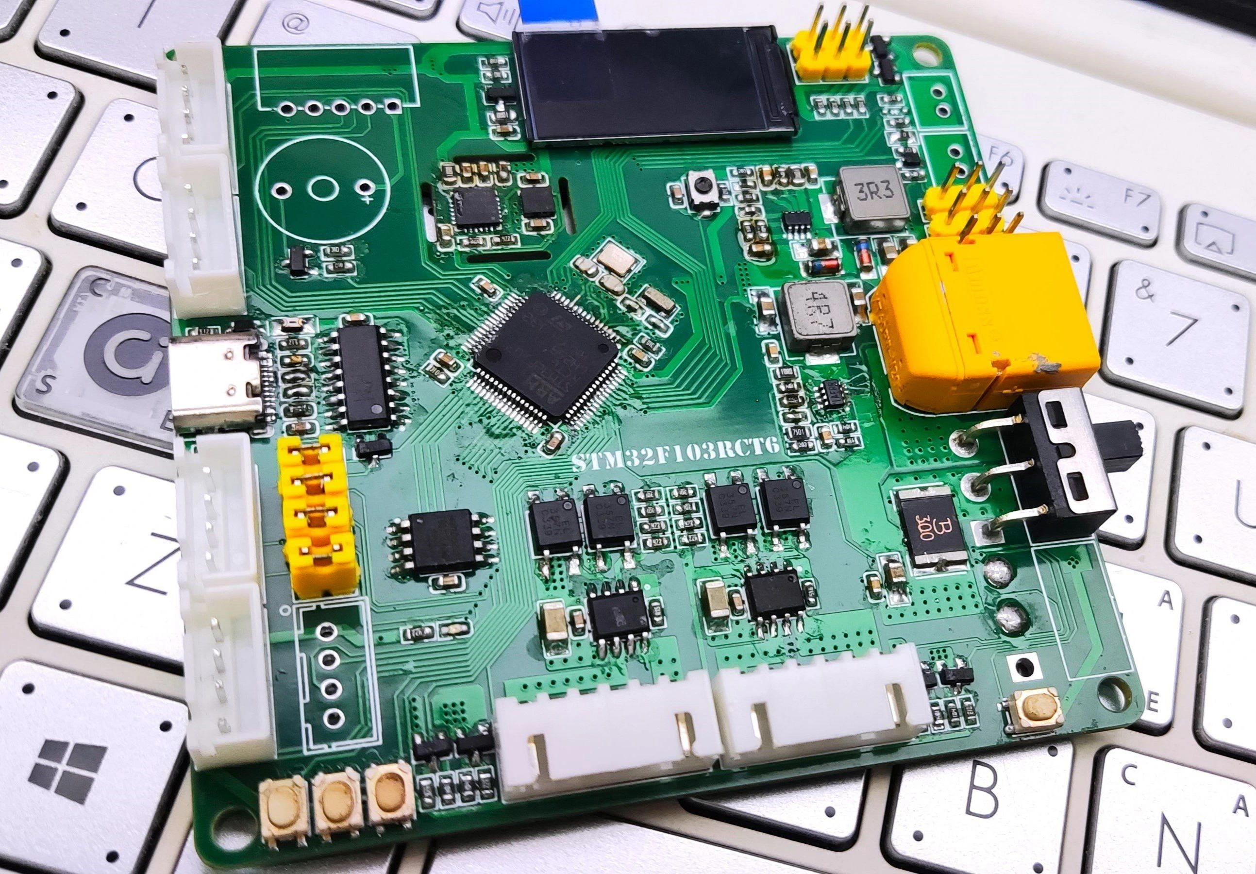

Project Introduction:
This is a control board that I started designing around this time last year. It was completed six months ago in preparation for the National Electronics Design Contest (NEDC). Before that, it went through four versions, but unfortunately, it wasn't used in the contest. Because I made many modifications and studied many excellent open-source projects, I avoided many pitfalls. Therefore, I'm open-sourcing it to provide reference for more students without guidance. The goal of this design is to complete all the functions required for the NEDC on a single board. It uses the STM32F103RCT6 microcontroller, utilizing almost all of its pins.
Supported functions:
Dual-channel voltage regulation, onboard daplink, dual encoder motors (with isolation), dual servos, TFT color screen, gyroscope, magnetometer, 4 buttons, 1 LED, external FLASH storage, active buzzer, two ADCs (1 external, 1 power supply), one DAC output, power header pinout, 1 IIC pinout, ultrasonic, line tracking, and 3 serial ports (one connected to daplink via a jumper). The microcontroller resource allocation
hardware introduction uses XT60 and ordinary terminal blocks for
the power supply
interface. The required interfaces can be soldered according to your own battery.
Both power supplies use MP2225 converters, converting VCC to 5V and 5V to 3.3V respectively.
VCC is used for the motors, and batteries of different voltages can be connected according to the motor's rated voltage. 5V is used for the two servo motors, and 3.3V is used for the onboard components and the microcontroller.
If the servo voltage is not 5V, it can be changed to the required voltage according to the following formula. A 1N5819 is connected in series between 5V and USB. Even if the voltage is changed to greater than 5V, plugging in USB will not damage the computer's USB port. When only USB power is supplied, the measured 5V voltage may be 4.7V, which is the normal diode voltage drop.
Two resistors are used in parallel here instead of one R2 in the formula. If you can buy resistors with the appropriate ratio, you can replace them yourself. Vout is the voltage you want to output to the servo motors. Here, a 5V resistor is used.
The board also provides external interfaces for 5V, 3.3V, and GND.
For the download section,
this project has an onboard daplink firmware, which is downloaded using a CH552. The firmware can be referenced from the Liangshanpai programmer.
https://oshwhub.com/lengyuefeng/a7c57e6d86bd47789178df3fda9219dc
Connect the RCT6 to the UART1 and SWD ports via jumper caps. If you don't want to solder the CH552 or if it's damaged, you can first solder the header next to Type-C and use it for program downloading or serial communication. If the daplink detects the microcontroller but cannot download the program, remove the jumper cap connecting the programmer and the microcontroller MCU_RST. Resetting the programmer without connecting it will not have any effect.
The microcontroller used is an STM32F103RCT6, with the filter capacitors placed as close as possible to the power pins, and the crystal oscillator section grounded.
The motor uses an encoder motor, controlled by two AT8236 chips, and isolated using an EL357. The encoder is isolated by a transistor (I forget the exact reason, but it seems unnecessary; you could omit the transistor connection resistor and short pins 1 and 3).
For control, a four-channel PWM controller from a TIM3 chip is used to control the encoder motor.
Speed ​​measurement uses encoder modes from TIM2 and TIM5 chips.
The servo motor's feedback resistor can be adjusted based on the servo's voltage. Two PWM channels from a TIM4 chip control
the screen, which is a 0.96-inch SPI protocol bare-screen soldered board with a resolution of 80*160. It costs only 3-4 yuan per piece, cheaper than buying an OLED screen directly, and the external circuitry is simple, meeting the display requirements. For displaying complex content, it is recommended to use serial port display directly. Note: Before soldering, carefully check the pin order on the silkscreen and the pin order on the screen to avoid reversing the soldering!
For control, software SPI is used (hardware SPI was not used because the microcontroller resources are somewhat limited, and since only data display is planned, high refresh rates are not required).
The gyroscope used is the MPU6050; there is plenty of documentation available online, including many open-source resources and tutorials. Because ST's hardware IIC function is not perfect, and a high detection frequency is not required, software IIC control is more suitable. During use, no good solution was found for the zero drift problem, but in actual use, there was only a small amount of zero drift at startup, which then stabilized and became negligible. Note: Without a hot air gun or other tools... Solder with caution on the hot plate.
The magnetometer uses a QMC5883, sharing one IIC channel with the gyroscope. I personally don't use it much, so you can choose to solder it selectively. Note: Solder with caution if you don't have a hot air gun or a hot plate.
The storage section uses a W25Q128, using hardware SPI2 communication. If you don't need power-down storage, you don't need to solder it.
There is an onboard LED for status display, 4-way button input, and 1-way active buzzer (you can solder an unactive one, but I only need it to sound; an active one is easier to control).
Channel 5 of ADC1 is used to measure battery voltage, and channel 6 is used for external voltage detection. An external DAC is also connected for voltage output. Both ADC channels use resistor voltage dividers. In calculations, the voltage read by the ADC needs to be 11 times the voltage. Ground plane is used. 0R resistors were used for segmentation.
This project introduced three serial ports. UART1 is connected to the onboard daplink via a jumper cap. UART2 and UART3 can be used for communication between the wireless module and the OpenMV/K210, respectively. When there are not enough serial ports, the jumper cap on the onboard daplink's UART1 can be removed.
Due to the limited resources of the microcontroller, ordinary tracking modules would use many pins, so a parallel-to-serial conversion scheme was adopted. The onboard interface only uses three data lines, making control very simple and worry-free. It works well with tracking modules that include parallel-to-serial conversion (this is not necessary if only three-channel tracking is required).
Here is a recommended resource: https://oshwhub.com/xaiomao/infrared_track This solution offers 16-channel tracking at a low cost, and using photodiodes to detect the light source allows for easy replacement of the desired color detection. Compared to online options that cost several times more, this solution is very user-friendly.
Simple I/O control is used here; an ultrasonic module could be connected for obstacle avoidance and distance measurement. However, ultrasonic modules haven't been used in recent years' electronics design competitions, so this is still a good learning resource.
A hardware I/O interface is provided here, which can also be used as a regular GPIO or software I/O. It can be connected to an OLED display, a 24C0X for storage, or other sensors, but the pin order must be considered. It is recommended to use a 4-pin ribbon cable, connecting the pins to the terminals according to the sensor pin order, and then inserting the terminal block into the sensor.
This project includes most common modules and common pinout interfaces. There are no extra pins, but unused serial ports, DACs, ADCs, I/O interfaces, etc., can be used as regular GPIOs.

My soldering sequence is as follows: First, solder the power supply section, using a battery or CNC power supply. Use a multimeter to measure the voltage (5V, 3.3V) to check if it's normal. If not, check if the power chip is facing the wrong direction, if the capacitors and resistors are placed incorrectly, or if the resistor values ​​are wrong. If the voltage is correct, then solder the microcontroller's minimum circuit and reset circuit. You can solder an LED for easier testing. Use a programmer connected to the jumper cap and write an LED blinking test to check if the microcontroller is working properly. If the microcontroller cannot be recognized, you can use the macro mode on your phone's camera (if you have good eyesight, you can look directly) to check for short circuits or cold solder joints on the pins. If the program runs normally, you can continue soldering the gyroscope and magnetometer. These are relatively difficult to solder, so I recommend using a hot air gun or a heating table (the magnetometer is not used much, so you can skip it). Then write an IIC program to test it. If it can read the data, you can confidently solder the rest. Experienced solderers can solder them all in one go. I haven't had time to organize the
