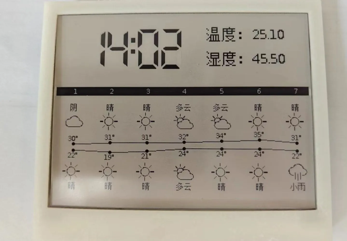

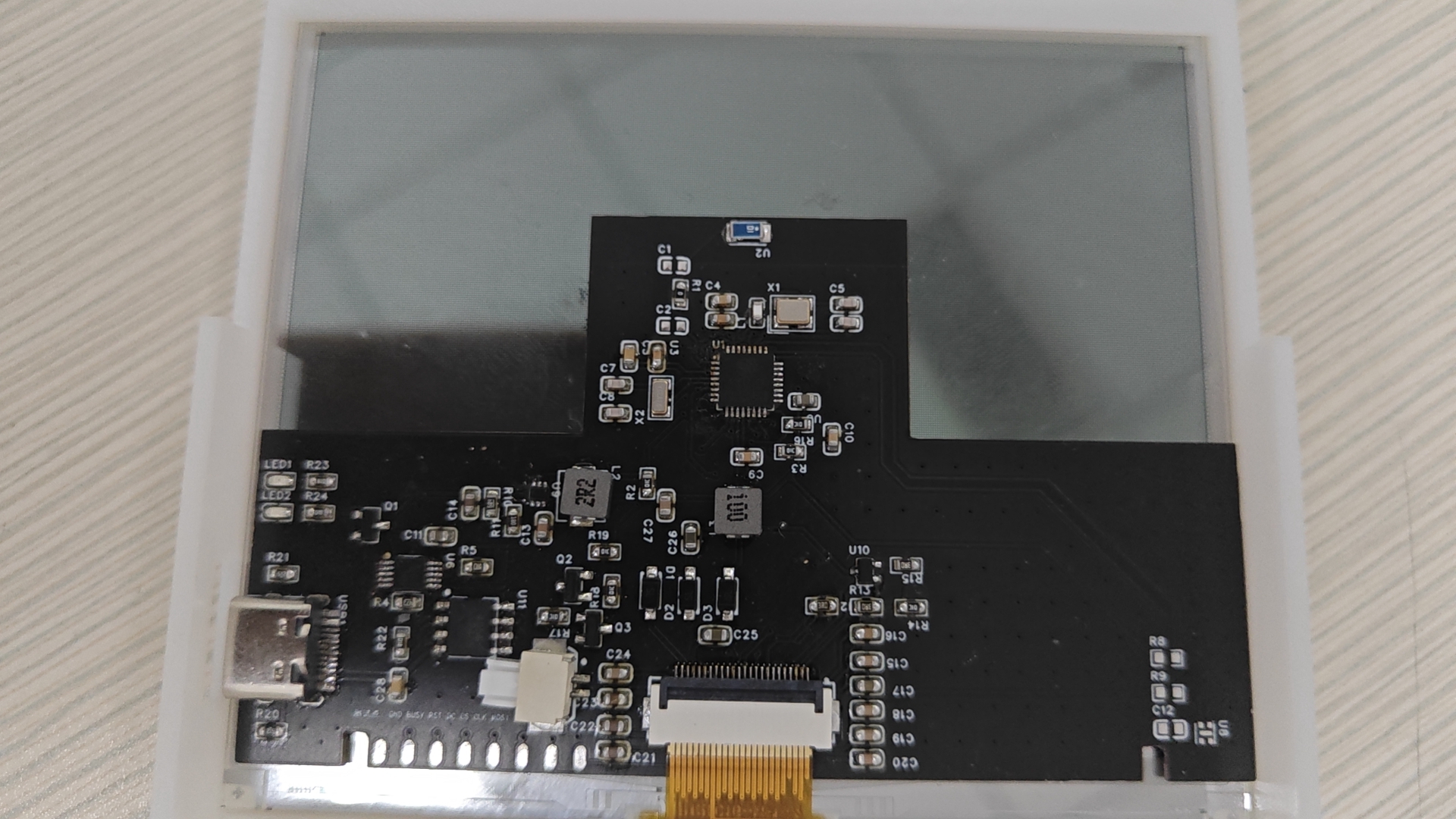

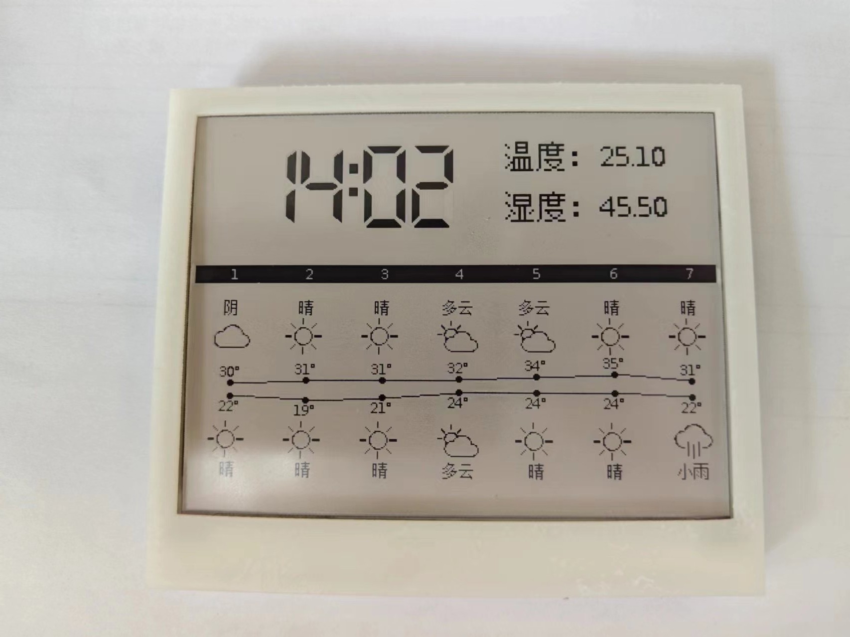

4.2-inch e-ink screen ornament
This is an e-ink display based on the ESP32C3FH4 microcontroller. The e-ink is from a second-hand electronic price tag. The main controller is an SSD1683, and the resolution is 400*300.
The EPD driver source code comes from HalfSweet on GitHub.
The weather API uses Hefeng Weather, and the related GZIP decompression uses arduino_uzlib.
Real-time weather data comes from SHT40.
I'm currently refactoring the code and adding features using ESP-IDF, but since the deadline is approaching, I'll use this patchwork Arduino version for now.
