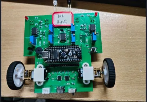

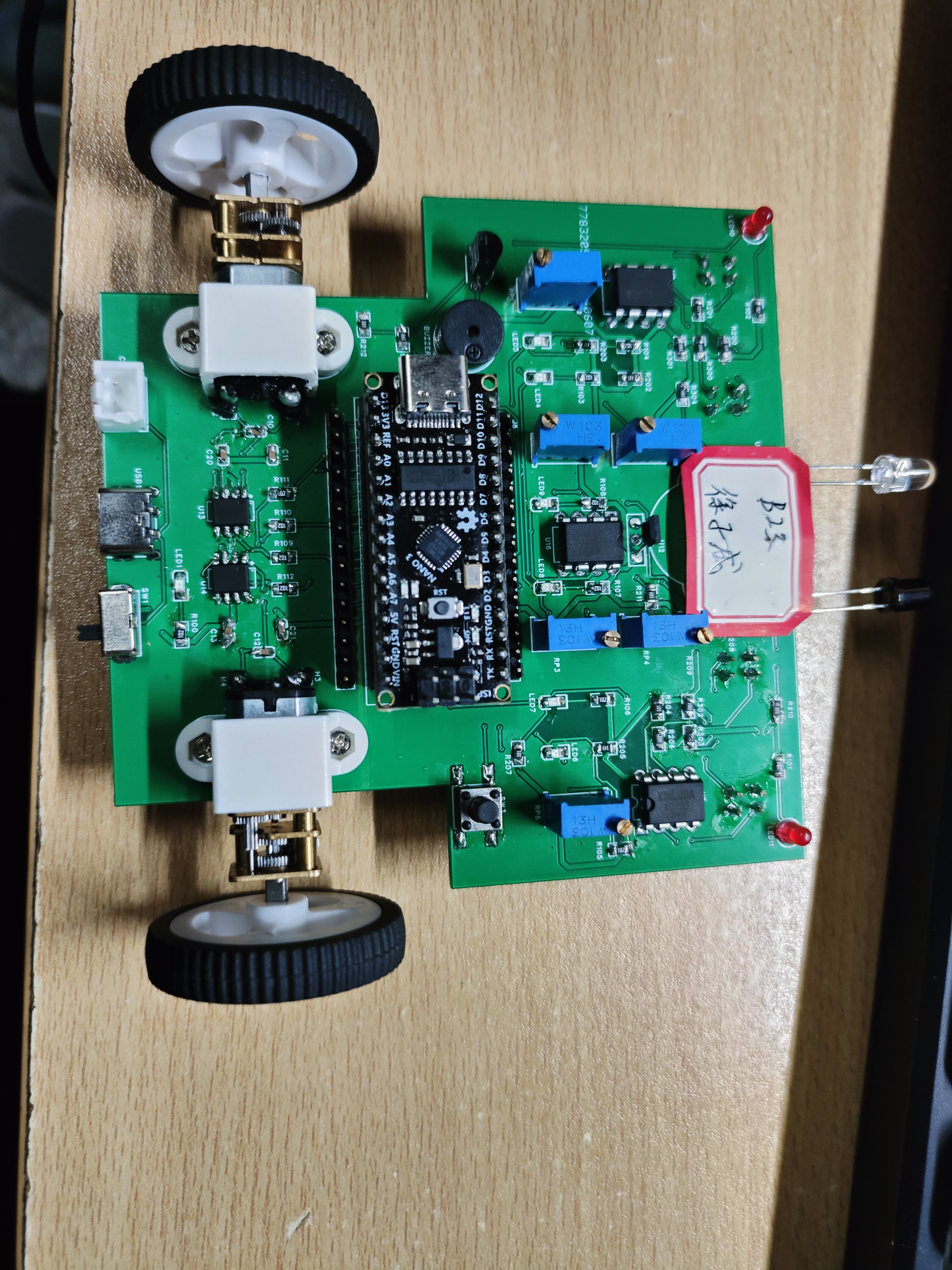

(Changshu Institute of Technology Electronic Engineering Competition) Project Name (Competition Problem) | B23
Members: Yang Dawei, Fang Jiayu, Xu Zicheng Title: Design and build a line-following robot to examine its road condition recognition, line-following control, and treasure-hunting algorithm design. The robot has a start button, which can be used to set the current working module to complete different design requirements. It emits a beep or flashes an LED indicator after completing each task.
Solution: Utilize a Nano board to control and coordinate different modules, including a main power supply, motor power supply, line-following circuit, buzzer, obstacle avoidance circuit, and Hall effect sensor.
First, initialize each module. Then, use a photosensitive sensor to adjust the wheel speed based on the different elevations of points on the path of different colors, thus controlling the robot's direction.
