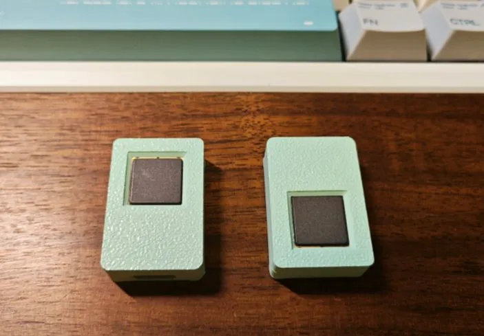

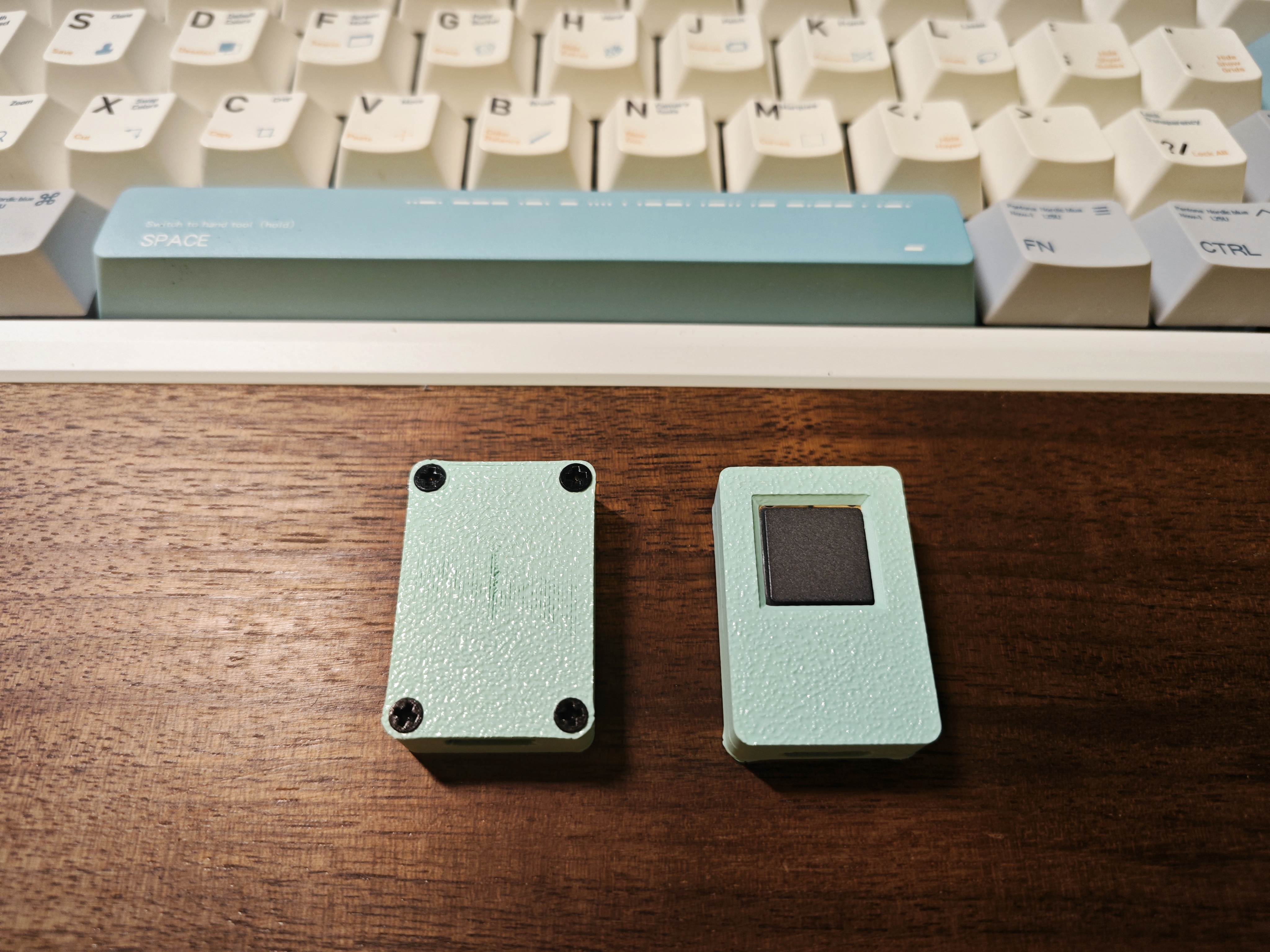

Windows Hello fingerprint module
This adapter board modifies the LDO of this module and replaces it with a more solderable enclosure
for mounting the fingerprint module. The module is a Synaptics fingerprint module. The enclosure is available at: [open source address missing].
Accessories include: M2*4, countersunk screws*4,
           FPC 0.5mm 8-pin 5cm Type A.

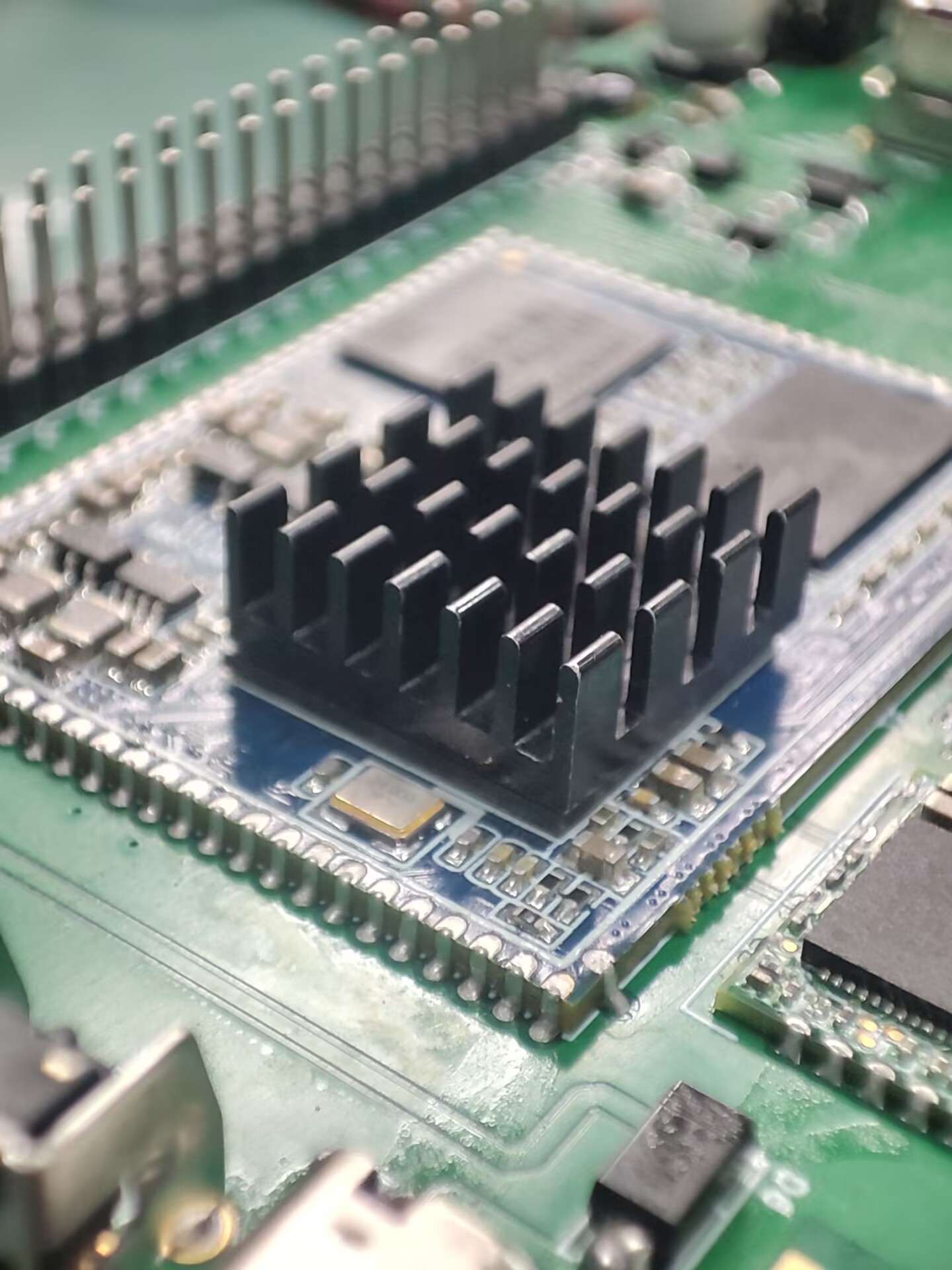

Note: After removing the core, apply a ring of low-temperature solder before using a heating pad to remove it; otherwise, the solder pads may come off.
Core board link:
[Xianyu link](https://m.tb.cn/h.gmuzAYJ?tk=4F4k3fUbgCF ZH4920) "Come grab a bargain! [Brand new Allwinner H3 development board, chip included, well-packaged, suitable for learning, includes casing and power supply]"
(Click the link to open directly)
Project Introduction:
This project was inspired by an Allwinner H3 core board I found on Xianyu (a second-hand marketplace). I designed it as a baseboard, and all basic functions have been tested and are working normally.
The project
features several GPIO and serial ports. I also added a spare Wi-Fi module. Antennas can be found on Taobao, although they don't need to be soldered.

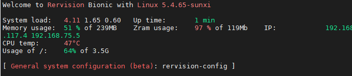

1. Firmware Burning Tutorial: First, burn the firmware to the SD card
. 2. Log in as root user. Do not log in first and then su root (I've already encountered this problem).
3. Execute in the terminal: nand-sata-install
4. Select 2 Boot from eMMC - system on eMMC

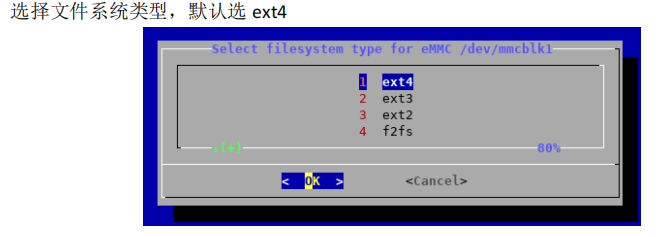

5. A prompt will pop up asking to erase the data on the eMMC. Select Yes
6. Select the file system type. The default is ext4.
7. Begin formatting and burning the system to eMMC.
8. Wait for burning to complete. Select "Power off" to shut down the device. After the blue indicator light on the board goes out, you can remove the TF card and power on again. The system will then boot from eMMC.

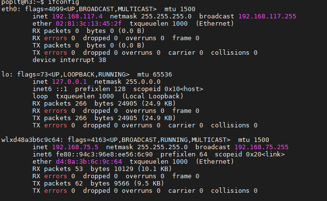

WiFi should boot normally and IP address should be obtained correctly.
Note:
Network port should be normal,
USB port should be normal,
serial port should be normal,
WiFi should be normal,
