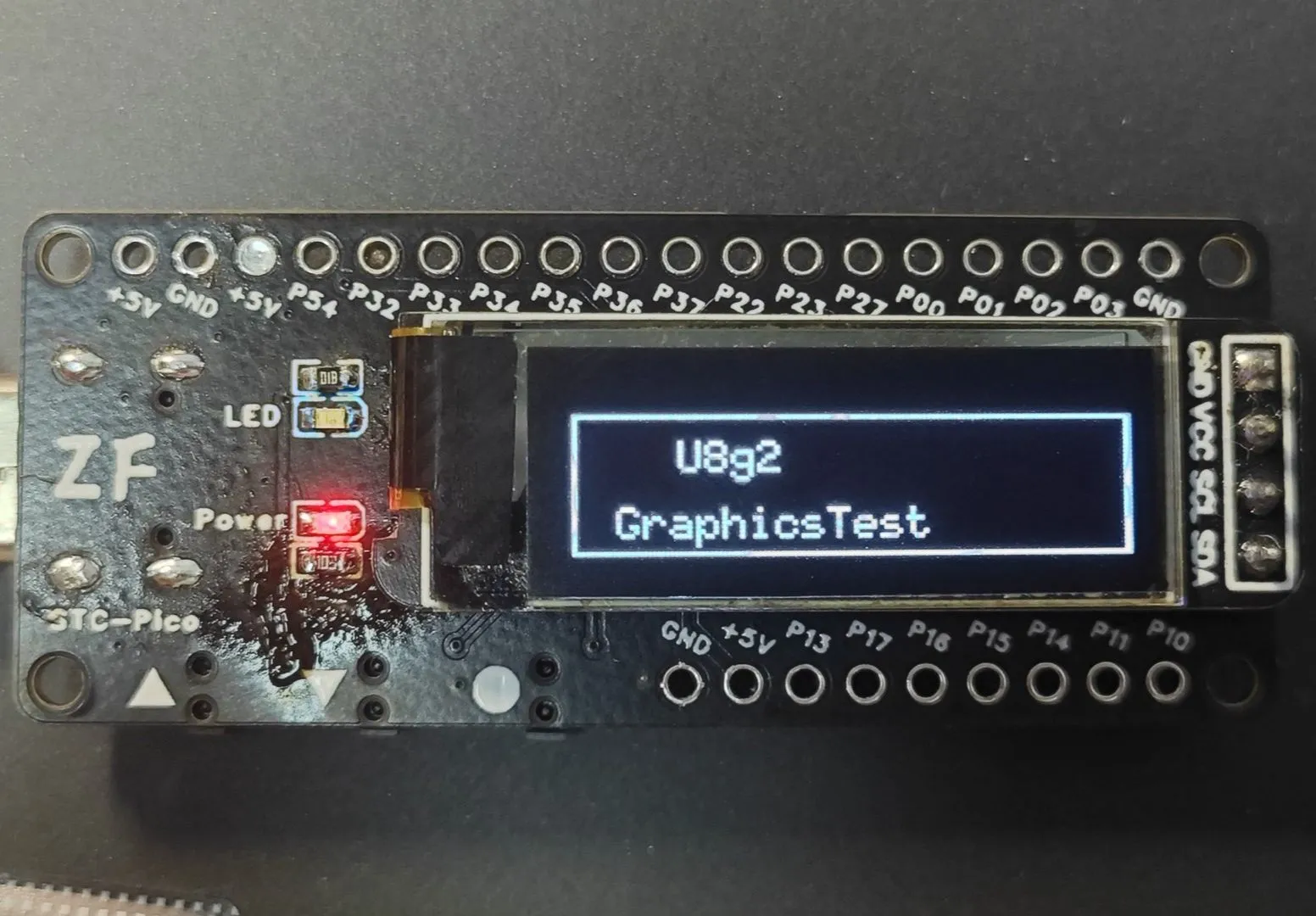

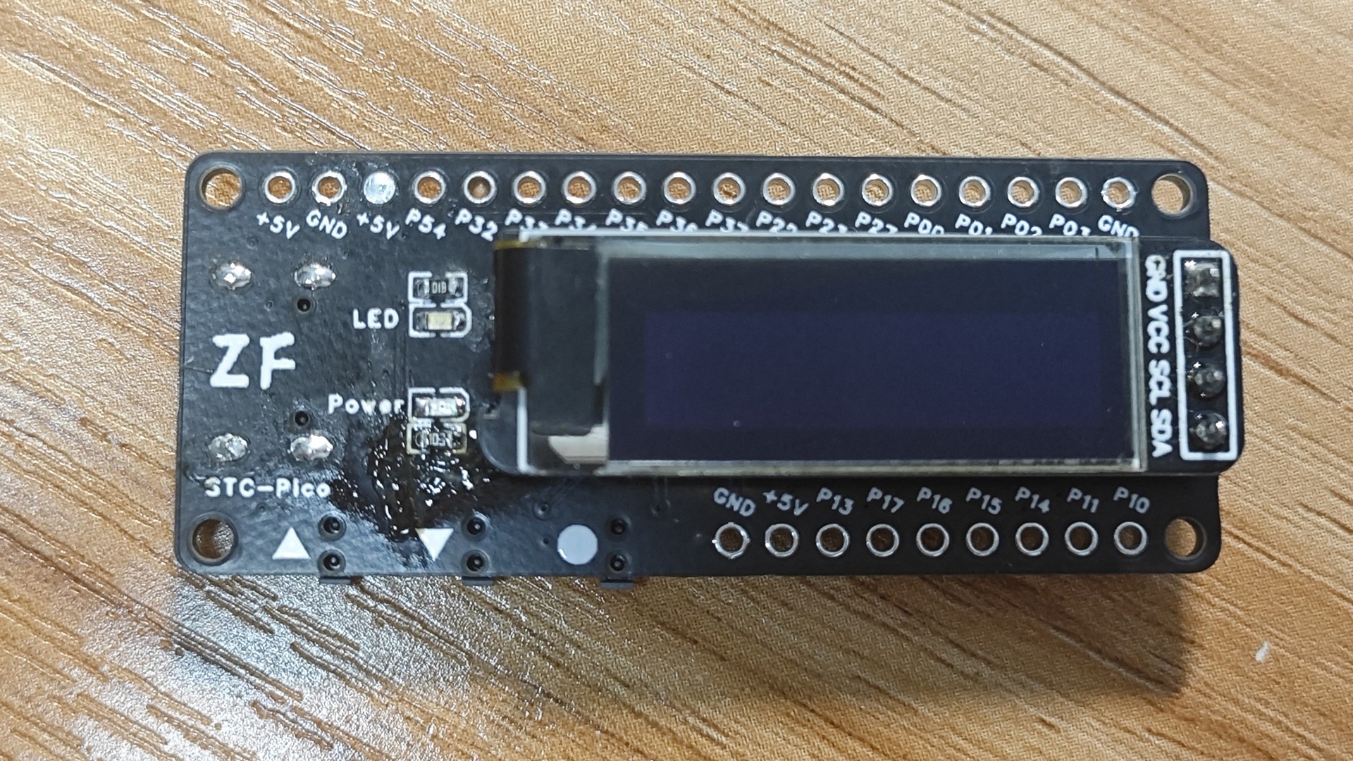

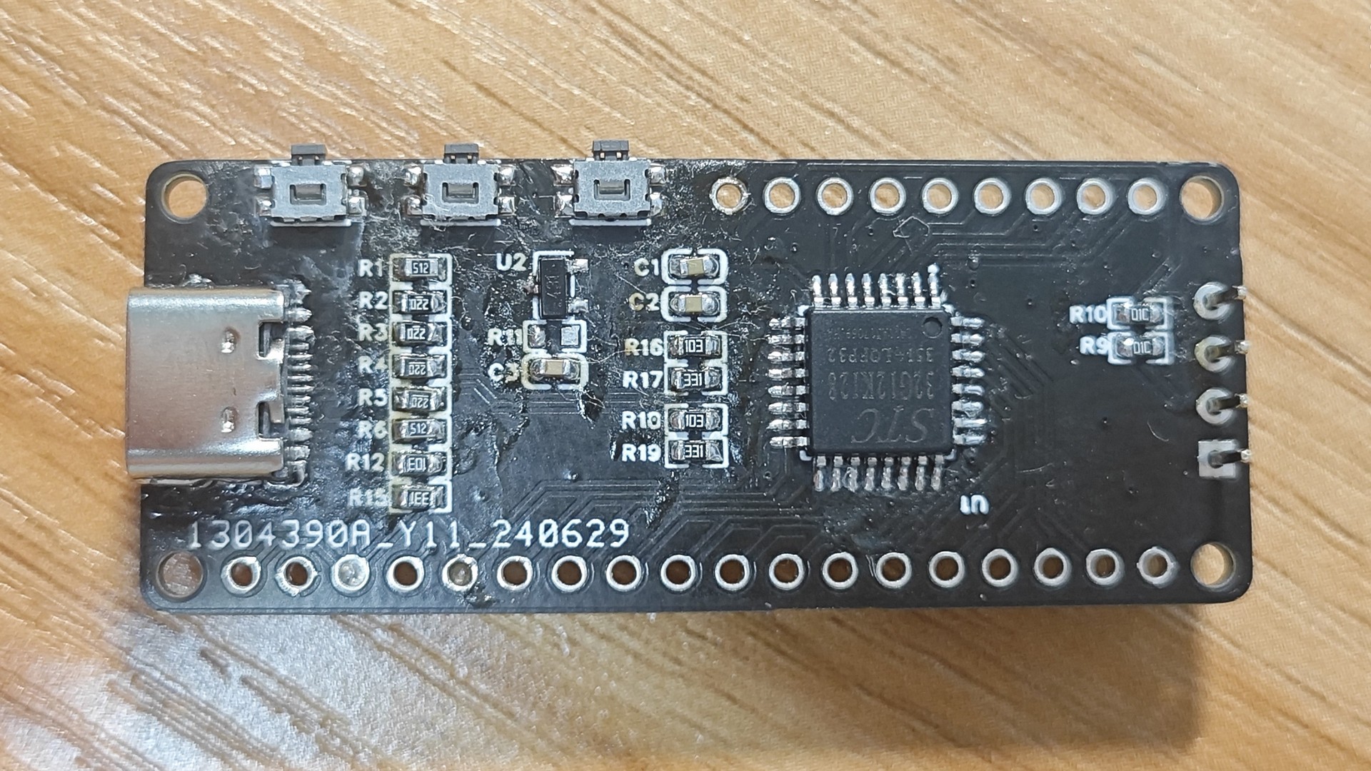

STC-Pico
The controller is a 32-bit STC32G12K128 microcontroller with an 8051 core. It features an onboard power indicator, a user LED, three buttons, and a 0.91" OLED_IIC through-hole interface.
Flexible design: all function pins are exposed for easy verification of various functions.
Convenient debugging: programs are programmed via a Type-C interface, eliminating the need for a separate programmer.

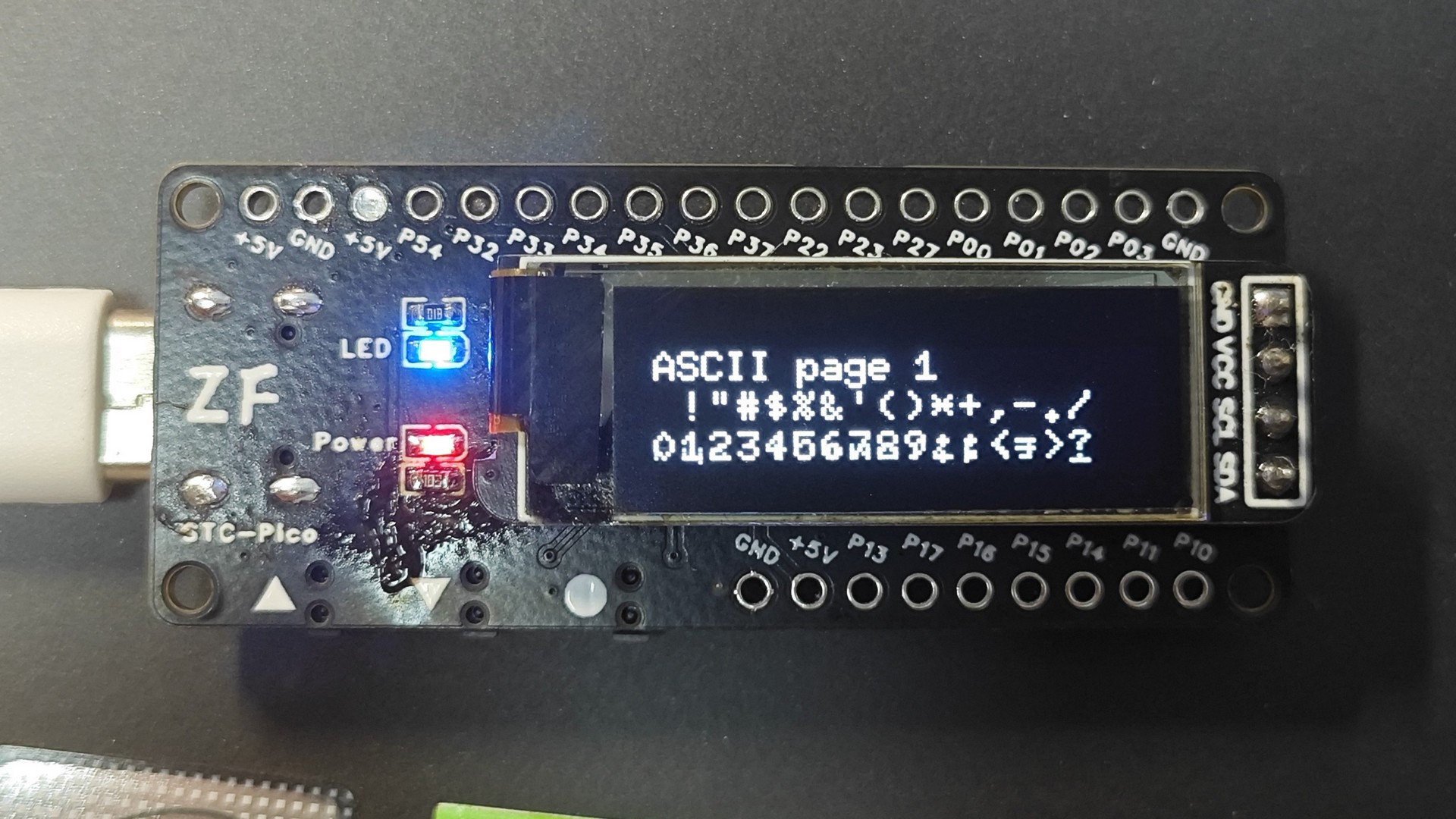

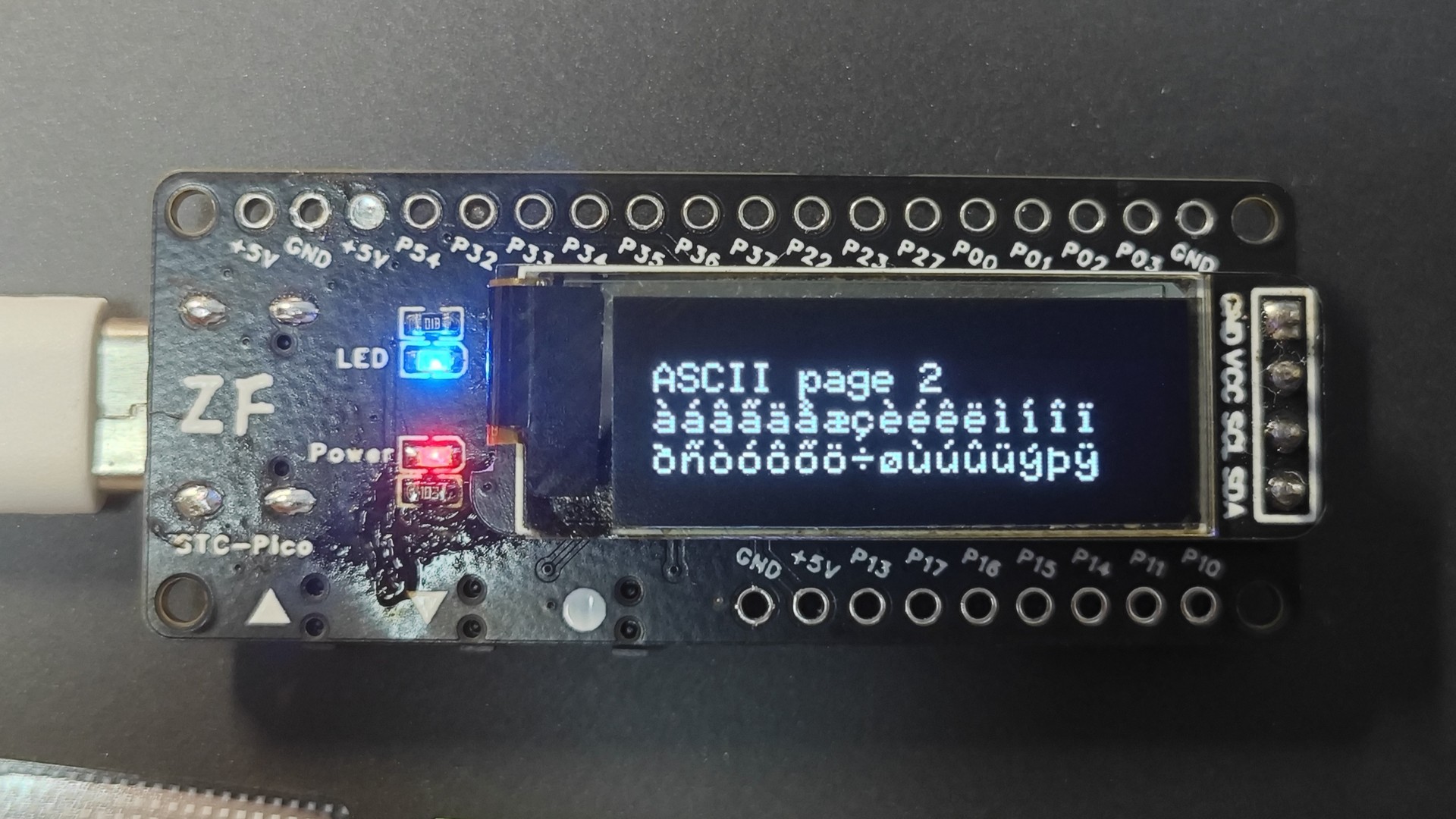

The official U8g2 program has been ported for testing; the source code is attached.
The three onboard buttons facilitate OLED menu development.
