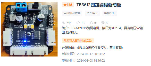

TB6612 Four-channel Encoding Driver
First version link:
https://oshwhub.com/fourteenzzh37/tb6612-four-way-coding-driver-bo

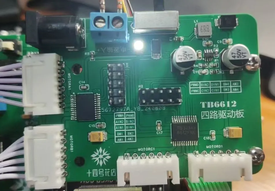

Driver Circuit:
The TB6612 is a dual driver, capable of driving two motors; two onboard drivers allow for driving four motors, with additional power supply available. Truth table for
driving
PWM1A (connected to the microcontroller's PWM port)
AIN1 0 0 1
AIN2 0 1 0
Stop forward/reverse
A01
AO2 connects to two pins of motor 1. Truth table for
driving
PWM2B (connected to the microcontroller's PWM port)
BIN1 0 0 1
BIN2 0 1 0
B01
BO2 connects to two pins of motor 2.
The other two paths are similar.

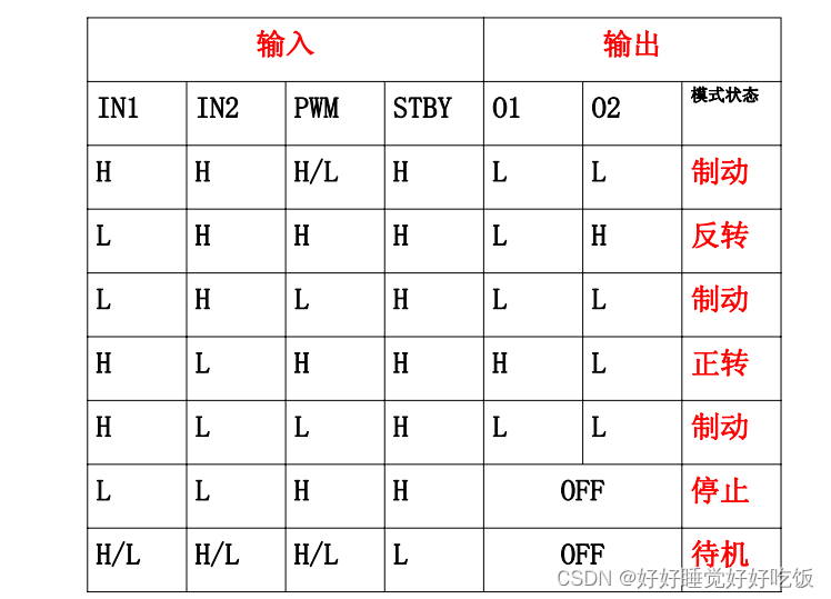

The logic truth table
is as follows: When the STBY port is connected to the microcontroller's I/O port, clearing it stops all motors.
