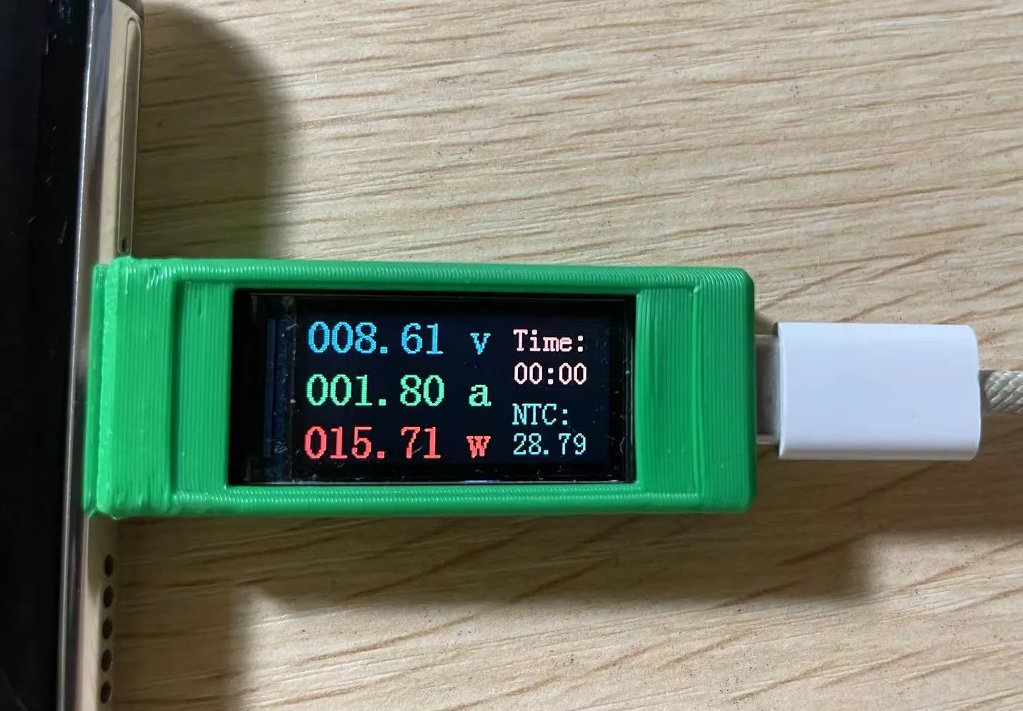

The voltage and current meter based on CW32L031F8U6 can measure voltage (3-28V) and current (0-5A). It has an onboard NTC for temperature measurement and can display system running time and other data. The display device is an ST7735 TFT color screen.
Project Parameters
This design uses CW32L031F8U6 as the main controller. CW32L031F8U6 is a low-power product in the CW32 series. However, this project does not actually use its low-power function.
This design uses an LCD color screen with ST7735 as the main controller, which can display current, voltage, power, inter-board temperature data, and system running time.
This design utilizes TI's high-end current sampling chip INA226, which supports a voltage range of 0-28V.
Board temperature detection is achieved using a 10K NTC circuit with a B value of 3950, and temperature data corresponding to the resistance value is obtained through linear interpolation.

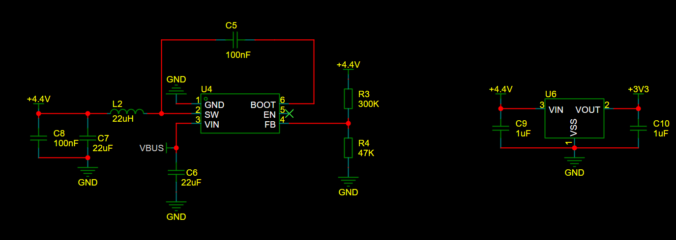

Figure 1 – Power Supply Circuit:
A Type-C male connector is used as the output, and a female connector as the input power. The input power supply is lowered to 4.4V by a BACK circuit controlled by a TPS54202, and then further reduced to 3.3V by an XC6206 to power the entire system.

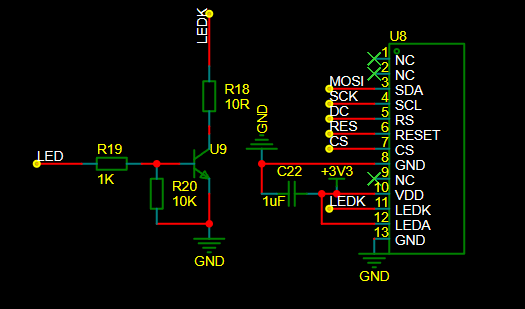

Figure 2 - LCD Circuit:
The display section of this project uses a 0.96c-inch LCD with an ST7735 main controller as the display device. Power data acquired by the MCU and board temperature data and system running time acquired by the NTC circuit are displayed on the LCD.

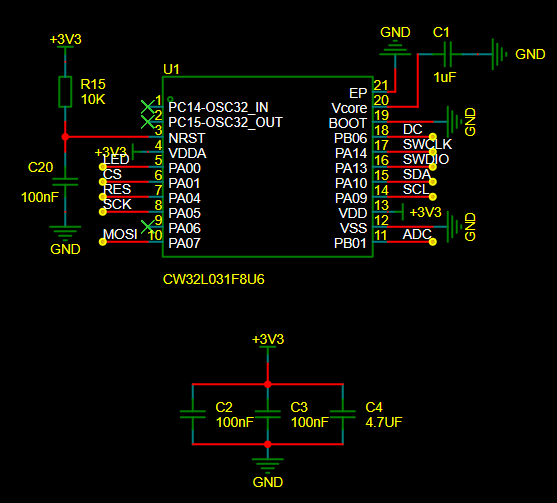

Figure 3 - MCU Circuit:
This project uses the low-power CW32L031F8U6 from the CW32 series as the main controller. Its internal high-precision clock source saves the need for an external crystal oscillator. Decoupling capacitors are added to its power supply pins according to the datasheet requirements. Its ADC is used to acquire the NTC voltage to obtain its temperature data. Power data is obtained through IIC communication with the INA226, and the data is displayed on the screen through SPI communication with the LCD.

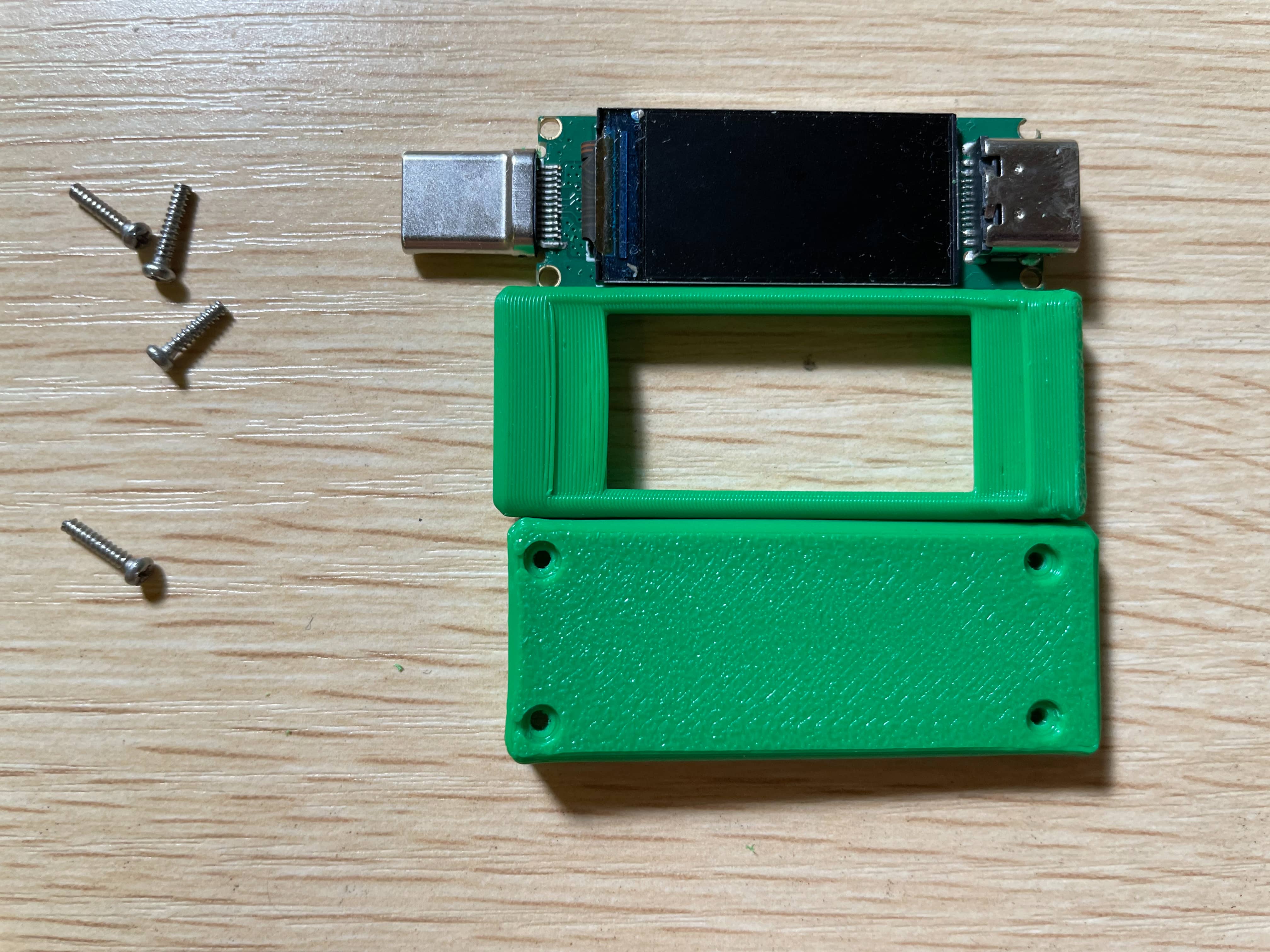

For the PCB, select a board thickness of 0.8mm; otherwise, the TYPEC male connector cannot be soldered. The layout is relatively dense; those unfamiliar with soldering can use a stencil.
Assembly Process:

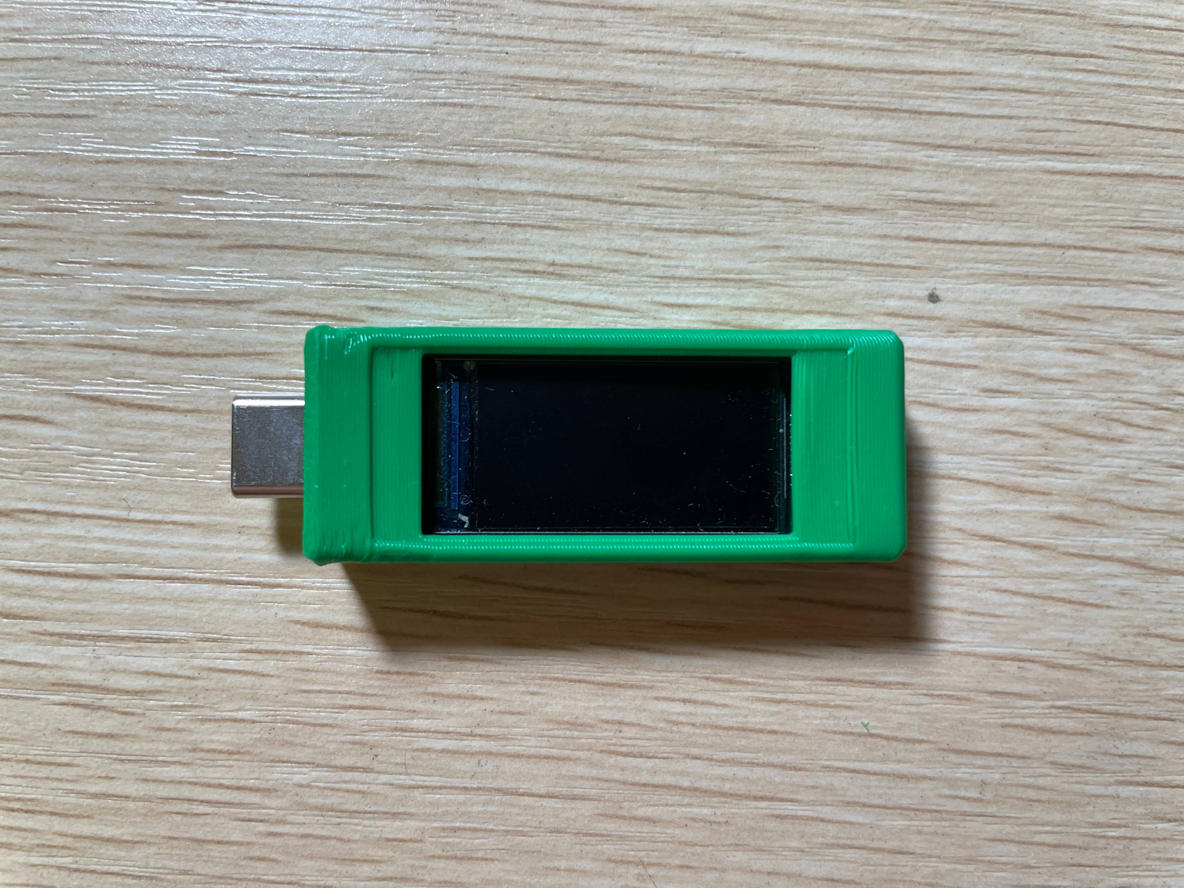

Assembly is very simple; after printing the attached package shell file, simply screw it on.
Actual Product Image
