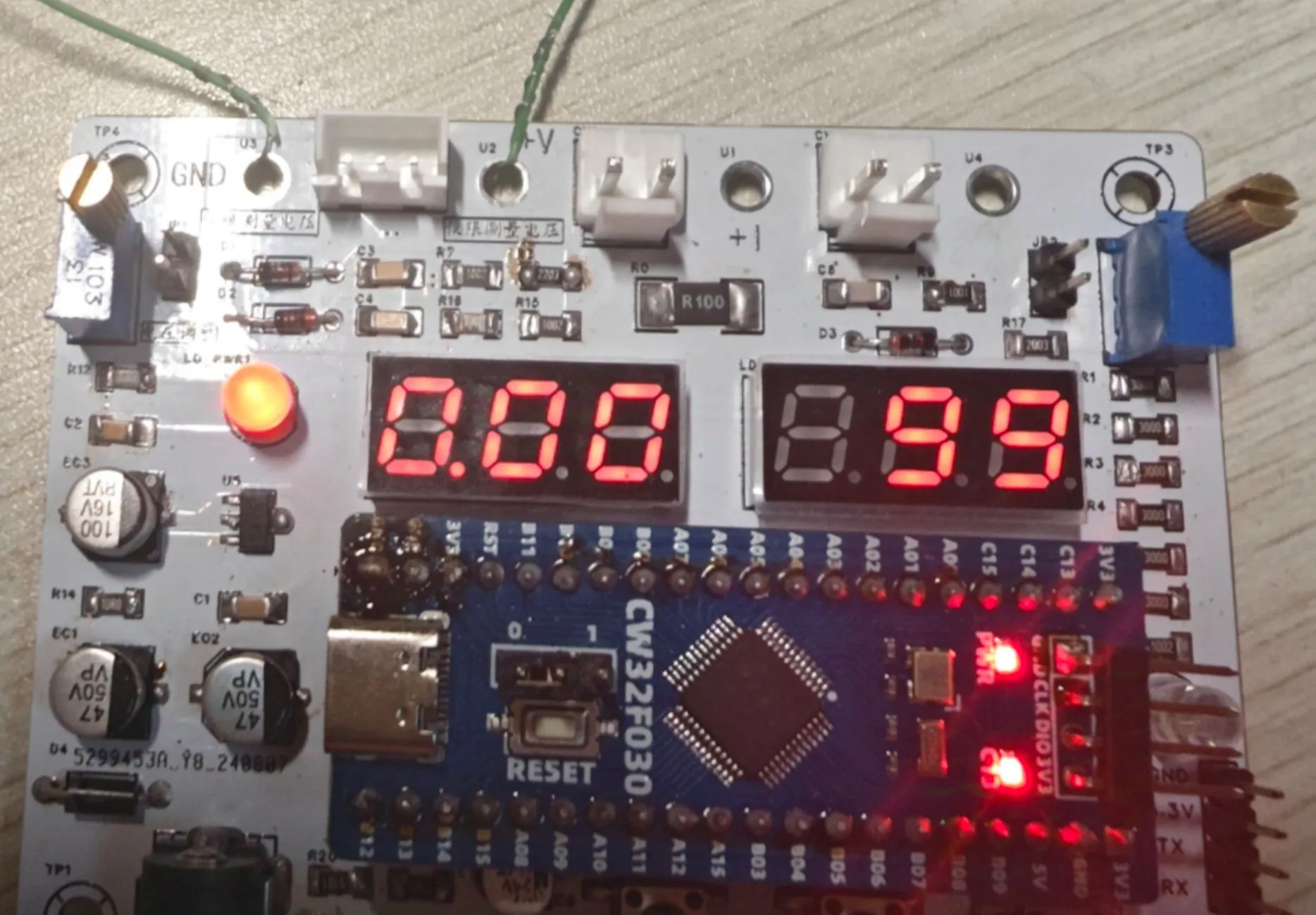

Project Overview:
This product is a voltage and current meter designed using the CW32 LCSC Diwenxing development board as its core. It features simultaneous measurement, calibrability, and multiple power supplies.
Project Attributes:
This product is available in through-hole and surface-mount versions. The surface-mount version achieves the same functionality with higher density and features a 3D shell design. It also adds a widely used USB-C interface as a power option to improve usability.
Hardware Part:
Wide Input Module
Through-hole and Surface-mount Versions)
Overall Routing: For both through-hole and surface-mount
versions , it is recommended to start with smaller components and solder the through-hole components last. Note that the USB-C connector is relatively difficult to solder; if your soldering skills are average, it is recommended to omit this function. The overall soldering difficulty of the board is relatively low. Software Part: Keil 5 is used for programming and function implementation. Material Selection Plug-in Version Quantity Comment Designator Footprint Value Manufacturer Part Manufacturer Supplier Part 3 100nF C1,C2,C5 CAP-TH_L5.0-W2.5-P5.00-D1.0 100nF CC1H104MC1FD3F6C10MF Dersonic (DERC) C254085 2 10nF C3,C4 CAP-TH_L4.8-W3.2-P5.08-D1.2 10nF CC1H103ZC1ED3F4D1100 Dersonic (DERC) C2761727 1 100pF C6 CAP-TH_L5.0-W2.5-P5.08-D0.7 100pF CC1H101KC74DSL4B10MN Dersonic (DERC) C254079 2 100nF C7,C8 C0805 100nF CC0805KRX7R9BB104 YAGEO (国巨) C49678 1 ZX-XH2.54-3PZZ CH1 CONN-TH_3P-P2.54_2501S-3P ZX-XH2.54-3PZZ Megastar (兆星) C7429633 2 M3960V-02P CN1,CN2 CONN-TH_2P-P3.96_B4P-VH-B-LF-SN M3960V-02P XFCN (兴飞) C492513 3 1N4148 D1,D2,D3 DO-35_BD2.0-L4.2-P8.20-D0.5-RD 1N4148 LGE (鲁光) C402212 1 1N5819 D4 DO-41_BD2.4-L4.7-P8.70-D0.9-RD 1N5819 LGE (Luguang) C402218 1 DC-005-2.5A-2.0 DC CONN-TH_DC-005-2.5A-2.0 DC-005-2.5A-2.0 XKB Connection (China Xingkun) C319099 2 47uF EC1,EC2 CAP-TH_BD6.3-P2.50-D1.0-FD 47uF KS476M050E07RR0VH2FP0 CX (Chengxing) C45100 1 100uF EC3 CAP-TH_BD6.3-P2.50-D1.0-FD 100uF KS107M016E07RR0VH2FP0 CX (Chengxing) C43805 2 22850120ANG1SYA01 H1,H2 HDR-TH_20P-P2.54-VF 22850120ANG1SYA01 JILN (Jinling) C429947 1 PZ254V-11-04P H3 HDR-TH_4P-P2.54-VM PZ254V-11-04P XFCN (Xingfei) C492403 2 B-2100S02P-A110 JP1,JP2 HDR-TH_2P-P2.54-VM-1 B-2100S02P-A110
