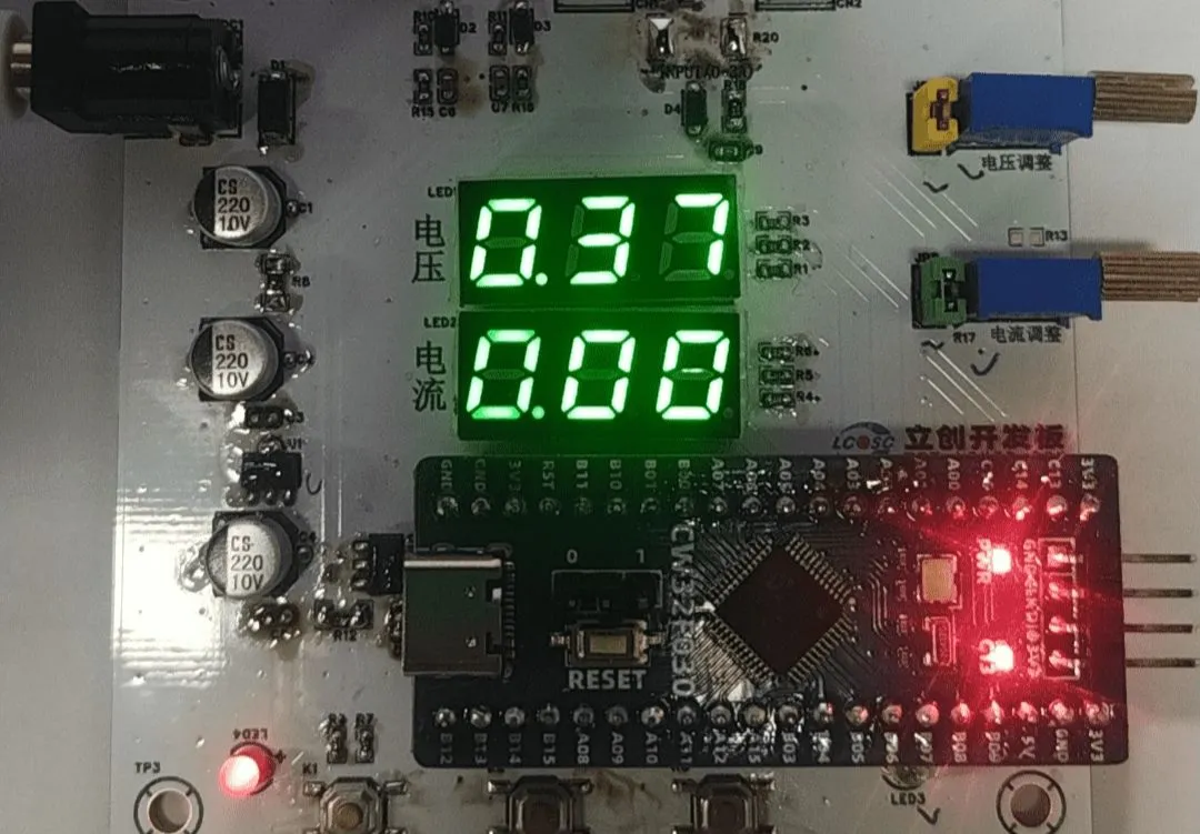

1.1 Main Control Unit
This project uses the CW32F030C8T6 Diwenxing minimum system board as the main control unit. The main control chip has a maximum clock frequency of 64MHz, 64KB FLASH, and 8KB RAM. A total of 26 I/O ports are used in this project: 14 pins for digital tube display, 3 pins for button control, and 4 pins for ADC conversion.

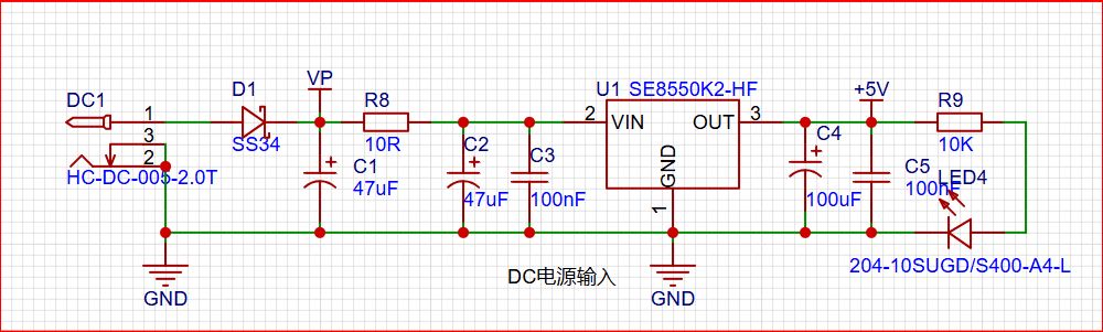

1.2 Power Supply Unit
1. This circuit uses an LDO as the power supply, selecting the SE8550K2 with a maximum input voltage of 40V. The main reason for not using a DC-DC step-down circuit to handle large voltage differences is to avoid introducing DC-DC ripple interference during the design process; a secondary reason is to reduce project costs.
2. The capacitors surrounding the LDO play an important role in filtering, improving load transient response, phase compensation, preventing oscillation, ripple suppression, and controlling startup surge current. By properly matching the external capacitors, the stability and performance of the entire circuit can be ensured.
3. Connecting a diode in series at the power input effectively prevents reverse power connection damage to key components. Connecting a 10Ω resistor in series for voltage division acts as a low-resistance fuse and reduces power-on surge peaks, effectively protecting downstream circuitry.

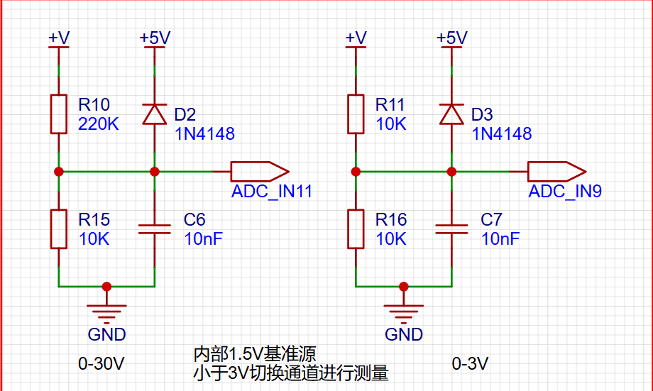

1.3
Selection of voltage divider resistor for voltage acquisition: The maximum voltage to be measured is 30V, and the ADC reference voltage is 1.5V. The calculated voltage division ratio is 1.5V/30V = 0.05. To reduce circuit power consumption, a 10K resistor is selected for the low-side side. Calculating 0.05 = 10kJ/(190K + 10K), the closest but greater standard resistor is selected as 220KJ.
Application of clamping diode: To protect the MCU from damage, an additional 1N4148 diode is added as a clamping diode. The forward conduction characteristic of the diode limits the voltage in the circuit to the forward voltage drop (typically 0.7V), achieving a protective function.
Measurement range switching introduces an additional voltage sampling circuit. This voltage sampling circuit uses the ADC_IN11 channel to measure voltages up to 30V. If the measured voltage is within the 0~3V range, the system will switch to the ADC_IN9 channel for measurement. Due to the reduced voltage division ratio, smaller voltage measurements can obtain more accurate values.

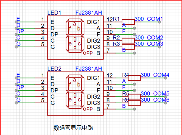

1.4 The digital tube display section
uses two 0.28-inch three-digit common-cathode digital tubes as display devices. Compared to a display screen, digital tubes have better recognition and are easier to identify in complex environments. Digital tubes have better mechanical properties and are less susceptible to damage from external forces. The size of the current-limiting resistor can be adjusted according to different environmental requirements to achieve higher brightness. In this project, the current-limiting resistors (R1~R6) for the digital tube are selected as 300Ω, which ensures good visibility and soft brightness.

Three: Physical verification part
VID_20240824_150410.mp4
VID_20240824_164018.mp4
