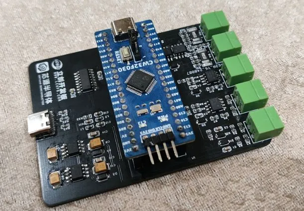

This project uses the LCSC CW32F030C8T6 development board to design a voltage and current acquisition module. It supports 0-30V, ±5V, and ±1.5V voltage measurement, and two-channel ±1A current measurement. Data can be displayed via a serial port to a host computer, and an LCD display port is added to display the measurement data.
Project Functionality
This design is based on a voltage and current acquisition module designed using the LCSC CW32F030C8T6 development board. Utilizing operational amplifiers such as TL082 and TLV2372, it supports 0-30V, ±5V, and ±1.5V voltage measurement, and two-channel ±1A current measurement; data can be displayed via a serial port to a host computer or an LCD display.

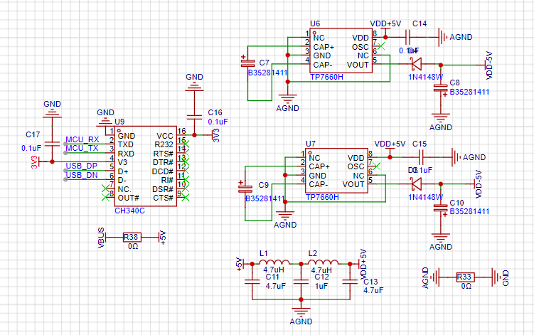

First, the power supply uses Type-C. Diode protection is not included because the supply voltage is 5V, and the voltage drop would be insufficient for the operational amplifiers. Two TP7660H chips generate a negative voltage to power the operational amplifiers, which, when connected to the development board, provides a 3.3V power supply to the LCD display and the CH340C serial communication chip. Partial circuit diagrams are shown below.
Figure 1 – Power Supply Circuit:
A TYPE-C-16P interface is used as the power supply interface, and the corresponding USB data pins are connected to the corresponding USB pins (USBD+) and (USBD-) of the CH340. 5.1K pull-down resistors are added to the CC1 and CC2 pins for easy identification and configuration by different host devices. Two TP7660H chips are used to generate negative voltage to power the operational amplifier.

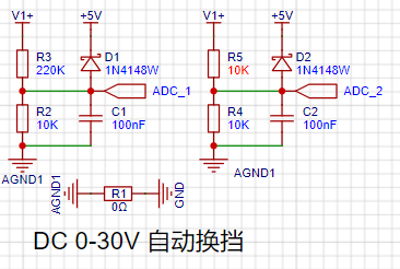

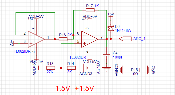

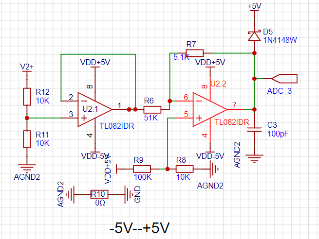

Next is the voltage acquisition circuit. The 0-30V voltage acquisition voltage is based on the official engineering case. Automatic range switching is available for 0-3V voltage measurement to perform low-voltage measurements. For ±5V and ±1.5V voltage measurements, a TL082 is used as the ADC preamplifier, with an operational amplifier used as a voltage follower for impedance matching. The signal is then attenuated and DC biased through an inverting circuit. As shown in the following figures:
Figure 2 - Voltage Acquisition Circuit.

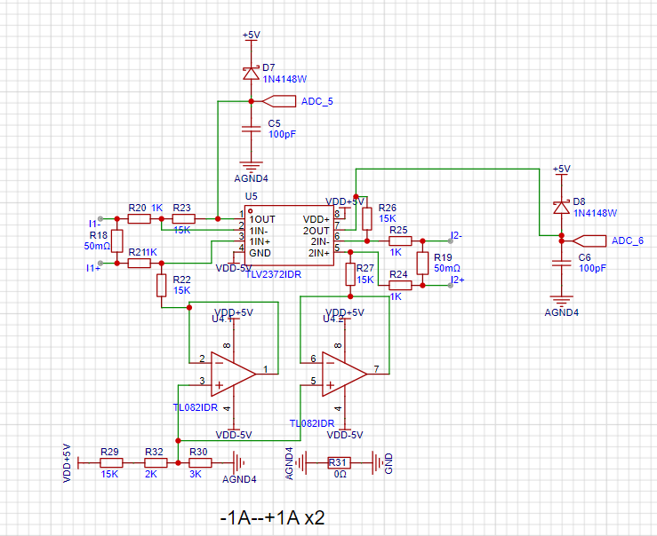

The current acquisition circuit uses a 50mΩ sampling resistor. The voltage of the sampling resistor is acquired through a TLV2372 differential input to measure the current, allowing for the measurement of two current data streams. A bias is provided through a TL082 to measure negative currents. The circuit is shown below, theoretically capable of measuring a current range of ±1A.
Figure 3 - Current Acquisition

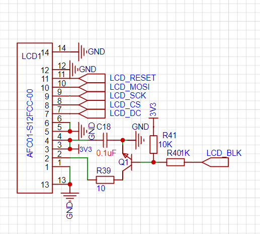

Circuit. Serial communication samples the CH340C chip. Due to integration issues with the development board, one-click serial download is not currently supported. The screen interface supports the 12-pin SPI protocol. FPC terminals are designed for wiring. The circuit diagram is shown below:
Figure 4 - LCD Display Circuit.

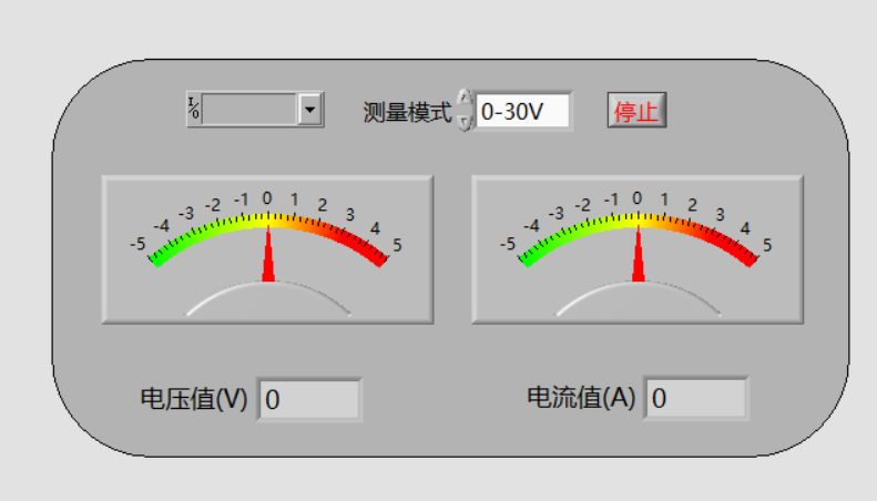

LabVIEW host computer

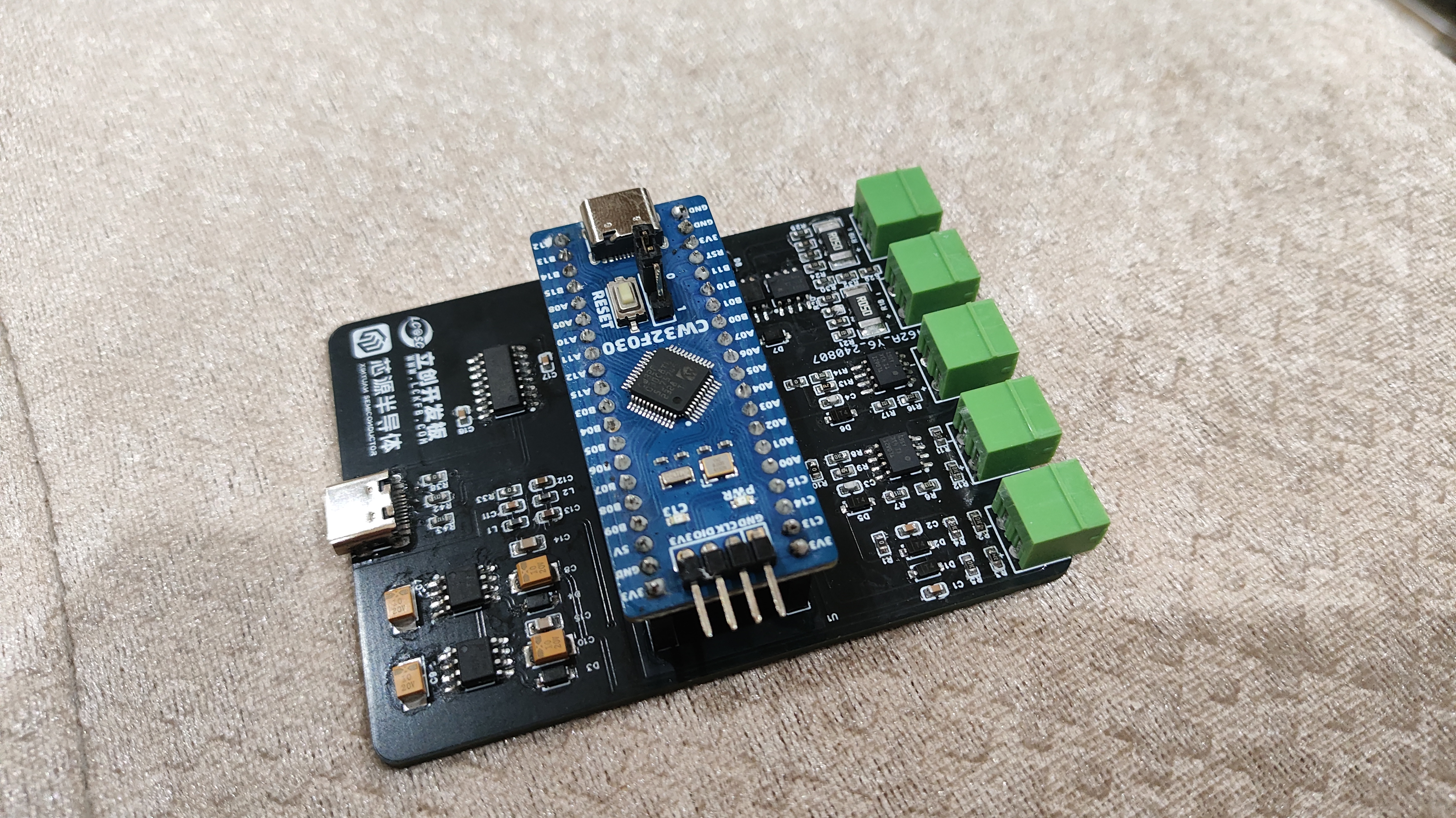

physical diagram .
Complete physical diagram.
