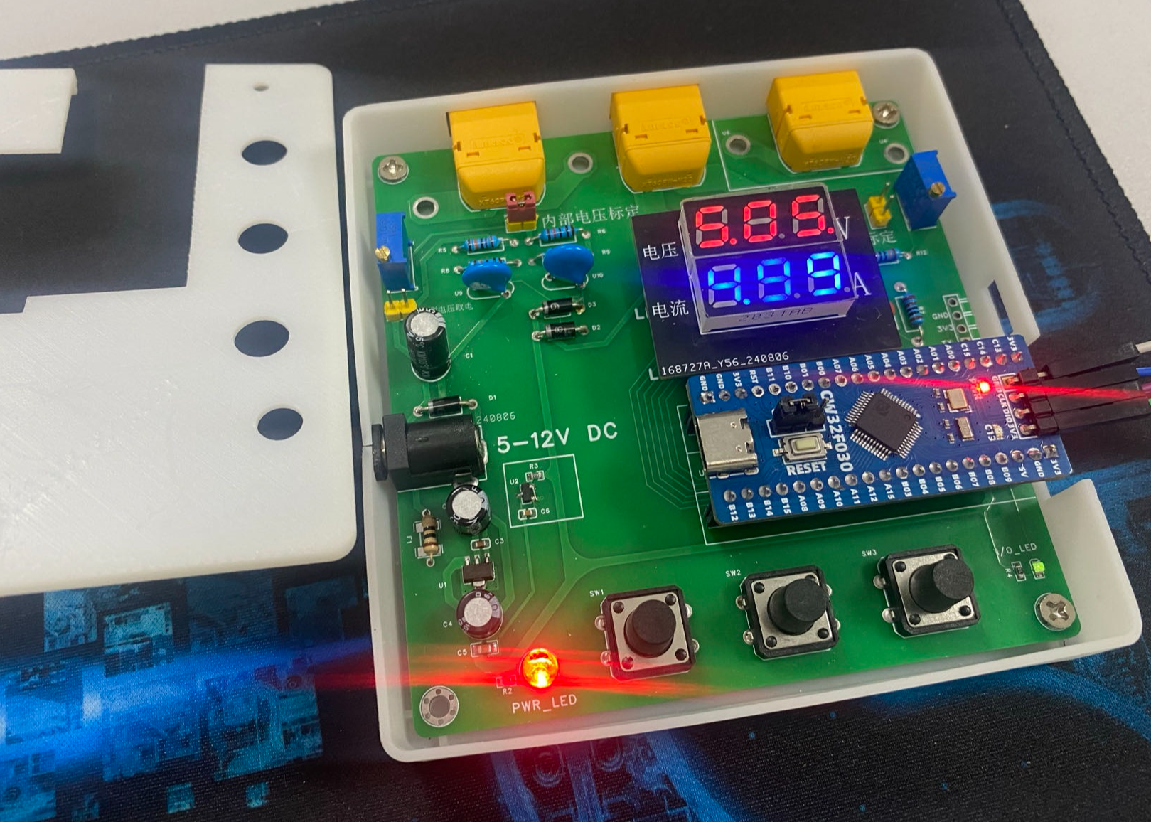

   Learning to design and build a digital voltmeter and ammeter is highly beneficial for improving personal professional skills. The digital voltmeter and ammeter project covers multiple aspects, including microcontroller circuit design and implementation, signal acquisition and processing circuit design, user interface development and optimization, and product appearance design. It integrates knowledge from multiple fields such as electronic technology, microcontroller programming, circuit design, and industrial design. This project has the following highlights:
It adopts a core board plus expansion board design concept and uses plug-in device design, making learning simpler and exploration more in-depth;
the core board uses the domestic Wuhan Xinyuan Semiconductor CW32 as the main controller, while also being compatible with other similar development boards; however, the CW32 has advantages in ADC sampling.
The project has a high degree of integration and strong practicality; after completion, it can be used as a desktop everyday instrument;
the project has abundant learning materials, including circuit design tutorials, PCB design, code programming learning, and training for engineers' debugging abilities. III. Hardware Design

  This project uses two 0.28-inch three-digit common-cathode digital tubes as display devices. Compared to displays, digital tubes offer better visibility in complex environments. Depending on the specific needs of the operating environment, smaller current-limiting resistors can be used to achieve higher brightness. Furthermore, digital tubes have better mechanical properties and are not as easily damaged by external forces as displays. They are commonly used in industrial applications requiring stability and reliability. From a development board learning perspective, this makes it easier to purposefully learn about electronic measurement principles and related development.
  In this project, actual testing showed that the current-limiting resistors (R1~R6) of the digital tube were configured to 300Ω. The corresponding brightness, whether for red or blue digital tubes, provided good visibility and a soft, non-glaring light.
This digital tube design uses a small board connection, as shown in the diagram below.
  In terms of software, this project uses dynamic scanning to drive the digital tube. Therefore, at any given time, only a maximum of 8 segments of the digital tube (or LEDs) are lit, or in other words, only one digit is lit. According to the design, the required driving current is approximately 11mA (IO port high-level voltage 3.3V ÷ 300Ω). The CW32 MCU's single I/O pull-up/sink current capability can reach 25mA (see the official datasheet). Therefore, this design is feasible.

11. Brief Usage Instructions:
The circuit board has three large switches: K1 for switching display modes, K2 for setting and saving the reference value for the corresponding mode, and K3 for returning to normal mode.
Mode 0: Normal operating mode, displays the measured voltage and current values.
Mode 1: 5V voltage calibration value; the upper digital tube displays 5.05, and the lower tube displays the currently measured voltage value. Use a high-precision multimeter to measure and adjust the voltage potentiometer until 5V is displayed. Press K2 to write the current calibration value.
Mode 2: 15V voltage calibration value; the upper digital tube displays 5.15. Calibrate using the same method as for 5V, and press K2 to write the current calibration value.
Mode 3: Current 0.5A calibration value. The upper digital display shows A.0.5, and the lower display shows the currently measured current value. Use a high-precision multimeter to measure the current, adjust the external current value to 0.5A, press K2, and write the current calibration value.
Mode 4: Current 1.5A calibration value. The upper digital display shows A.1.5, and the lower display shows the currently measured current value. Use a high-precision multimeter to measure the current, adjust the external current value to 1.5A, press K2, and write the current calibration value.
