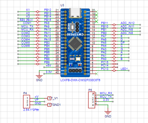

2.1 Main Control Chip Selection
This project selects the CW32F030C8T6 microcontroller as the main control chip. This chip features a high-performance ARM Cortex-M0+ core and rich built-in peripheral interfaces, including ADC, UART, and I2C, meeting the requirements of this project.

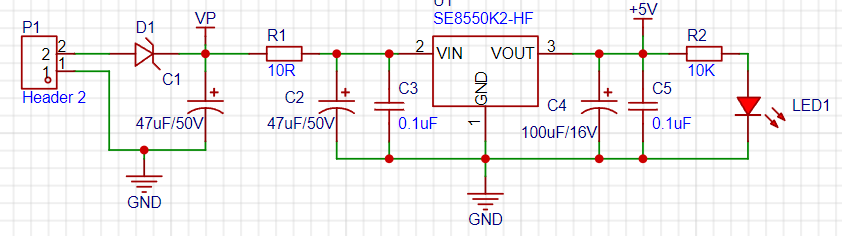

2.2 Power Supply Design
Considering that the voltmeter may be used in industrial scenarios with 24V or 36V power supplies, this design uses the SE8533K2 as the power supply chip, supporting a maximum input voltage of 40V. To reduce the heat generation of the LDO under large voltage drops, a small series resistor (10Ω) is added for voltage division. Simultaneously, a separate copper foil area is set under the LDO's heat dissipation pad, and heat is dissipated through vias to improve power efficiency.

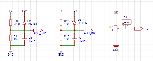

2.3 Voltage Acquisition Circuit The
voltage acquisition circuit uses a voltage divider circuit to achieve high voltage acquisition. The voltage divider resistors are designed to be 680KΩ and 10KΩ, with a voltage division ratio of 69:1 (approximately 0.0145). The voltage value after voltage division is read by the ADC, and the actual voltage value is calculated by the program. Considering the possible fluctuations in the measured power supply, a 0.1uF filter capacitor is connected in parallel with the low-side voltage divider resistor to improve measurement stability.

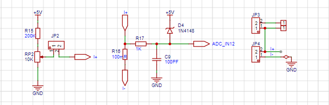

2.4 Current Acquisition Circuit
The current acquisition circuit adopts the low-side current sampling method, and the sampling resistor is connected to the meter ground. According to the maximum value of the designed measured current (3A) and the voltage difference limit of the current sensing resistor (generally not exceeding 0.5V), a 100mΩ sampling resistor is selected. The voltage value on the sampling resistor is read by the ADC, and the actual current value is calculated. Considering the limitations of the surface-mount sampling resistor in high current scenarios, a constantan wire through-hole pad is reserved for replacement according to the actual use scenario.

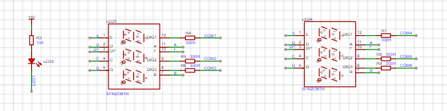

2.5 Display Module
The display module adopts a seven-segment digital tube to display voltage and current data in real time. It has the characteristics of high contrast, low power consumption and fast response, which is suitable for the display requirements of this project.
