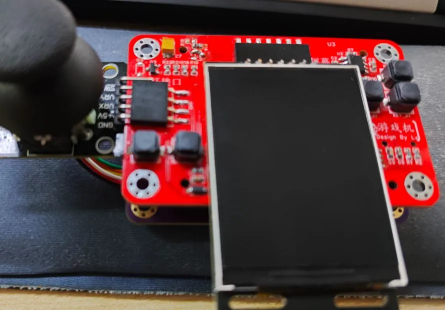

Liangshan School Game Console Expansion Board + 2-inch Screen + External Joystick

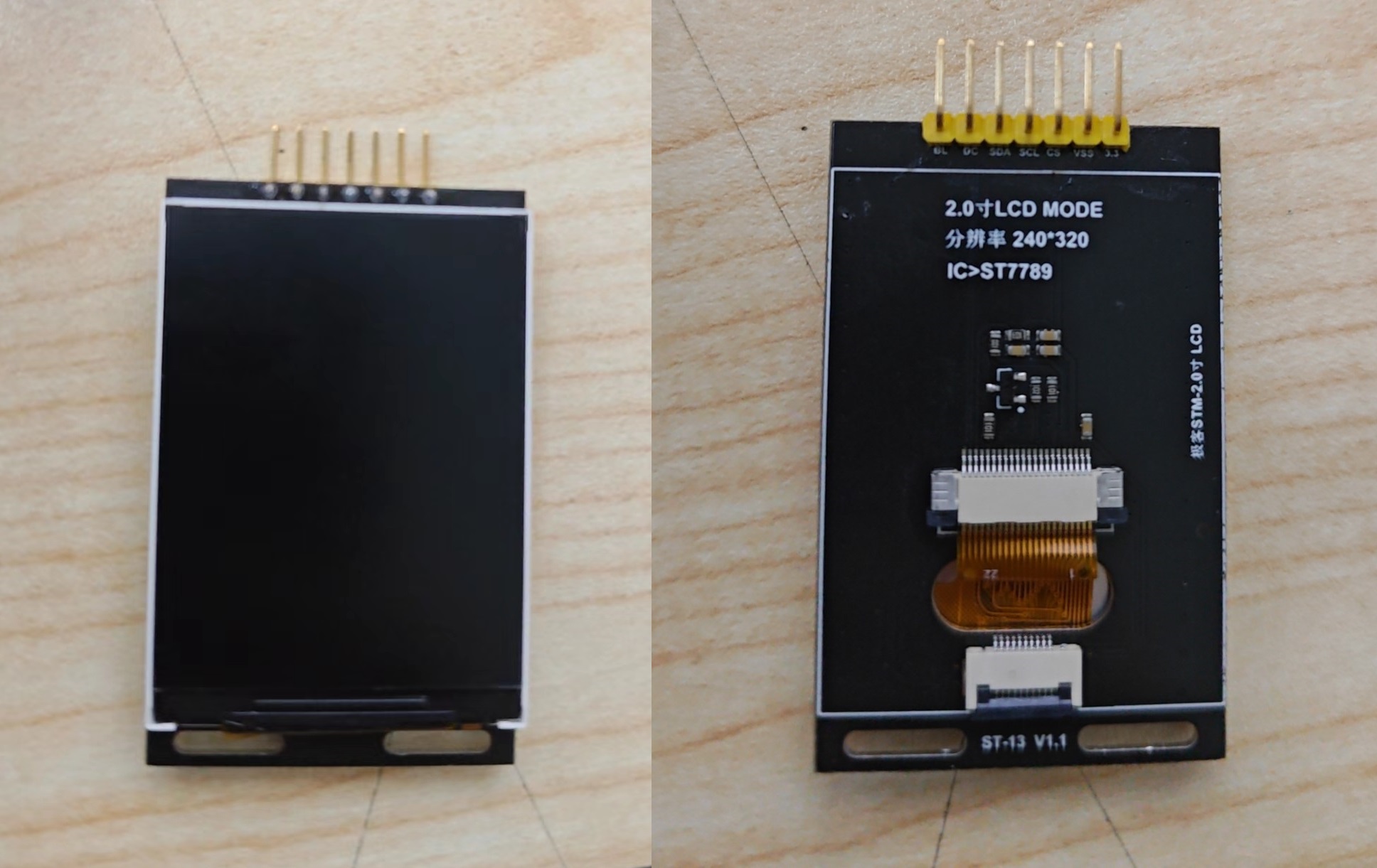

First, the screen. It's a 2.0-inch LCD screen, ST7789. The module porting manual mentioned someone had already programmed for this screen, and I initially thought I could just copy and use it. However, inexplicably, the screen wouldn't light up.

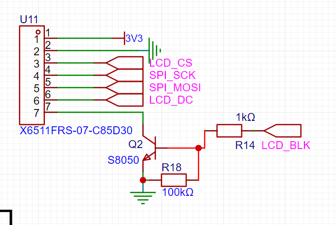

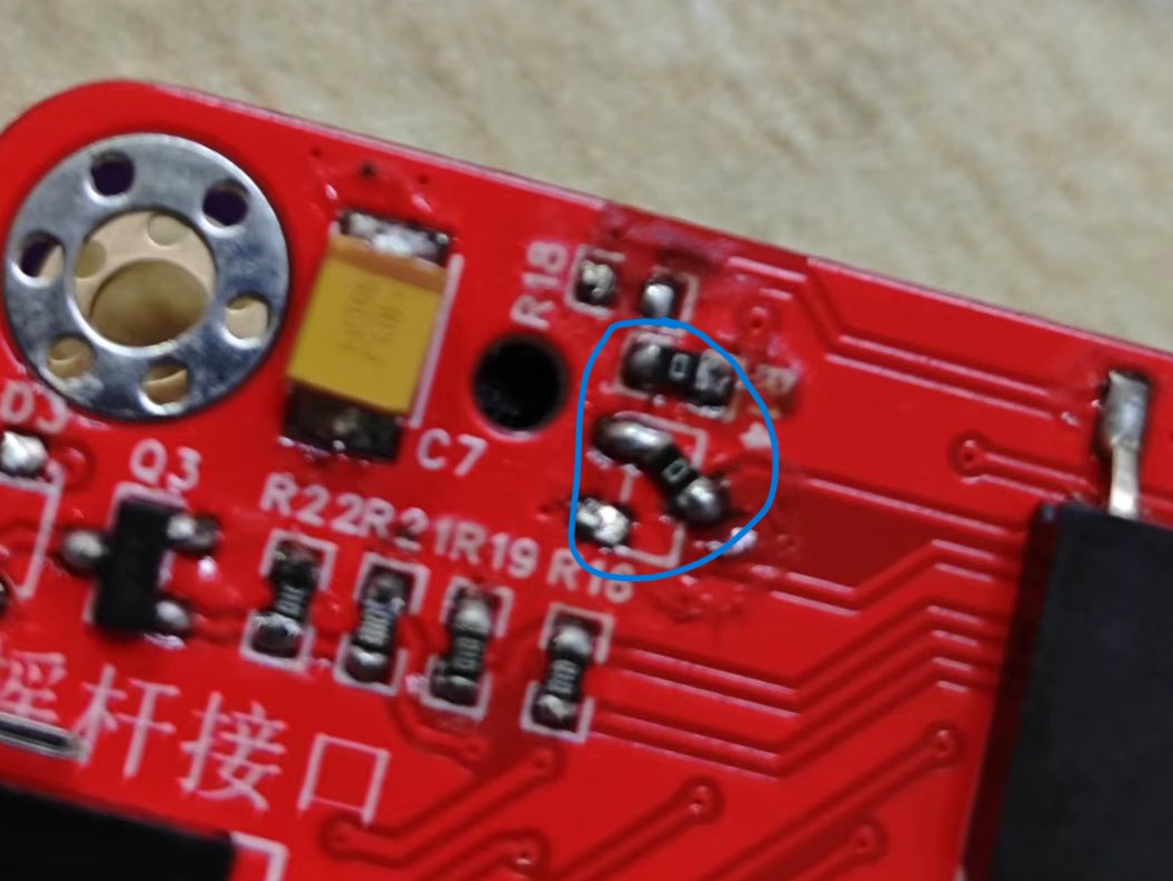

After spending some time troubleshooting software issues, I discovered that connecting the screen with DuPont wires worked, but plugging it into the expansion board failed. The problem was obvious: the expansion board was designed for bare screens, but my screen already had a built-in driver circuit, hence the inability to light up. I
had initially followed the official circuit design, which used an S8050 and some resistors for the LCD_BLK circuit. However, this 2.0-inch screen already had these circuits, making it redundant and causing an open circuit in LCD_BLK. Since I had already printed the board, modifying it would require reprinting, which was too much trouble. So, I removed R18 and replaced R14 and Q2 with a 0Ω resistor, effectively short-circuiting this part.
The screen then lit up successfully.

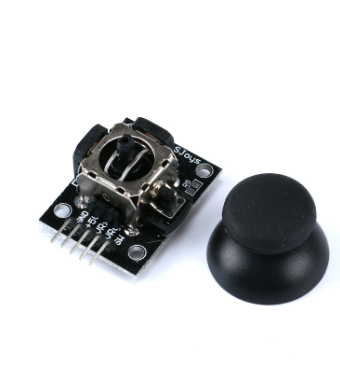

Next is the joystick issue. The official open-source project doesn't specify which joystick model is used. I found joysticks on Taobao, but I didn't know if JLCPCB had packaged them, so I simply bought a cheap joystick module and connected it using bent pins and headers. It has five pins, but only four are actually used. The SW pin is the button pin for this joystick module, which isn't used here.

As mentioned earlier, the JLCPCB development board documentation already includes the program for this screen, but this doesn't mean it can be used directly. Although both are 2.0-inch TFT and ST7789, screens from different manufacturers have slight differences (although sellers usually provide example code). The one I have was purchased from an unknown small seller on Taobao. Its biggest difference from the screen in the official documentation is the absence of the RES pin, which led me to initially believe that this was the reason the screen wouldn't light up.

First, I modified the joystick's reading code because I encountered a problem during testing: all buttons except the Reset button were malfunctioning. Initially, I thought it was a hardware issue, but after checking the circuit design and soldering, I ruled out hardware problems. I also checked the button output using a serial port assistant, which was normal.
Finally, I discovered the problem was with the joystick itself. Because the joystick module normally reads values ​​greater than 3000 from the ADC, the joystick continuously outputs a five_key_down signal, causing it to be occupied and preventing the buttons from functioning properly, resulting in me being stuck on the start screen. Changing the condition to 4000 resolved the problem. Incidentally, I also discovered that the Y-axis of this rocker model is reversed, so I replaced the UP and down buttons.
