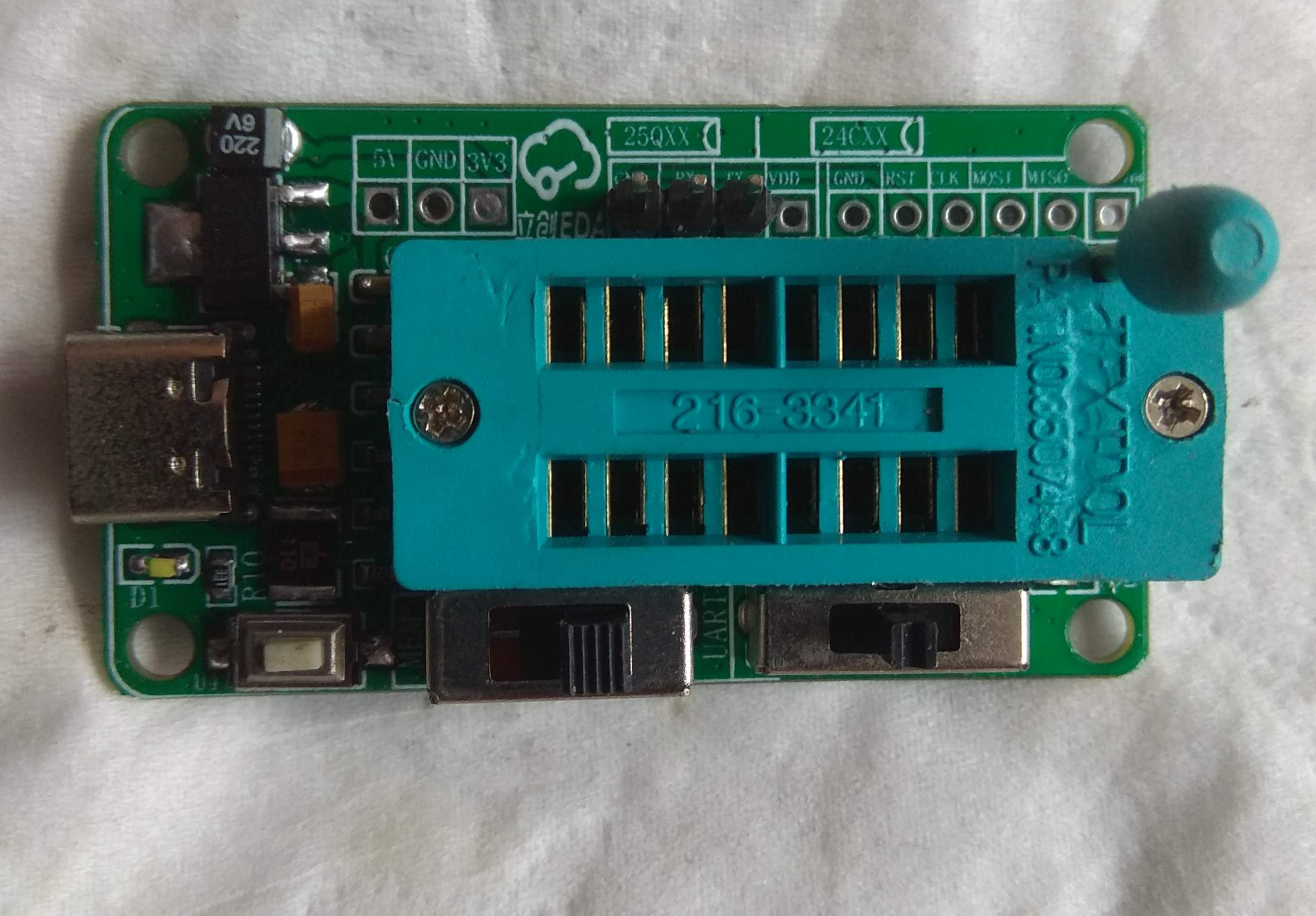

A self-restoring insurance has been added, three voltage schemes, 1.8V, 3.3v.5v, and two operating modes have been added.
First preview:
With two interface solutions, a large number of tantalum capacitor pads are placed on the entire board. Ensure the stability of the equipment.
The chip voltage has an LED indicator, and you can judge the current voltage by observing the bright changes of the LED. The 5V-indicator light is very bright and a bit dazzling, the 3.3V-indicator light is soft and not dazzling, and the 1.8V indicator light is dim.
Real object:
ASM1117 is used as a step-down chip, which has low cost and strong component versatility.
