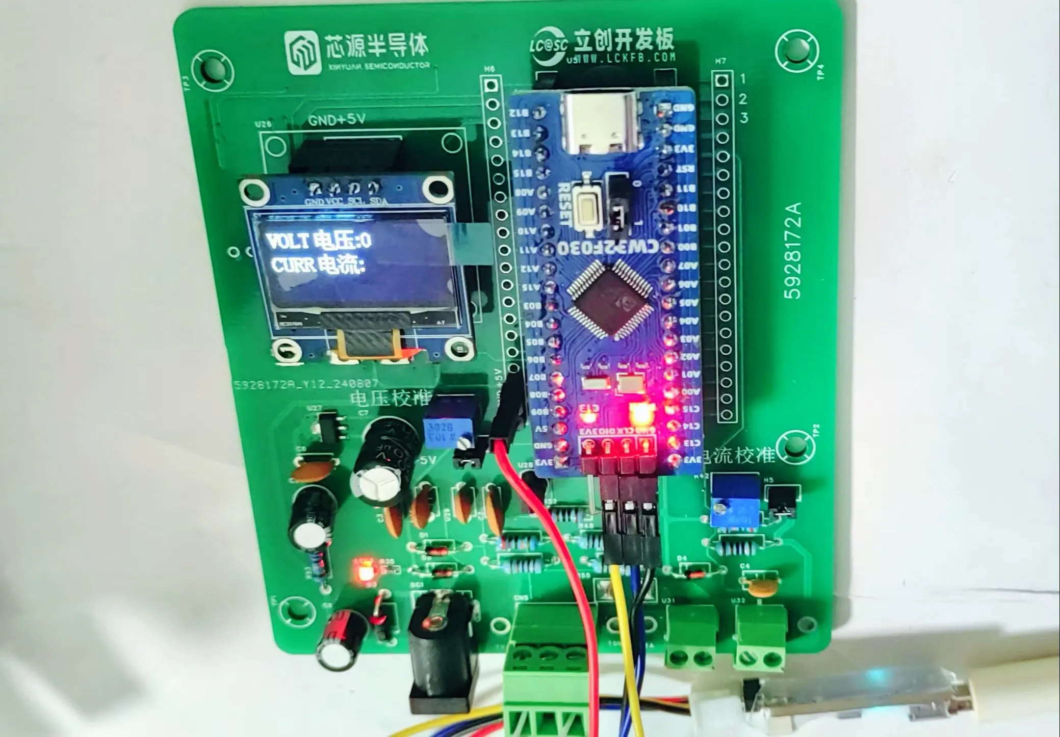

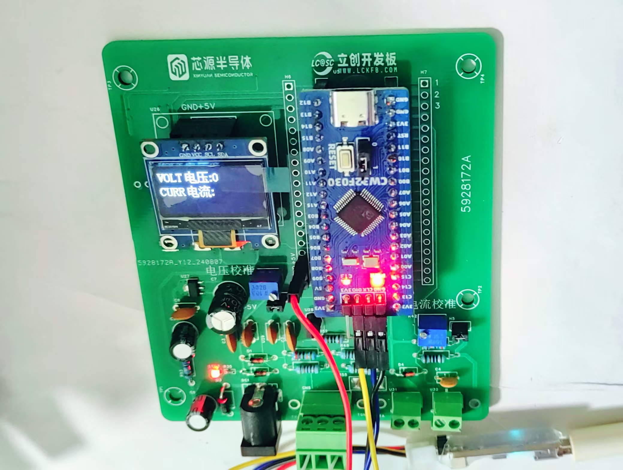

0. Physical Verification Image

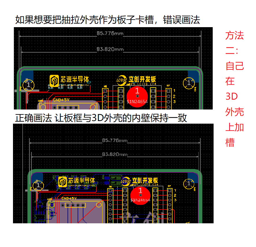

1.3D Shell Size Borrowing Notes
      Image 1.0 Shell Demonstration Image

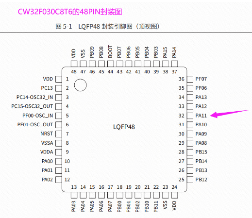

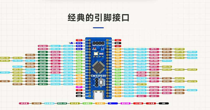

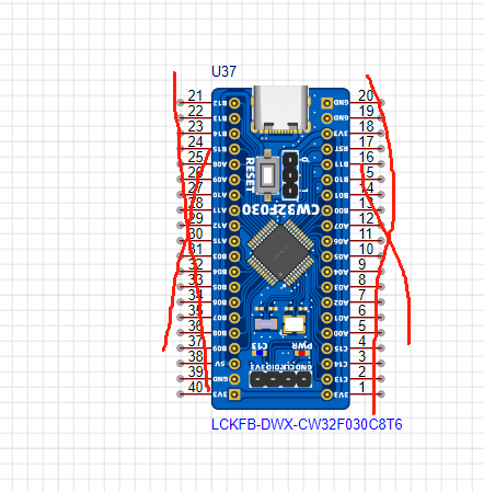

3. OLED Transplantation Notes
3.1 It was mistakenly believed that the pins of the Diwenxing development board were also numbered, but this is not the case. As shown in the figure, B10 refers to GPIOB10, not number 15 in the EDA design software
(when I2C is outputting normally, the SCL voltage is approximately 0.05V, and the SDA voltage fluctuates between 0.05V and 3.3V [because of communication]).
      Figure 3.0 shows the PIN pin diagram of the development board .
Figure 3.1 shows the corresponding PIN pin diagram.
      Figure 3.3 shows the misleading serial number. Figure
