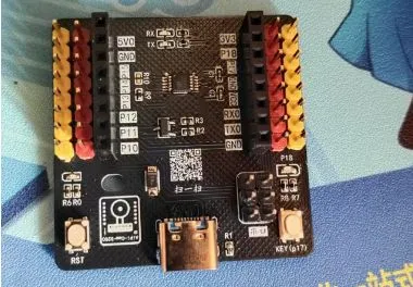

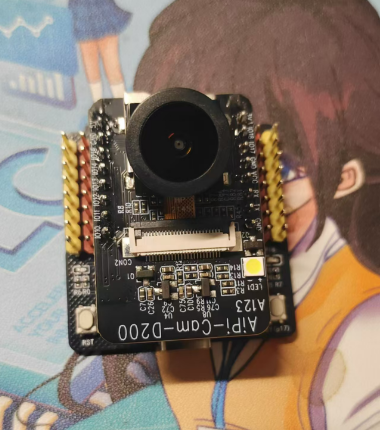

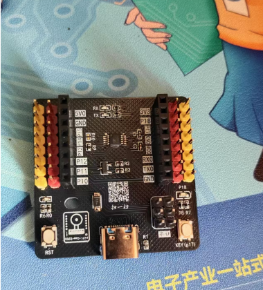

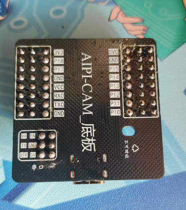

The Anxinco Cam-D200 camera baseboard features an onboard CH340X to serial port chip, uses an NMOS to control the power supply, and can automatically download firmware. It has two rows of I/O ports for convenient function testing, a reset button, a user LED, and a freely usable button. It can also be used as a serial port tool.
(Note:
Except for one 0603 LED, all resistors and capacitors are in 0402 packages.
The BOM may be inaccurate; please refer to the schematic diagram .)
