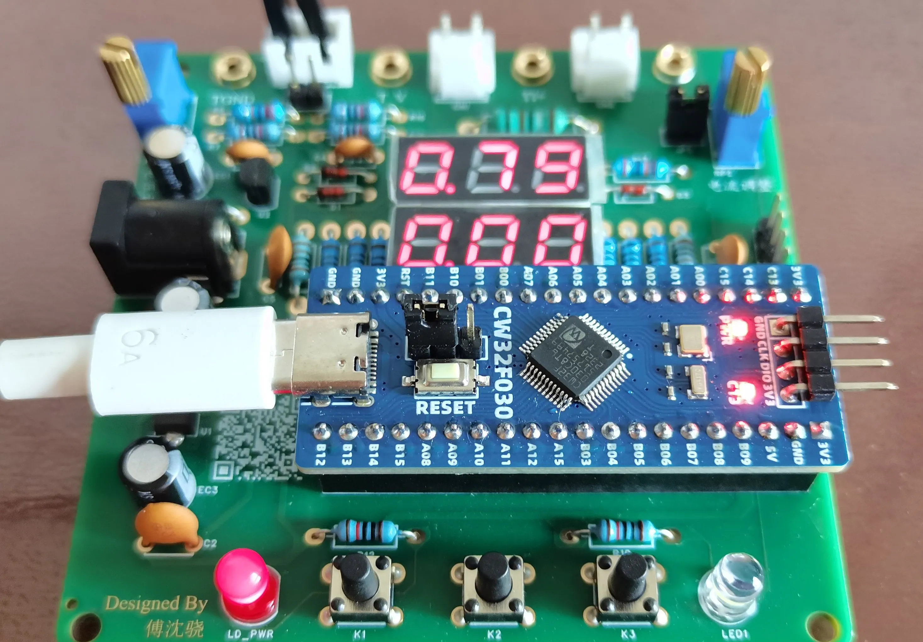

CW32-based voltage and current meters

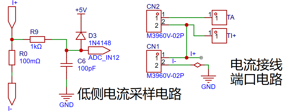

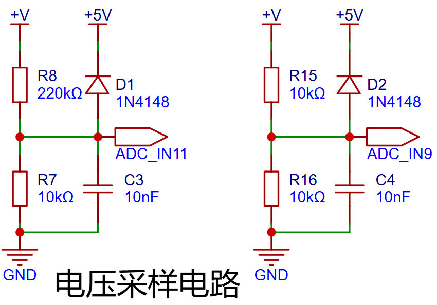

The most important parts of the hardware circuit are the voltage acquisition section and the current acquisition section
. The voltage acquisition circuit implements the acquisition
of voltage under both high and low voltage conditions. The current acquisition section uses a small resistor and an ADC sampling method to acquire the current magnitude . In the software

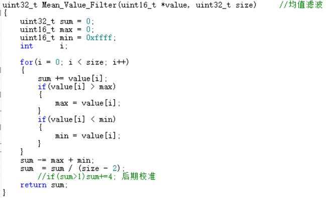

the most important parts are calibration and mean filtering
. Calibration uses a linear fitting method, obtaining the slope of the fitted curve based on the actual voltage change and the calculated voltage change.
Filtering uses a mean filtering method, which involves acquiring voltage values ​​over a period of time, subtracting the maximum and minimum values, and averaging the remaining values. This filtering method can prevent voltage spikes to some extent.
