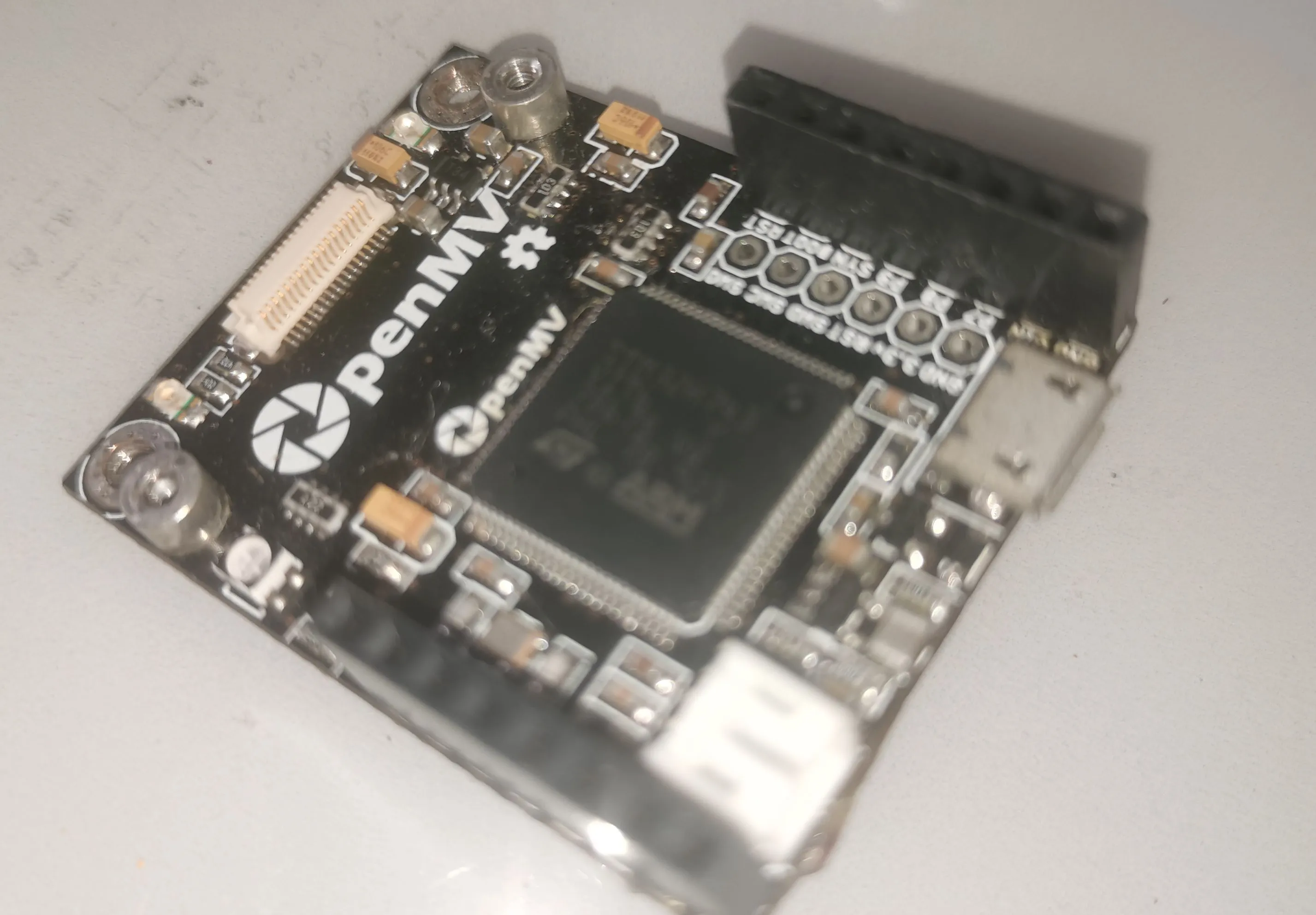

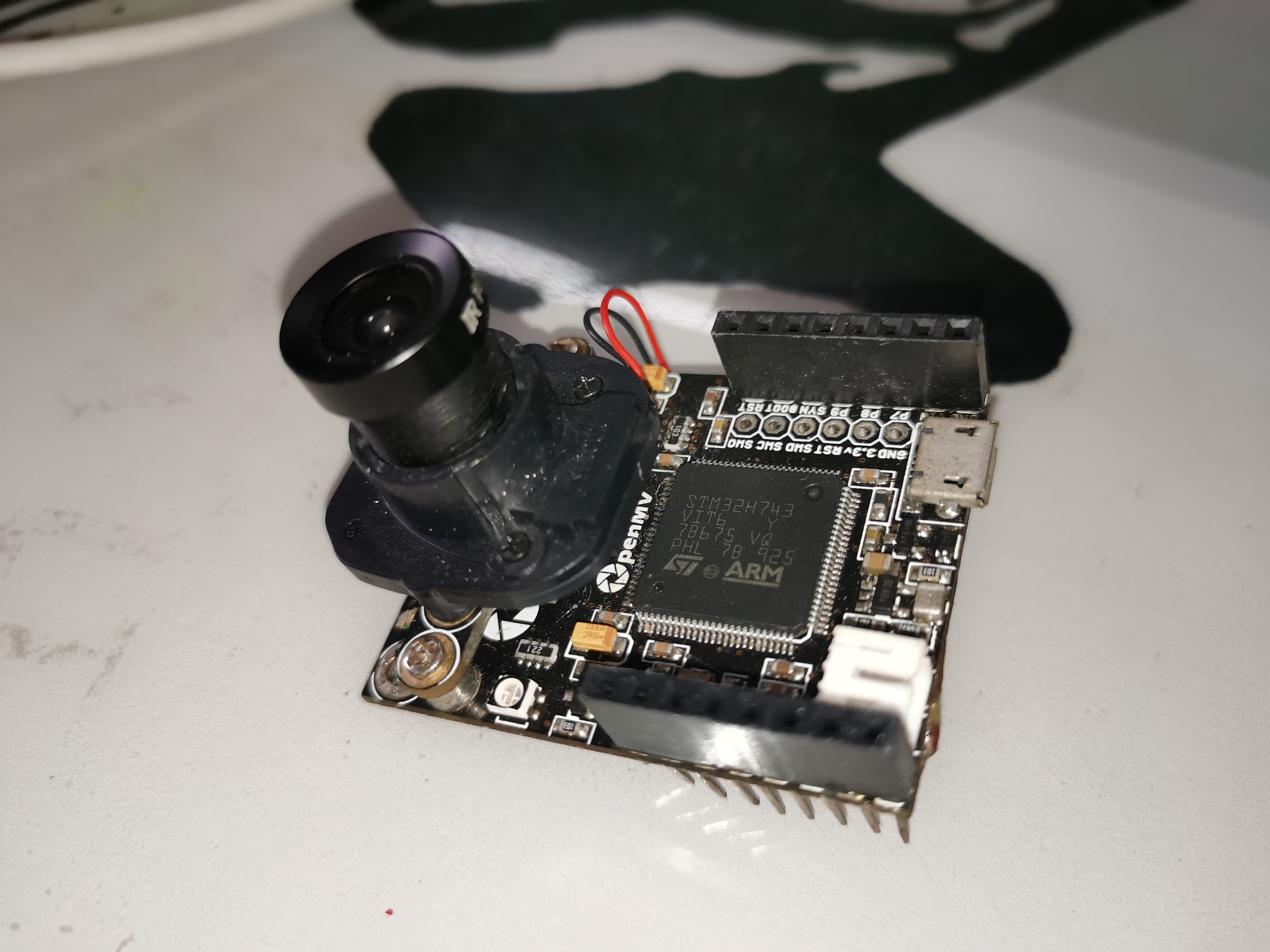

The discontinued OpenMV4 H7 R1 from StarEye Technology
This file contains the official open-source PCB for the OpenMV4 R1 board. It can be used for replacing damaged pins and for replicating designs. Please do not use it for commercial purposes.

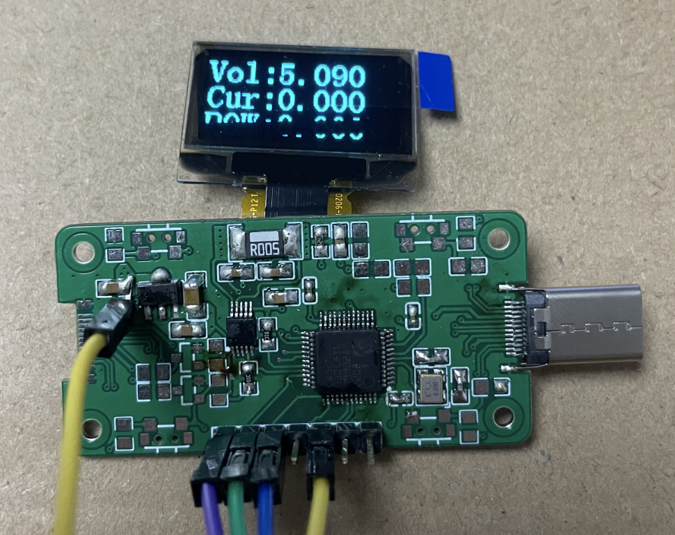

CC meter, without deception, displays voltage, current and power.
This document describes
the use of an LDO to power a microcontroller
, an INA226 as the voltage and current acquisition chip,
and an OLED screen for display.
Issues and subsequent optimizations
: 1. Using an LDO for power supply can easily cause system restarts when the USB-B voltage changes; a DC-DC converter is planned for the next version.
2. There was a bug in the OLED screen circuitry (now fixed).
3. A resistor divider network using the CW32's built-in ADC has been added for functional verification.
4. The overall current flowing through the board is relatively low; the power supply issue for the Type-C port still needs to be addressed.
5. Reserved buttons have been removed.

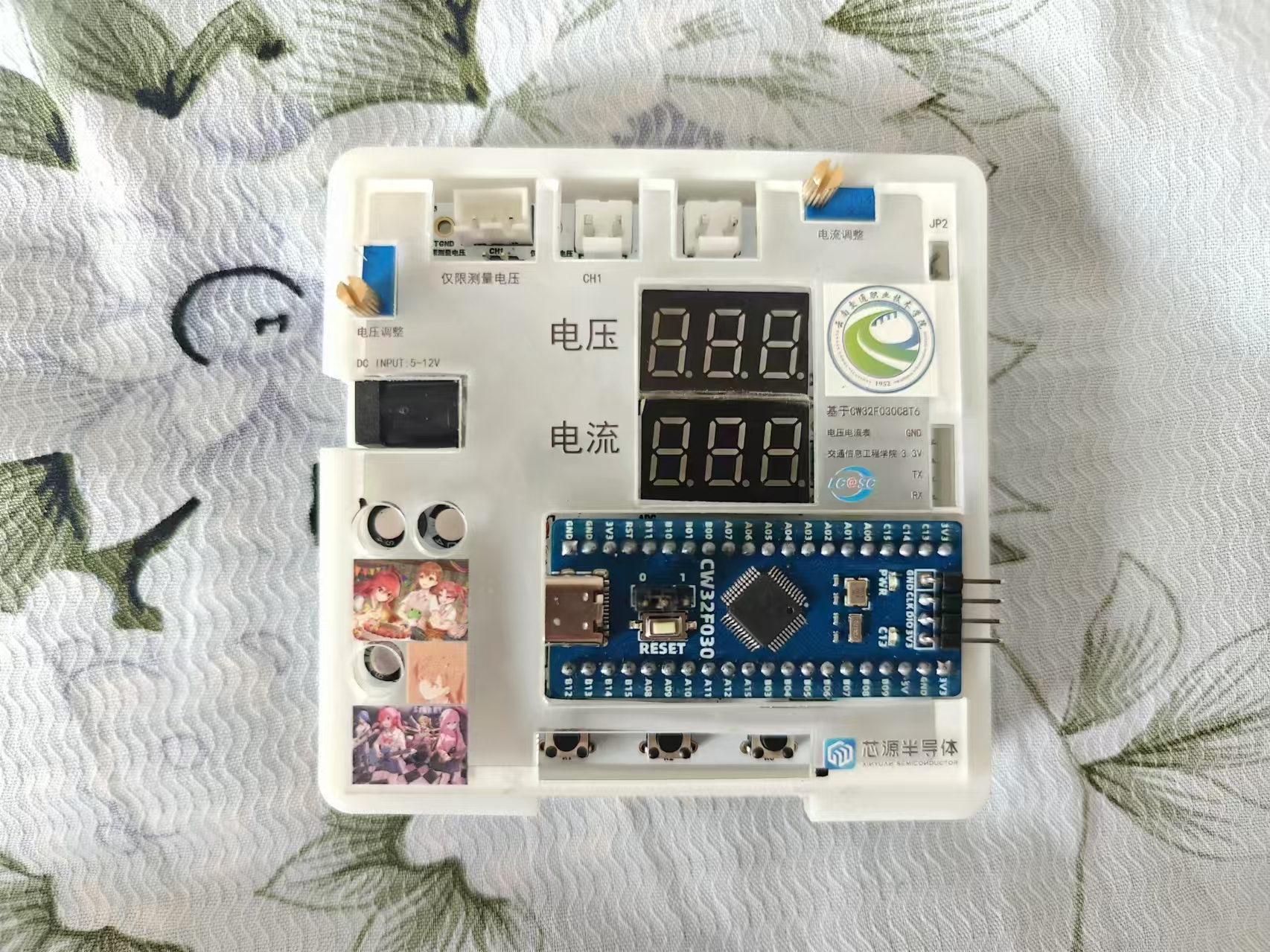

Voltage and current meter – based on CW32F030C8T6
LCSC GeoStar CW32 Digital Voltage and Current Meter Expansion Board

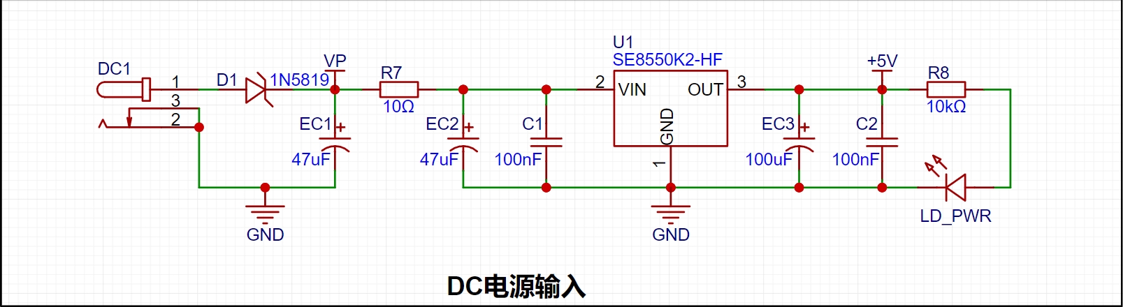

1. Power Supply Circuit
LDO (Low Dropout Linear Regulator) Selection This project uses an LDO as the power supply. Considering that most voltmeter products are used in industrial scenarios with 24V or 36V power supplies, the SE8550K2 with a maximum input voltage of up to 40V was selected as the power supply. The main reason for not using a DC-DC step-down circuit to handle the large voltage drop is to avoid introducing DC-DC ripple interference during the design process, and the secondary reason is to reduce project costs.
