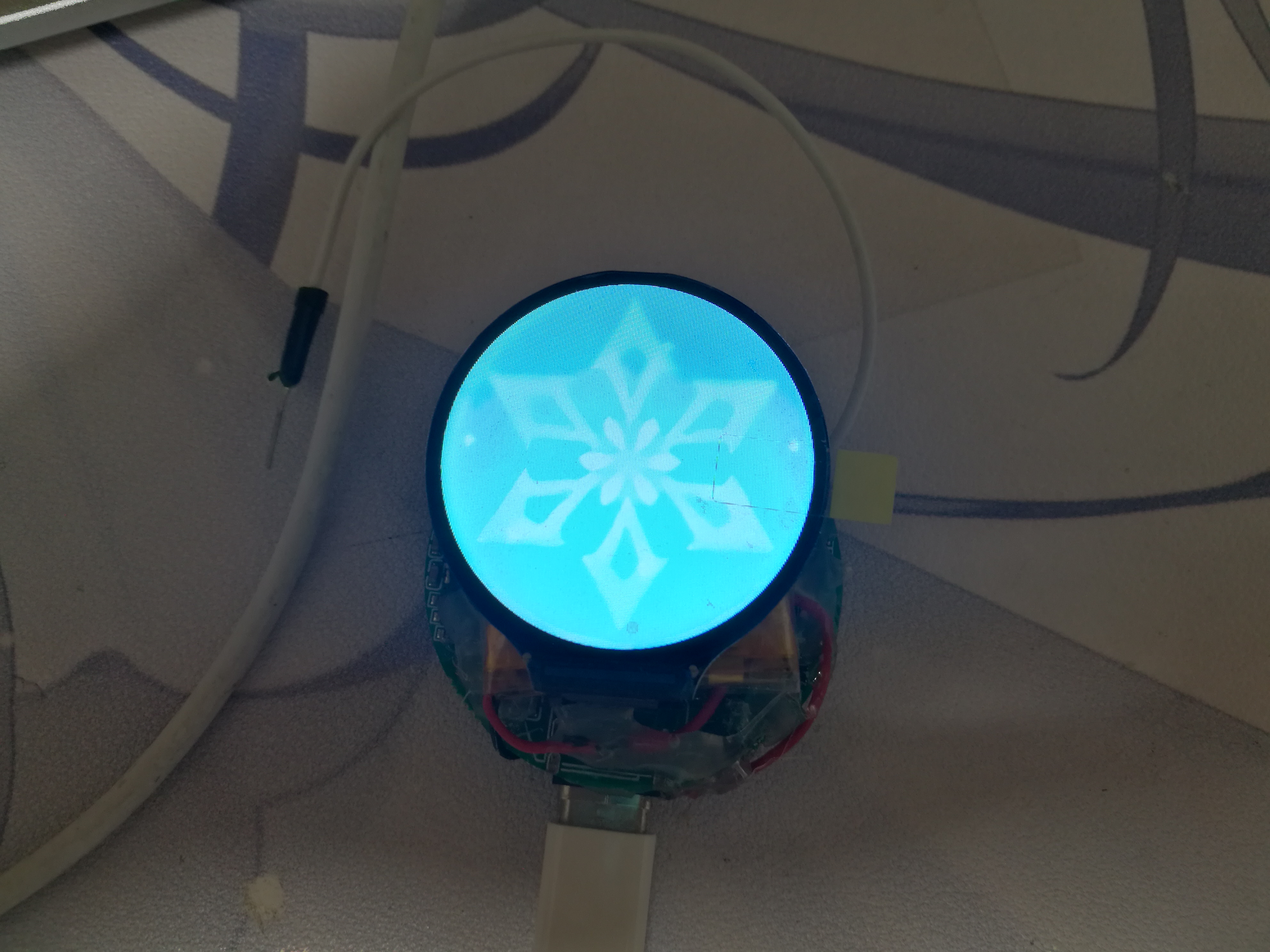

Motherboard: Integrates ESP32, screen, 32G surface mount SD card, DS2321 clock, buttons & single-button power on/off, lithium battery charging & buck & power detection, USB to serial port, USB card reader, infrared transceiver, speaker, temperature sensor, power indicator, etc.
Note: GPIO2 needs to be pulled low when uploading the program
. After simple testing, the hardware works normally. III. Shell & Structure

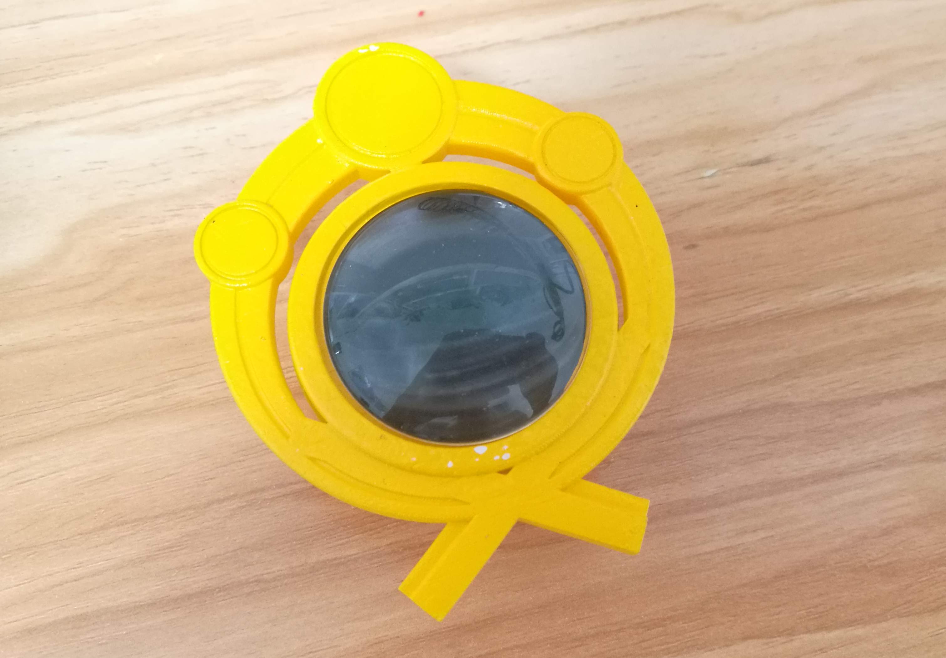

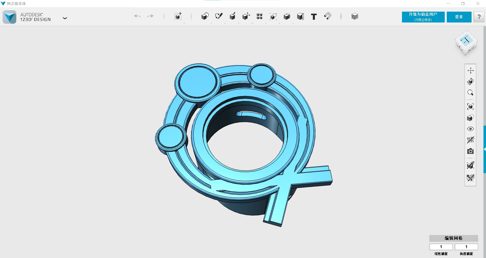

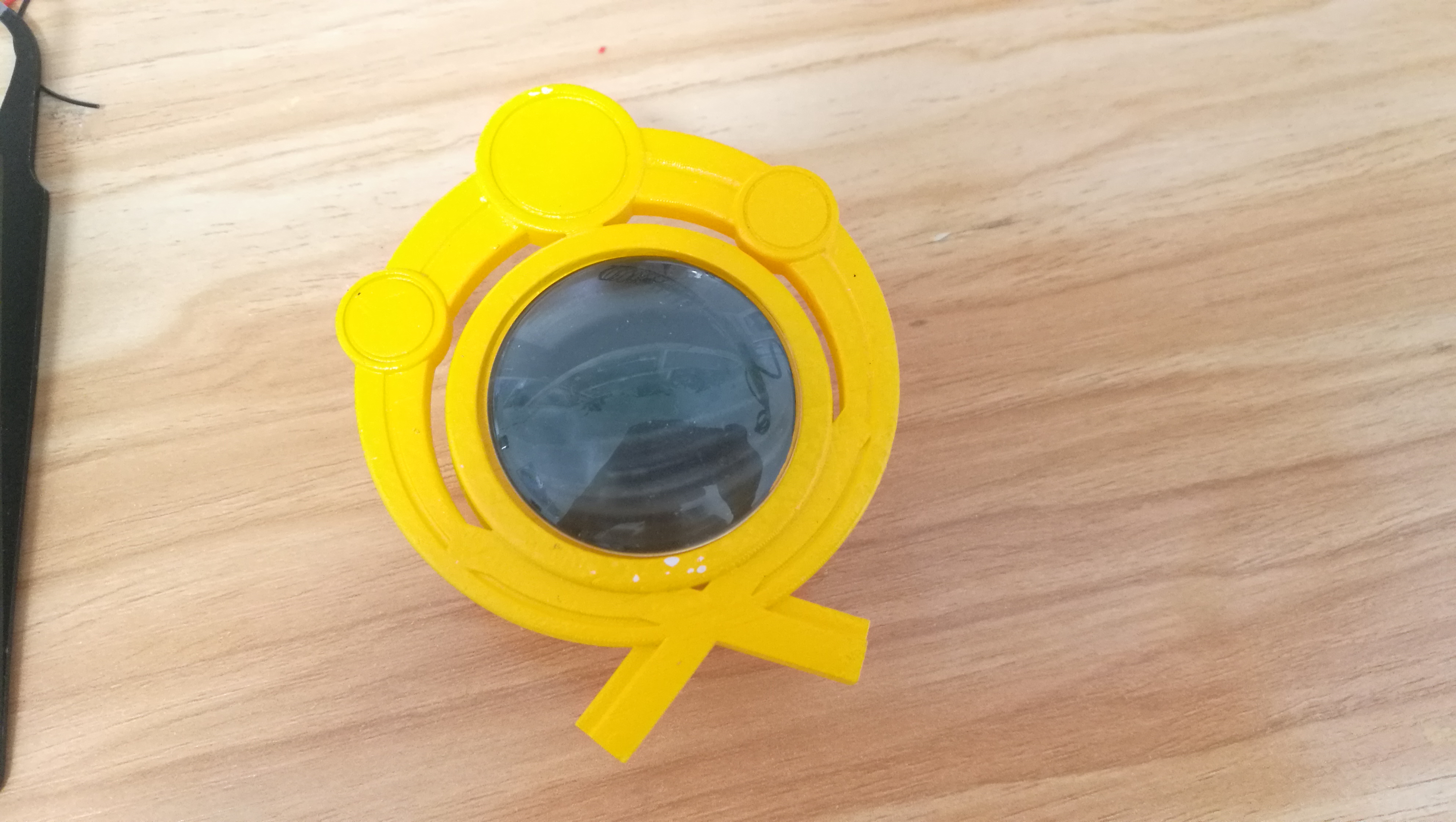

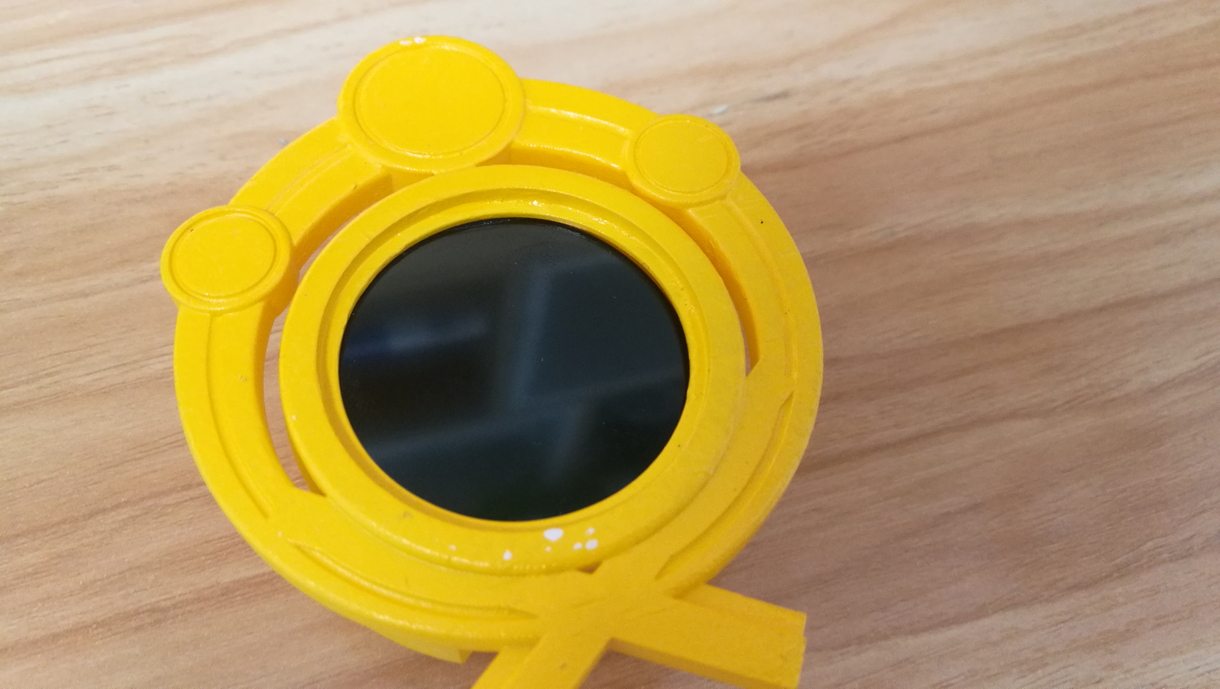

God's Eye The outer shell of the eye is shown below.

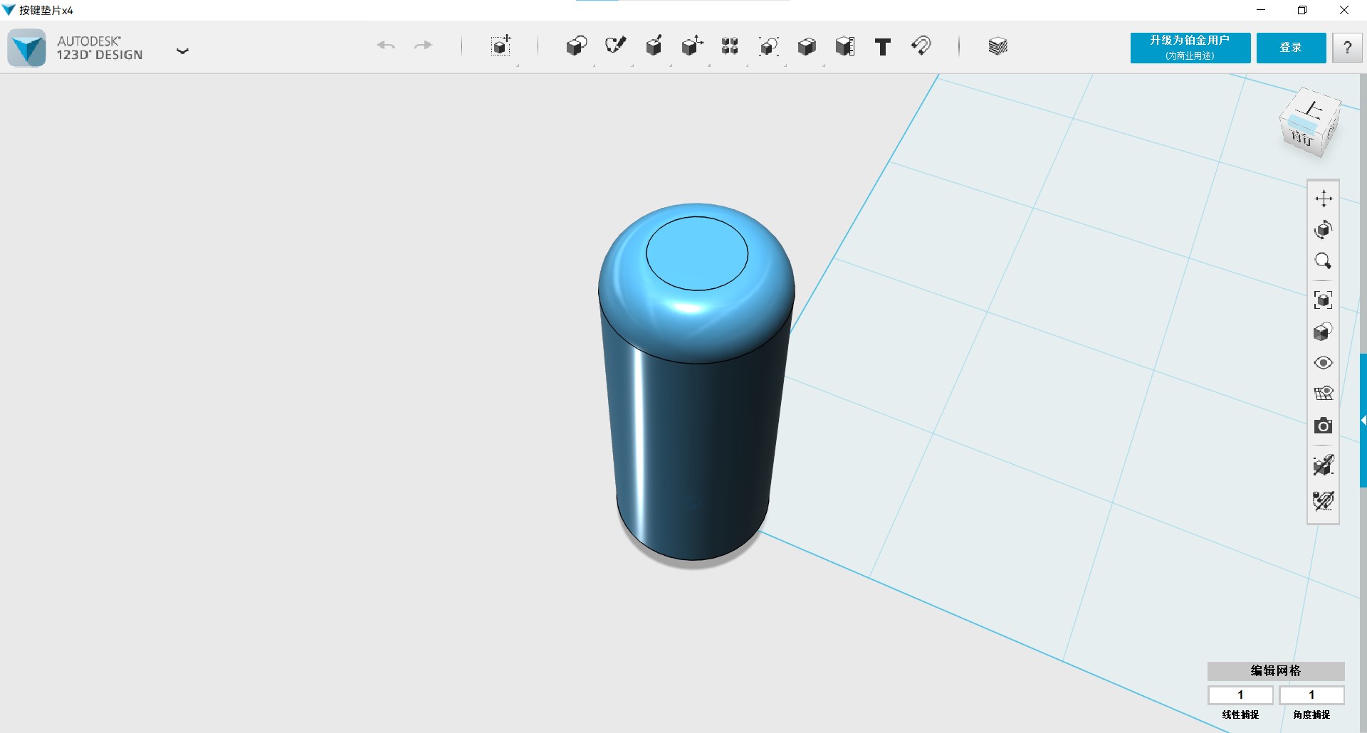

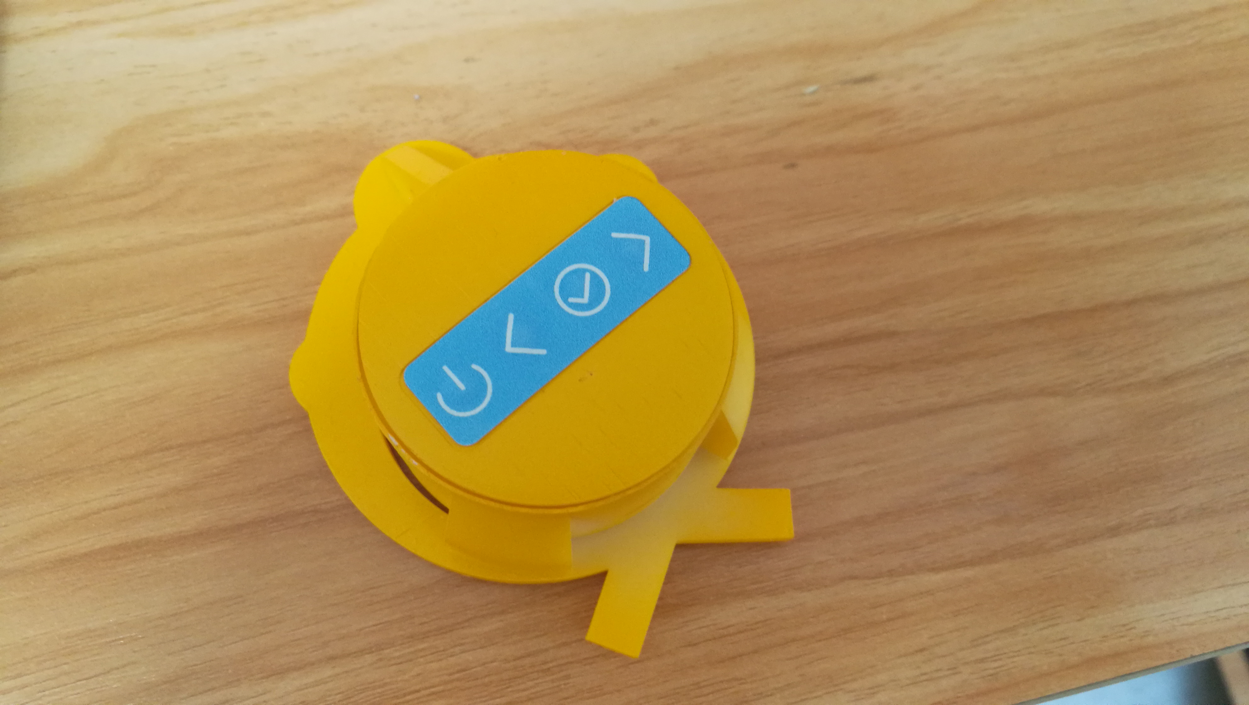

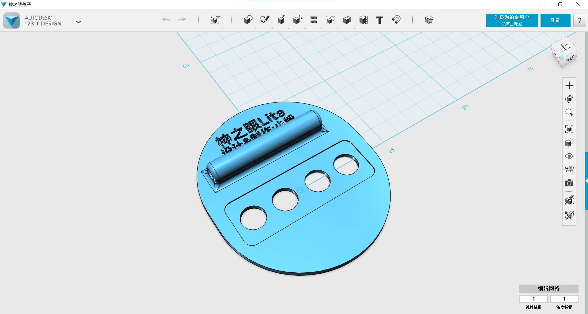

The cover of the Eye of God's outer shell, manufactured using 3D printing, is shown below. The groove in the button area is for holding the membrane panel. Because the button length is insufficient, it needs to be raised, so the following button pads were designed (4 need to be 3D printed).

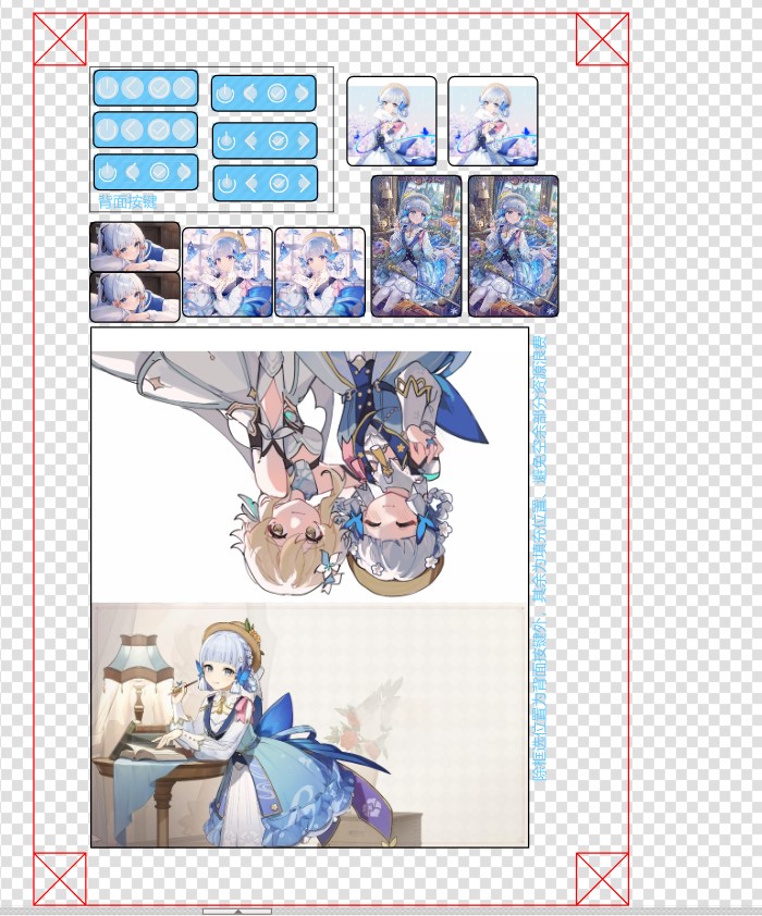

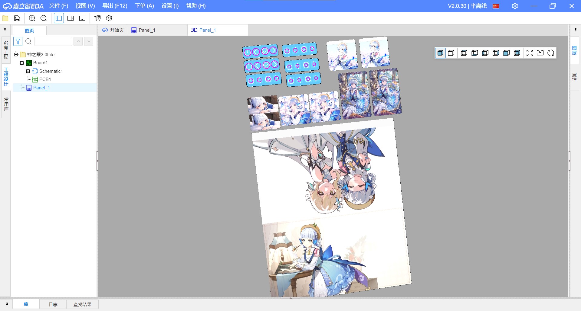

The button panel in the cover area of ​​the Eye of God's outer shell is shown below. The area in the upper left square is the actual button panel. Because the minimum printable size of the LCSC panel is 200*300, some images were added to fill the blank areas to avoid waste. Please approve...

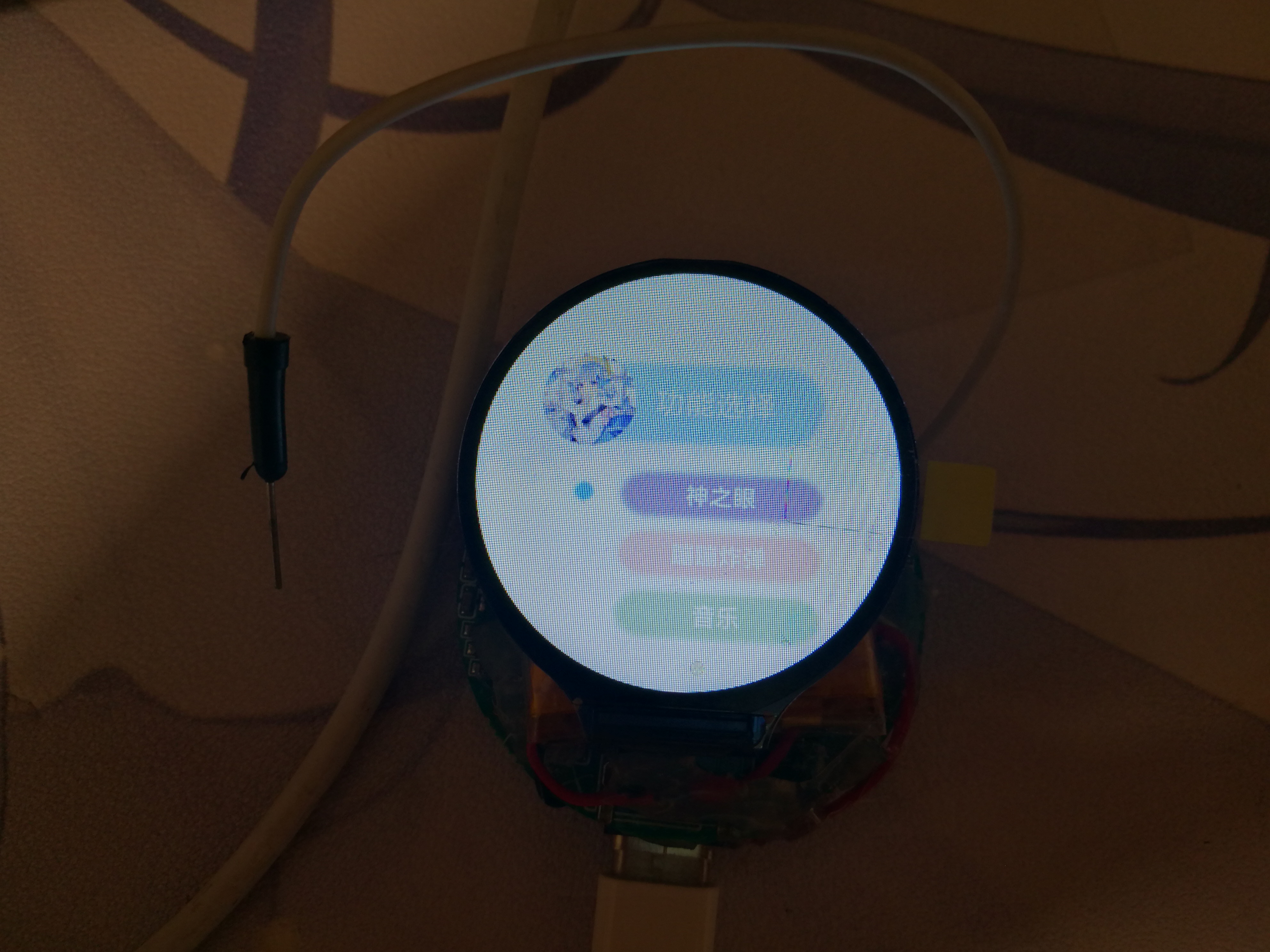

V. Finished Product Image
