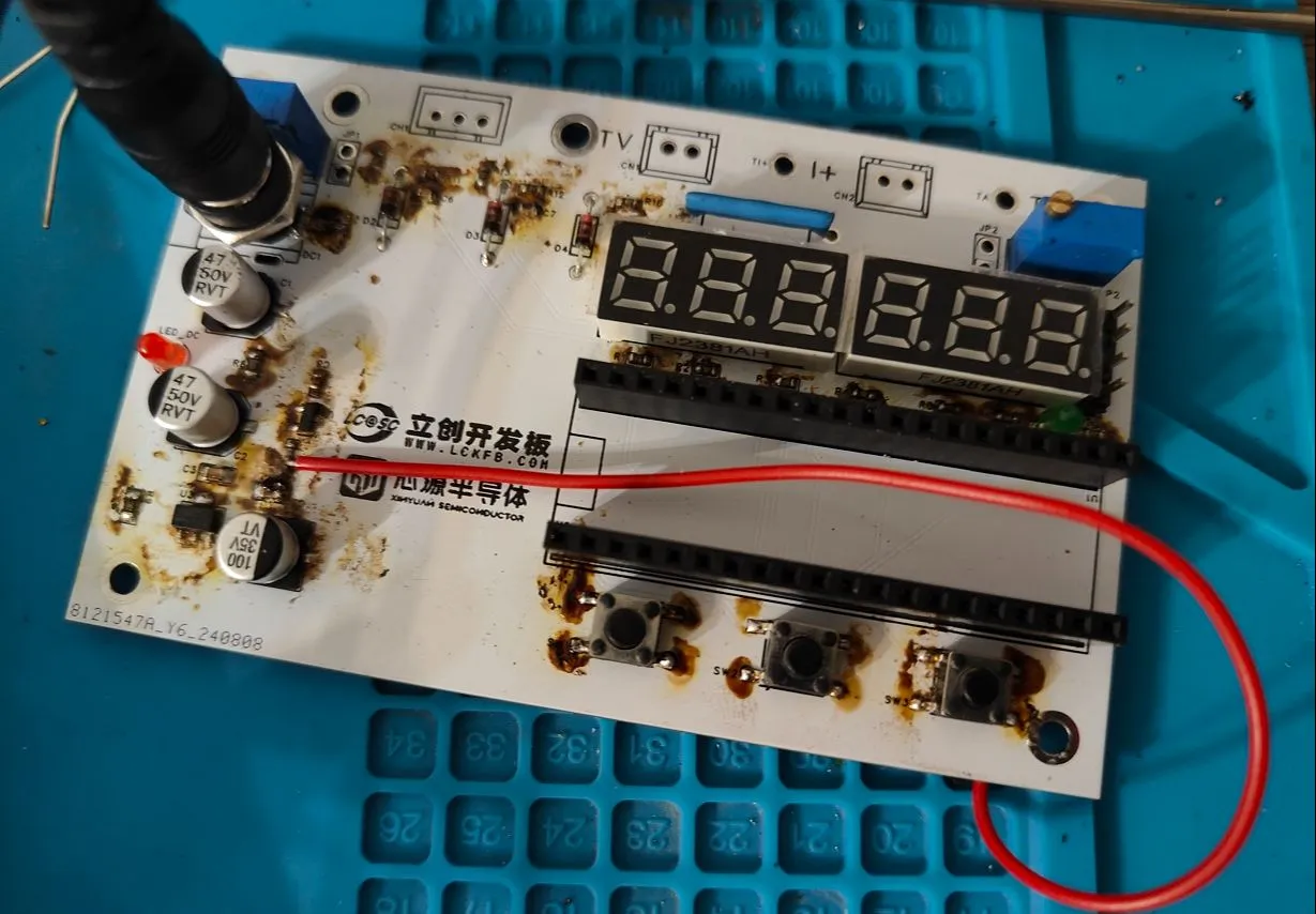

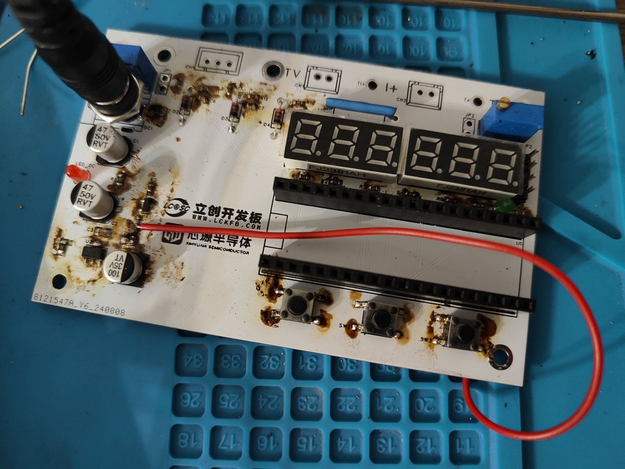

Project Introduction This project involved
learning to design circuit boards following a training camp. Several issues arose regarding
programming (I only had CH340, not various LINK components). I eventually found a serial programming method in the development board documentation,
but overlooked the power supply, so I used jumper wires to resolve this (schematic and PCB layout updated).
The TV and TGND points on the PCB are not connected to other circuits, even though they are necessary. No errors were found during the design process (PCB not updated as the impact is minimal).
