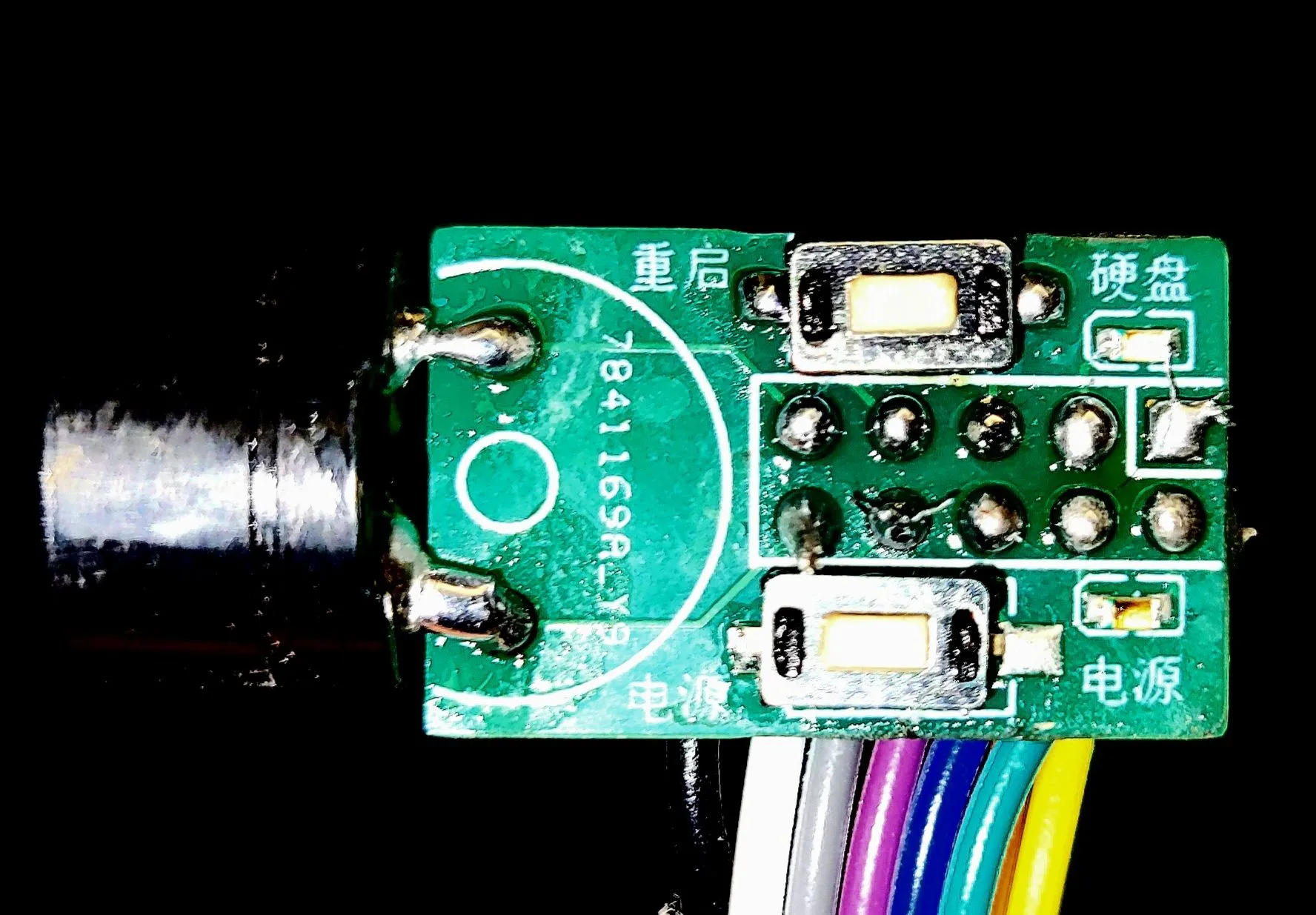

Computer front panel, restart and power buttons, power on and hard drive indicator lights
Applicable to: Desktop power buttons, open-frame cases, shoebox cases, damaged original panels, motherboard testing. Supports wired and wireless connections.
Wired connection:
Wireless connection (actually, a short cable for the buzzer is also required):
