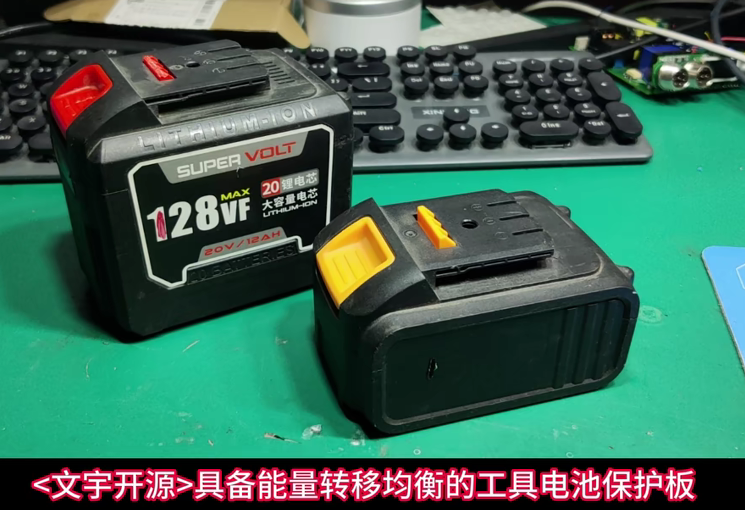

Makita Tool Lithium Battery Pack Active Balancing Protection Board
The performance of a lithium battery toolkit determines the performance of lithium battery tools. High-end tools typically use batteries from the same batch, resulting in excellent initial internal resistance and capacity consistency. However, after hundreds of repeated use cycles, due to factors such as materials and temperature, the performance of individual cells can become the bottleneck for the entire tool battery pack.
We know that lithium batteries require a protection board for safe use. This board monitors the voltage of each cell, and if any cell's voltage is too high or too low, it shuts off the input and output of the entire battery pack. After repeated occurrences, the capacity of the poor-performing cell decreases with each charge/discharge cycle, ultimately determining the overall capacity of the battery pack – the so-called "weakest link" effect.
In fact, the performance of the battery pack can be restored simply by charging each cell independently. However, this requires disassembling the batteries, which is inconvenient.

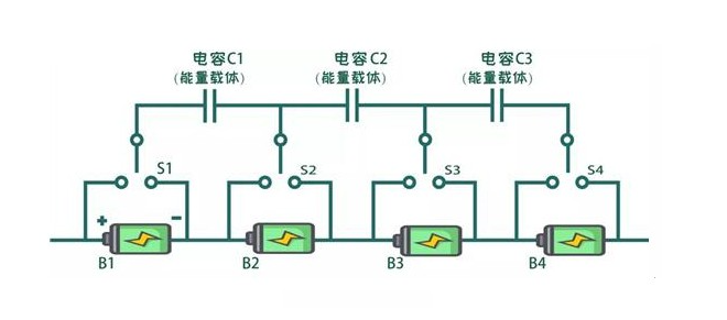

Capacitor-based equalization speed is determined by voltage difference. When the voltage difference is small, the speed is slower, but it has low self-power consumption, high efficiency, and a small size, making it suitable for long-term parallel use in tool battery packs.

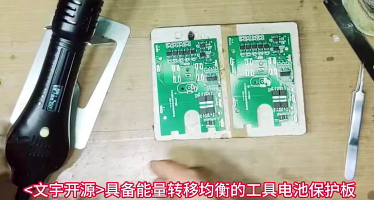

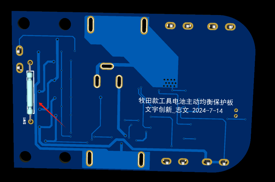

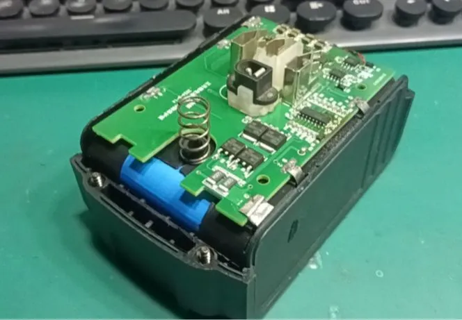

An open-source protection board with active equalization that directly replaces the original battery pack protection board is provided. It is based on capacitor energy transfer.
The main working principle is shown in the diagram: the drive circuit controls the switch to repeatedly switch on and off, allowing capacitors to be repeatedly connected in parallel to adjacent batteries, achieving energy transfer.

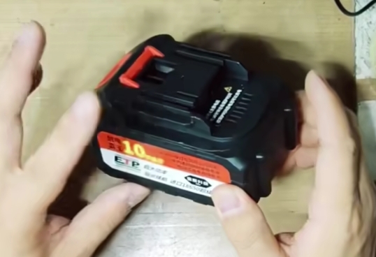

For cost control reasons, voltage testing of individual cells is not performed here. The entire equalization section is constantly working. If the battery is stored and not used for a long time, it may deplete its charge. Therefore, I added a reed switch here. When storing for a long time, the magnet in the recessed part of the casing is removed, and the equalization section will stop working. This is
a 10-cell version of the Makita battery pack.

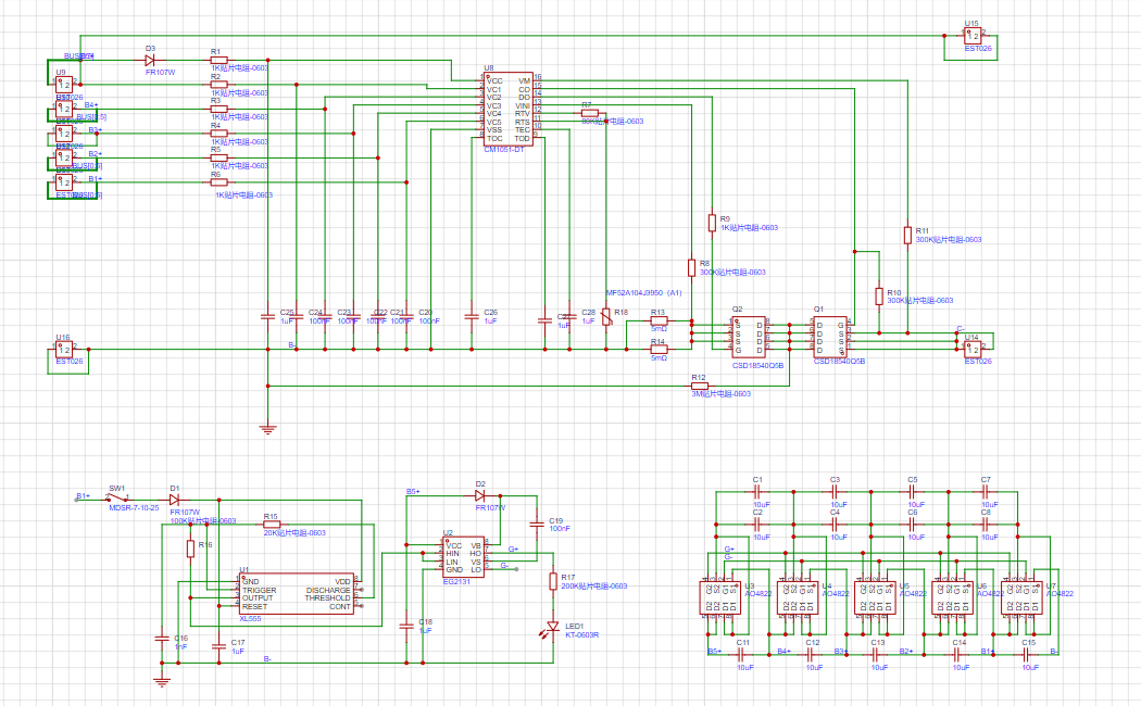

Please refer to LCSC Engineering for the parts list. This is my first time using LCSC EDA to complete a PCB. You can modify it according to your needs.
Tools: Battery pack.

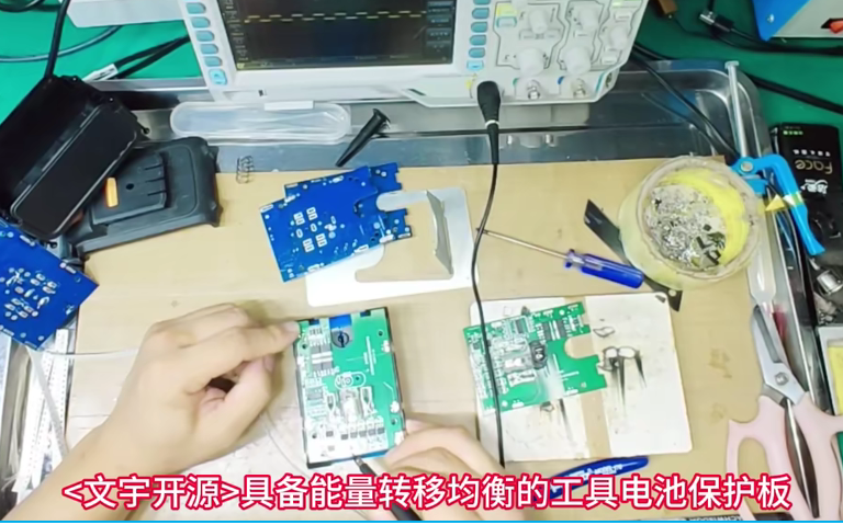

Surface mount soldering
test: Installing the battery pack.
PCB surface mount soldering. For repairs, you can use this useful tool: an all-in-one hot air gun.
