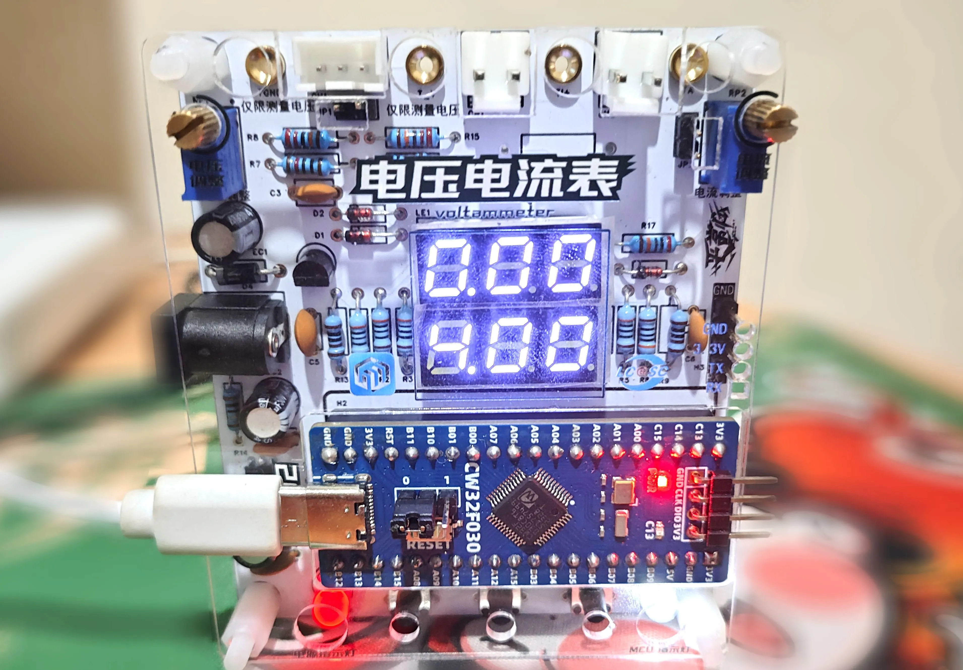

This project is a replica of the voltmeter and ammeter project from the 2024 summer camp. I (the author) participated in this training camp during my summer vacation when I had some free time. Having only recently entered university, I know very little about hardware and lack the skills to modify the hardware schematics and PCB designs myself. Therefore, I can only replicate this project using a copy-paste method to enrich my knowledge of hardware design.
I. Project Introduction
      This project is a voltmeter and ammeter based on the LCSC CW32F030C8T6 development board. It utilizes the CW32's internal ADC 1.5V reference to acquire voltage and current data. The acquired results are averaged and filtered before being displayed on a digital tube, completing a simple voltage and current measurement. Five modes can be used to calibrate the voltage and current for more accurate measurements.

The ADC cannot directly measure the current magnitude and can only sample it through a sampling resistor. The maximum current design is 3A. As for why it's 100mΩ... The author can only briefly explain that a 100 milliohm resistor has a small resistance and a small voltage drop. V = I * R = 3A * 0.1Ω = 0.3V, providing a sufficiently large voltage signal input to the ADC_IN12 for voltage detection, thus indirectly calculating the current. Furthermore, P = 3A² * 0.1Ω = 0.9W, indicating relatively low power consumption and preventing overheating. Regarding
circuit board soldering and BOM materials
       : since most components are through-hole, although the author lacks extensive soldering experience, the existing soldering iron was sufficient for soldering this circuit board. However, due to the small spacing between the TL431 holes, solder bridging was easy, resulting in one damaged board. A larger package of TL431 could be used; the author will not modify it further. Special reminder: Do not solder resistor R0 during the soldering process; solder it only after the experiment is complete.
       The white digital tube is a 0.28-inch common anode white digital tube purchased from Taobao, but the BOM specifies a common cathode digital tube. Why would a mouse buy a common anode seven-segment display? Of course, it's to learn how to use a common anode seven-segment display (not really). The 2mm banana plug is a K2A33, which can be found by searching keywords. The rest were ordered from LCSC Mall based on the BOM. For detailed materials, please see the attached BOM.

     After the PCB has been tested and found to be functional, you can use an extra circuit board as the bottom surface, connecting it with M3-5mm plastic copper pillars. On the front, use M3-10mm plastic copper pillars to connect the printed panel and secure it with screws and nuts.
    The buttons cannot be directly pressed through the acrylic panel; you can modify them to 12mm or larger through-hole buttons. Alternatively, you can leave them as is and use a pen or similar object to press the buttons.
