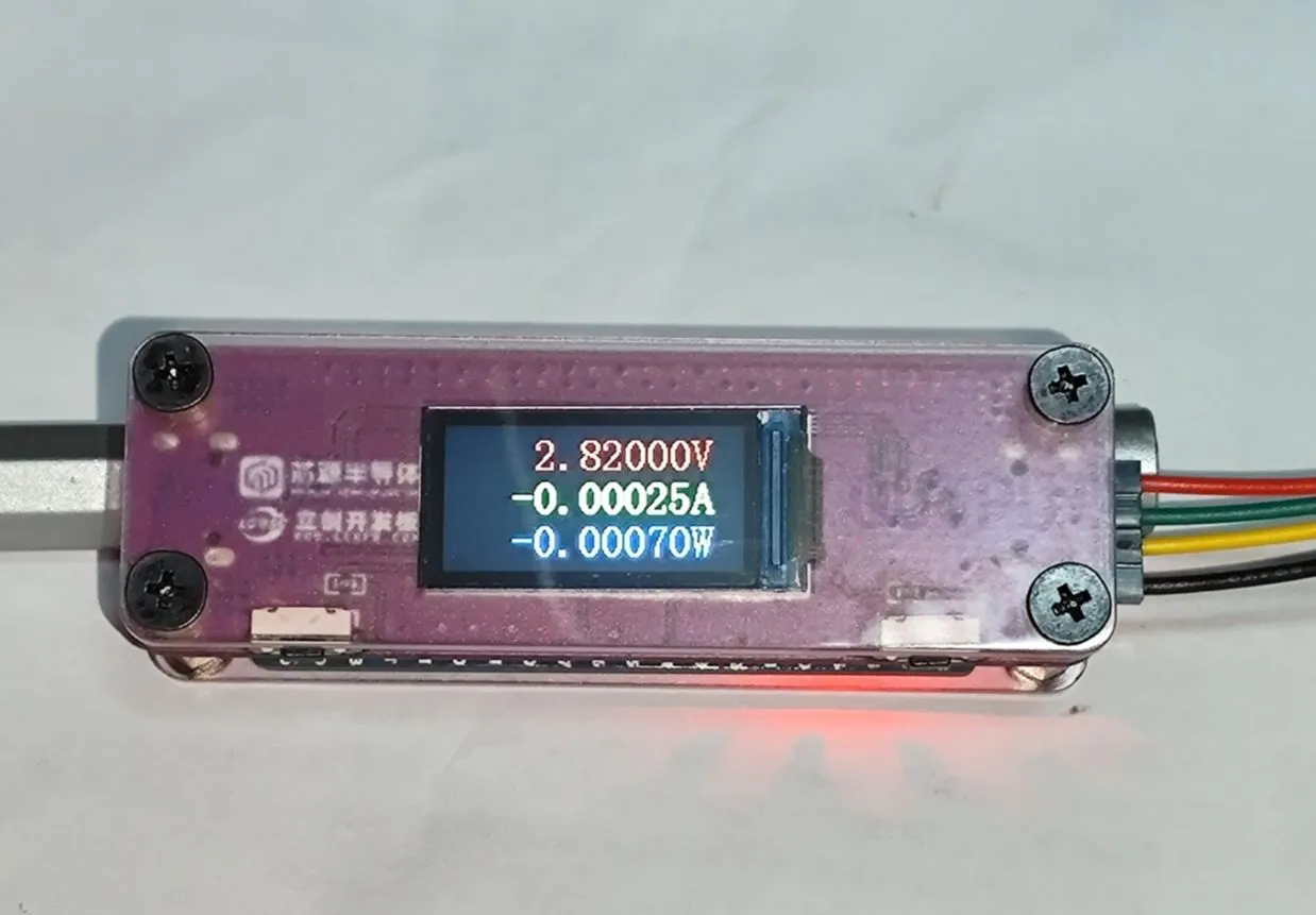

Voltage and current display: Resolution 0.25mV, 0.25mA, power is the product of voltage and current.

Important Notes: When soldering headers
for 5A or higher interfaces
, ensure they are aligned correctly. Otherwise, they will not be level.
After soldering the headers, first test the functionality by attaching the development board to the headers, then solder them securely
. To ensure a smooth solder joint, see the image below. Solder two headers to empty I/O pins, using
screws and nuts as spacers. Buy the size shown below.
The printed panel is semi-transparent, and the text is very unclear. If you don't like it, adjust the transparency control layer yourself.
As for the 8A and 16A markings on the panel, just take it as a joke; those are the maximum register values.
16A requires replacing the sampling resistor, modifying the program, and also requires a 10A connector.
