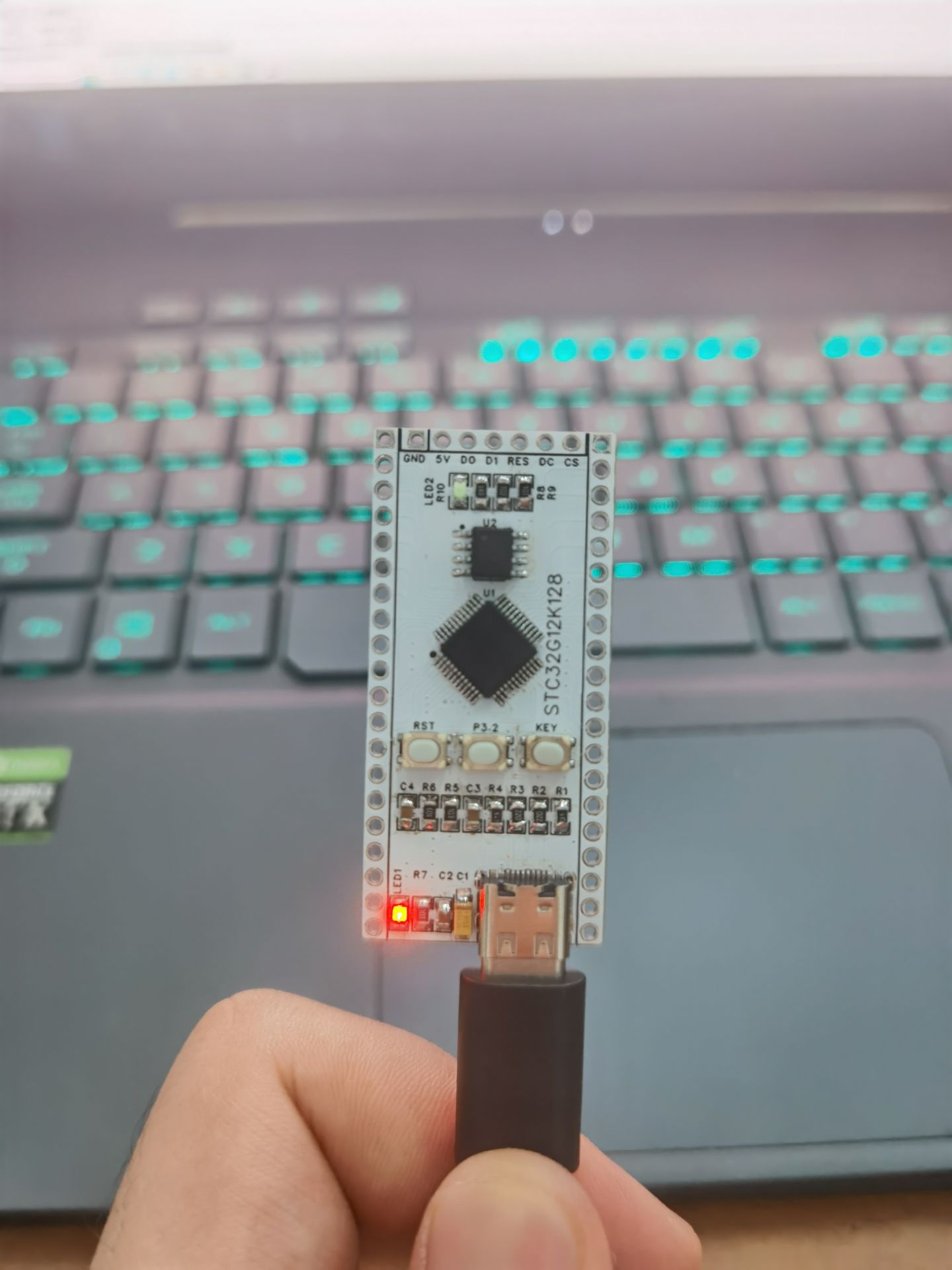

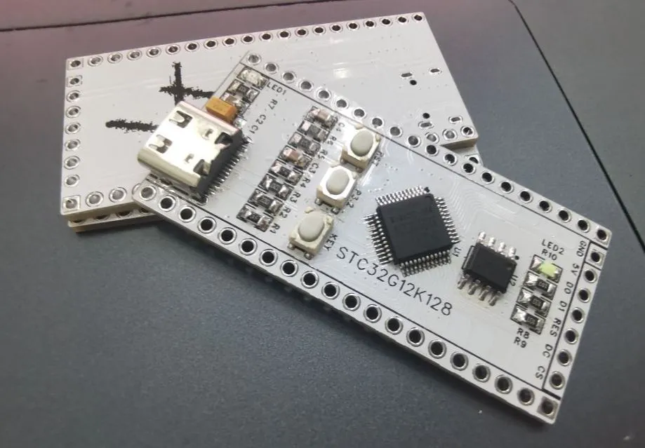

STC32G12K128-35I-LQFP48 minimum system board
The minimum system board uses the STC32G12K128-35I-LQFP48
and is directly powered by 5V. It uses
a virtual serial port for downloading
LSP screen interfaces.

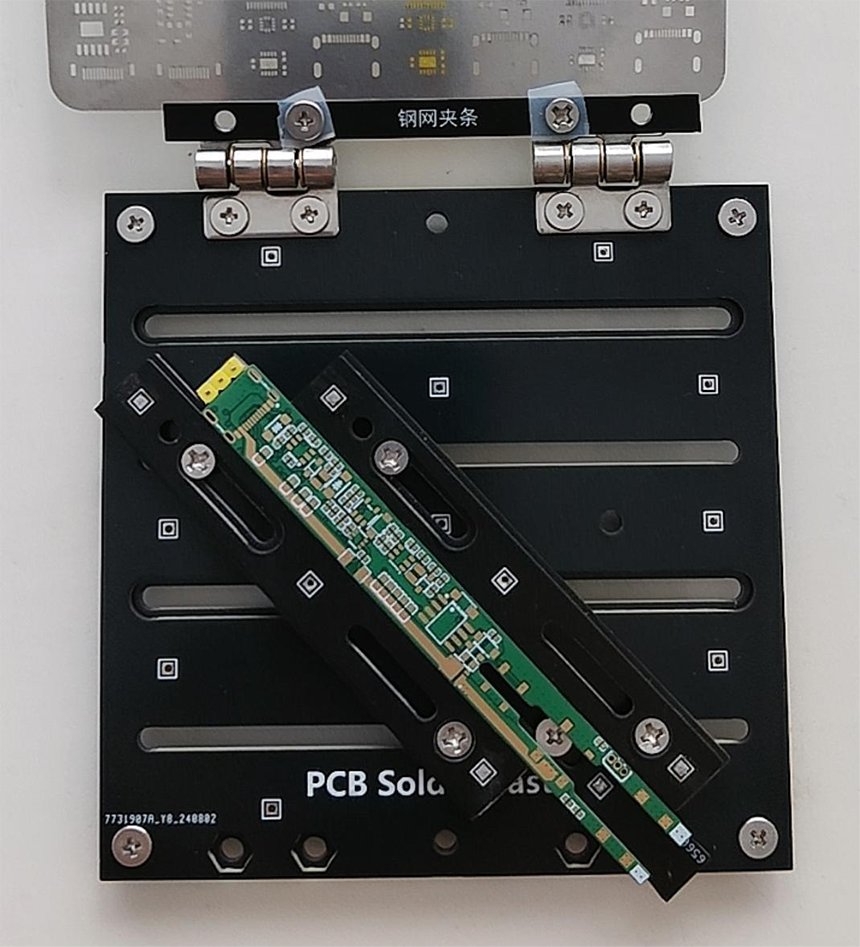

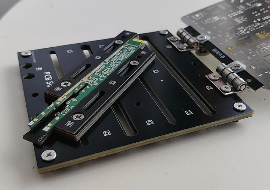

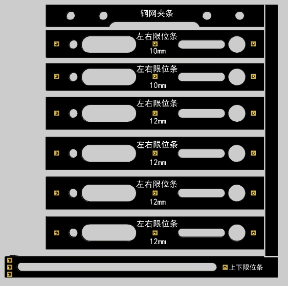

PCB screen printing table

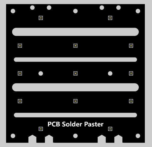

Use the simplest materials to assemble a convenient and easy-to-use solder paste application tool.

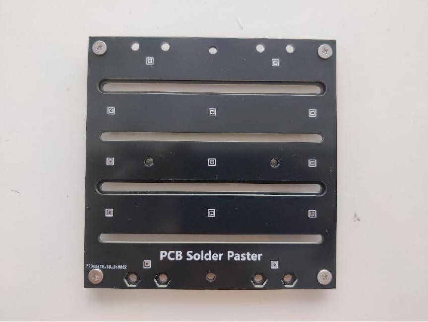

This image shows the base of the PCB silkscreen printing table
, version v1, which requires specific hinge models. The latest version, v2, has optimized the hinge design, allowing it to accommodate various sizes and dimensions, improving compatibility. Version v2 is recommended for printing.

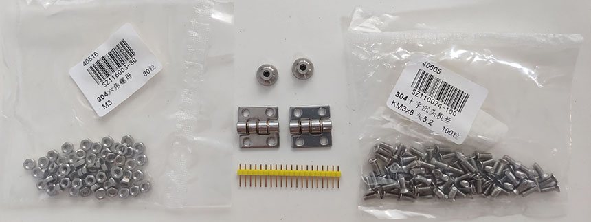

Required materials:
2/3 main base plates, 1.6mm/1mm thick;
2 auxiliary plates, 0.8mm thick; (white lines indicate trimming lines).
Additional materials include:
several M3x8 flathead screws, several
M3 nuts,

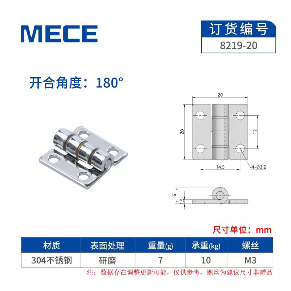

2 M3 through-hole knobs, and 2
20x20x6 hinges. Silkscreen printing

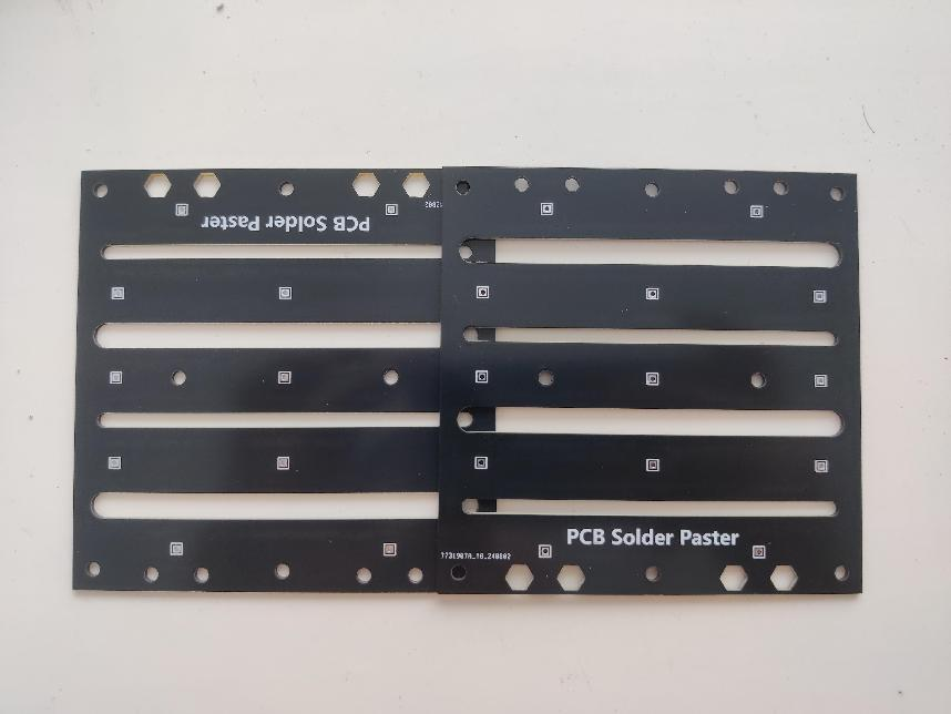

table construction : To
construct the main base plate
, rotate one of the two main boards 180 degrees, stack the two boards, and secure them using screws, nuts, and pin headers. For

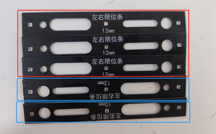

pin header soldering, the solder surfaces should be smoothed to facilitate the movement of the limit blocks. Testing shows that the strength is sufficient without pin header soldering, so this step can be omitted.
Therefore, as shown in the image, simply install screws at the four corners to complete the main base plate construction.

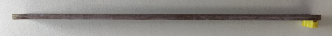

Two 1.6mm thick sheets can be stacked, three 1mm thick sheets can be stacked, and even all the main substrates provided by JLCPCB can be stacked together to increase the weight and stability of the base. Left and

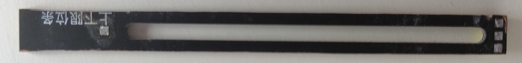

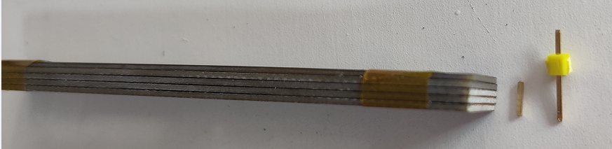

right limiting blocks are made using left and right limiting strips.

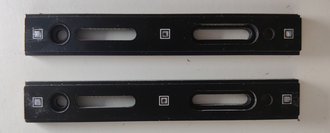

Each limiting block requires five limiting strips: four 12mm wide strips and one 10mm wide strip. (Limiting blocks made in this way are compatible with 0.8/1.0/1.2mm thick circuit boards. For 1.6mm thick circuit boards, three 12mm wide strips and two 10mm wide strips can be used to make the limiting blocks.)
As shown in the diagram, from bottom to top, place three 12mm wide strips upright and one reversed, and the 10mm wide strip reversed to hide the screw head and restrict screw movement.

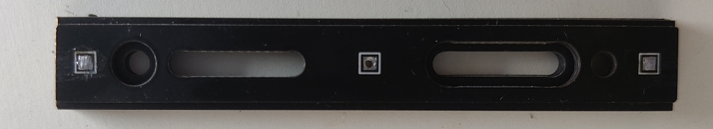

After stacking the limiting strips, cut out three pins of the same height and fix the limiting strips by soldering.
The soldered limiting block is shown in the diagram. Note that any protruding solder at the soldering points needs to be smoothed with a soldering iron to ensure smooth movement of the limiting block.
Make another limit block using the same method. The two limit blocks are identical and do not differentiate between left and right.

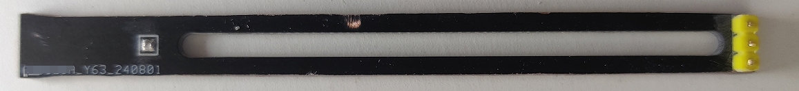

At this point, the left and right
limit strips are complete. The upper
and lower limit blocks are made in the same way as the left and right limit blocks. Note that the two upper and lower limit strips must be stacked together to form one upper limit block, and then the pin headers are soldered onto it. After soldering, trim off the pins that extend above the yellow base.
It is important to note that after soldering, the solder joints must be smoothed with a soldering iron.
At this point, the upper and lower limit blocks are also complete, and the next step, installation, can begin.

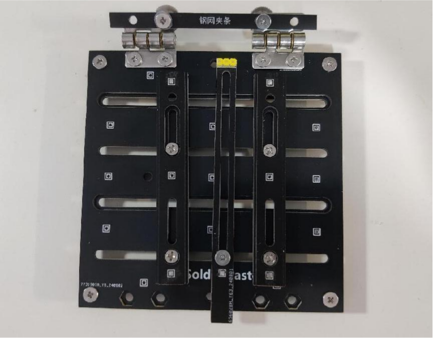

Assemble
the blocks, hinges, and clamping strips as shown in the diagram to obtain a simple and complete PCB screen printing station.
In the installation of the stencil strip on the hinge, a strip is clamped at the lower part of the upper hinge, and an M3x8 screw is inserted through the screw hole. The nut is then hand-tightened from the top.
For better performance, a silicone pad or washer can be placed between the M3x8 screw and the stencil strip to increase friction, thus limiting screw rotation when tightening the nut.
The effect after installing the stencil is shown in the figure. Because the left, right, and up/down limit blocks all move within a single track, even very thin PCBs can be soldered at any position, making it very convenient.
