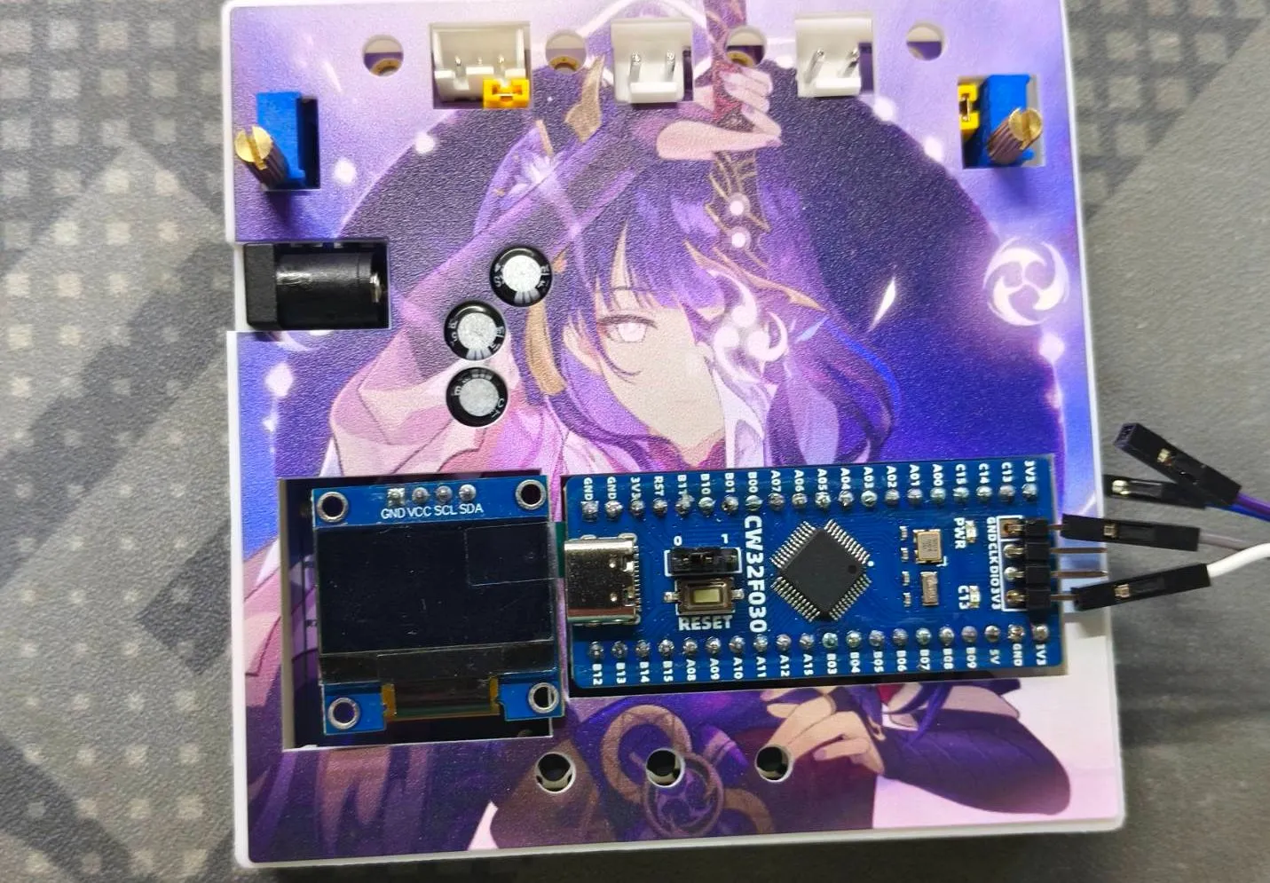

This project is a lightweight, aesthetically pleasing, and accurate voltage and current meter. It uses the CW32 Diwenxing development board and an OLED display to show the measurement data. The project originates from the LCSC Training Camp.

: The schematic diagram is provided at the end of the document. For detailed explanations, please refer to the LCSC Training Camp: CW32 Digital Voltage and Current Meter Training Camp Project Tutorial Document | LCSC Development Board Technical Document Center (lckfb.com). A slight difference is the use of an OLED instead of a digital tube. This document mainly discusses some soldering experiences for beginners.
As I am a complete beginner, I purchased the following soldering equipment based on recommendations from experienced users:
an unknown T12 soldering station + Yamazaki solder wire (63 rosin core): Overall, it is very beginner-friendly. The soldering station heats up in 3 seconds, and the leaded solder wire makes it easier for beginners to get started. The rosin core is even more convenient, saving a lot of trouble.
Deer Fairy Teppanyaki + Solder Paste (Needle Tip): If you have the budget, I still recommend using a heating plate. Although this teppanyaki is cheap, it lacks temperature control and requires you to connect the power cord yourself, which poses certain safety hazards.
Since most of the components in this project are surface-mount, and the components are small and densely packed, it is not very user-friendly for beginners. Therefore, this set of equipment provides great assistance. The soldering diagram is as follows:

software is mainly composed of two parts: OLED display and voltage and current data reading.
The program idea of ​​OLED display is that the main control chip CW32 controls the OLED display through the I2C protocol:
