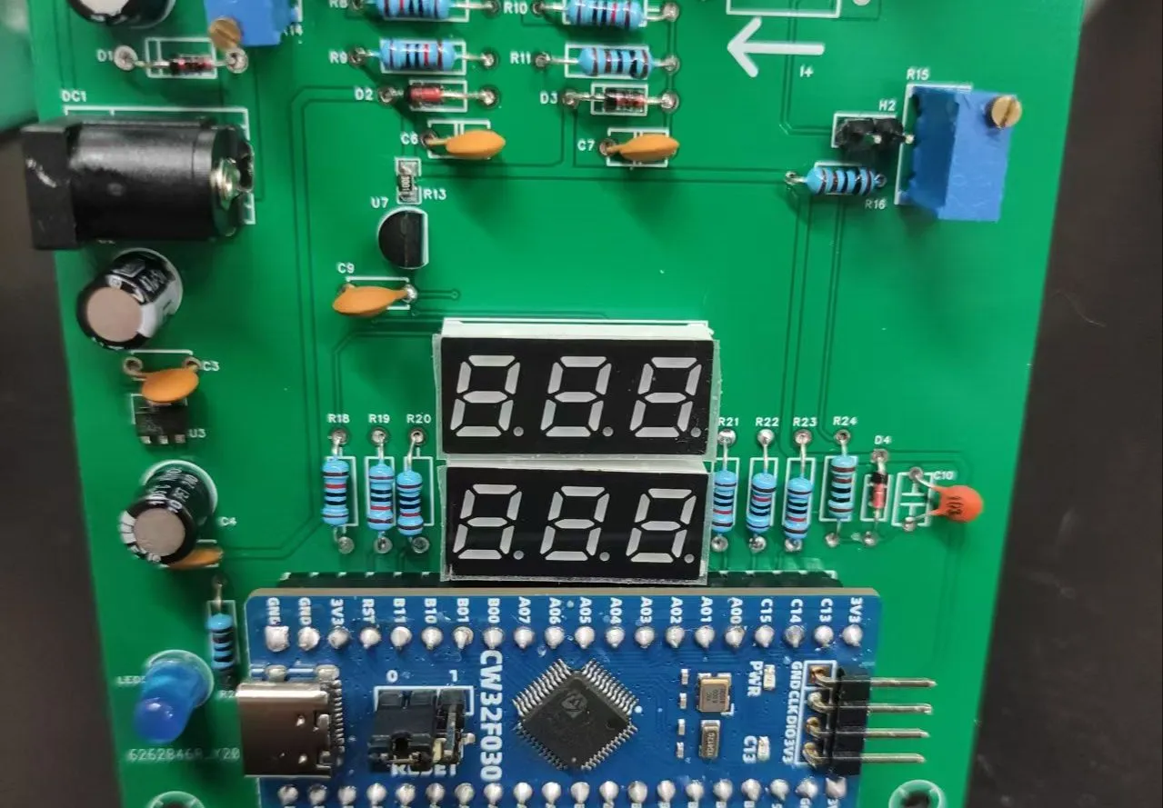

Voltage and current detectors
*1. Function Introduction

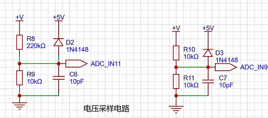

1. Accurately measures input voltage and current
2. Wide voltage measurement capability, maximum measurement voltage is 30V 2A
3. Maximum input voltage is 40V

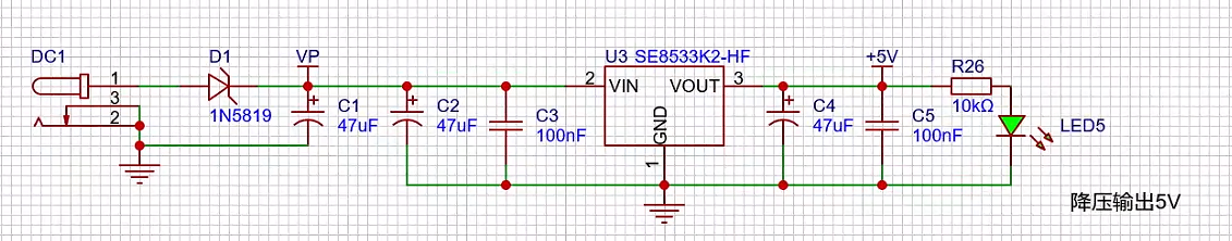

*4. Hardware:

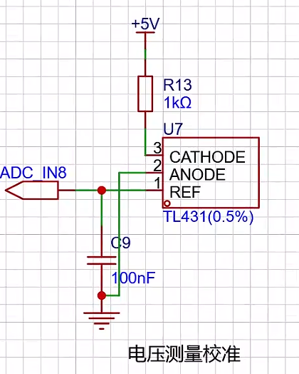

The step-down circuit here has a 12V input and 5V output
to reduce measurement voltage error. A TL431 is used to build the calibration circuit.

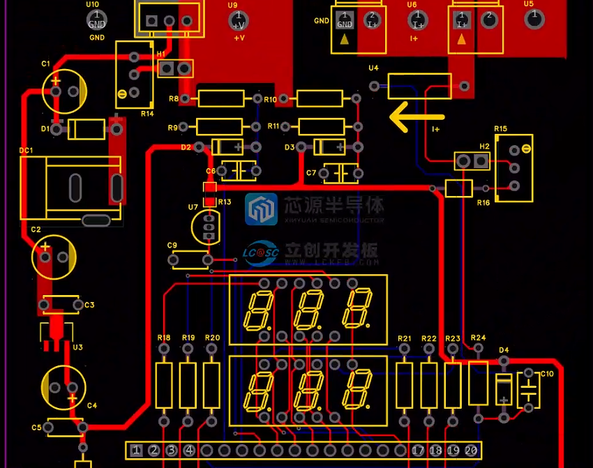

*5. PCB Part

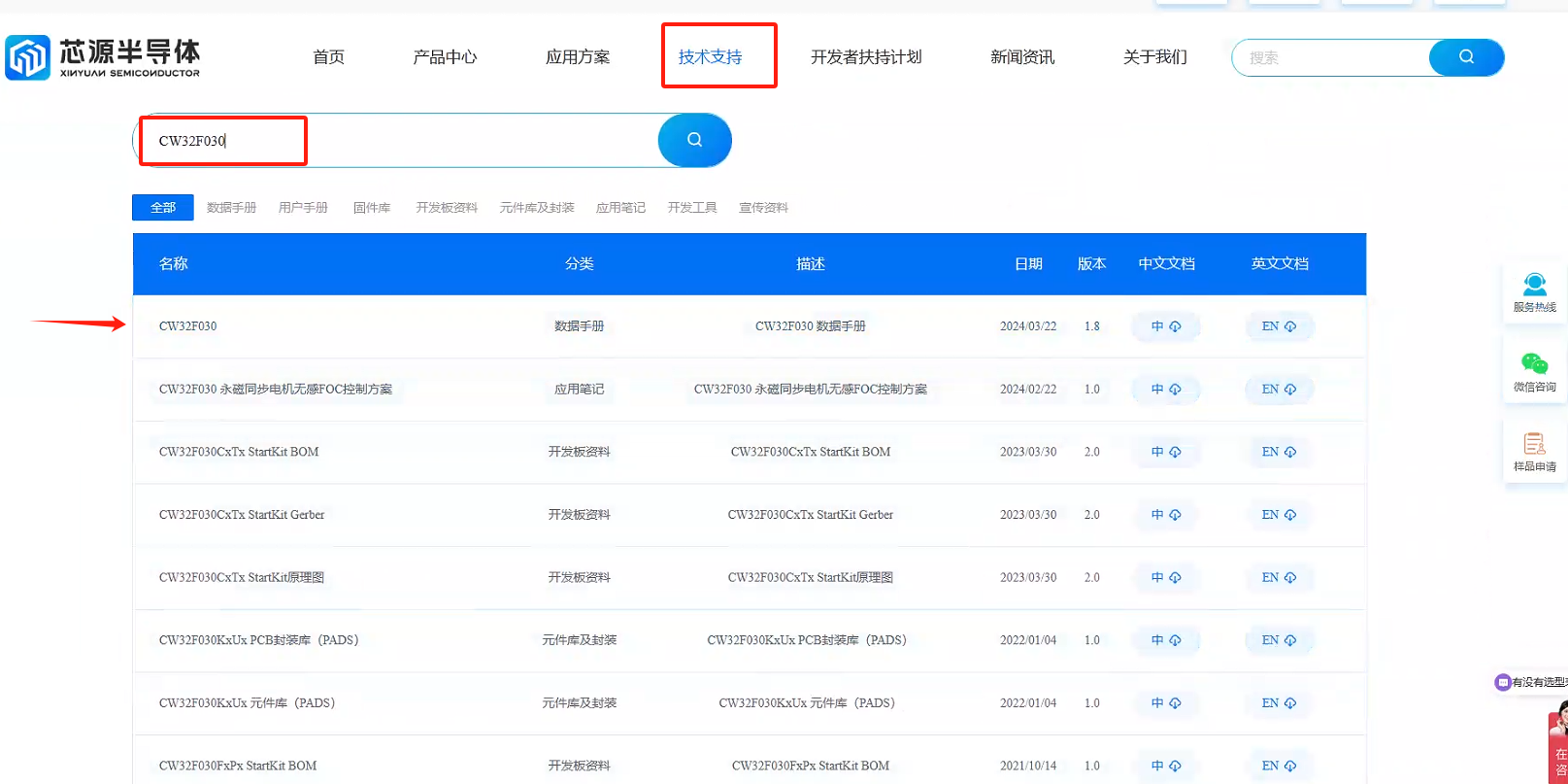

The corresponding example code can be downloaded from the CW32 official website. (
Uploaded as an attachment for download.)
