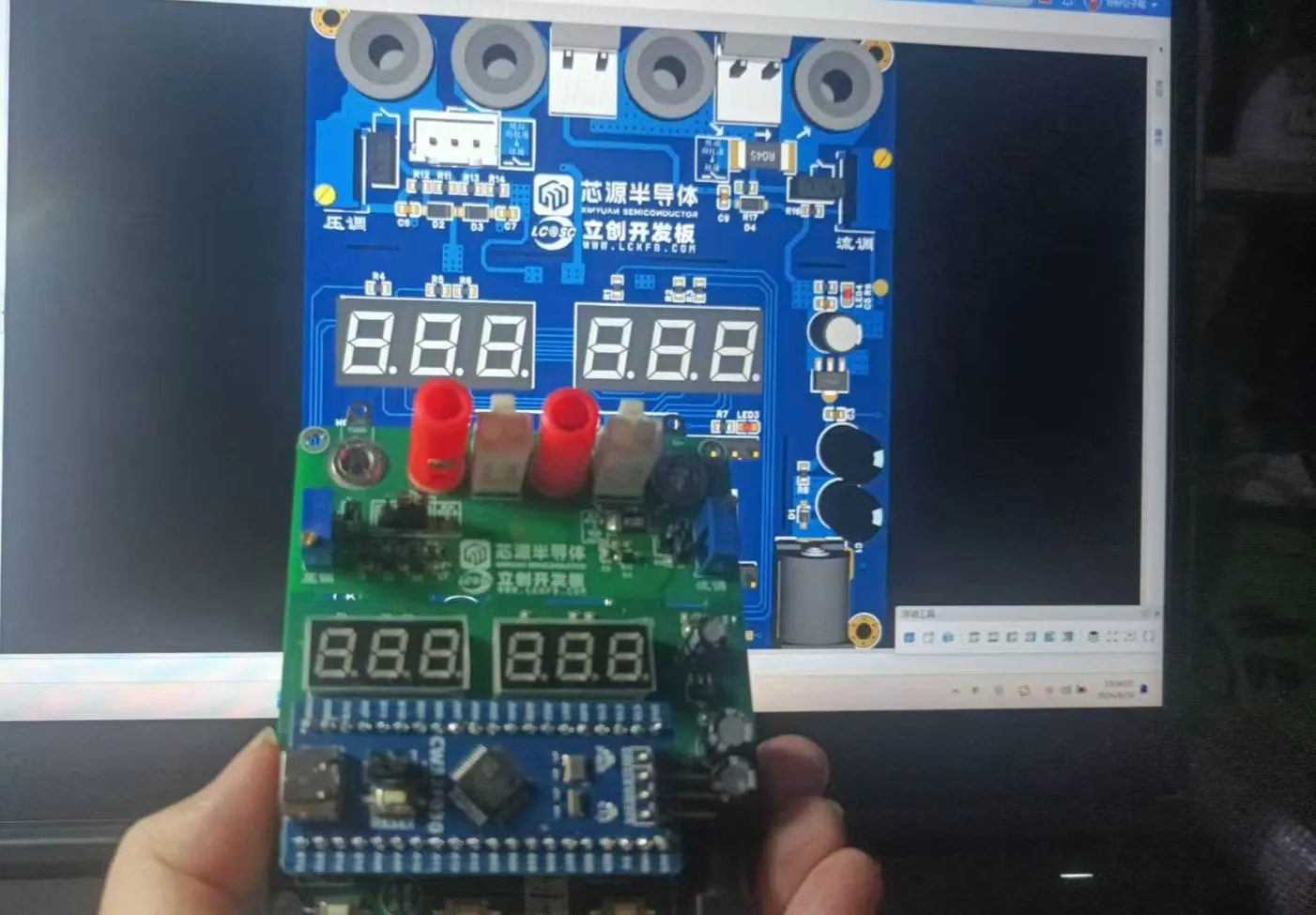

A Simple Voltage and Current Meter Based on CW32F030C8 [Training Camp 2024.7]
The I/O allocation for this project is only applicable to the CW32F030C8T6 minimum system board from Chipone Semiconductor. For specific allocation details, please refer to the schematic diagram,
final effect diagram, and finished product diagram.

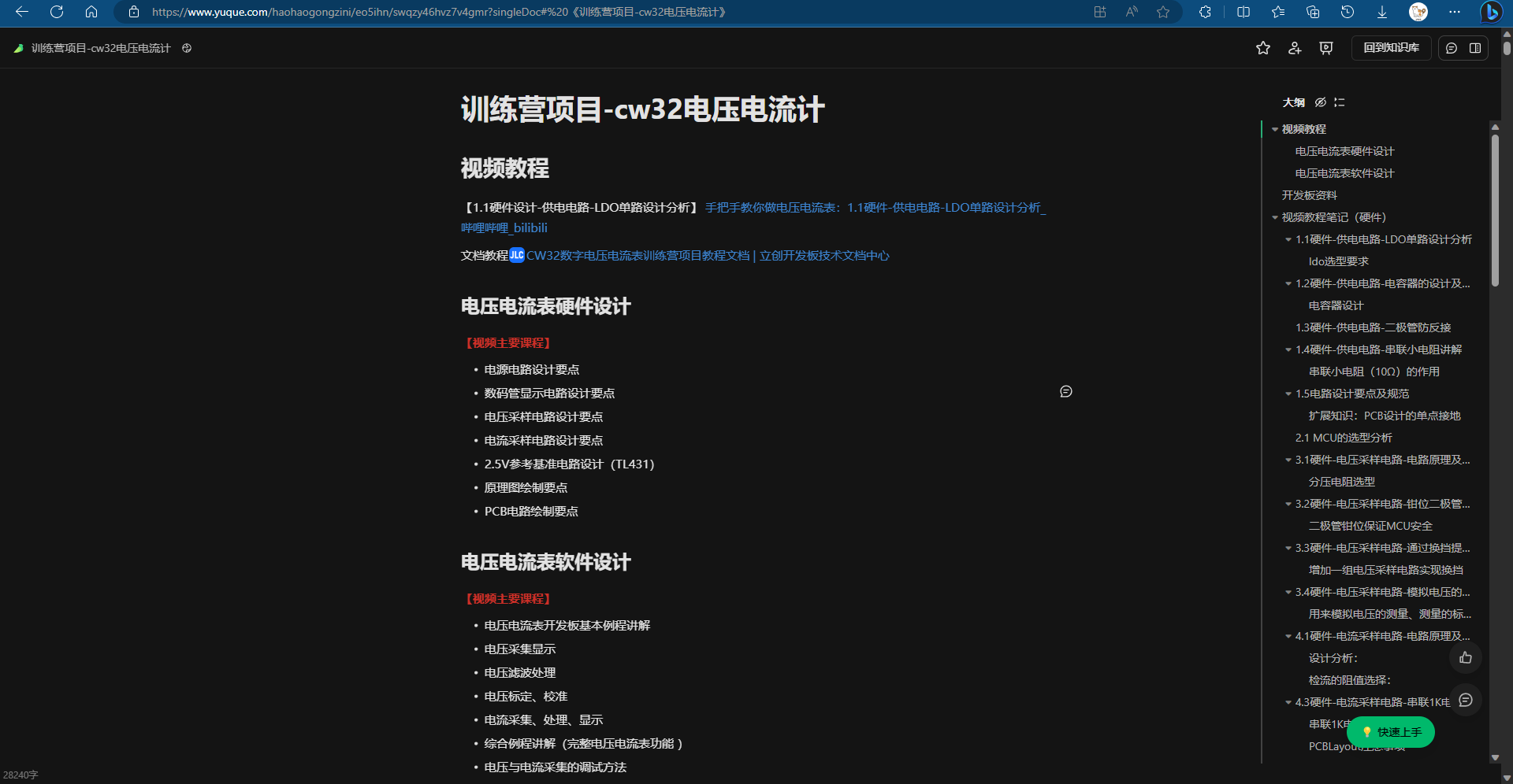

4. Author's Own Notes: Yuque Document Address (Added some of my own, step-by-step from hardware to software)

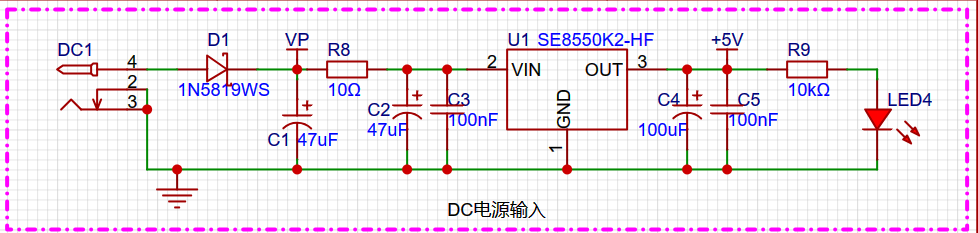

1. Power Supply Circuit SE8550K2
LDO (Low Dropout Linear Regulator) Selection: This project uses an LDO as the power supply. Considering that most voltmeter products are used in industrial scenarios with 24V or 36V power supplies, the SE8550K2 with a maximum input voltage of 40V was selected. The main reason for not using a DC-DC step-down circuit to handle the large voltage drop is to avoid introducing DC-DC ripple interference during the design process; a secondary reason is to reduce project costs.

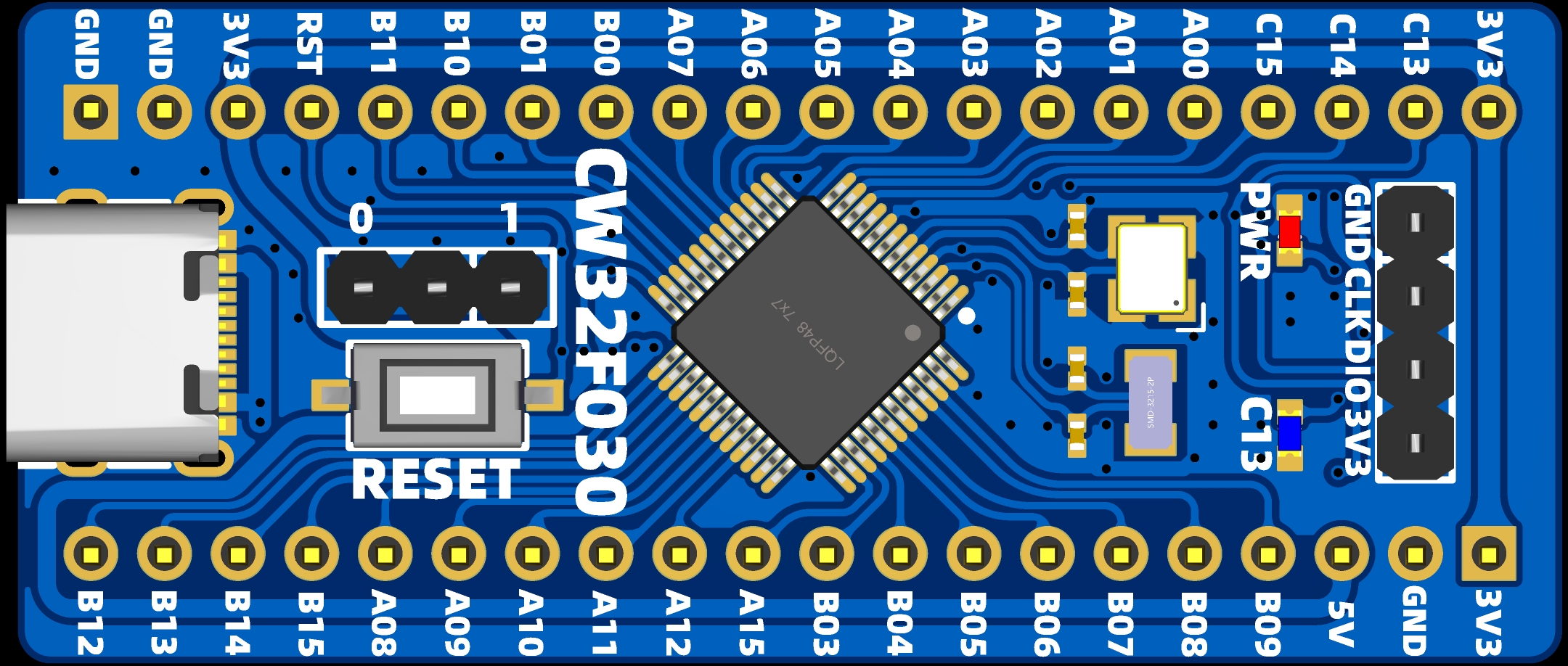

2. MCU Control: CW32 M0
Selection Should Not Be Blind: When selecting the MCU (Microcontroller Unit) for this project, multiple aspects need to be considered to ensure that the selected MCU meets the project requirements.
Clearly define your project requirements: Clearly understand how much computing power the project needs, including clock speed, processor core type, and whether a floating-point unit is required.
Clearly define the required I/O ports and important peripherals, such as ADC peripherals. Since this project is a development board project, the main purpose is debugging and learning; therefore, there are no strict limitations on the number of I/O ports: i.e., the cost associated with it is not considered.
Remember to match the correct port

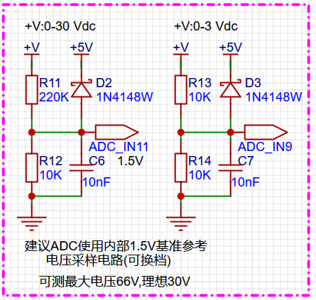

3. Voltage sampling.
The voltage ratio of the resistor is 220K+10K. The voltage divider resistor in this project is 22:1 (ADC_IN11).
is selected to measure the maximum voltage. For safety reasons, this project uses 30V (the actual maximum can be displayed as 99.9V or 100V).
The ADC reference voltage is 1.5V in this project, and this reference voltage can be configured through the program.
To reduce power consumption in the sampling circuit, the low-side resistor (R7) is typically chosen as 10K based on experience.
The high-side resistance of the voltage divider can then be calculated using the above parameters.
The required voltage division ratio is calculated as follows: ADC reference voltage: Design input voltage, calculated as 1.5V/30V = 0.05 using known parameters.
High-side resistance: Low-side resistance/voltage division ratio, calculated as 10K/0.05 = 200K using known parameters.
A standard resistor is selected: A resistor slightly higher than the calculated value of 200K is chosen. We typically choose E24 series resistors; therefore, in this project, 220K is chosen, which is greater than 200K and closest to the calculated value.
If, in actual use, the voltage to be measured is lower than 2/3 of the module's design voltage (66V), the voltage divider resistor can be replaced and the program modified to improve measurement accuracy. An example is provided below:
Assuming the measured voltage is no higher than 24V, and other parameters remain unchanged .
Calculations show that 1.5V/24V = 0.0625, and 10K/0.0625 = 160K. 160K is a standard E24 resistor and can be directly selected. Alternatively, a higher resistance value of 180K can be chosen to allow for some redundancy.
In practical applications, if the voltage to be measured is higher than the module's design voltage of 99V, the voltage divider resistor can be replaced, or the reference voltage can be modified to achieve a larger voltage measurement range. The following example illustrates this:
Assuming the measured voltage is 160V, the solution is to increase the voltage reference to expand the range.
Given that the voltage division ratio of the selected resistor is 0.0145, we can calculate 160V * 0.0145 = 2.32V using the formula. Therefore, we can choose a 2.5V voltage reference to increase the range (increasing the range will reduce accuracy).
Considering the potential fluctuations in the measured power supply, a 10nF filter capacitor is connected in parallel with the low-side voltage divider resistor in the circuit design to improve measurement stability. In this project, an additional voltage sampling circuit was
added
. Therefore, we can discuss the significance of range switching in improving measurement accuracy. To achieve more accurate measurements, multimeters often have multiple range settings. By adjusting different ranges, the optimal measurement accuracy of the measured point within the corresponding range can be obtained.
This project requires a combination of hardware and software to implement this function. When we first use the ADC_IN11 channel mentioned earlier to measure voltages below 30V, if the measured voltage is within 0~3V, then we use the ADC_IN9 channel for measurement. At this time, due to the reduced voltage division ratio, the measurement accuracy is greatly improved. There are many ways to implement range switching, and the development board design provides more design possibilities.

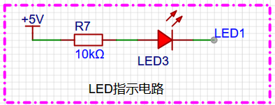

6. Power Indicator and Working Indicator

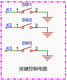

7. Button Circuit Ordinary Buttons

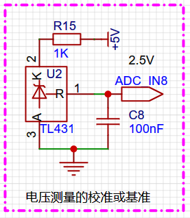

8. Reference Voltage TL431
This project adds an extra TL431 circuit to provide a 2.5V reference voltage, which can be used to provide an external voltage reference for calibrating the ADC. From a product design perspective, due to the inherent ADC performance advantages of the CW32, this circuit is not necessary. This circuit is designed on the development board to learn the relevant application principles. The
TL431 is a relatively "old" device, very classic, and widely used; it is still found in many electronic products.
Many beginners may be encountering this device for the first time, so we will briefly explain the principles of this product to help everyone better apply the TL431.
TI defines it as a precision programmable reference in its name. On the first page of the references, we can focus on several key characteristics.
Precision: Precision indicates that its output voltage is very accurate. I used a ±0.5% accuracy TL431, which measured 2.495V on the board at room temperature. Compared to common Zener diodes, the accuracy is vastly different. In the application circuit diagram, the TL431 is represented by a Zener diode symbol.
Adjustable output voltage: The adjustable output voltage is between Vref and 36V. In our project, we use the output Vref voltage. Vref voltage is approximately 2.5V. Therefore, we use 2.5V in the description, which is approximately equal to 36V.
Sinking current capability: This refers to how much current the output voltage pin can provide. This is greatly related to the resistance value (R13) in the application circuit. It should not be less than 1mA. If there is no need for sinking current, do not design the current too high, causing unnecessary power consumption.

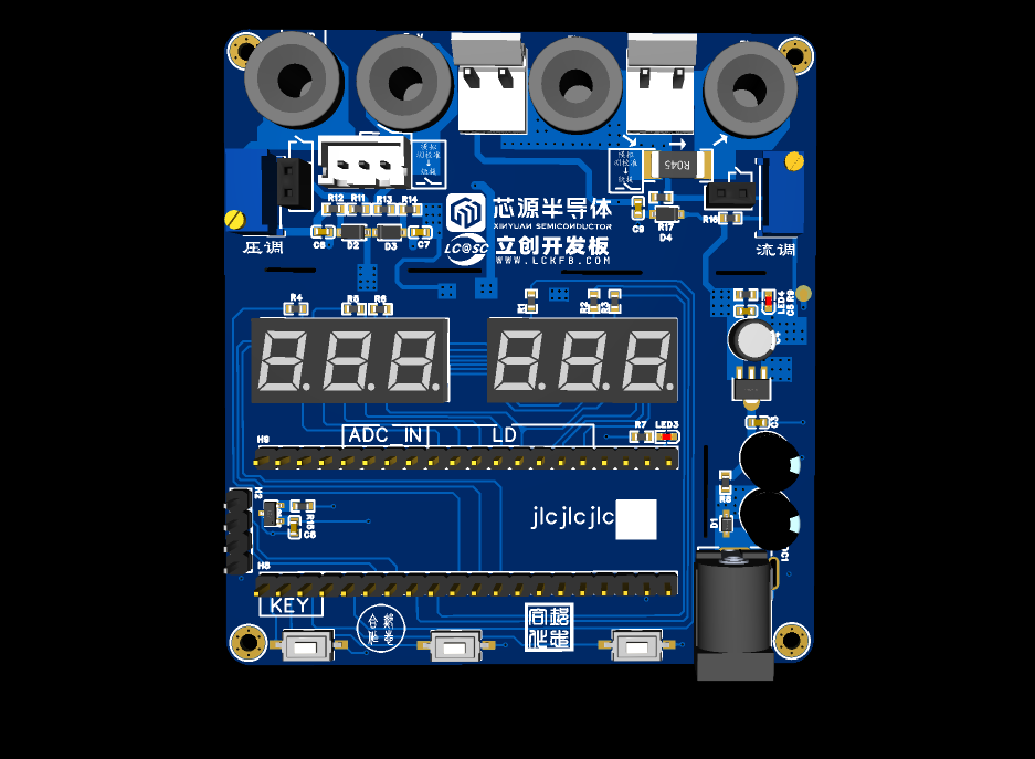

PCB design (see document for details)

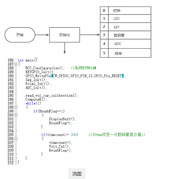

Software
1. The official documentation is very detailed
main.c
#include "main.h"
#include "Seg_Dis.h"
#include "BTIM1.h"
#include "ADC.h"
#include "flash".h"
extern uint16_t Volt_Buffer[ADC_SAMPLE_SIZE];
extern uint16_t Curr_Buffer[ADC_SAMPLE_SIZE];
extern uint8_t Seg_Reg[6];
uint16_t V_Buffer,I_Buffer;
unsigned int spp_start=0;
uint32_t ble_time=0;
unsigned int timecount=0;
//5V and 15V calibration
unsigned int X05=0;
unsigned int X15=0;
unsigned int Y15=15;
unsigned int Y05=5;
float K; //slope
//0.5A and 1.5A calibration
unsigned int IX05=0;
unsigned int IX15=0; unsigned
int IY15=150;
unsigned int IY05=50;
float KI; //slope
//defining mode
unsigned char Mode=0;
//mode0 :Voltage and current normal display mode
//mode1 :Voltage 5V calibration
//mode2 :Voltage 15V calibration
//mode3 : Current 0.5A calibration
// mode4 : Current 1.5A calibration
unsigned char BrushFlag=0;
void RCC1_Configuration(void)
FLASH_SetLatency(FLASH_Latency_2); // Set the main frequency to 48MHz. Note that the access cycle of the FLASH needs to be changed to FLASH_Latency_2.
  RCC_HSI_Enable(RCC_HSIOSC_DIV1); // Set the frequency to 48MHz
RCC_SYSCLKSRC_Config(RCC_SYSCLKSRC_HSI); // Select the SYSCLK clock source 48MHz
RCC_HCLKPRS_Config(RCC_HCLK_DIV1); // Configure the division factor from SYSTICK to HCLK 48MHz
RCC_PCLKPRS_Config(RCC_PCLK_DIV8); // Configure the division factor from HCLK to PCLK 6MHz
InitTick(48000000); // The SYSTICK operates at a frequency of 48MHz, interrupting once every ms
void RCC_Configuration(void)
  /* 0. Enable and calibrate HSI */
  RCC_HSI_Enable(RCC_HSIOSC_DIV6);
  /* 1. Set the division factor for HCLK and PCLK */
  RCC_PCLKPRS_Config(RCC_PCLK_DIV1);
  /* 2. Enable PLL, multiply the frequency to 64MHz via PLL */
  RCC_PLL_Enable(RCC_PLLSOURCE_HSI, 8000000, 6); // HSI default output frequency 8MHz
 // RCC_PLL_OUT(); // Output PLL clock on PC13 pin
  __RCC_FLASH_CLK_ENABLE();
  FLASH_SetLatency(FLASH_Latency_3);
  /* 3. Switch the clock to PLL */
  RCC_SysClk_Switch(RCC_SYSCLKSRC_PLL);
  RCC_SystemCoreClockUpdate(48000000);
RCC_PCLKPRS_Config(RCC_PCLK_DIV8); // Configure HCLK The frequency divider to PCLK is 6MHz.
void KEYGPIO_Init(void)
__RCC_GPIOB_CLK_ENABLE();//Enable the clock for GPIOB
__RCC_GPIOC_CLK_ENABLE();//Enable the clock for GPIOC
GPIO_InitTypeDef GPIO_InitStruct;
GPIO_InitStruct.Pins = GPIO_PIN_12|GPIO_PIN_13|GPIO_PIN_14; //
GPIO_InitStruct.Mode = GPIO_MODE_INPUT_PULLUP;
  GPIO_InitStruct.IT = GPIO_IT_NONE;
GPIO_InitStruct.Speed ​​= GPIO_SPEED_HIGH;
  GPIO_Init(CW_GPIOB, &GPIO_InitStruct);
GPIO_InitStruct.Pins = GPIO_PIN_13; //
GPIO_InitStruct.Mode = GPIO_MODE_OUTPUT_PP;
  GPIO_Init(CW_GPIOC, &GPIO_InitStruct);
extern void DisplaySETV(uint32_t value);
void DisplayBuff(void)
  if(Mode==0)
Display(V_Buffer);
if(I_Buffer>400)I_Buffer=400;
DisplayI(I_Buffer);
else if(Mode==1) //S.05.
Seg_Reg[0] =5+10;
Seg_Reg[1] =0;
Seg_Reg[2]=5+10;
DisplaySETV(V_Buffer);
else if(Mode==2) //S.15.
Seg_Reg[0] =5+10;
Seg_Reg[1] =1;
Seg_Reg[2]=5+10;
else if(Mode==3) //A.0.5
Seg_Reg[0] =20;
Seg_Reg[1] =0+10;
Seg_Reg[2]=5;
DisplayI(I_Buffer);
else if(Mode==4) //A.1.5
Seg_Reg[0] =20;
Seg_Reg[1] =1+10;
Seg_Reg[2]=5;
DisplayI(I_Buffer);
void ComputeK(void)
{ K =
(Y15-Y05); K=K/(X15-X05) ; KI=(IY15 - IY05 ) ;   da[0]=0xaa;   da[1]=X05;   da[2]=X15;   da[3]=IX05;   da[4]=IX15;     flash_erase();     flash_write(0,da,5); } /**  * @brief  *  */ void read_vol_cur_calibration(void) {     uint16_t da[5];     flash_read(0,da, 5);   if(da[0]!=0xaa)//If it hasn't been calibrated yet, calculate the theoretical value and store it { X15=15.0/23/1.5*4096; X05=5.0/23/1.5*4096; IX05=0.5*0.1/1.5*4096; IX15=1.5*0.1/1.5*4096;       save_calibration(); } else  { X05=da[1]; X15=da[2]; IX05=da[3]; IX15=da[4]; } } void Volt_Cal(void); int main() { RCC_Configuration(); //System clock 64M KEYGPIO_Init(); GPIO_WritePin(CW_GPIOC,GPIO_PIN_13,GPIO_Pin_RESET);  Seg_Init(); Btim1_Init(); ADC_init();  read_vol_cur_calibration(); ComputeK(); while(1) {  if(BrushFlag==1) { DisplayBuff(); BrushFlag=0; } if(timecount>= 300) //Change the digital tube display value once every 300ms// { timecount=0; Volt_Cal(); BrushFlag=1; } } } uint32_t Mean_Value_Filter(uint16_t *value, uint32_t size) //Mean filtering {     uint32_t sum = 0;     uint16_t max = 0;     uint16_t min = 0xffff;     int i;     for(i = 0; i     {         sum += value[i];         if(value[i] > max)         {             max = value[i];
        if(value[i]
            min = value[i];
    sum -= max + min;
    sum = sum / (size - 2);
//if(sum>1)sum+=4; Post-calibration
    return sum;
void Volt_Cal(void)
float t,KT1;
V_Buffer = Mean_Value_Filter(Volt_Buffer,ADC_SAMPLE_SIZE);//Use mean filtering
I_Buffer = Mean_Value_Filter(Curr_Buffer,ADC_SAMPLE_SIZE); //Use mean filtering
if(V_Buffer>=X05)
t=V_Buffer-X05;
  V_Buffer=(K*t+Y05)*1000;}
else
KT1=5000;
KT1=KT1/X05;
V_Buffer=KT1*V_Buffer;
// Rounding
    if(V_Buffer % 10 >= 5)
        V_Buffer = V_Buffer / 10 + 1; //10mV is the unit
    else
        V_Buffer = V_Buffer / 10;
if(I_Buffer>=IX05)
t=I_Buffer-IX05;
   I_Buffer=(KI*t+IY05)*10;
else
KT1=500;
KT1=KT1/IX05;
I_Buffer=KT1*I_Buffer;
if(I_Buffer % 10 >= 5)
        I_Buffer = I_Buffer / 10 + 1;
    else
        I_Buffer = I_Buffer / 10;
//I_Buffer=I_Buffer * ADC_REF_VALUE >> 12;
        mv =I_Buffer * ADC_REF_VALUE >> 12,
        R = 100mr,
        10ma = mv/R/10=mv/0.1/10 = mv

if(GPIO_ReadPin(CW_GPIOB,GPIO_PIN_12)==GPIO_Pin_RESET)
keytime++;
if(keytime>=100 )
  keytime=0; //switch mode
Mode++;
if(Mode>=5)Mode=0;
BrushFlag=1; // Update the digital tube
else keytime=0;
if(GPIO_ReadPin(CW_GPIOB,GPIO_PIN_13)==GPIO_Pin_RESET&&Mode!=0)
keytime2++;
if(keytime2>=100 )
  keytime2=0; // Switch mode
  if(Mode==1)
X05=Mean_Value_Filter(Volt_Buffer,ADC_SAMPLE_SIZE);
save_calibration();ComputeK();Volt_Cal();BrushFlag=1;Mode=0;
if ( Mode == 2 )
{​ save_calibration();ComputeK();Volt_Cal();BrushFlag=1;Mode=0; } if(Mode==4) { IX15=Mean_Value_Filter(Curr_Buffer,ADC_SAMPLE_SIZE); save_calibration();ComputeK();Volt_Cal();BrushFlag=1;Mode=0; }  }  } else keytime2=0;  if(GPIO_ReadPin(CW_GPIOB,GPIO_PIN_13)==GPIO_Pin_RESET)        { keytime3++; if(keytime3>=100 ) {   keytime3=0; //Switch mode Mode=0;  BrushFlag=1; //Update digital tube }  } else keytime3=0;    }   /* USER CODE END */ } ..Problems                                                                                                                                                                                                                                                                                                                                                                              encountered: 1. The source code downloaded from the official website, after adjusting the compilation environment V5.06 and confirming activation, correct version, no code modification, and correct path, still shows the error "cmsis_version.h not found" (as shown in the picture below). This may be because the CMSIS firmware is too old. Update it. The firmware is attached: ARM.CMSIS.5.9.0.pack 2. Measure the size of the banana plug to prevent it from not fitting. My first version was slightly off in size. It is recommended to increase the diameter by 0.2CM, such as in V1.1 3. The operation process is shown in my V1.1 silkscreen ...                                                                                                                                                                                                                                                                                                                                                                              Buy, buy, buy! 1. LCSC Mall (use 16-15mm batteries wisely, they're enough) 2. Taobao [Taobao] https://m.tb.cn/h.gOiMK9fGGU9G6cX?tk=yMCK3VkxsKW MF6563 "5 x 4mm lantern head banana plug socket terminals male and female plug-in power test terminals female plug" Click the link to open directly or search on Taobao to open directly 3. [Taobao] https://m.tb.cn/h.gOiosFkG74O7PQ9?tk=RDeJ3VkDlEE CZ0002 "Dayi alloy resistor 2512/2W/3W 1%" 0.033R-0.2R/RLP25FEGR033-R200" Click the link to open directly or search on Taobao. 4. [Taobao] https://m.tb.cn/h.gOiL1LAF1qzPgGD?tk=Alt93VkDOB3 HU9196 "~DC power plug socket male and female connector adapter female and male 5.5-2.1/2.5mm 3.5 round hole (~@ ~)" Click the link to open directly or search on Taobao .                                                                                                                                                                                                                                                                                                                                                                              Finally, thanks to LCSC EDA, thanks to Sinyuan Semiconductor, thanks to LCSC development board, and thanks to LCSC Mall.
