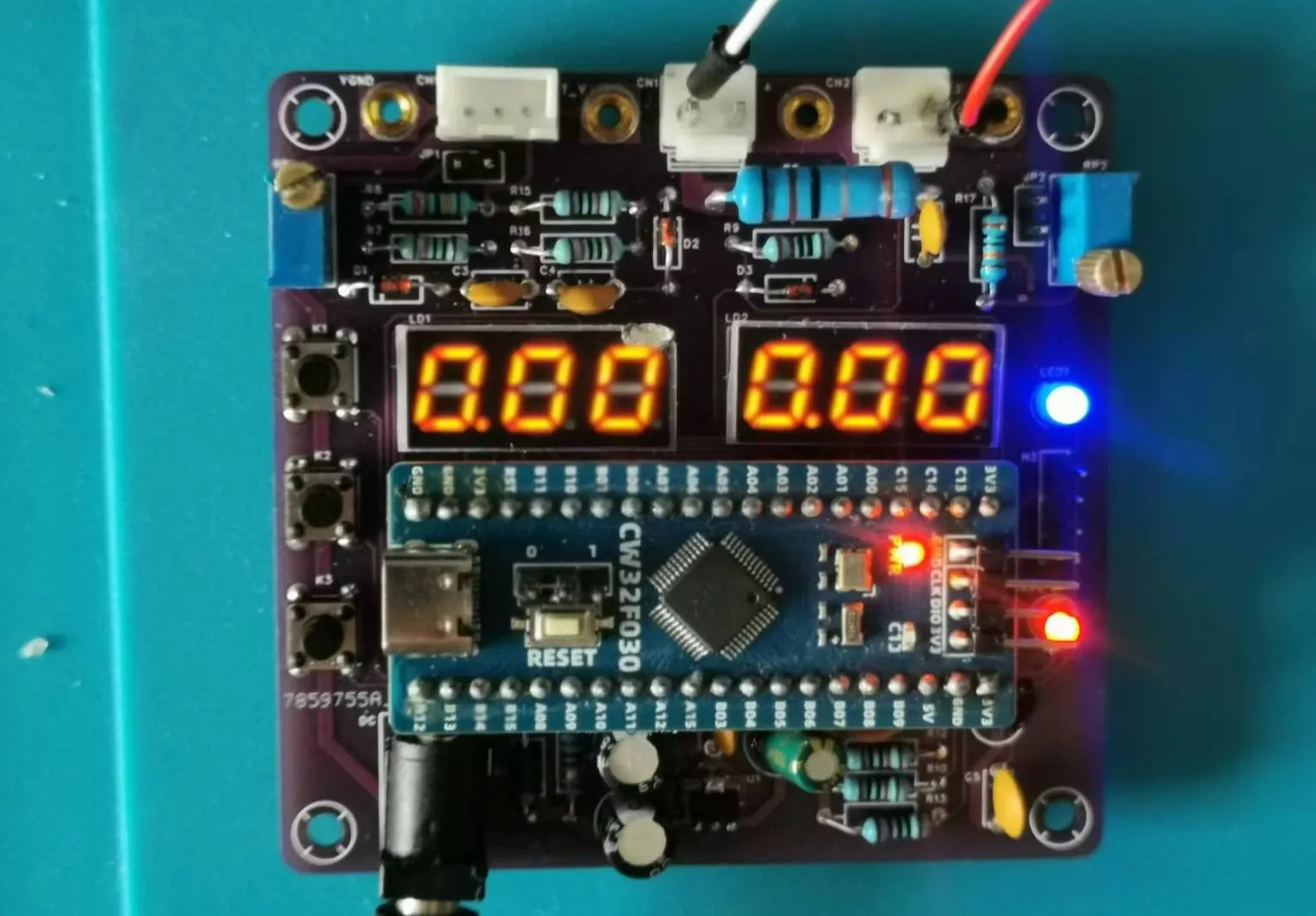

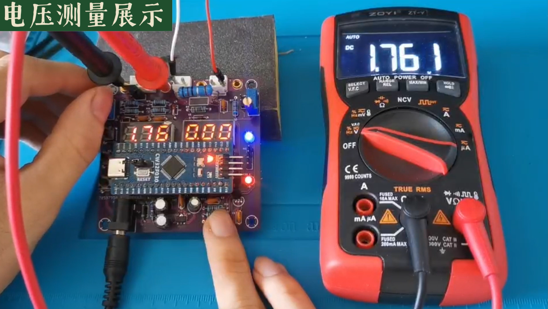

Voltage and current meter based on CW32F030

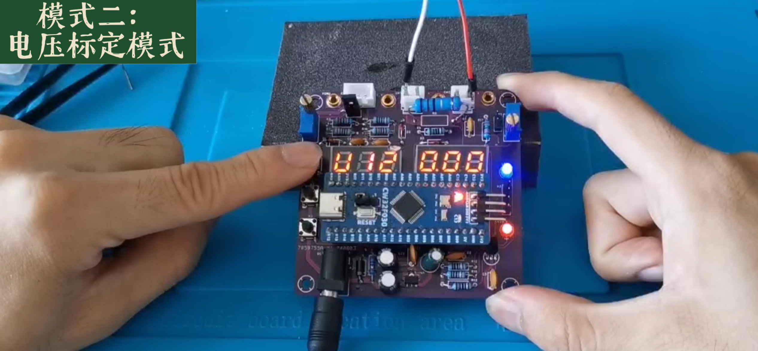

Function

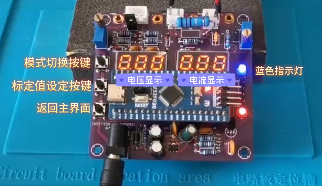

         Button 1 Function Selection:
                           1. Normal Measurement Display Mode

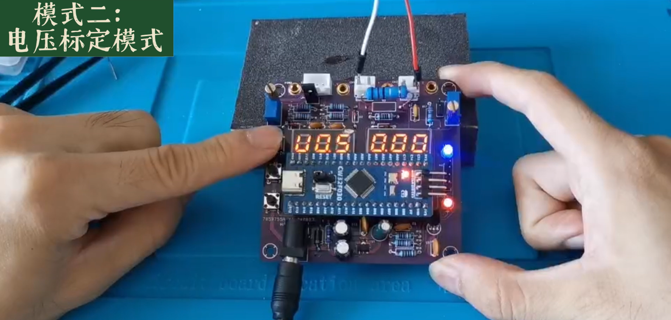

                     2. 0.5V Calibration Setting
                     3. 1V Voltage Calibration Setting
                     4.
                     2V Voltage Calibration Setting 5. 5V Voltage Calibration Setting
                     6. 12V Voltage Calibration Setting
                     7.

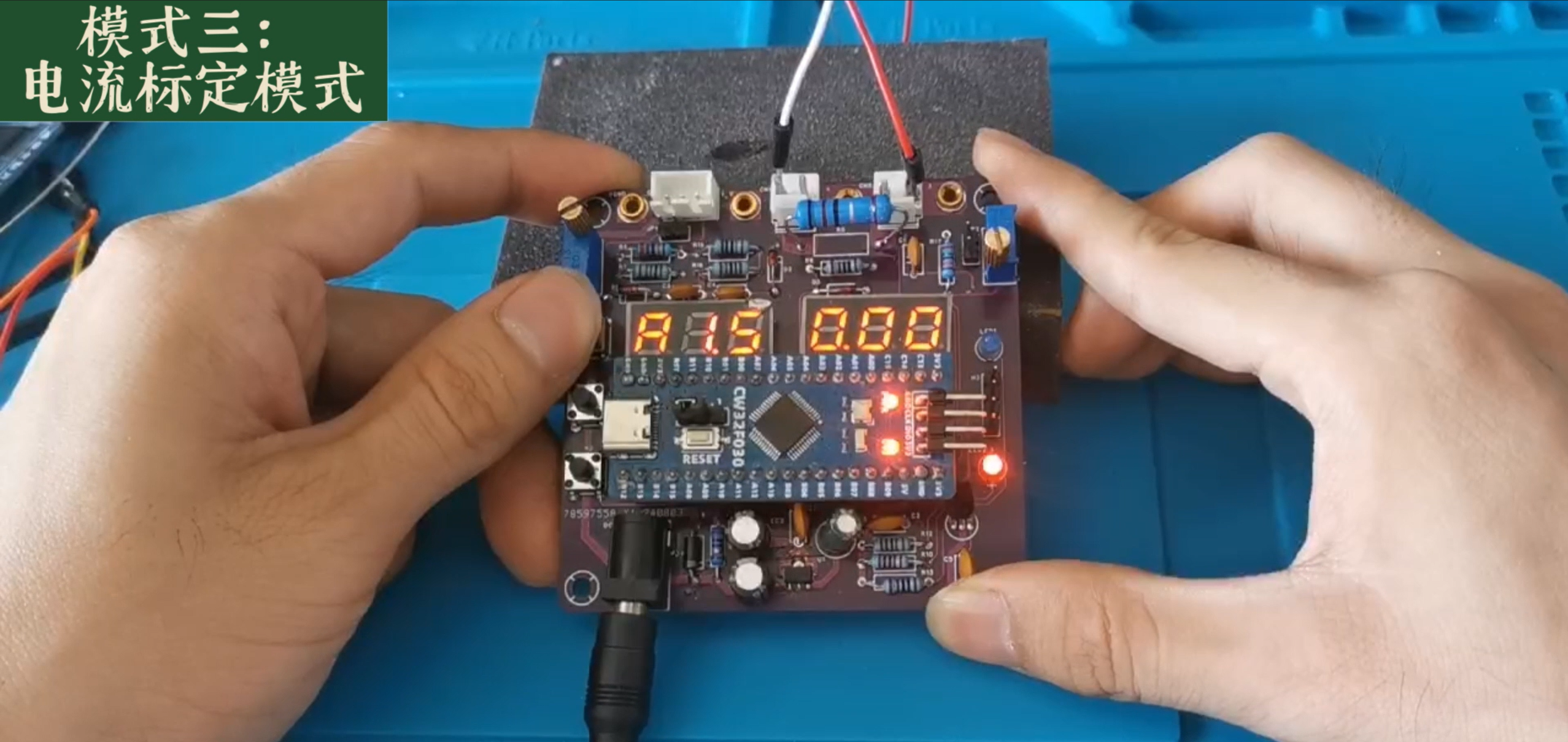

                     0.5A Calibration Setting 8.          1A Calibration Setting
           Button 2 Set Calibration Value
           Button 3 Return to Voltage and Current Measurement Display Mode
Detailed explanations are available in the software files
         : Current and Voltage Meter Project Code Extraction Code: 2024

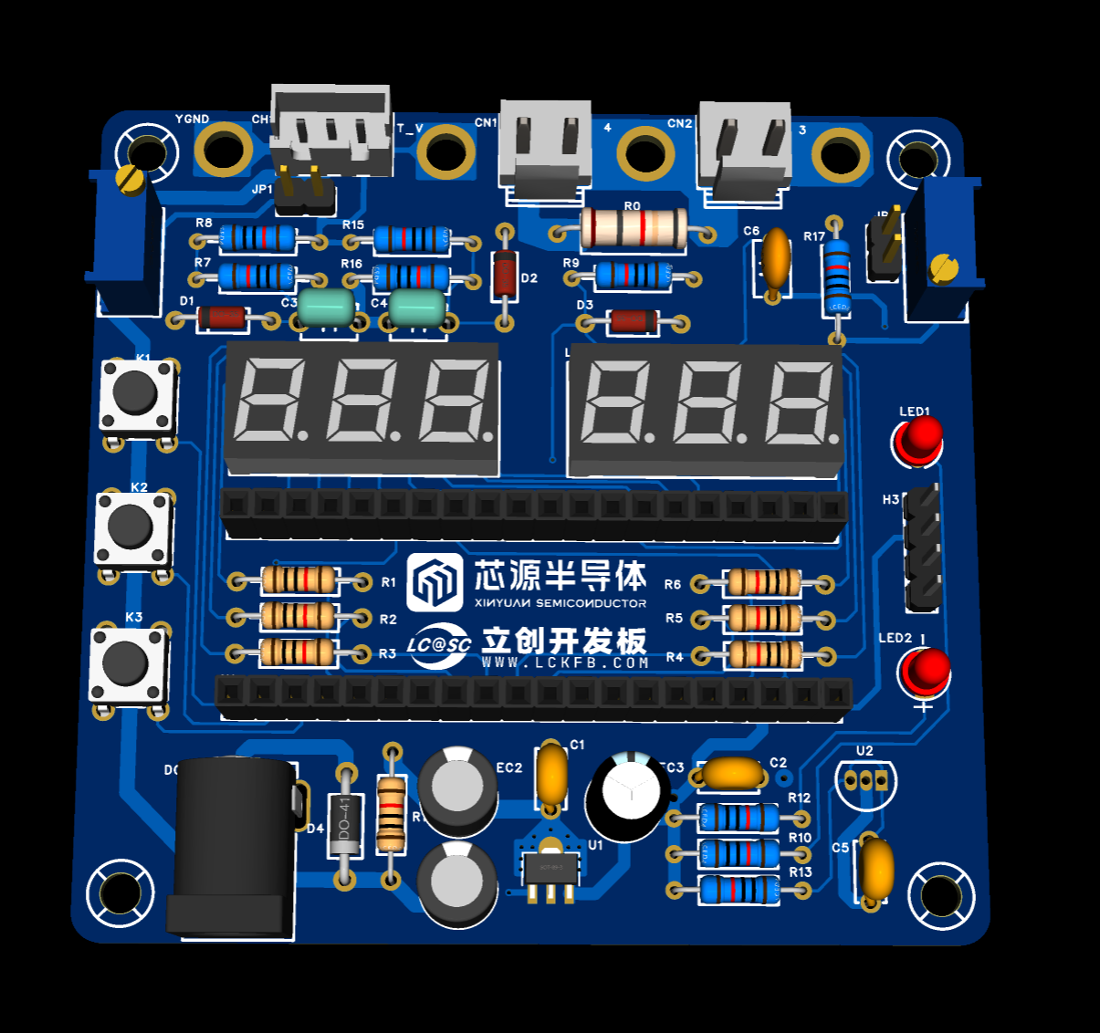

 Project PCB 3D Rendering
Project Finished Product Verification Display

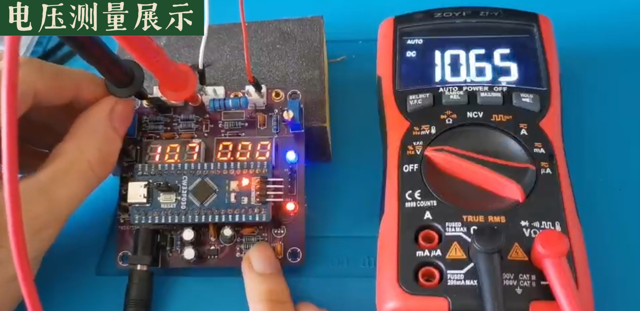

 Voltage Measurement Display

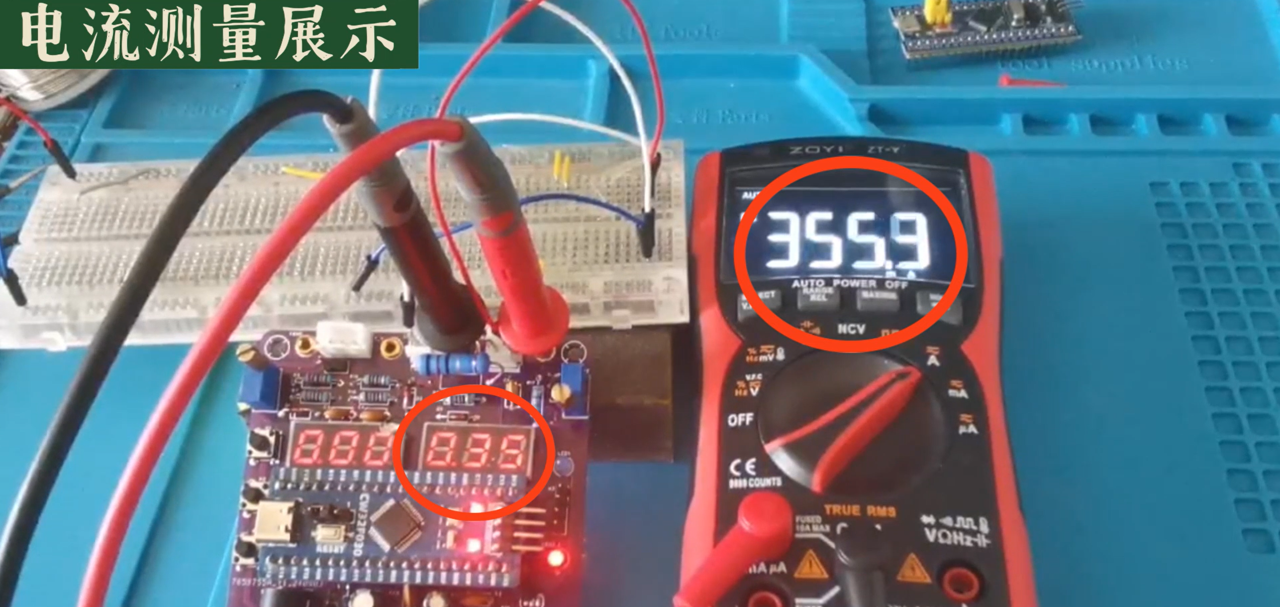

3. 1V Voltage Calibration Interface
4. 2V Voltage Calibration Interface
7. 0.5A Calibration Interface

 Note: This project does not use single-point grounding at the 12V to 5V power supply on the PCB, and power ground and signal ground are not distinguished in the project.
